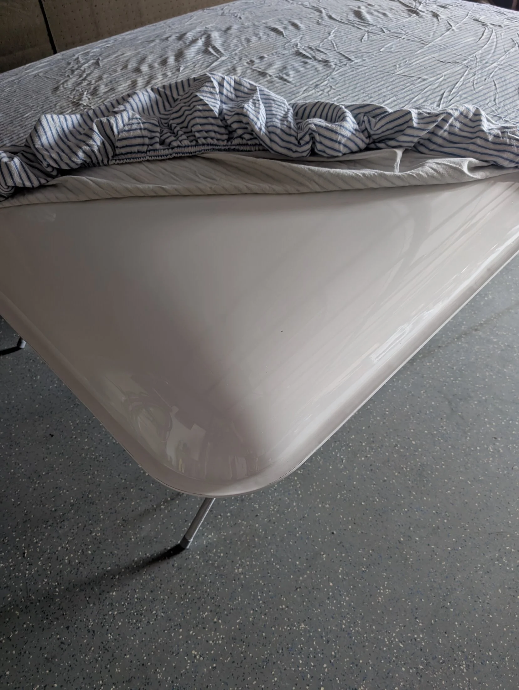

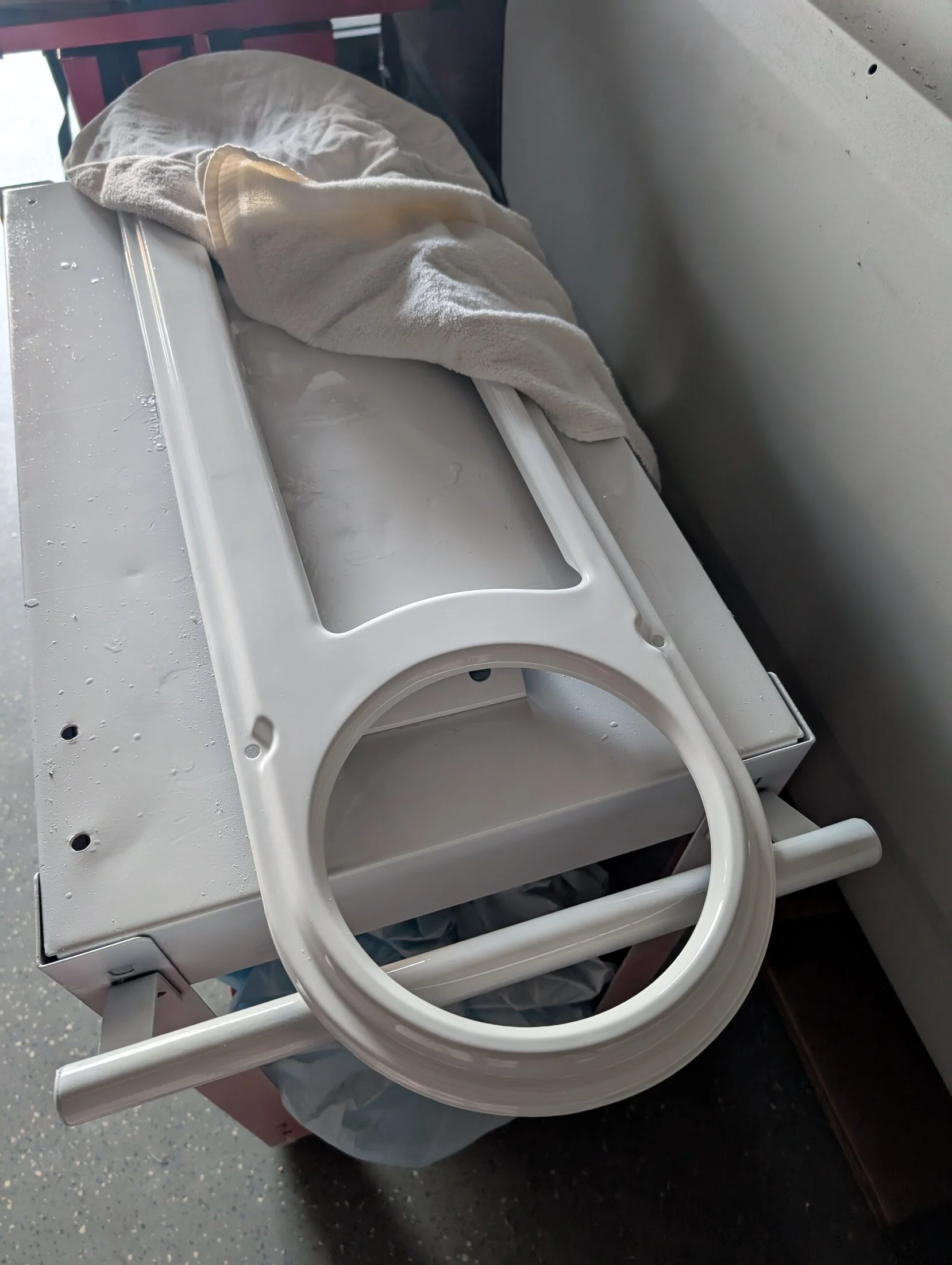

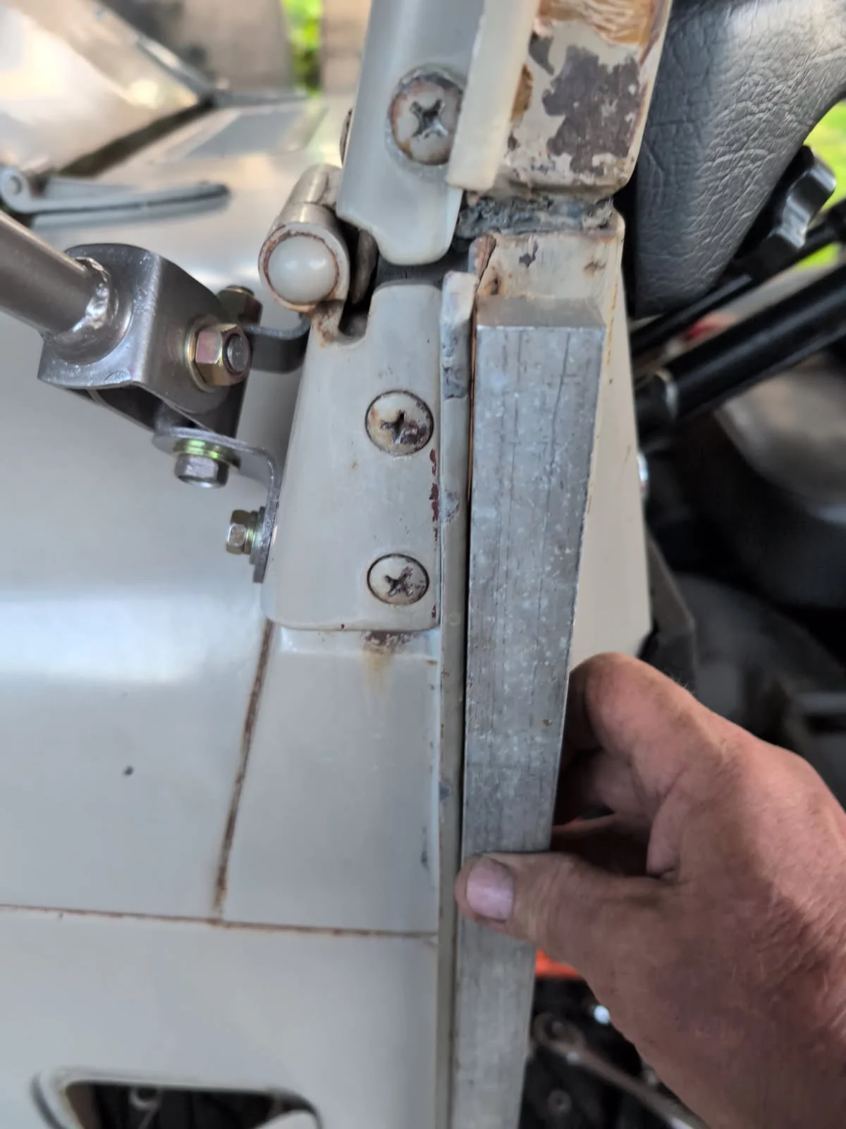

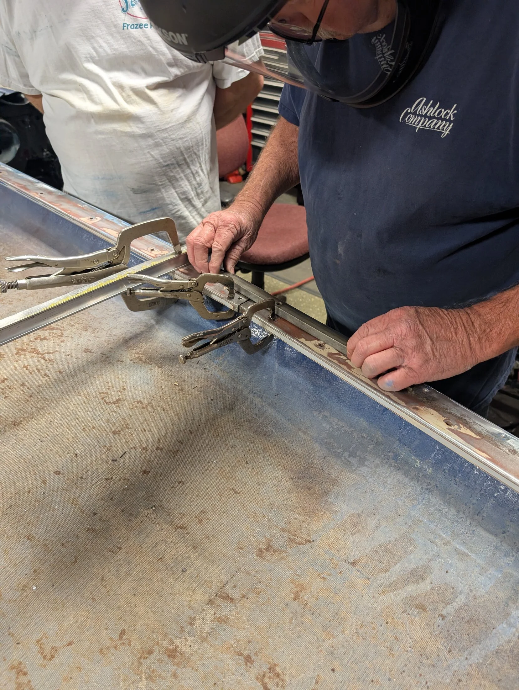

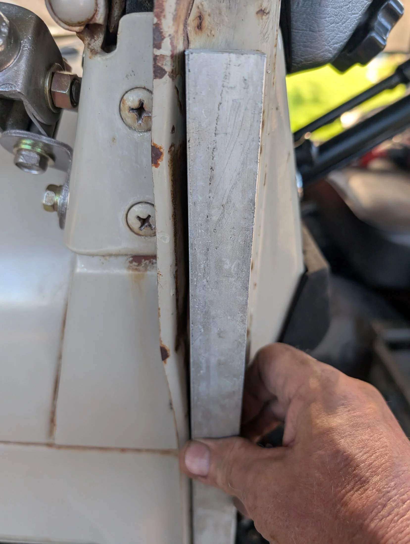

Doing a dry fit of the top before painting. When I originally got the cruiser the previous owner had dropped some trees on it a couple of times so I had to source a new top. It has a had a couple of tweaks. Had to reweld the cracked drip rail, had to be careful not to heat up the fiberglass and the drip rail had already been sealed with self-leveling filler. The door hinge had been stressed and bent out of shape, It did a number on the frame trim too. Nothing a little tap tap tap can't fix.

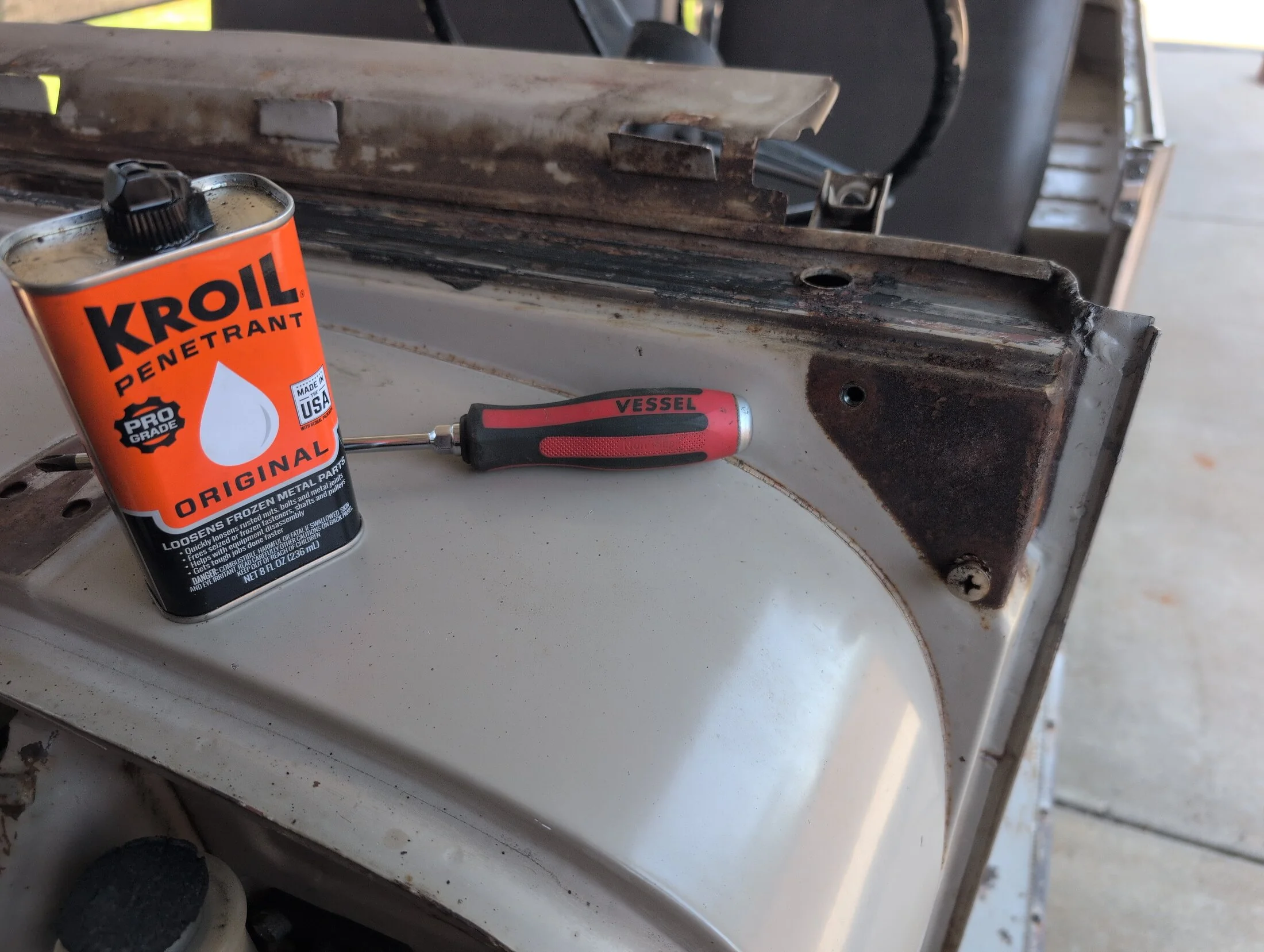

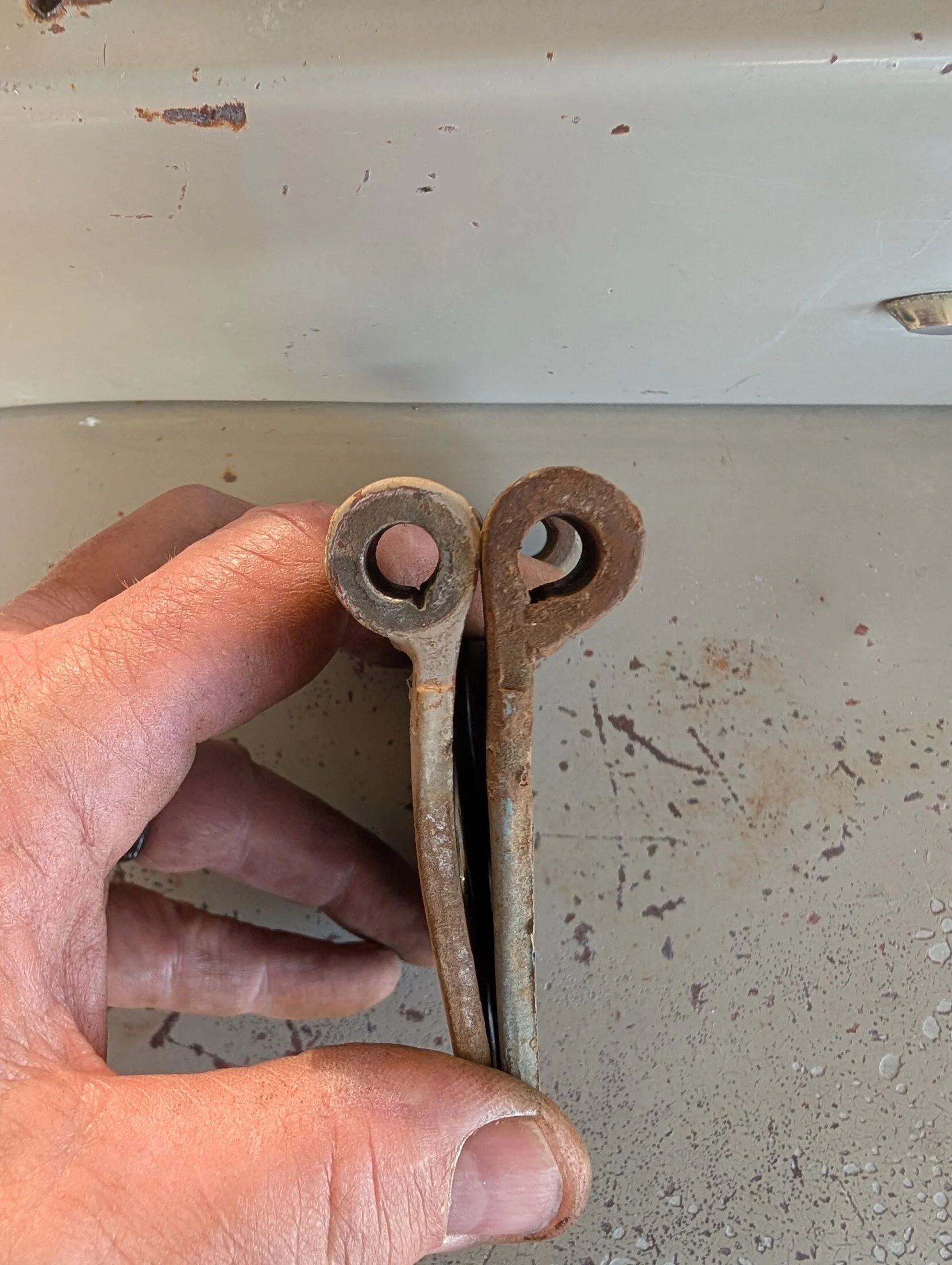

There is a lot to be said about having the right tool for the job. Especially when trying to loosen the bolts that hold the windshield in place. I have tried handheld and battery impact tools. But I found that a little bit of kroil pretreatment overnight , then seating a JIS screwdriver in the slot and tapped on it a few times. Does the trick of course, but having the grip on the screwdriver shank doesn't hurt. That way you can put a crescent wrench on it and loosen it up.

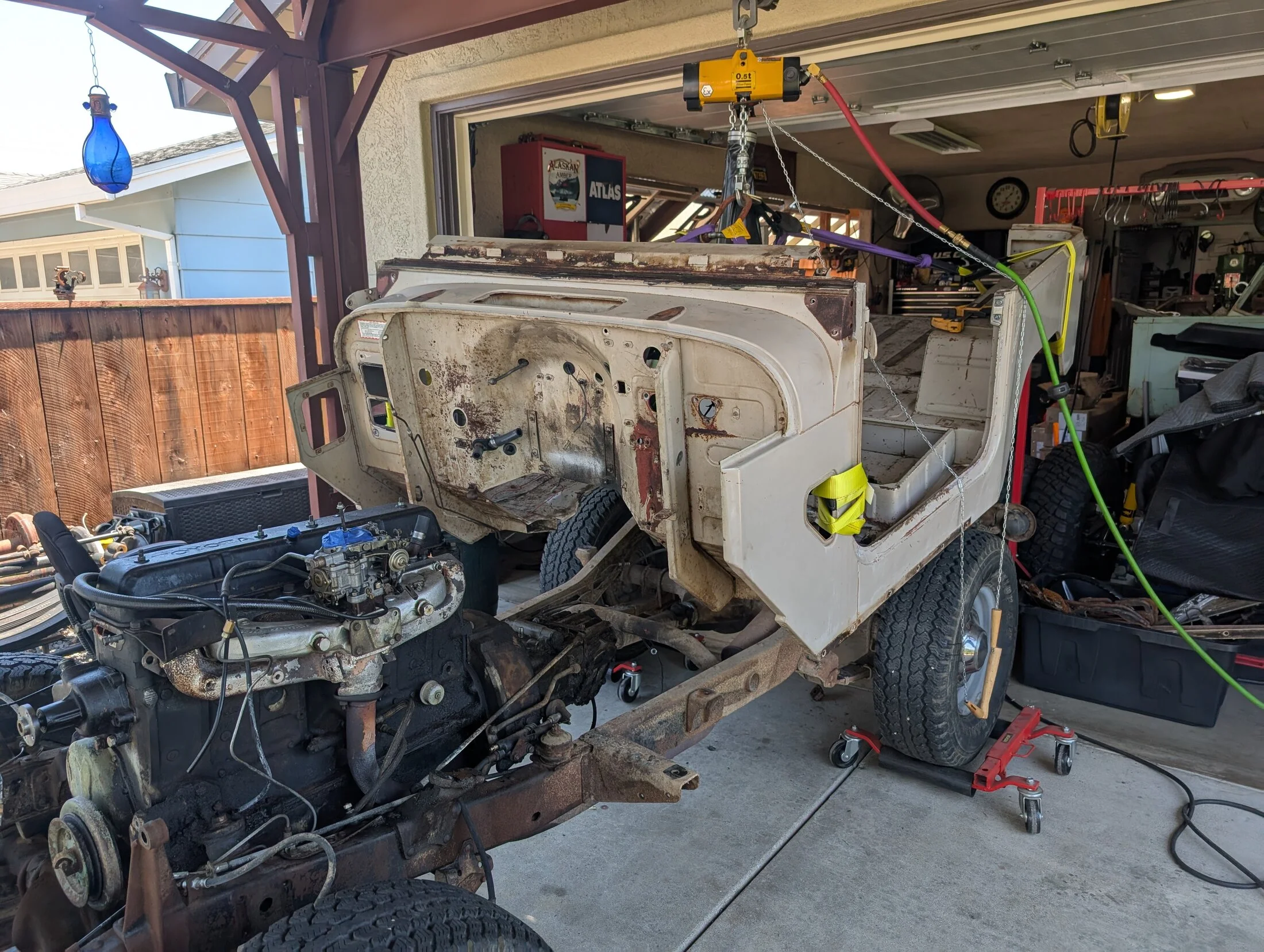

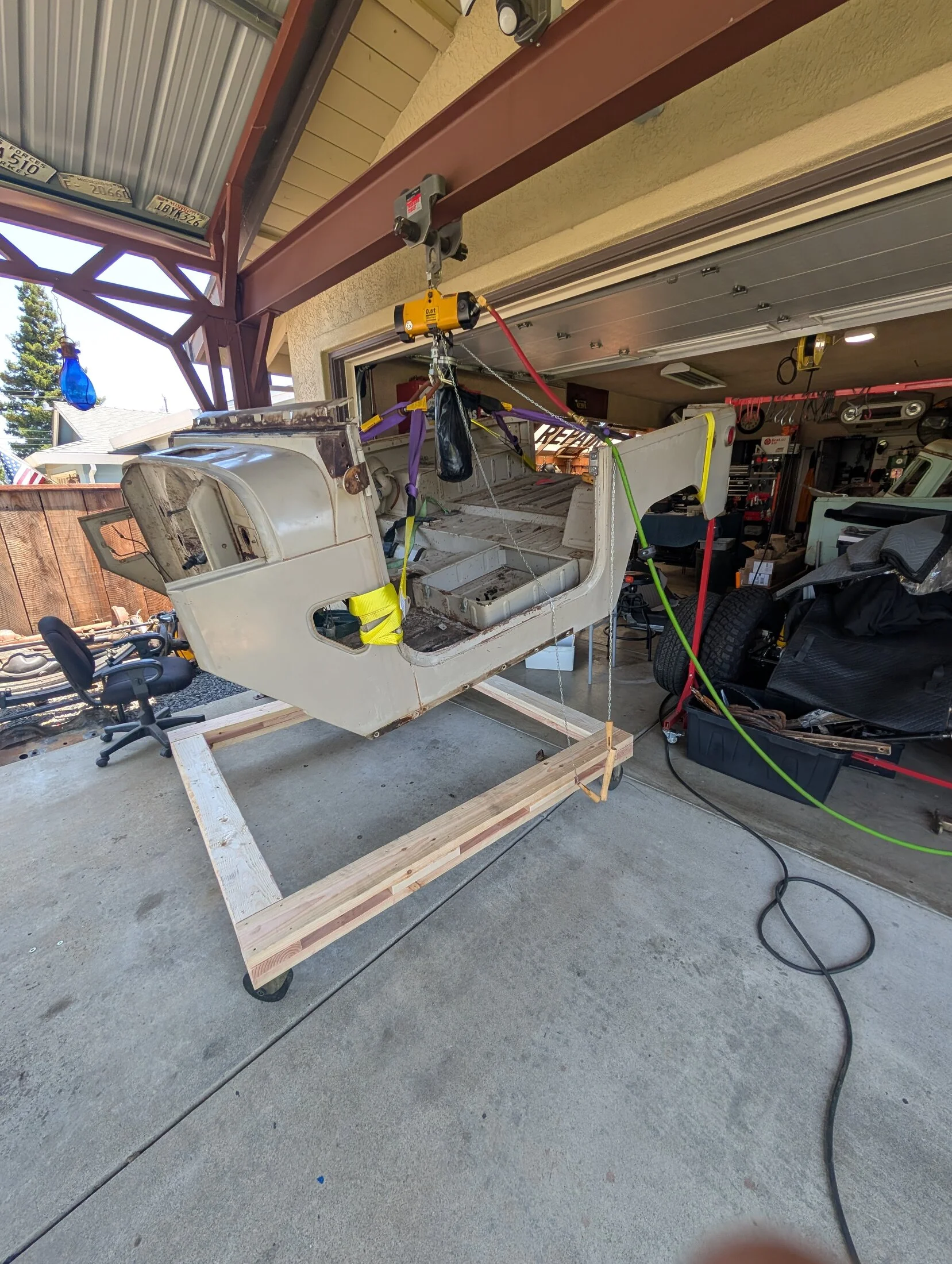

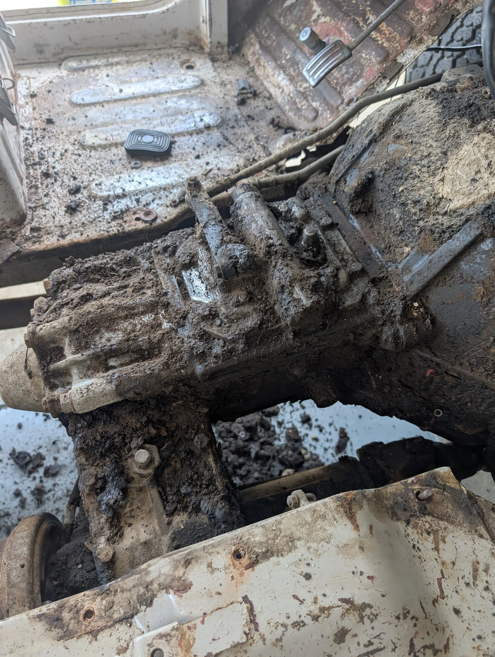

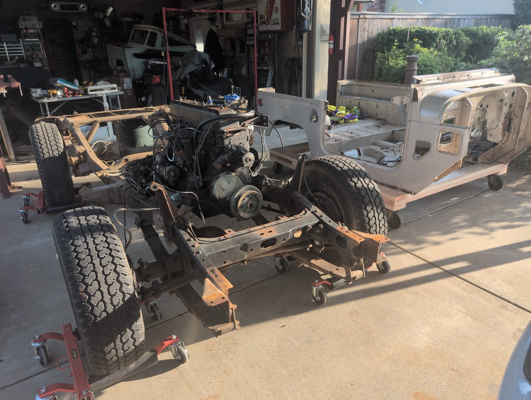

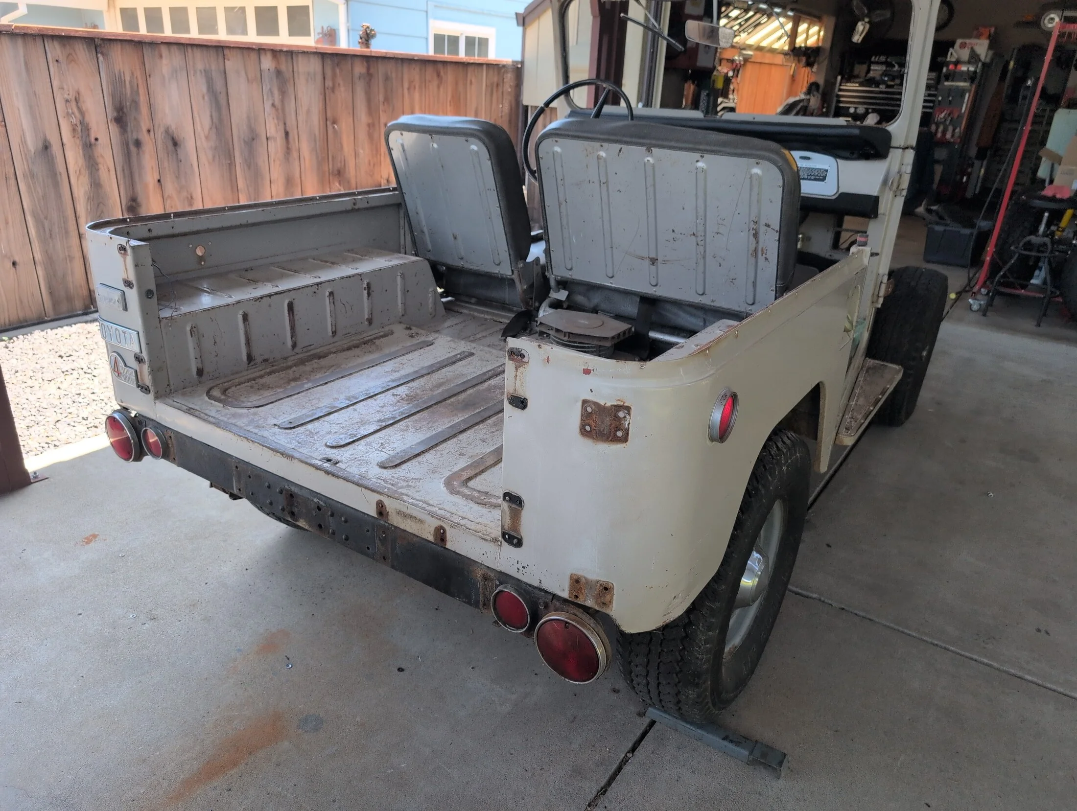

Getting ready to take the tub off. Figured, well since I'm replacing the body mounts might as well take the tub off. Going to make a dolly for it tomorrow. Planning on leaving the original paint on the exterior. Lizard skin is planned for the interior floor/ firewall and underneath to include the firewall. Paint to match.
Always nice to clean this stuff up and start from scratch.

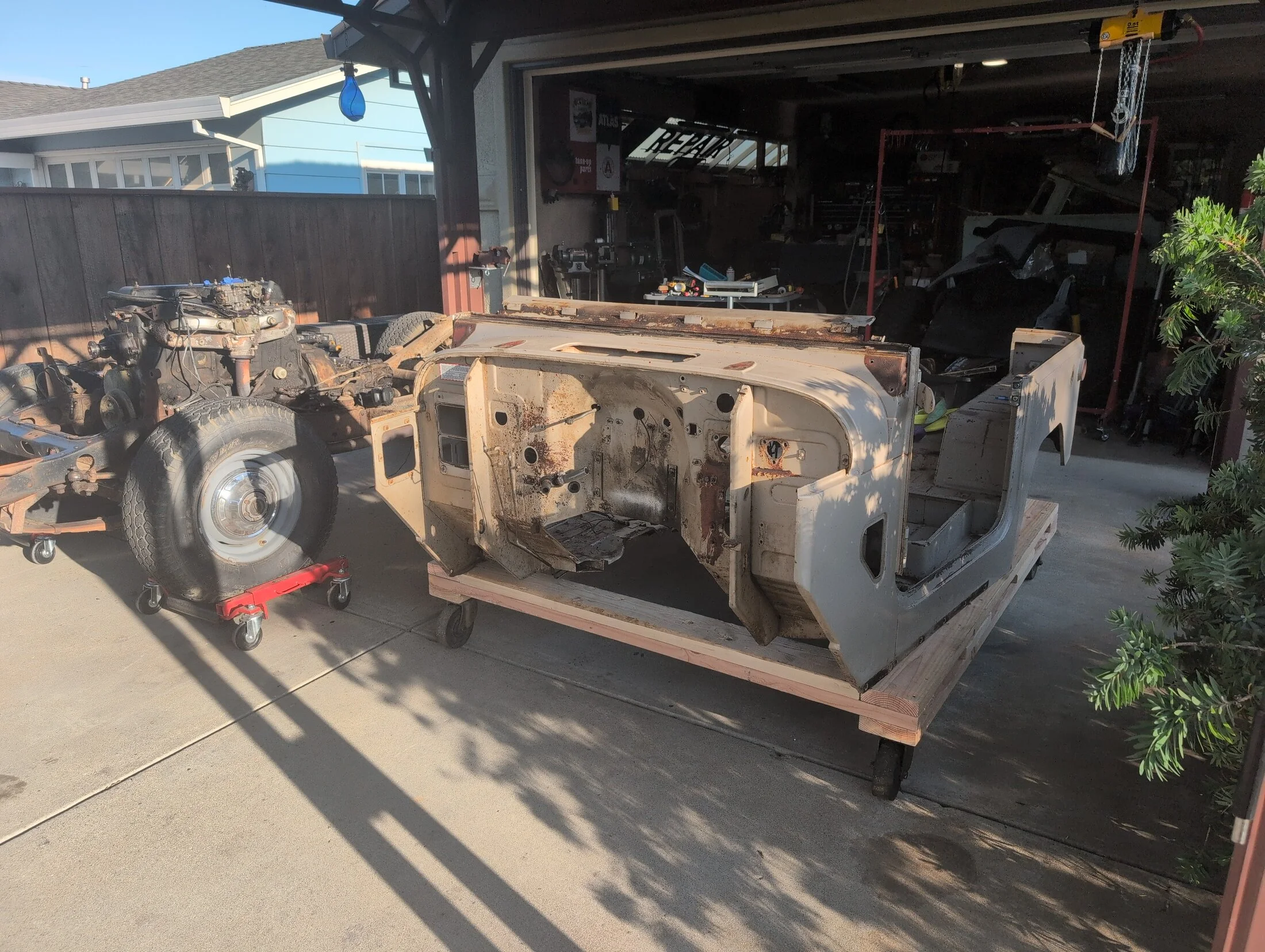

Dolly time. About $60 in materials minus the wheels. There were some old scruffy ones I had. But it's so nice to move around.

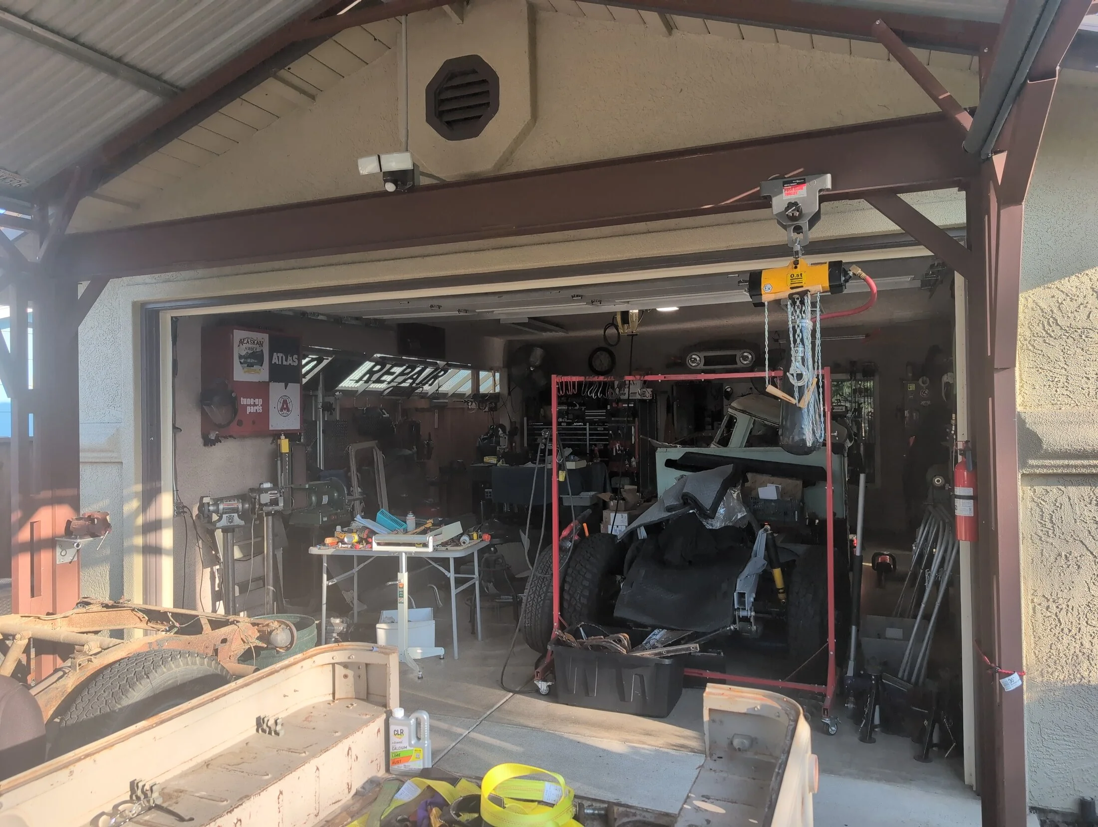

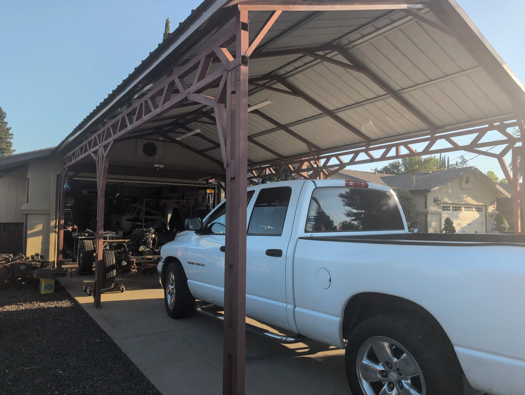

Love the cover/gantry setup outside your garage—looks great and very functional. I don’t remember seeing that when we stopped by your place a couple of years ago.
I added that in after I had a guy put in a carport. It works out nice. It blends right in with it. I have a pneumatic hoist. Never owned one before. Always had electric. They work really slick, you can just creep along with the thing when you're lifting.

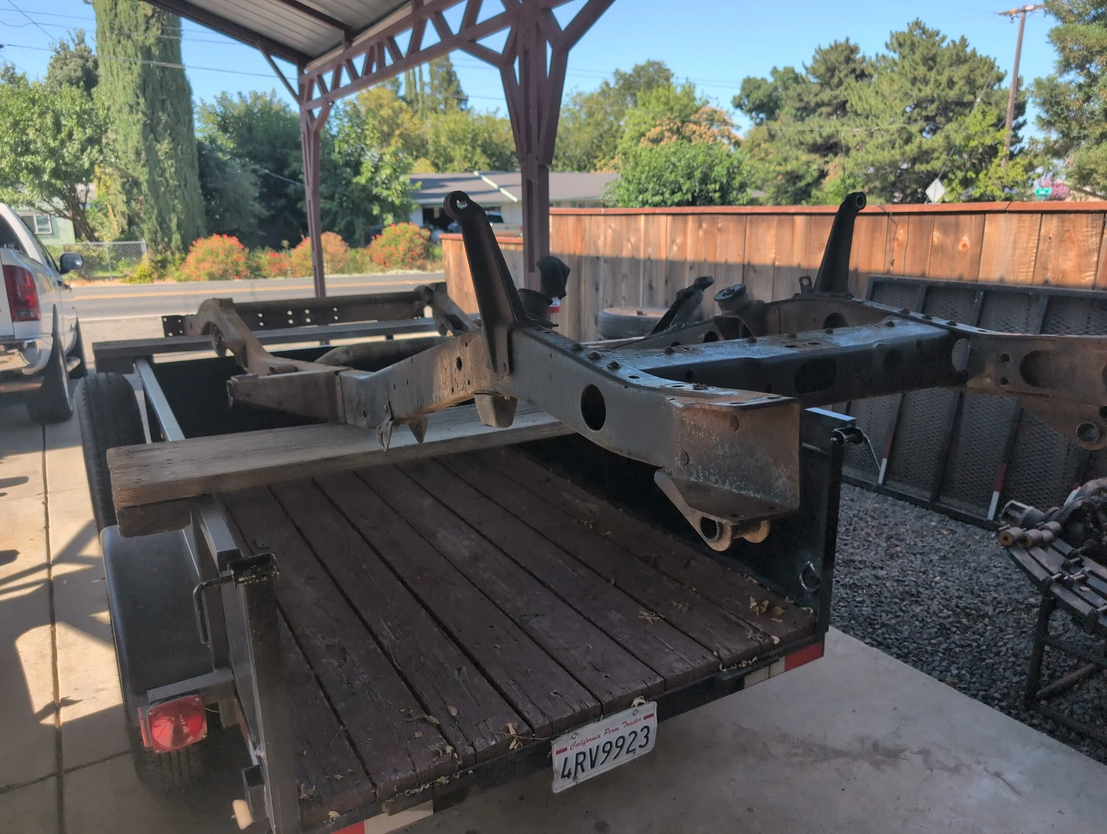

Getting ready for sandblasting and off to the powder coater. Got to clean some excess oil off and remove some hardware and she'll be good to go.

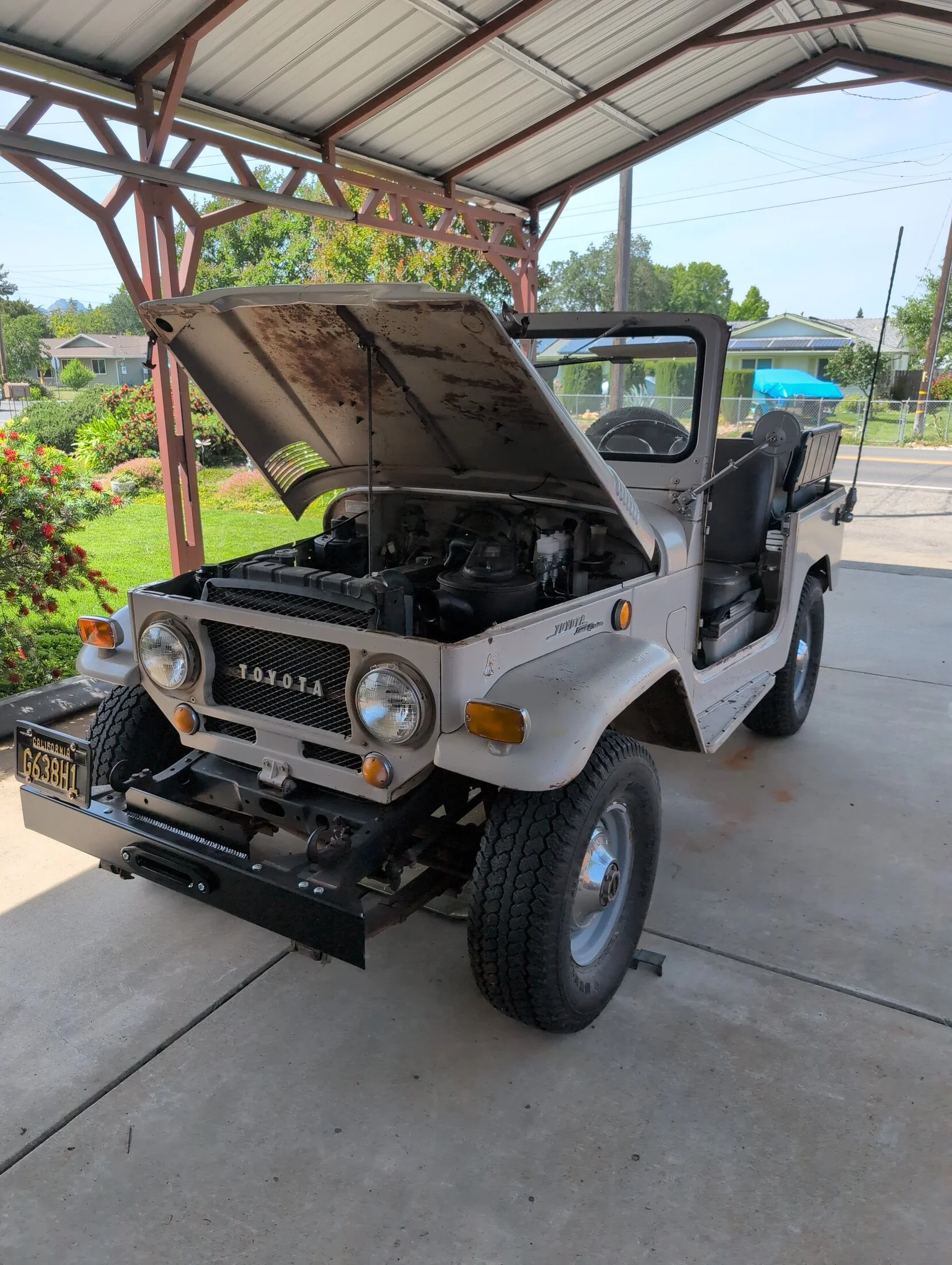

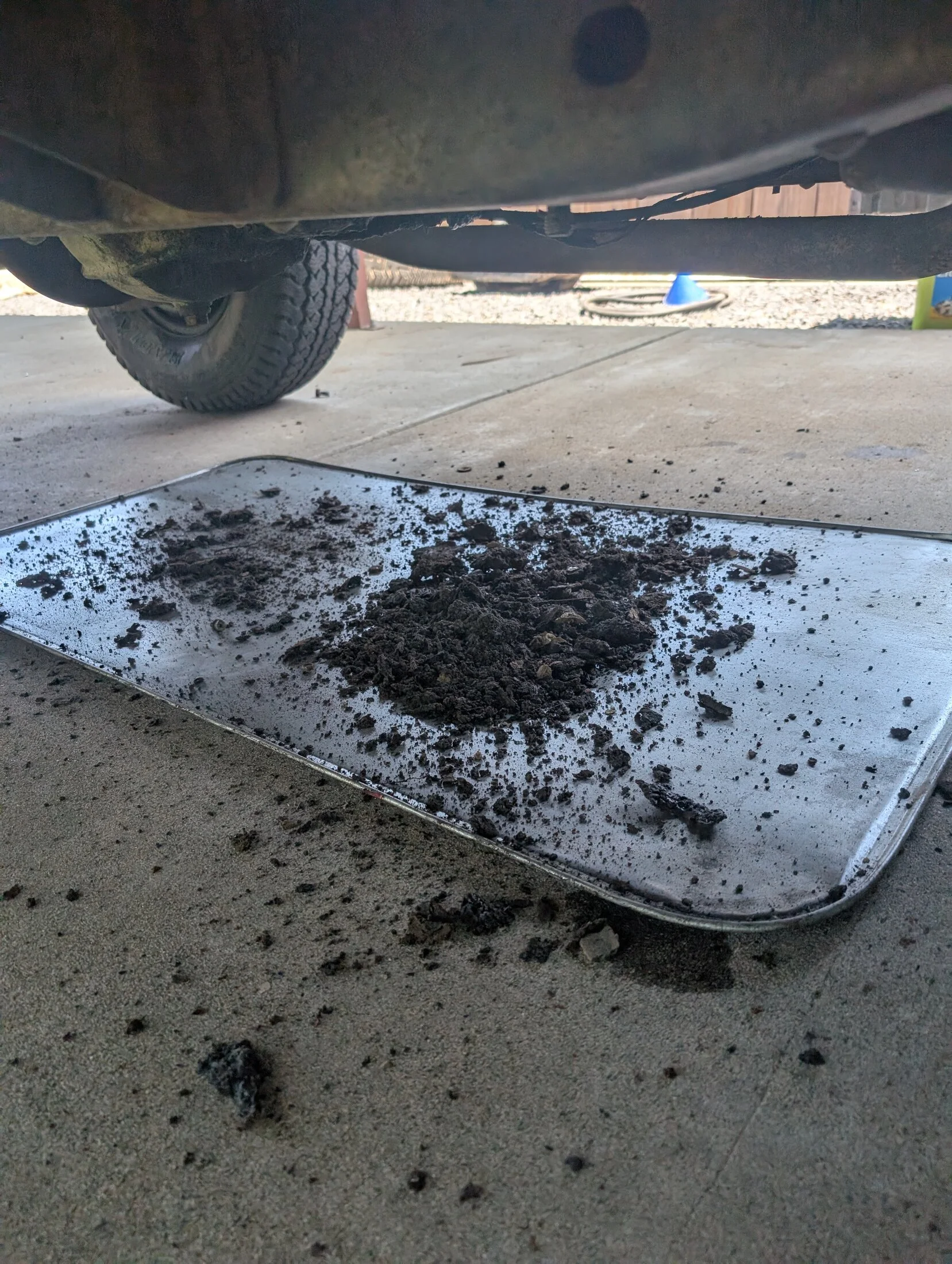

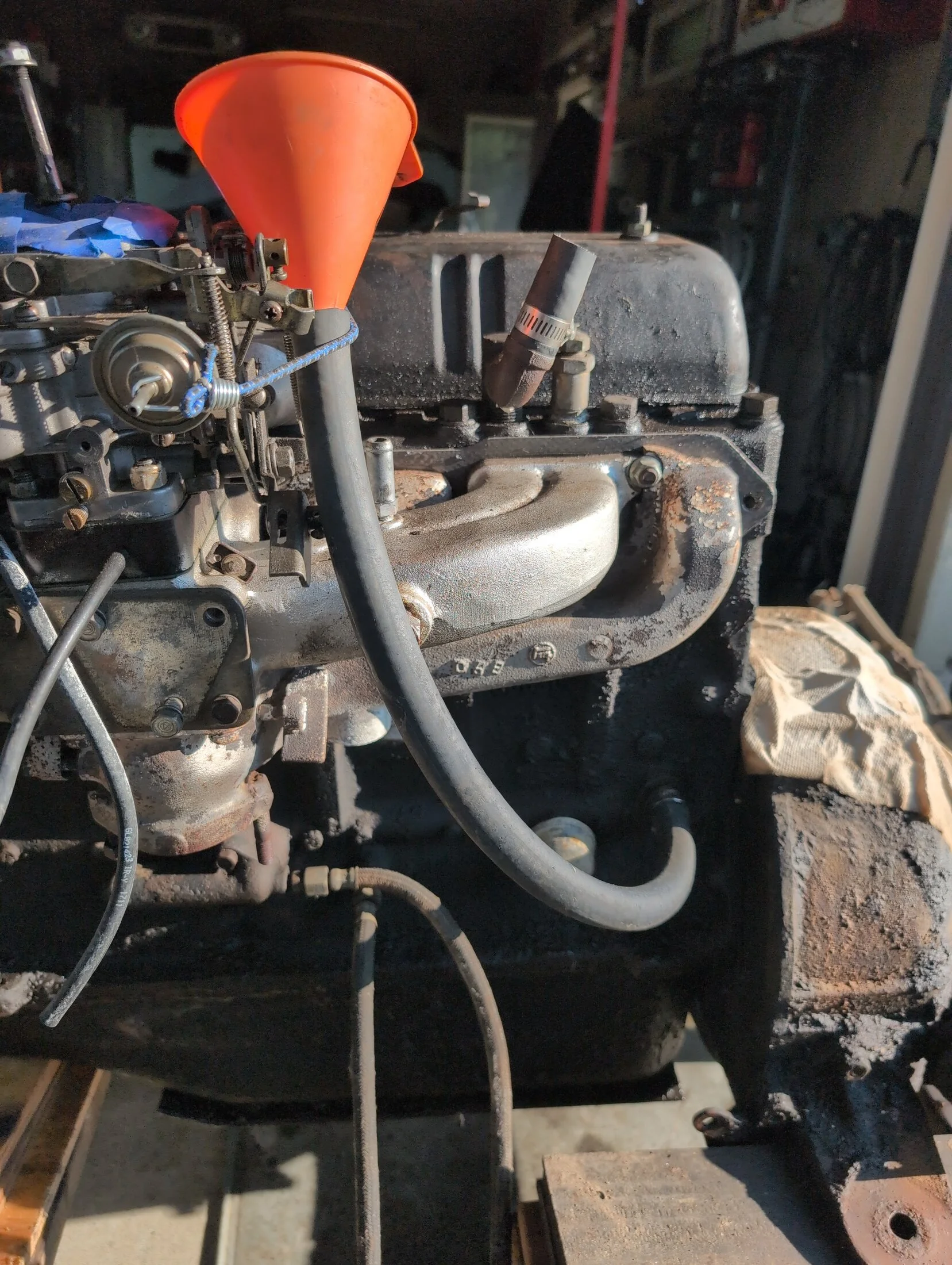

Starting work on the motor. First thing I always do is loosen up that rear coolant drain plug, and of course that is plugged up! I had noticed a couple times on a little bit of a warm day. It would run hot. I've been putting CLR in there . Just picking away at it. I think I will end up pulling the head and get better access to those ports. Plus that will allow me to check the valves and ring wear at the same time.

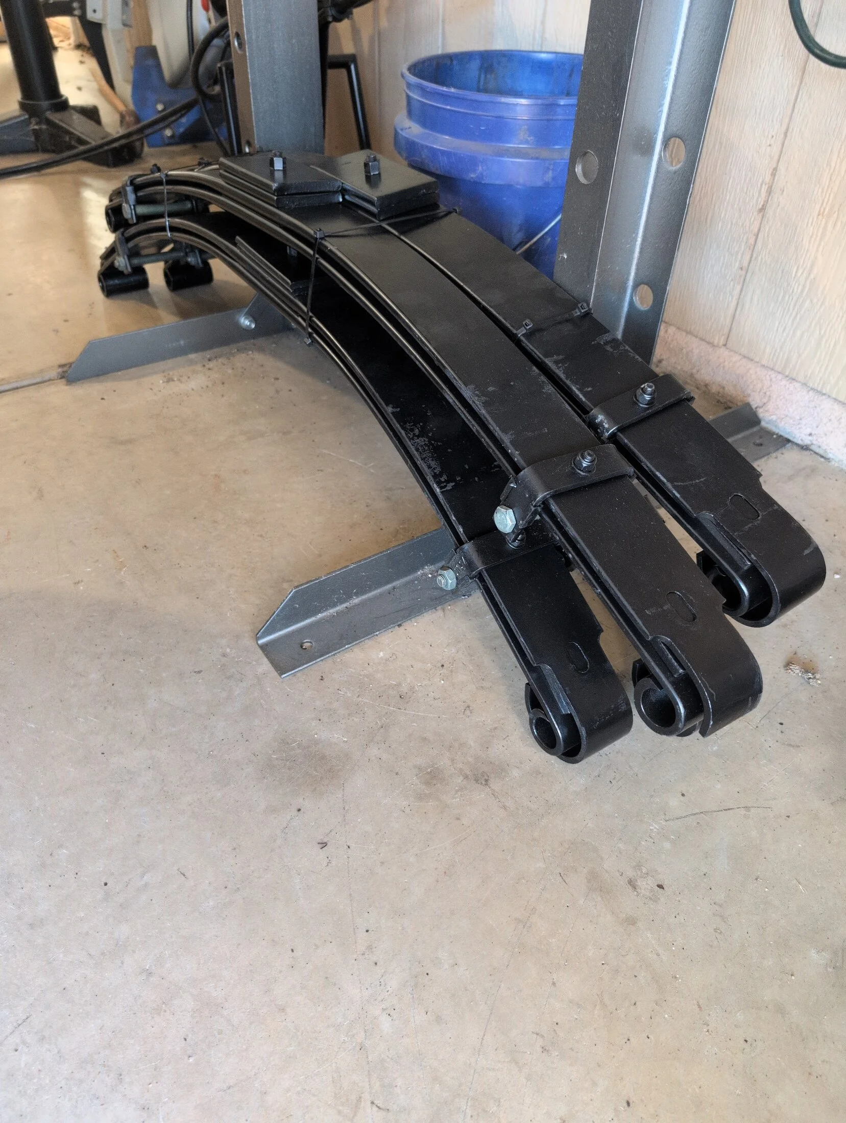

I motored by Valley hybrid in Stockton and picked up some parts and then went over to Georg's new store. Picked up some terrain tamer springs, looking forward to testing them out!

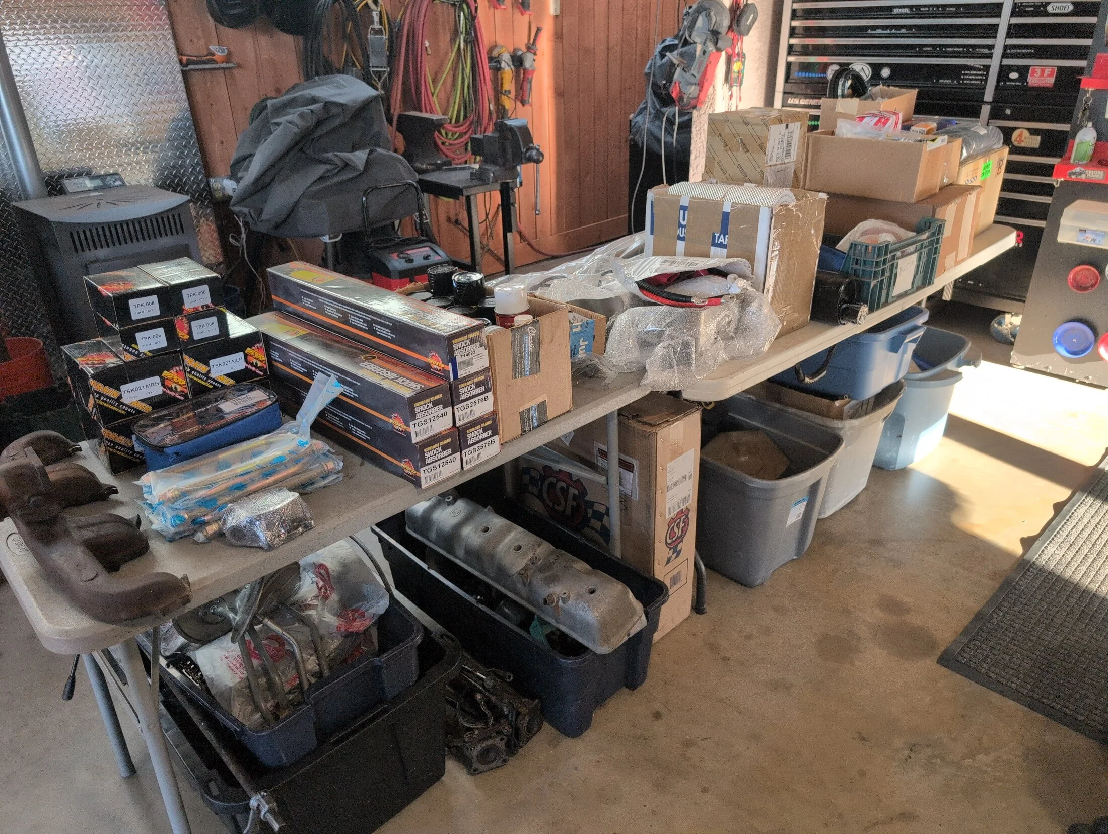

Accumulating a few parts to put on the old girl.

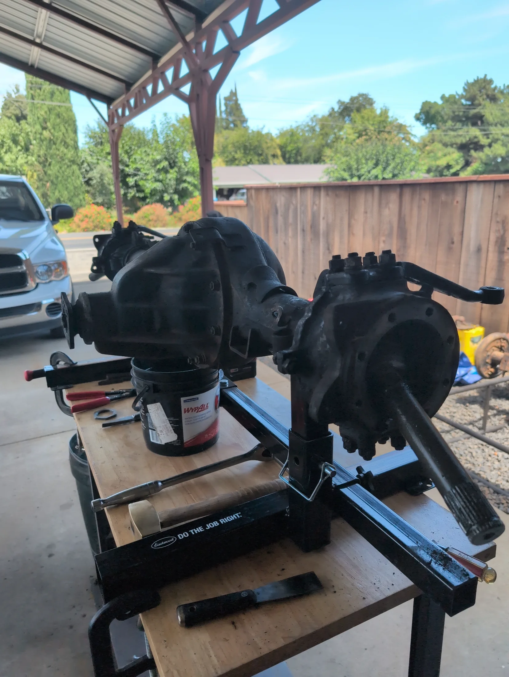

Tomorrow I'm going to be starting on disassembly of a later model FJ40 disc brake axles. Planning on going thru them before installation.Going with disc on the rear also. Degreased and ready to disassemble.

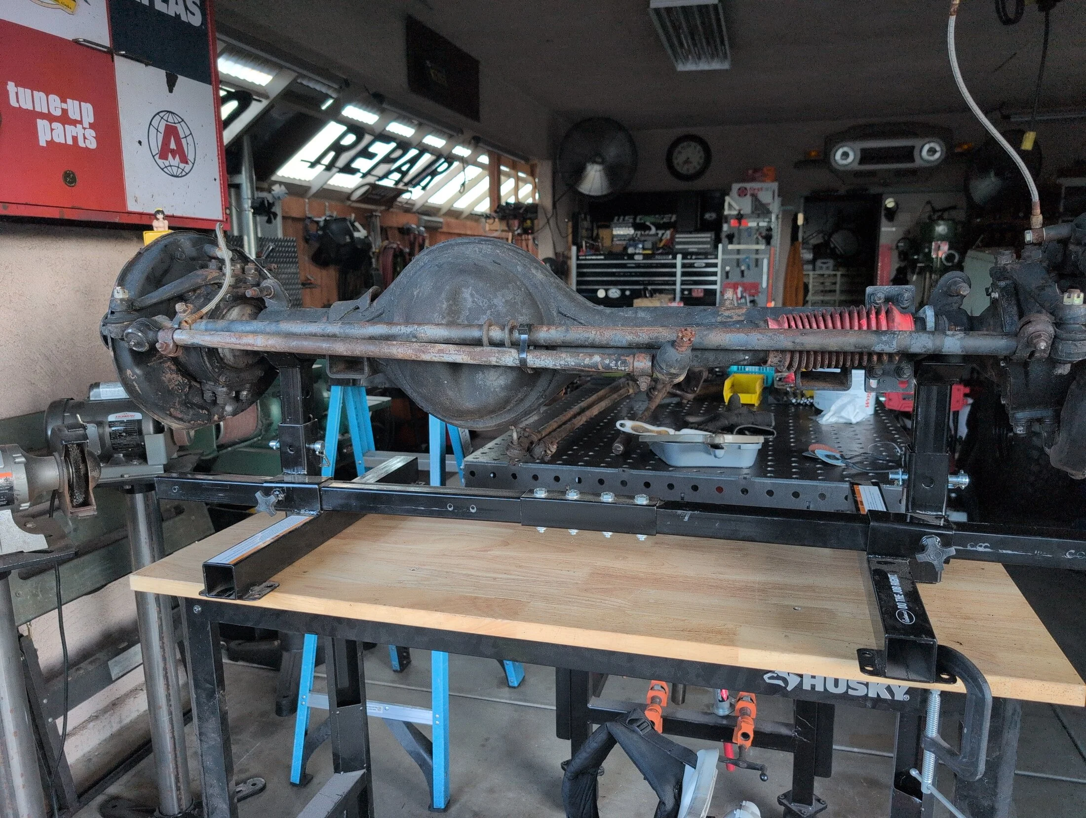

Couldn't wait..lol. Hoisted the axle up on my bench. Using a Eastwood axle dolly. I just removed the casters and clamped it to the bench. Easy to work at height, at least for me.

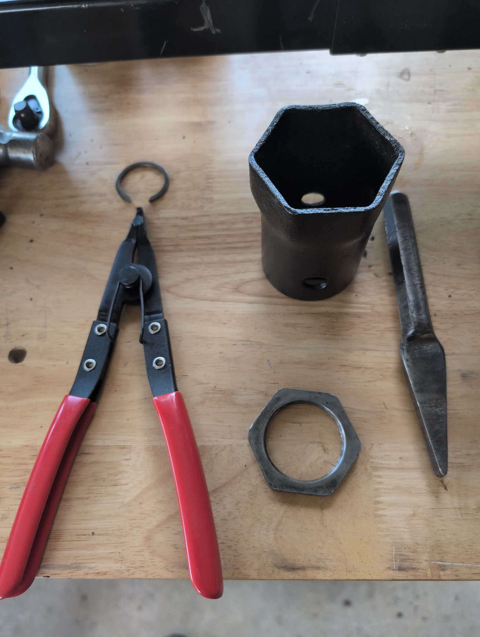

Starting on the axle teardown. Good to see clear oil coming out of the differential. Going to make sure I mark where I take all of my shims off of on the knuckles. Had a mix-up before on a previous set, wasn't pretty... Couple tools to have before you start. 54mm Hub Socket and a retaining ring plier. There are always ways around using these tools but these will get the job done most effectively.
