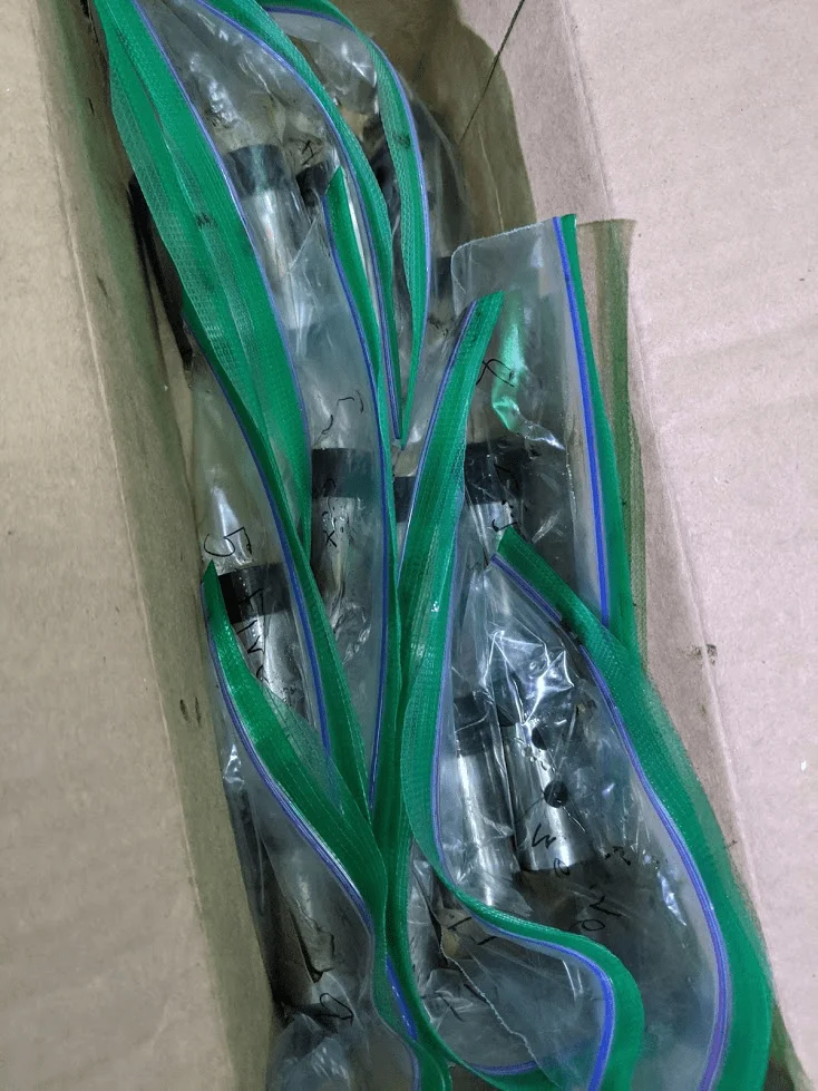

In the meantime, I was able to pull the lifters, camshaft, and crank gear.
The trick to getting the lifters out was using a magnet to slowly pull them out. Make sure to keep in order if reusing.

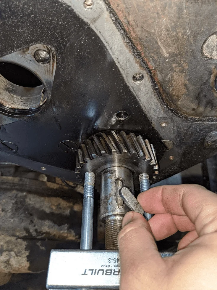

And last but not least the crank shaft gear. The trick to this was getting the pulley key out. I wasn't sure exactly how to remove it, but after some searching through mud for some answers, I was able to do the job with some vice grip pliers as was suggested. Just took a little finesse, but it finally came off followed by the crank gear itself. I found using an impact wrench worked to get the gear off so that it wouldn't try to start turning the whole crank shaft while you're trying to remove the gear.

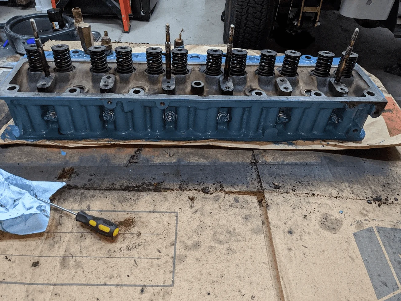

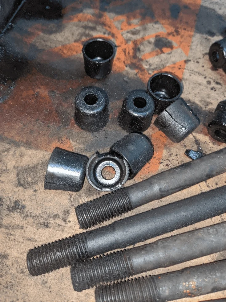

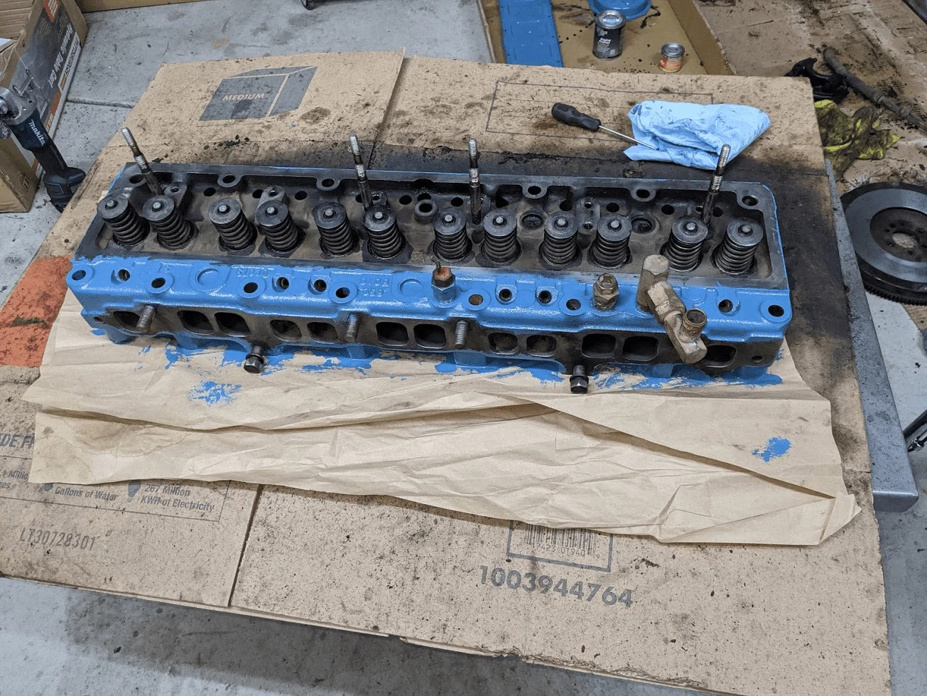

For today's update, I got to do a valve job. By that I mean pull the valves, clean them up, replace the seals. The seals were all pretty bad and broken. I think there was one that did not have a break in one way or another. This was cathartic in a way and I enjoyed doing it. I feel good knowing that those seals have been fixed and will not give me anymore problems.
Can someone educate me as to what these broken seals might cause during regular driving conditions? I don't know enough to know exactly what happens if these have failed, only that it can't be good leaving them in that condition.

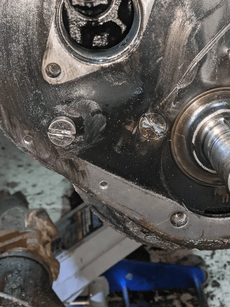

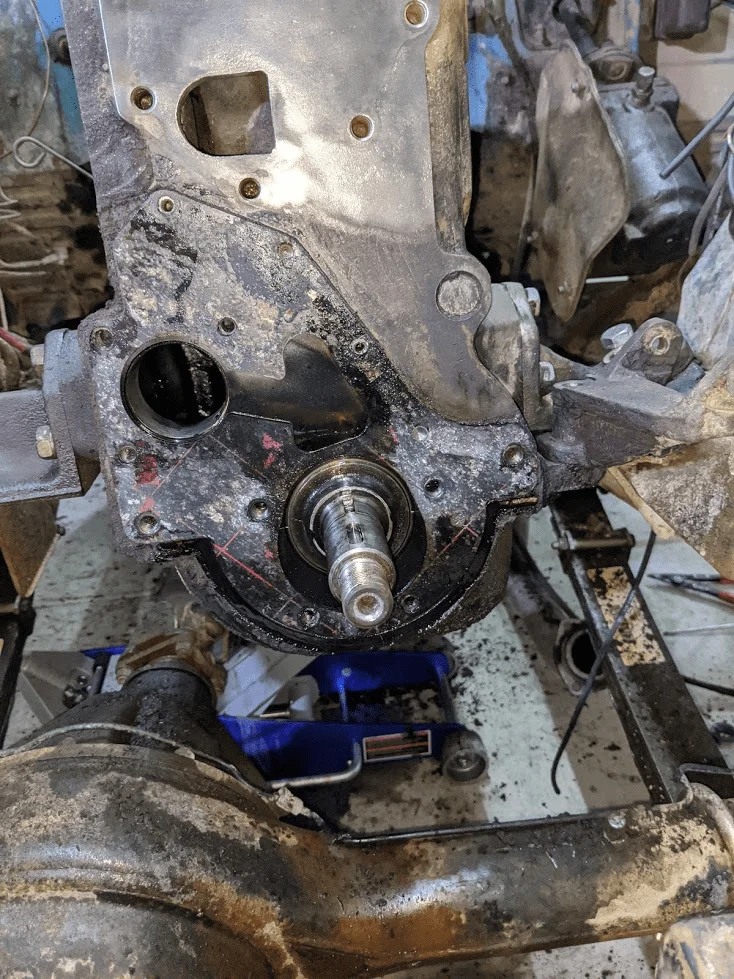

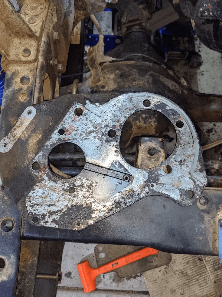

Second thing I got done today is I successfully removed the crankshaft end plate/backing plate. It was a super pain and I stripped one of the flat head screws in the process, but eventually I got the best of it. Now it is off and cleaned up ready to receive the new seal. It is a paper seal, thick paper or cardboard-like material.
Do I need to put some gasket sealer or FIPG sealer stuff on this gasket? I struggle with when to use extra gasket sealer and when to not.

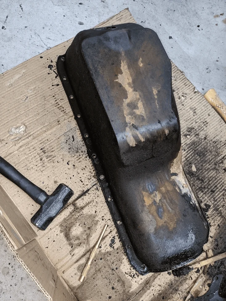

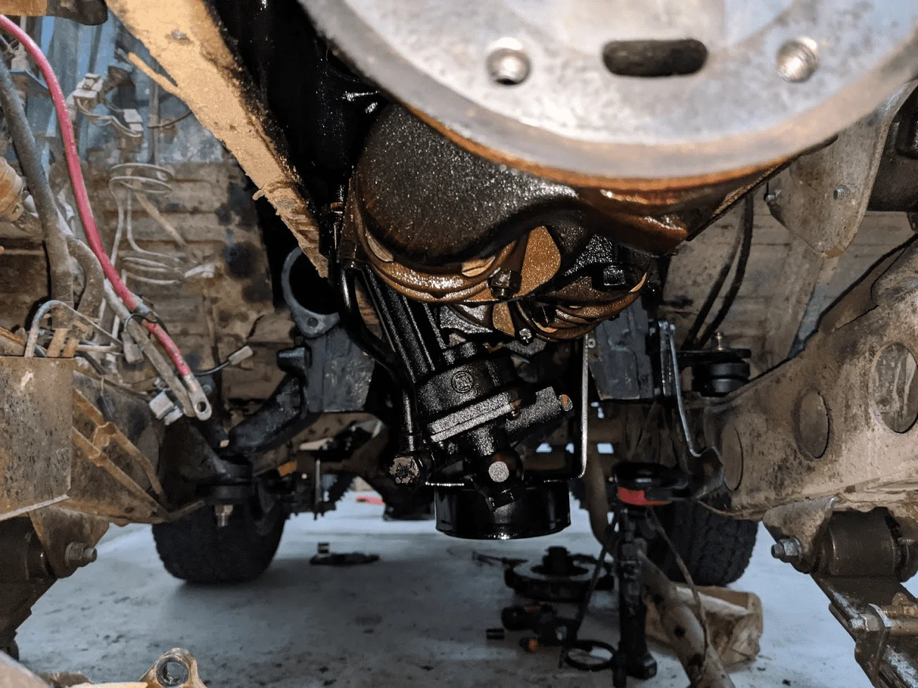

Last thing I got done was drop the oil pan. This was a real PITA! The rear main seal is now ready to be replaced, but we'll get to that later.

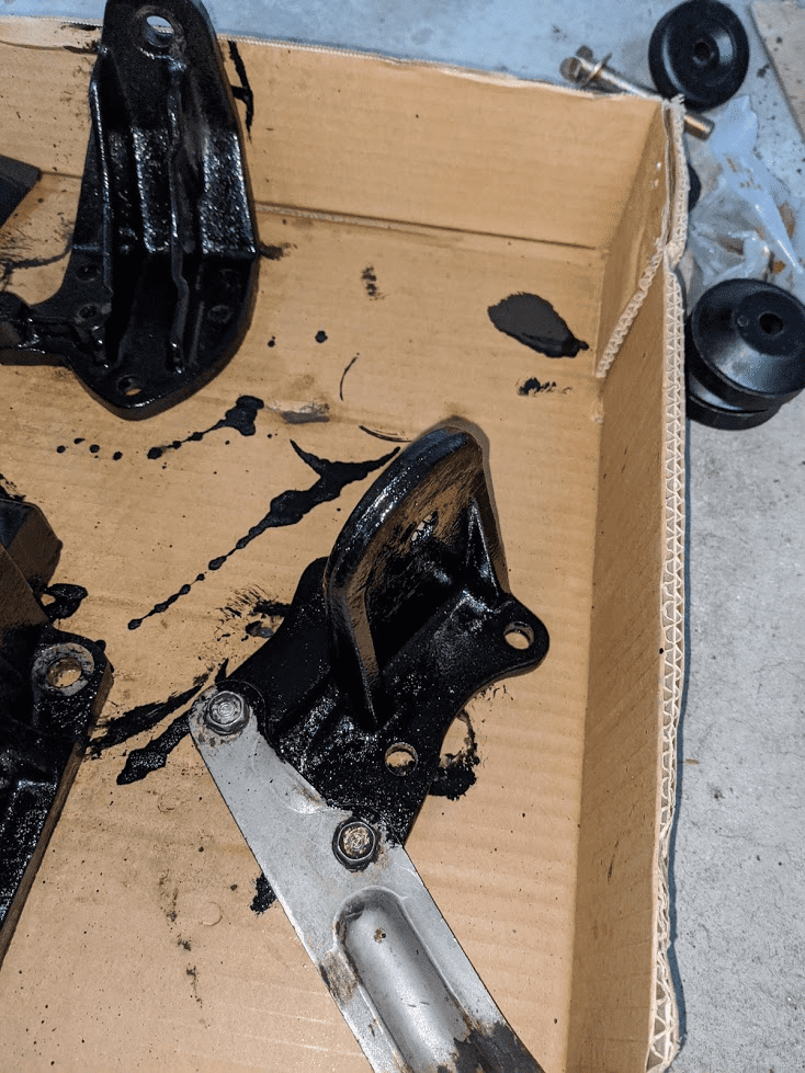

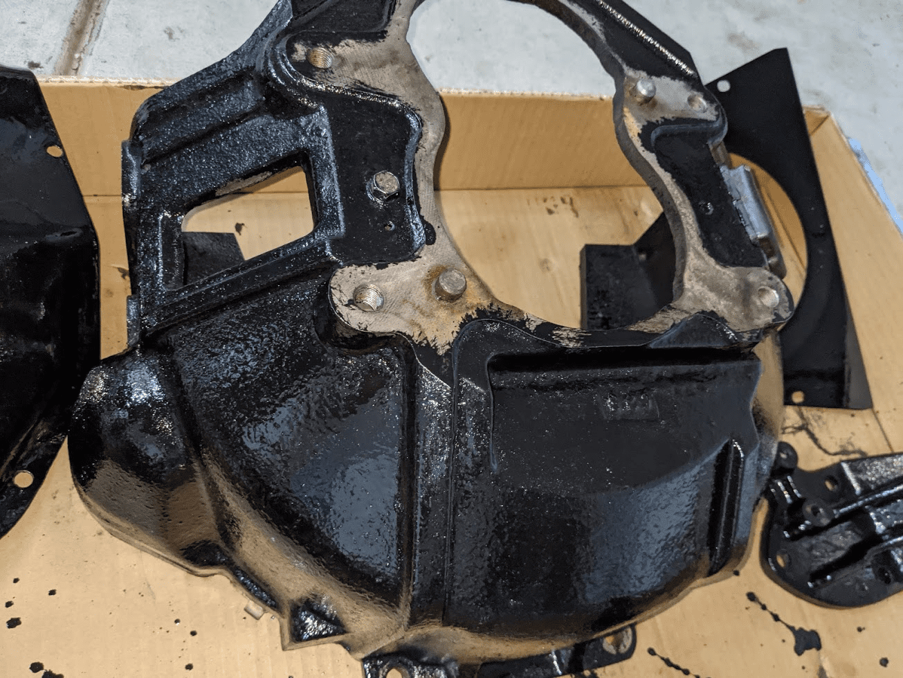

Now I have several pieces to clean up and get painted using some POR15. I really like that stuff, the texture and color is great.
The valve stem seals regulate oil to the valve guide and valve stem. When they are real old, the exhaust has much oil being burned at startup, and maybe deceleration. They contribute, big time, to fouled plugs. If you have chunks of baked-on oil on top of the valve, this is probably why. Fixing just the seals (with the head on), was the biggest victory on my currently installed motor - no more plug fouling, no more smoke out the exhaust.
I cleaned a set with an un-braided wire wheel on the grinder. I couldn't imagine how it doesn't reduce vacuum, getting in the way of the intake.
Thanks for the explanation, it makes sense.
I did have a good amount of smoke pretty much exactly as you described so I'm hoping these new seals will fix that issue. I did the same thing with wire wheel cleaning. I don't think I took pics but mine were about the same build up on the valves as yours shows.

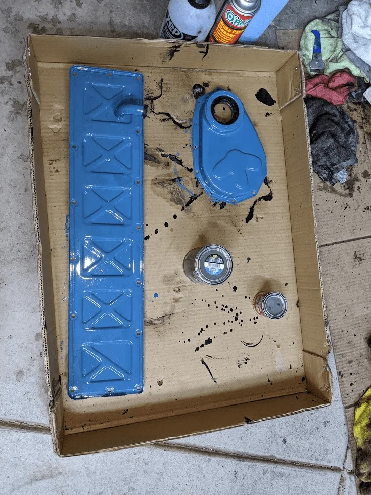

So I made some progress that I'm fairly happy with, but that said it isn't perfect, then again neither is the rest of the landcruiser.
I like the POR15 but it is a little runny and has a tendency to drip. A couple coats to cover some of the missed spots and I'm good with how it is turning out.
Now I have to clean and paint the oil pan, what is your vote same color as engine block or black?
No picture yet but I'm painting the valve cover white with same type of paint.
