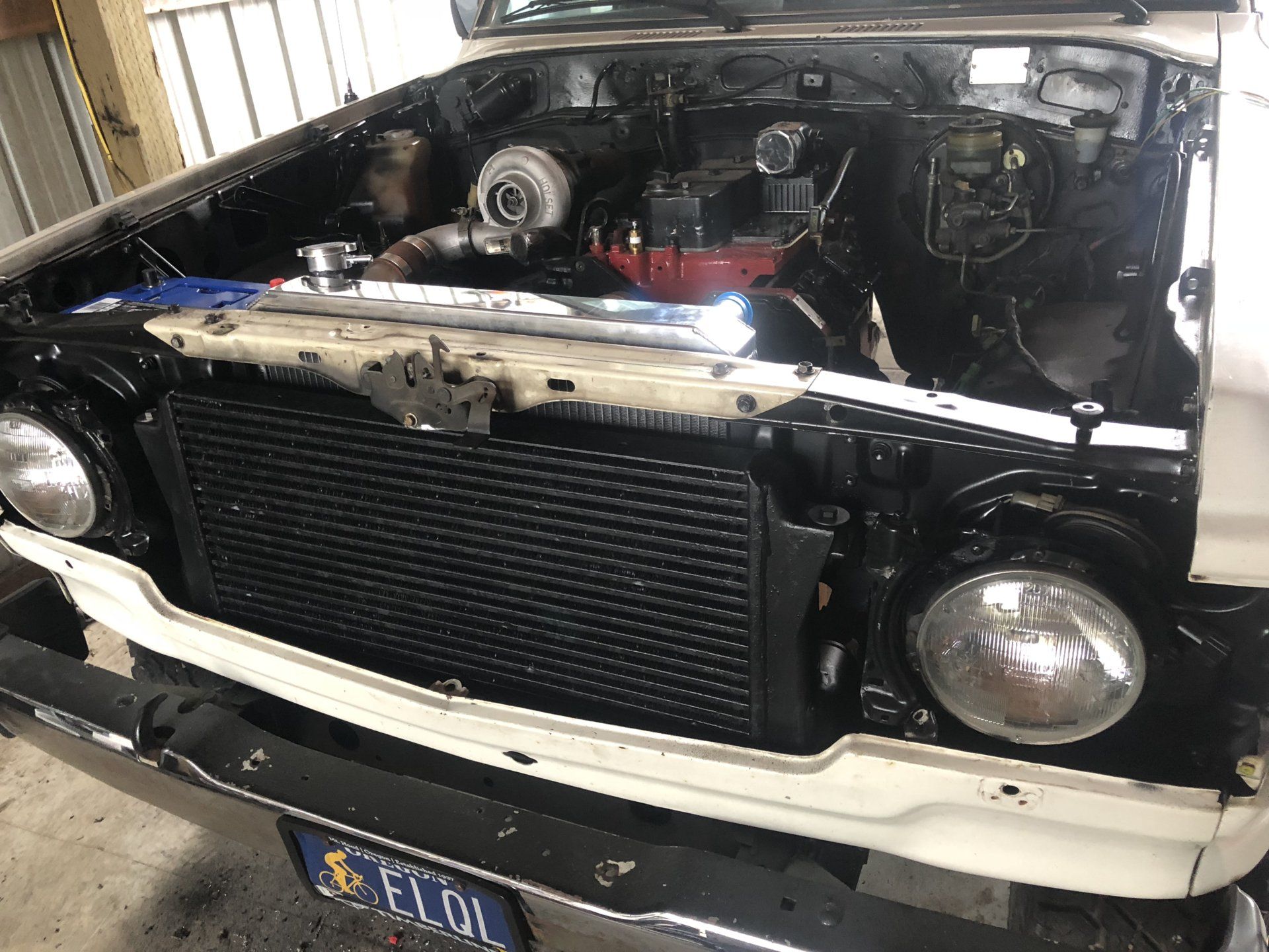

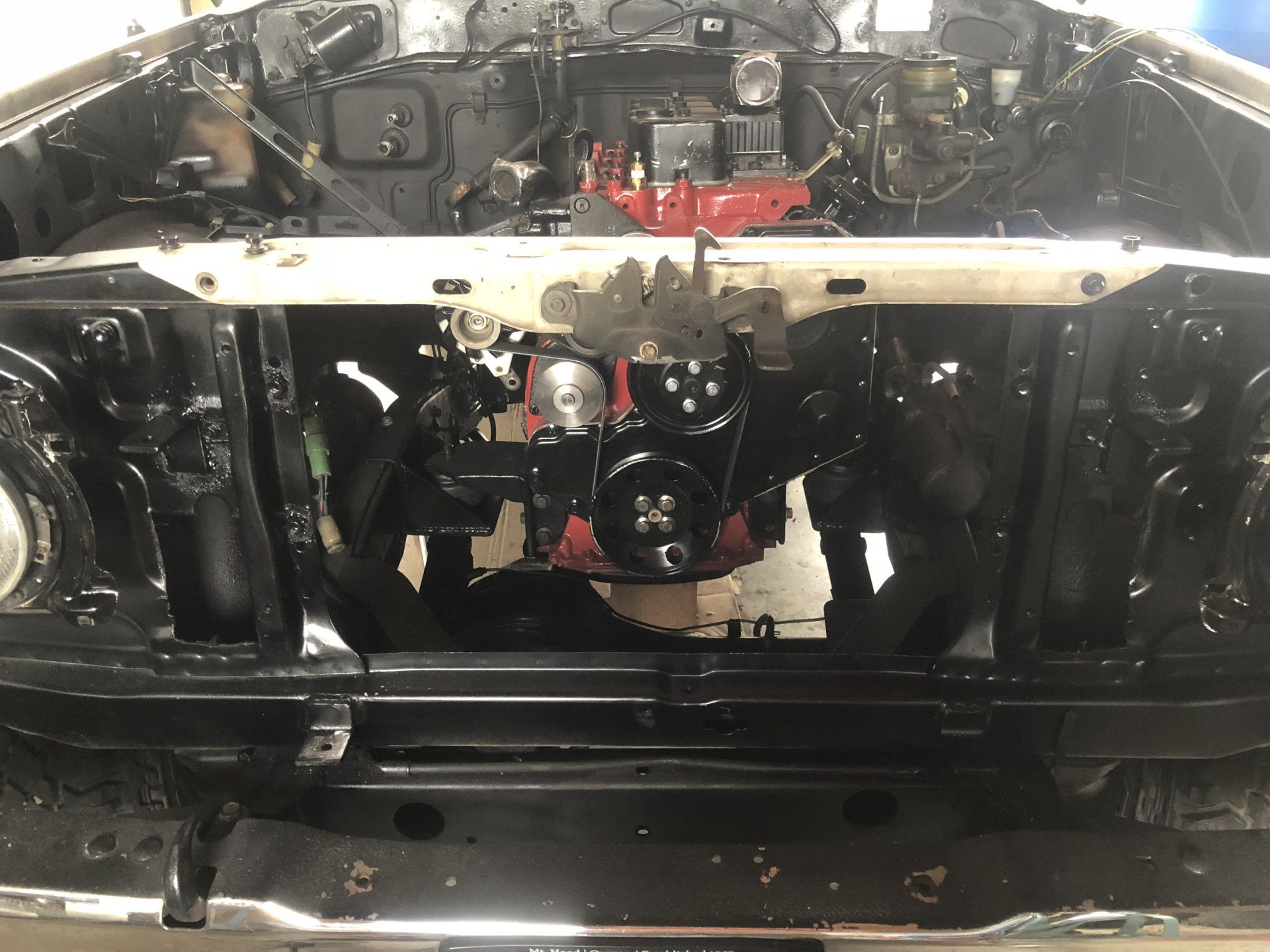

Time sure does fly by. Works been busy as well as any time off for family so it’s been slow as molasses on the cruiser... until today. Was able to get the innercooler painted and mounted in the location just behind the Toyota grill. Mounted the Chamipion Radiator in the stock location.
Did your fj have factory air conditioning? If so, did the condenser fit between the rad and the intercooler?

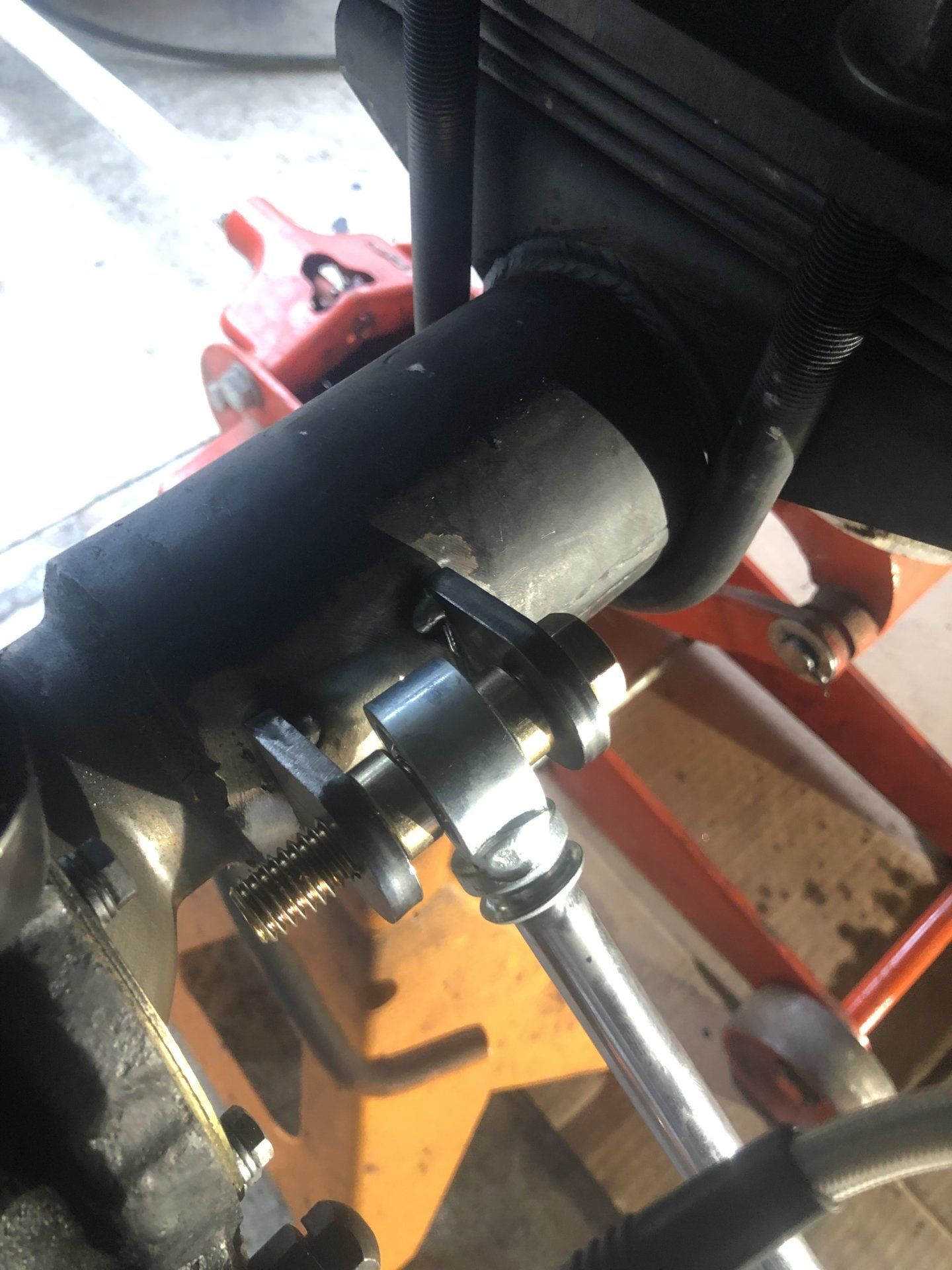

Tack welded the hanger on the axle and turned wheel to check for clearance issues. The grade 8 bolt needs to be shortened and a jam nut used instead of a nylon lock nut.

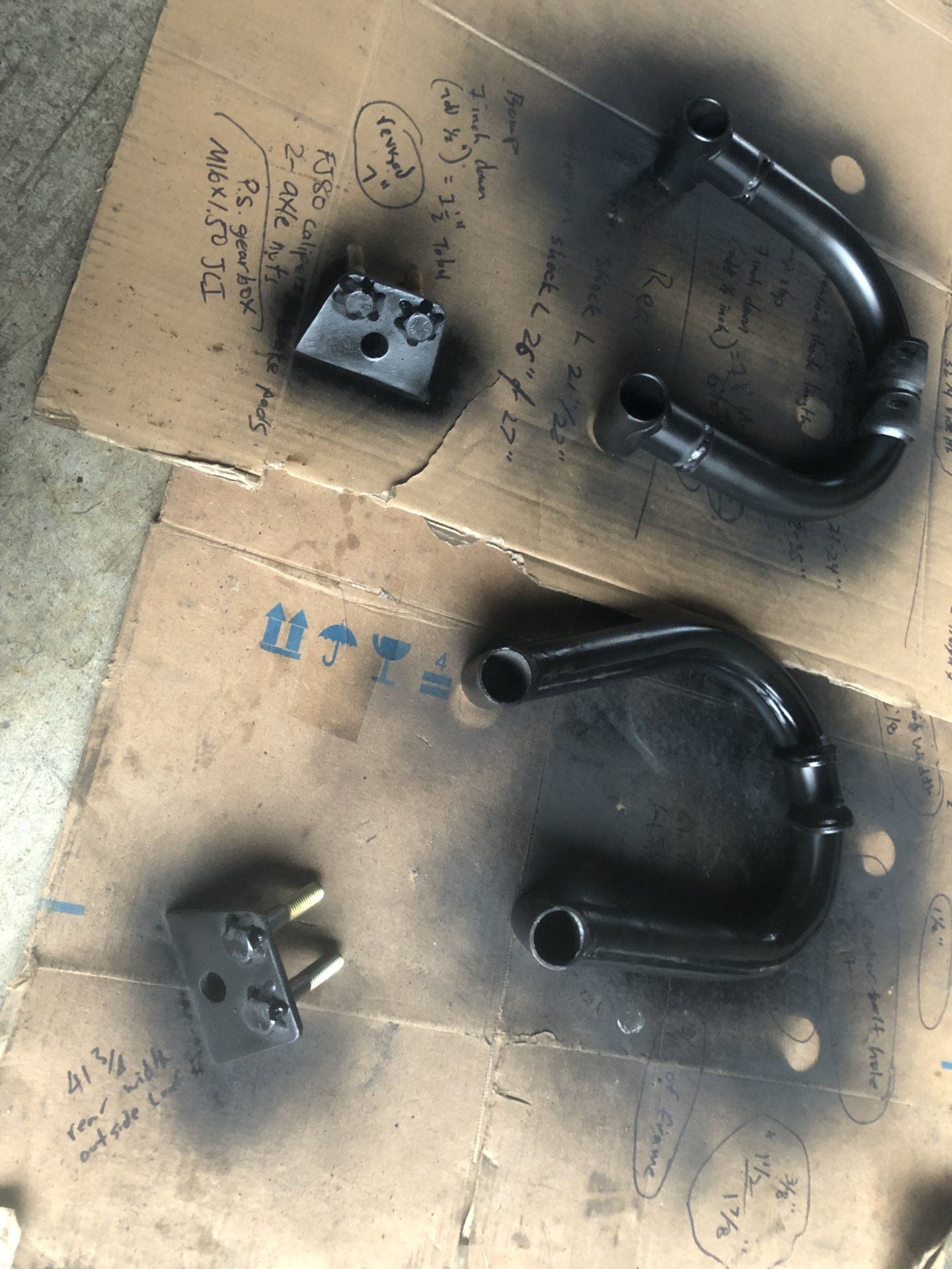

The rear upper shock mounts with two bolt options for shock mounting. Painting and ready for install.

That is not a good way to shorten those shock towers unless you sleeved them. Butt welded tubes with the welds ground down are not going to last.
Why didn’t you do the Ford towers? Would have been a ton easier.
You need a jam nut and shorter bolt for the axle side, the knuckle is going to hit that. Mine is the positioned exactly the same.
The shock body looks like it's really close to the upper shock bracket. When the suspension flexes the shock body will likely move a good 1/2" or more closer to the frame. I see the draw to want to use shock hoops because they look cool and fairly easy to install. I think in your situation though that ford towers would work better for you with less clearance issues and result in a cleaner install. Rough stuff makes a tower that is similar to the Ford tower but ultra beefy, is more expensive too though. 4plus products also makes a cool and beefy set of shock towers that are for Fj40s that u could adapt easily. I try to put my lower shock mount bracket on top of the axle housing to protect it from rocks. Maybe I missed it, but where are your steering stops on the housing? Keep in mind too that when you weld near the knuckle, you run a risk of melting the inner axle seals.

Mike runs the shock hoops on his 60 and they seemed the most easily to adapt. When you have a 60 that’s running the same setup as your doing then why not just try to copy it.

Cool. Not trying to beat u up on your build, just throwing out input from what I see. It's gonna be a fun cruiser. You need to build a mount on your trailer hitch and some hydraulic outriggers and u can use it to drill wells and wheel it .:cool:

I don’t think anybody is beating on the build...:rofl: I like to read others input that’s why we’ve got this forum. I decided to post yesterday’s pictures without it being the end product to get some input. A bit of tweaking the front drivers hoop and it’ll be ready.
Dont forget to put the gusset from the hoop back down to the frame without it you will end up ripping two holes in your frame where the hoops are welded to the frame
