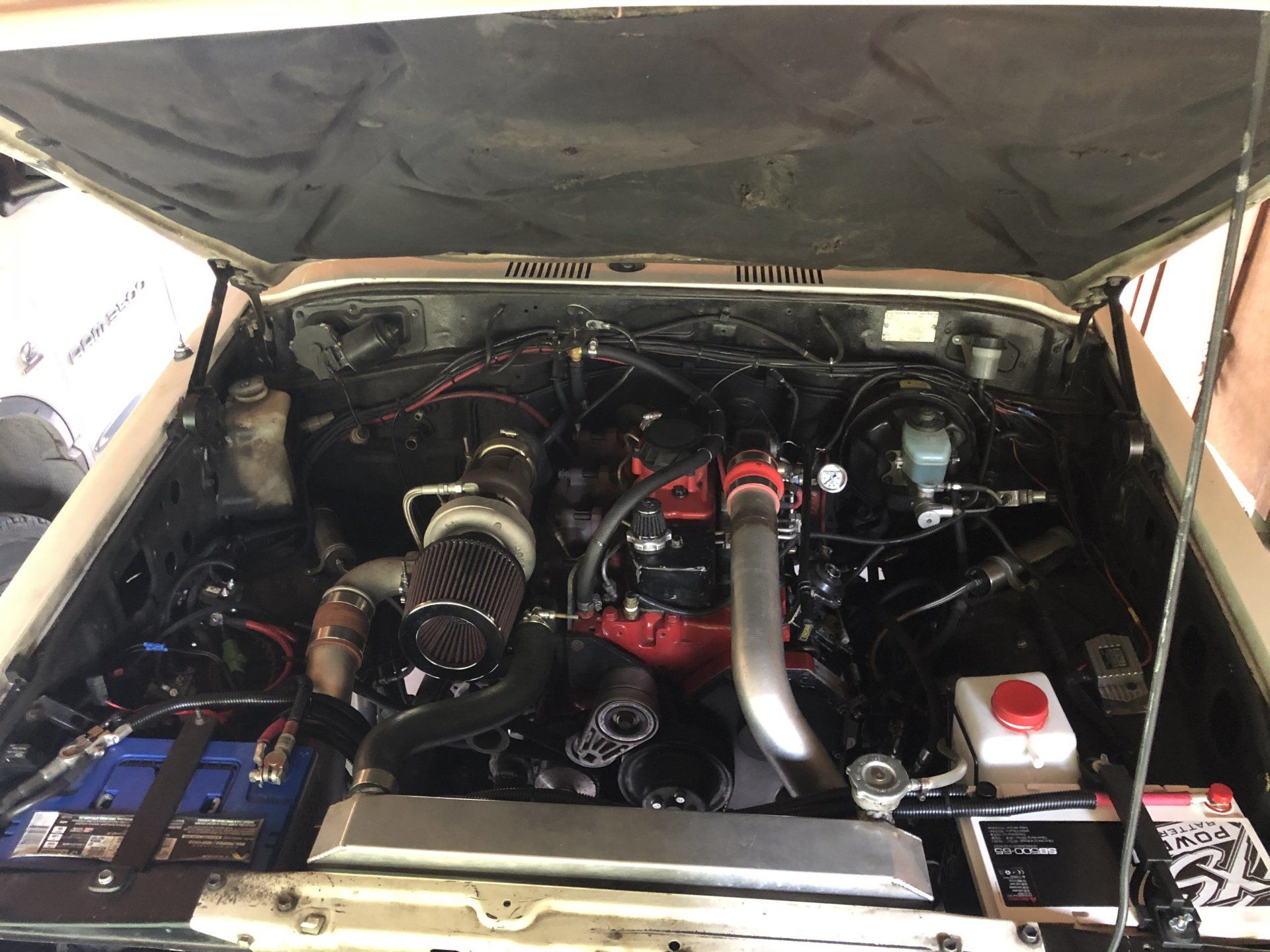

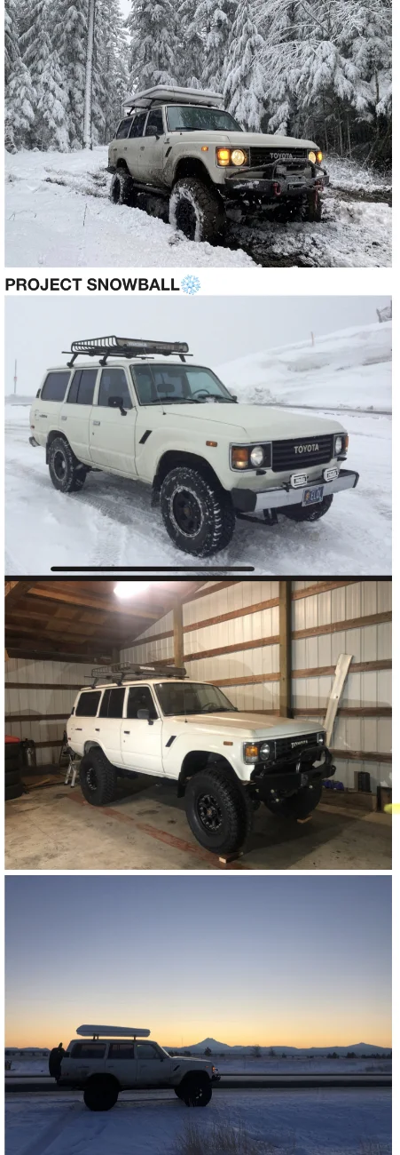

Fellow FJ60 Cummins diesel enthusiasts. I've followed IH8MUD for a couple years dreaming of one day beginning a diesel conversion in my 85 Fj60 Toyota Landcruiser. Yesterday I bought one from my buddy Matt who decided to put a Mercedes Diesel in his Toyota instead of the 4BT. I’m excited and found a NV-4500 5 speed transmission. Looking forward to this build to gain more power, a 5 speed and better fuel economy. Eventually turning this into the ideal overland Landcruiser.

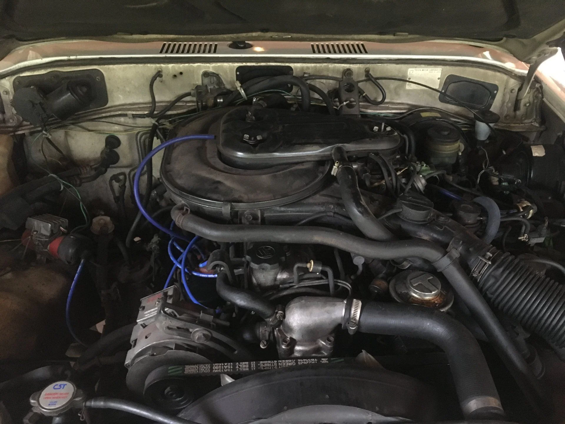

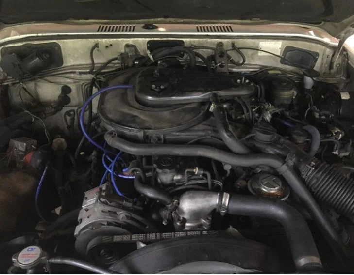

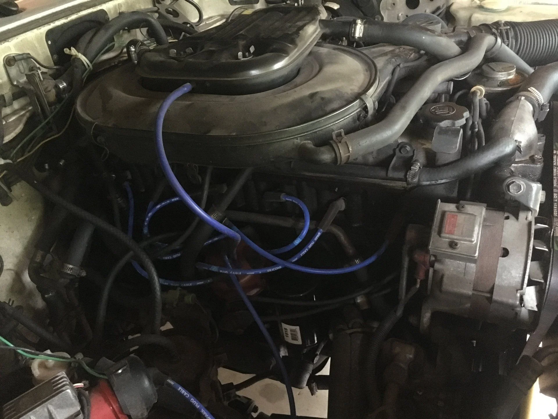

I'm selling my running 2F motor and 4speed transmission. They are still in my Landcruiser here in Eagle Creek, Oregon. If your needing a motor and tranny let me know. I'm getting my nv4500 Friday for the swap. I'd like to sell my 2F and tranny with it running so the buyer knows how it runs.
I absolutely love the 60's series cruiser and am so stoked about the diesel swap. This was last summers trip to Olallie Lake in the high Cascades of Oregon.

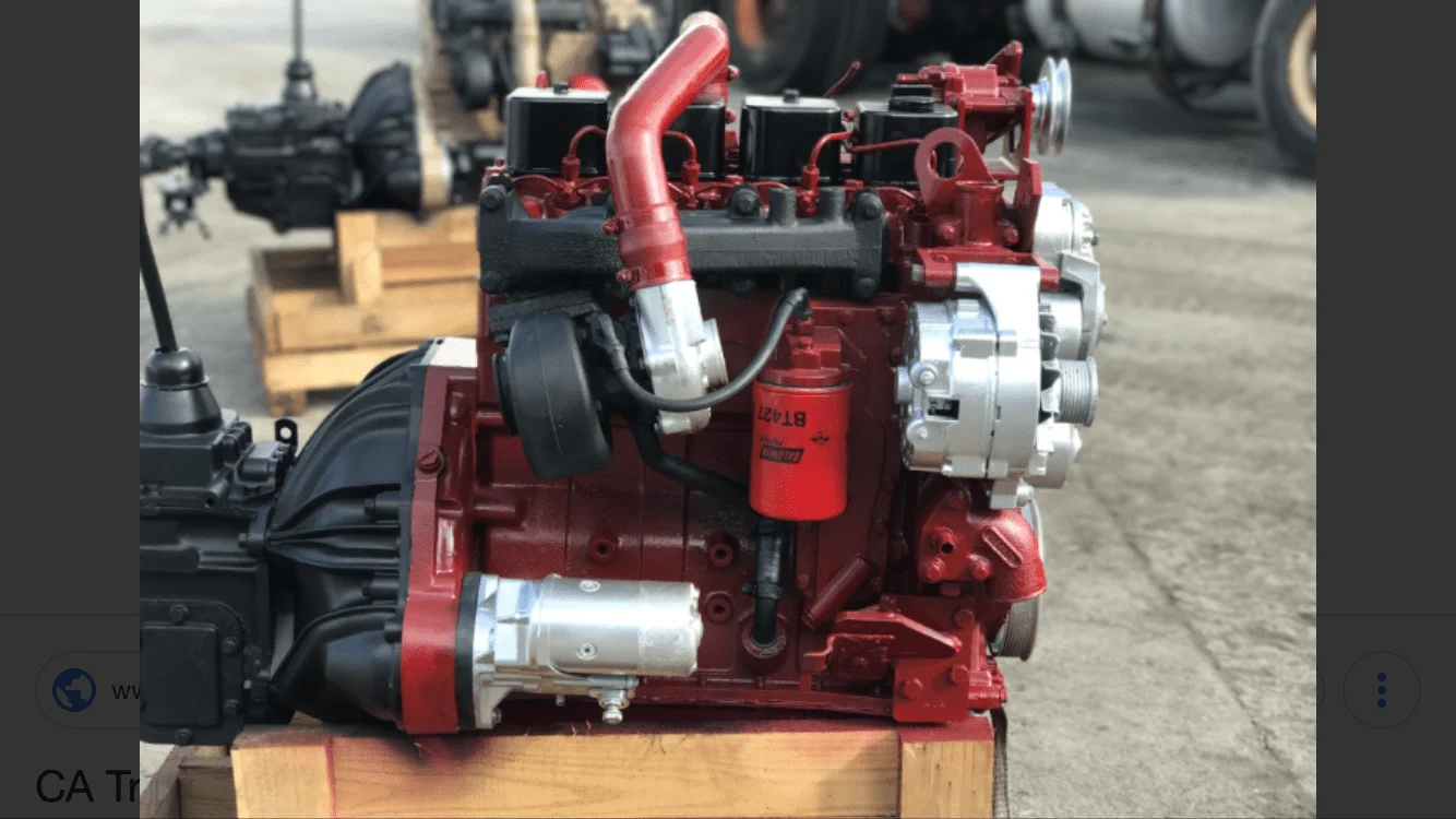

Fellow FJ60 cruisers. I've followed for years dreaming of one day begging a diesel conversion in my 85 Landcruiser. I've been searching long and hard for a suitable donar motor. Every 4bt I found had very little info on miles or maintenance records. Finally last week an ad on Craigslist with a 96 Freightliner step van with a 4bt came up. I went to check it out on Saturday and took the step van for a drive. The motor had a factory cummins rebuild sticker and ran great with amazing power hauling 12,000 pounds of weight. With no smoke or any obvious engine noise I bought the entire step van. It also included a good size tool chest. The seller was a house farmer who used the step van as a mobile tool shed during jobs. He figures he may have put maybe 100K miles on the motor after it was put in. Today was our first day to begin removal of the prized possession. The transmission is a Eaton Fuller 5 speed which works great but am going a rebuilt dodge nv4500 4 wheel drive tranny with warranty and updates and bell housing. I've read a lot of posts on the 4bt swaps but may need some fellow cruiser help. Best part today was we found the motor was rebuilt in 2007 and even cleaner than we'd thought. I'll post our progress. Here is the step van and my 85 FJ60.

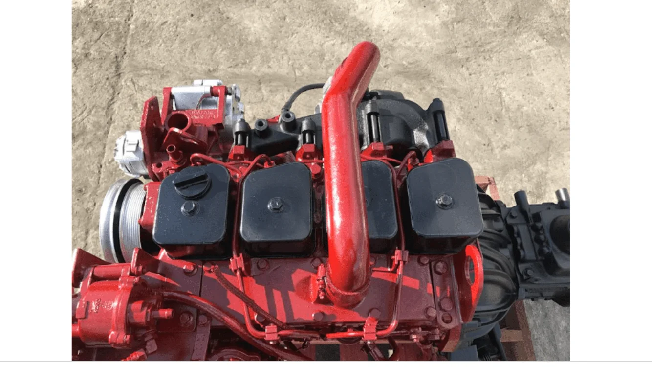

We are going to go through engine and remove bolts and check gaskets etc. I'm thinking antiseize is a great idea for the future ease in bolt removal?
I was also thinking I don't care for the Cummins beige. I do like the cummins red and black. What are your thoughts. Keep it factory or go custom?
Agree with The Phoenician, red and black looks nice. and yes this engine vibrates like no other so be careful where you use it if you do. Are you doing SOA or SUA?

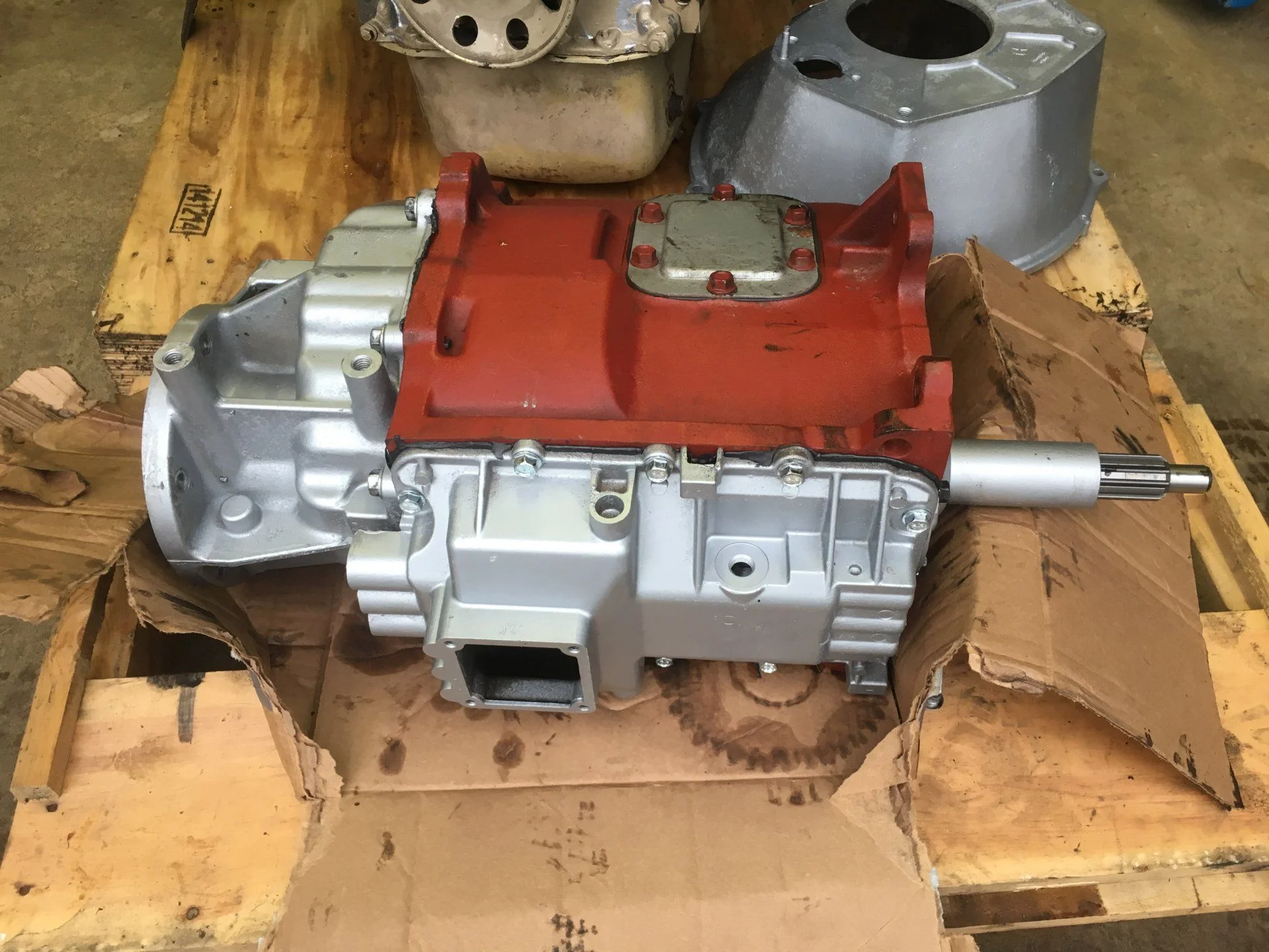

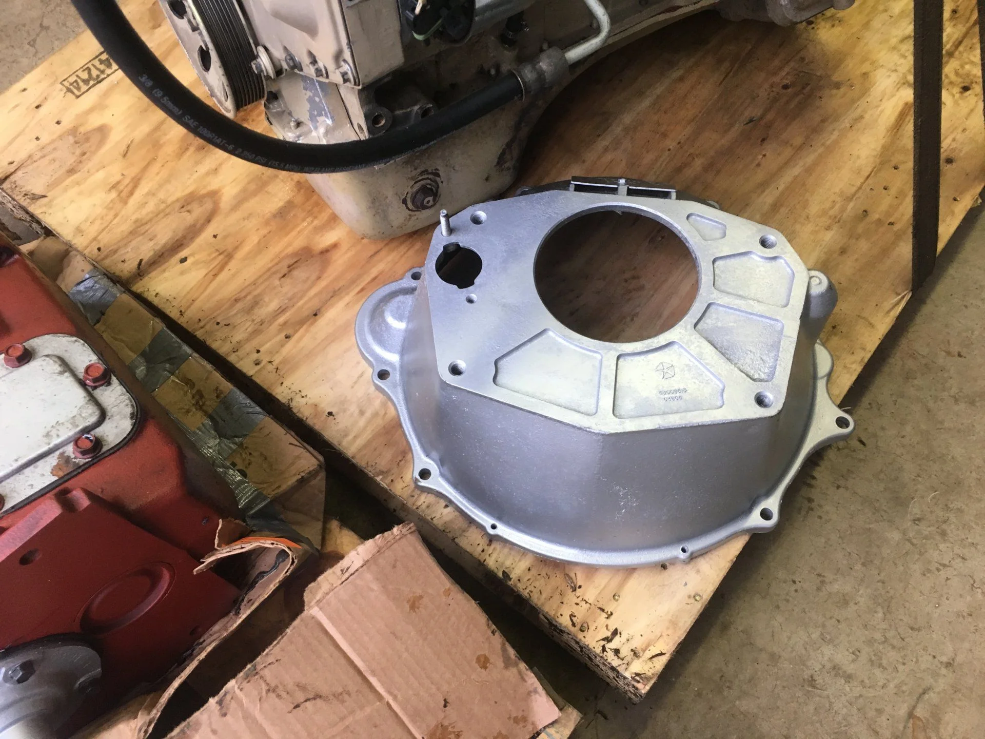

My rebuilt dodge nv4500 and bell housing arrived today. The shop has a year warranty on it and performed updates on transmission, including the 5th gear retainer nut. Have offers on 2F motor. One guy called and said his wife drives a 84 FJ60 and has 2 bad cylinders, he was good with $1000. And another guy called who wants to drop it in a Toyota flatbed truck who said he'd pay $1200. Im showing it to the first guy Sunday who really needs it. The 4 speed is also sold to a guy who has a bad transmission from Seattle. He's paying $500. I'm getting all my figures together to see what my actual cost is at buying the 4BT and selling my running 2F and 4 speed transmission. I'll try to keep track of my costs to allow others who have this diesel swap dream to have some costs.
