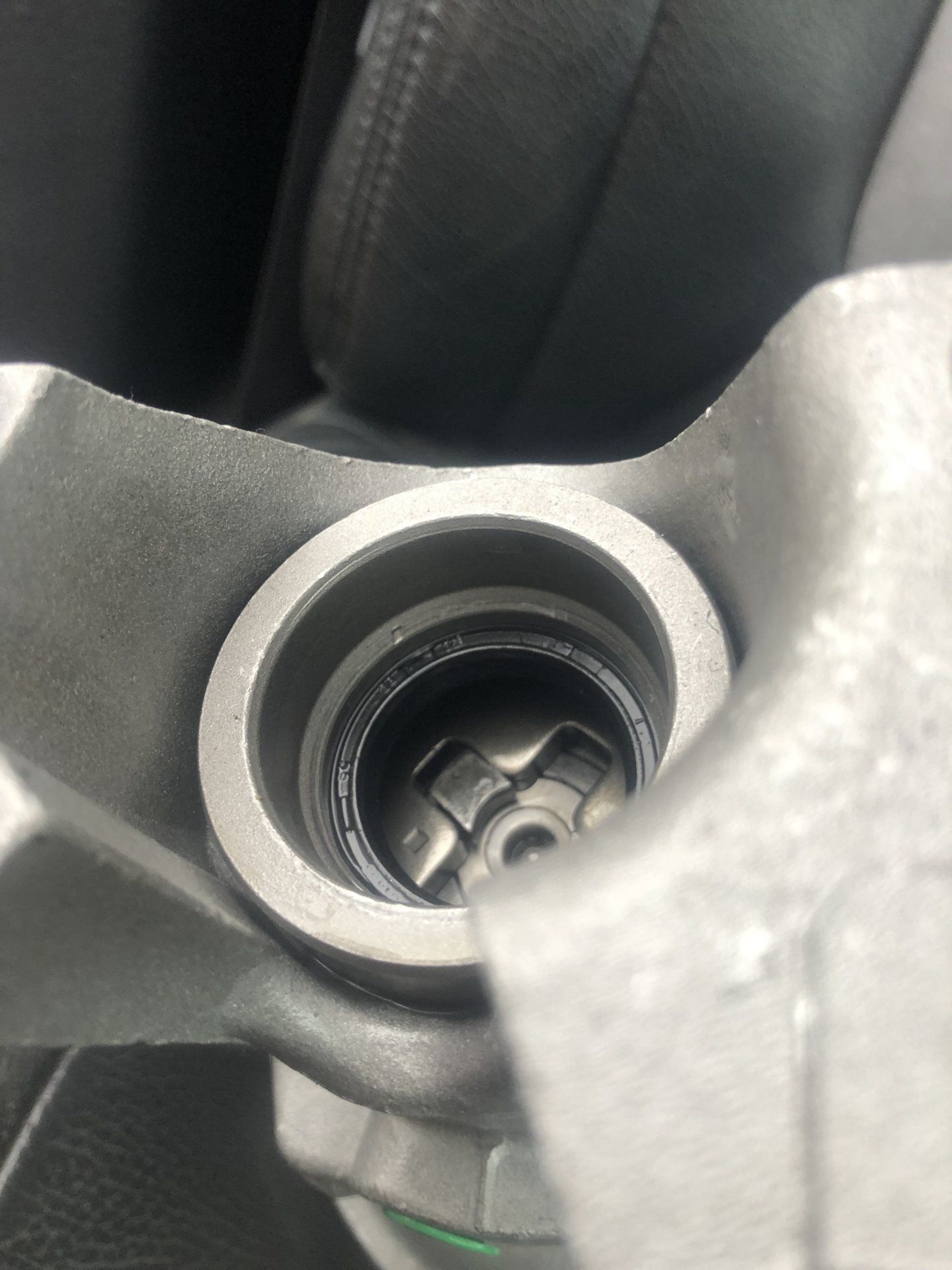

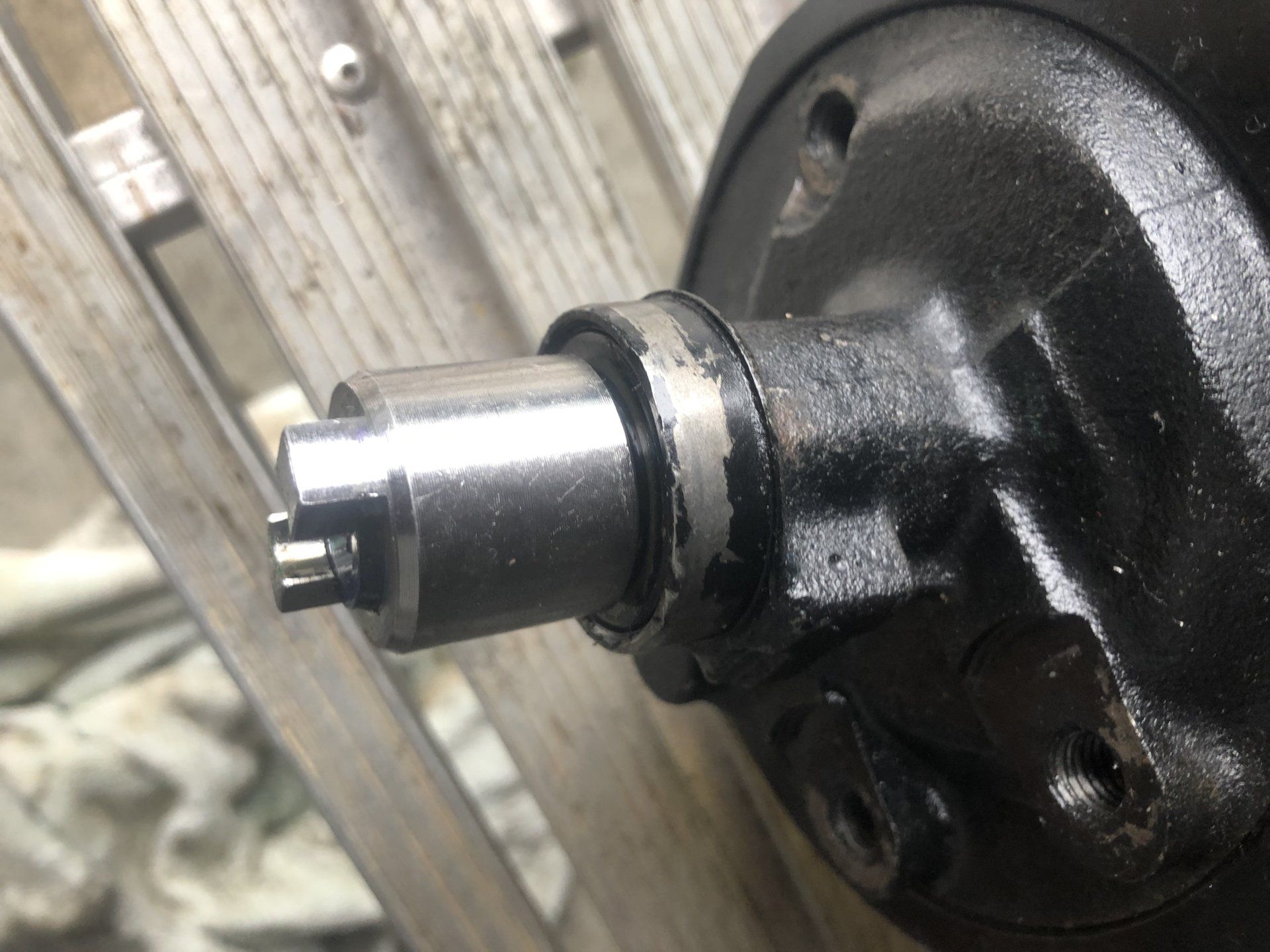

This vacuum pump and power steering pump seal leak is baffling.
1915550
You can see the seal inside the vaccum pump housing. It can slide in and out. When inserting the power steering pump it pushes it forward the front where when we remove the power steering pump it moves and would not seal. It seems like it should be on the outer side of the lip inside the vacuum pump.
1915552
Here marked in yellow. As then the power steering pump would compress the seal against the shoulder of the vacuum pump.

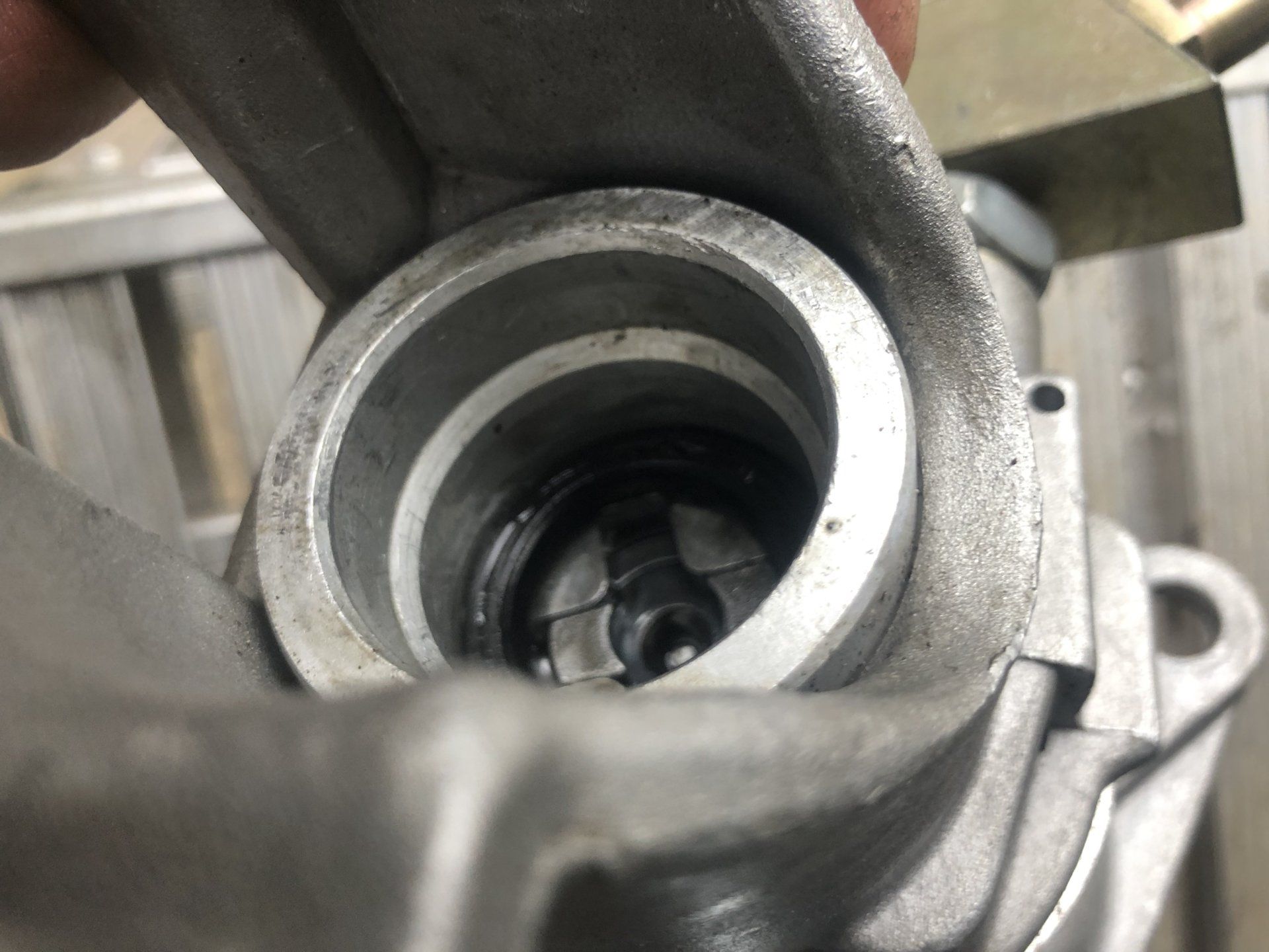

With the seal on the inside it just floats. I’m headed to Napa now with both PS and VP.
1915557
The new Napa vacuum pump. The seal in this one is stationary.

This seal definitely seem like a weak spot as it can slide in thus loose it’s abilty to seal.
