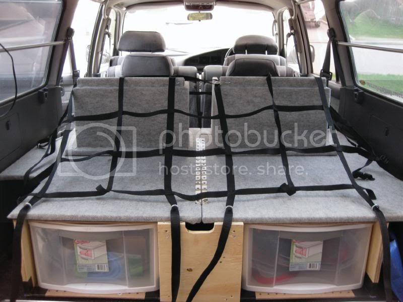

Not quite as pretty as most, but about 3 hours worth of work and about $80 bucks isn't too bad.
There is carpet over the osb that has a flap to hide the draws when closed, also has 2 compartments accessable by tilting the 2nd row seats forward. This is where my Full Size air mattress, sleeping bag, pillow, and D/C air pump are kept, as well as my 10" sub enclosure.
All in all it works well for me, I haul a lot of equipment for work (home energy audits and solar pannel installer) so excuse the mess in the back.
Oh and that's a 6' step ladder on the right, so you can see that streching out is no problem (I sleep with my head at the tailgate)

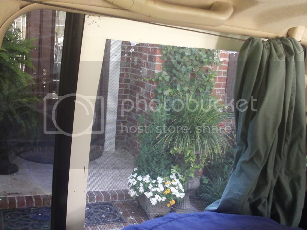

I made window screens and curtains aswell.

hey landcruiser4ever, got more shots of your screen? whadya make it out off? is it a stiff frame that you slid in? didn't get a chance to make mine this summer, i got the monsoon windows so i could maybe make a half screen and have half the window up....
I made my screens out of a 1/8 inch thinck plastic roofing peice cut two inches wide and glued screens to them, its a flexible rigid frame that bends into the window slips, I have about $8 invested in them and used them a few times, no problems so far. At some point in life I would like to get those fancy ones that mot sells but these are fine for now. Ill see if I can find some more pics for you and PM them your way.
gr8! thanks!
