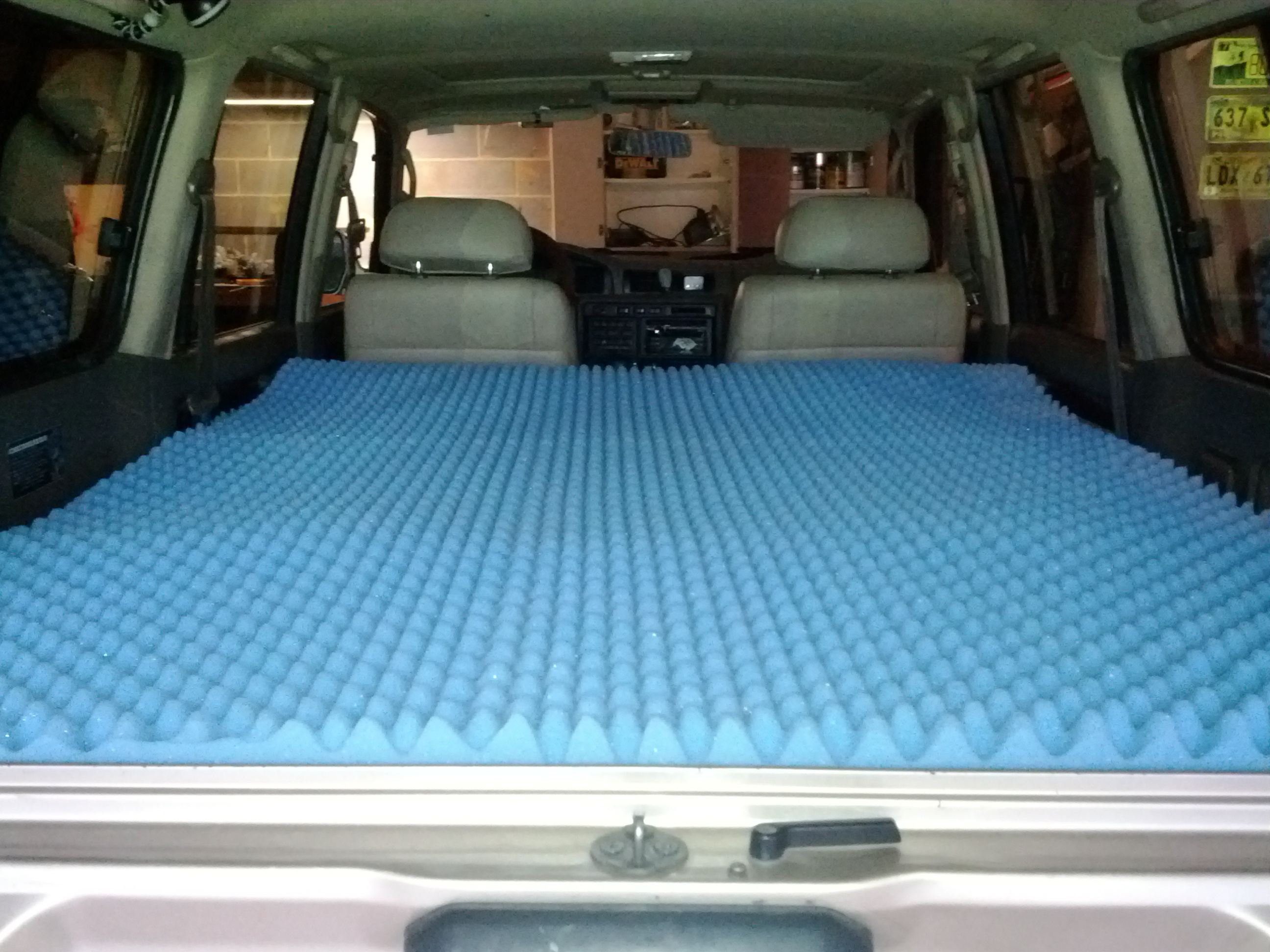

I tried to keep mine as cheap as I could and so far I think I have about 150-175into it. I also have 2 cattle dogs that love to wander around the back end so carpet seemed the way to go for them. (pics are without carpet)
It's not finished yet, it needs tiedowns, locking setup, camp kitchen etc. It all comes apart and you can mount a single seat in the middle row, or both seats and leave the back storage in place. We can fit a full size air mattress on top and the dogs can sleep in the front seats.

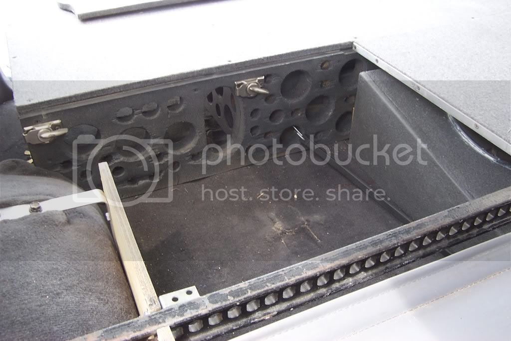

Here is my drawer system / sleeping platform. I bought everything I used to built this cabinet system at Home Depot with the exception of the runners for the drawer system - they are 500 LB runners. I had every piece of wood cut to length at the store so when I brought it home I really just had to assemble it.
It was amazingly inexpensive to build and very simple. It is solid as a rock as the whole thing is put together with 3/4 inch marine plywood, decking screws and wood glue. It has an extension that folds over the back seats when they are folded forward. It simply lays on the seat backs. When not in use, it folds back in place and is secured with a latch. Because of the simplicity of the build and the low cost I have been intending to put a build thread on Mud but haven't gotten around to it.
I built the drawer system to carry my tools, recovery equipment and extra parts. I built it as a sleeper so I would have the option of using a rooftop tent or simply sleeping in the vehicle. So far I have used it during mule deer season as I hunt in the middle of nowhere in West Texas. I am 5'10" and I can sleep with my legs completely straight and room to spare with the back closed.
I don't use a blow up bed because it makes it impossible to sit up. I bought padding that makes it feel as good as a bed. Keep the height in mind when building your drawer system or it will become a major hassle to get in and out of the sleeping area.

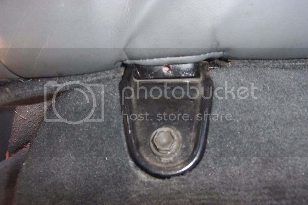

Hinges removed from front 2nd row legs to lower front edge of 2nd row seats 2 inches.
Solid and lightweight at 42lbs (not including tools). The entire set up (hi lift, tools, and anything else) is secured to the floor/wheel wells, but easily unfastened and removed.

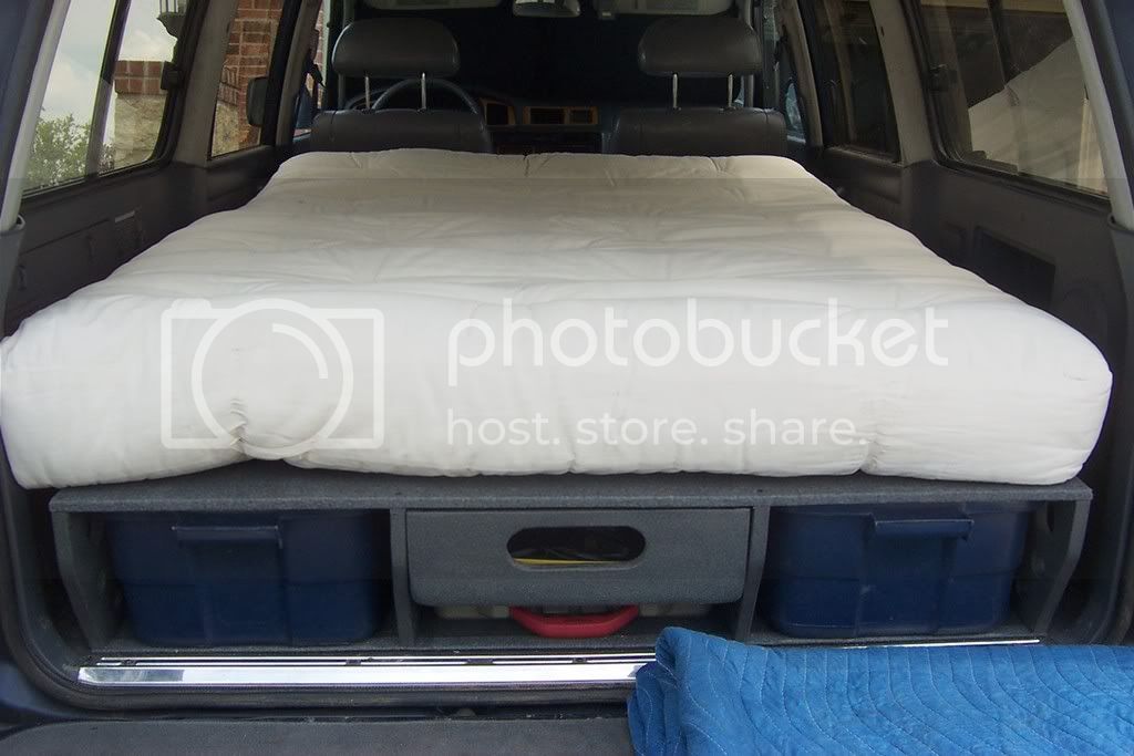

Here's the platfom I built for the back of our 80. Fits a queen size futon mattress with room to spare:

Very nice setup!! 3 questions:
1) Do you the interior dimensions in the back of the 80? You say it fits a queen mattress, but the only dimensions I've been able to find show it's only 58" wide.
2) Do you have the plans for this setup? I'm looking at installing/making something like this myself. (if its somewhere in the tread, my apologies!)
3) are you able to fold the rear seats up with the drawers in the back and remove/store the back half of the platform when not in use?
thanks!
