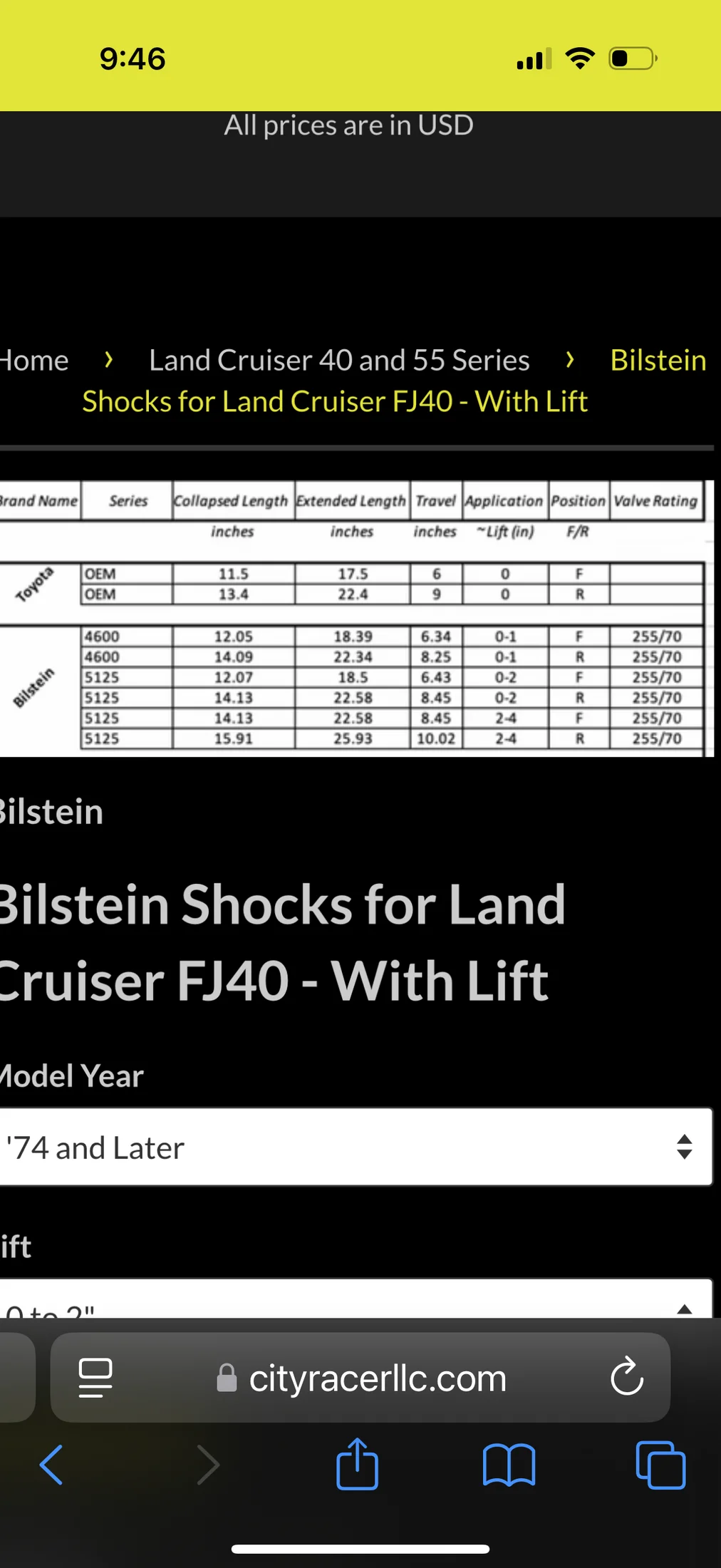

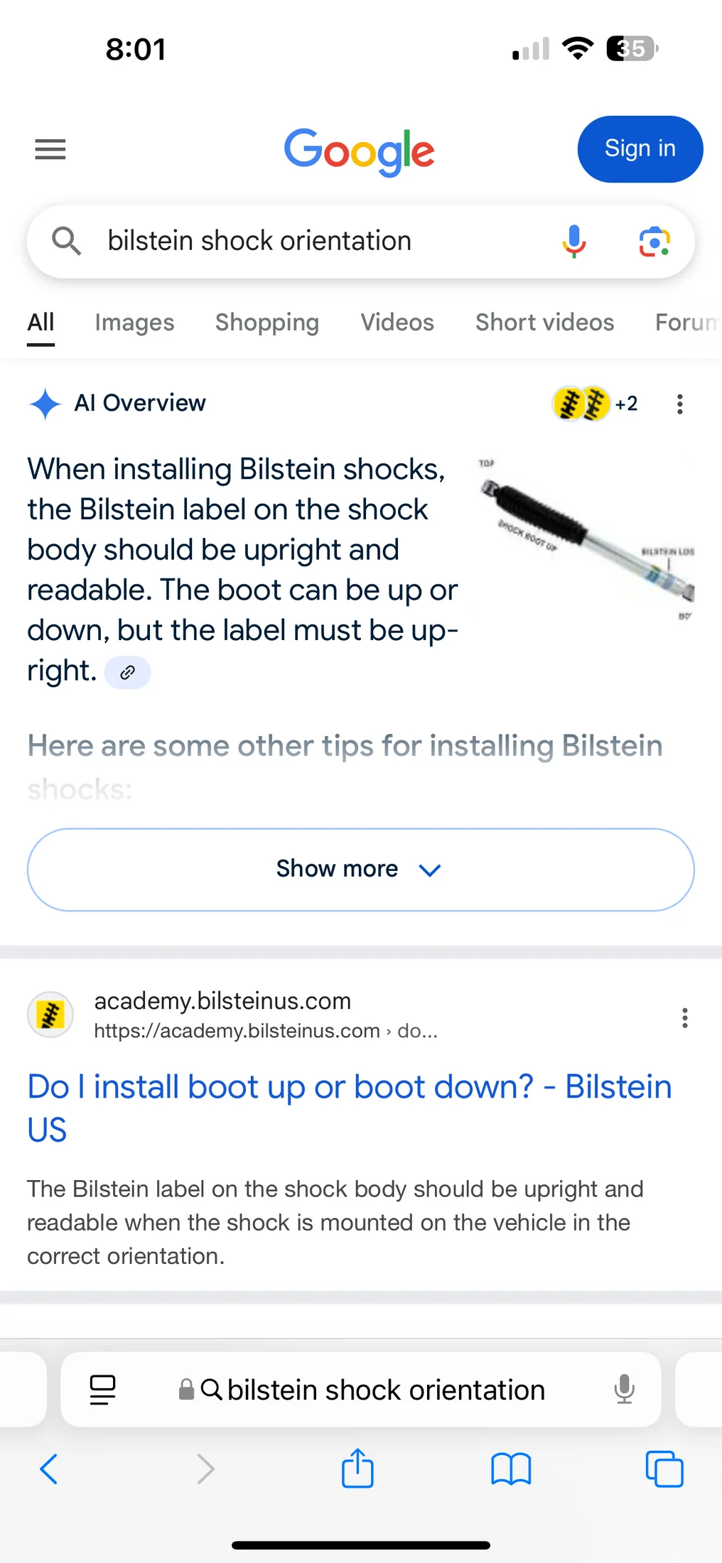

Not gonna make any up travel difference, but I think they are upside down.
I’ve found conflicting information on that but then there’s this

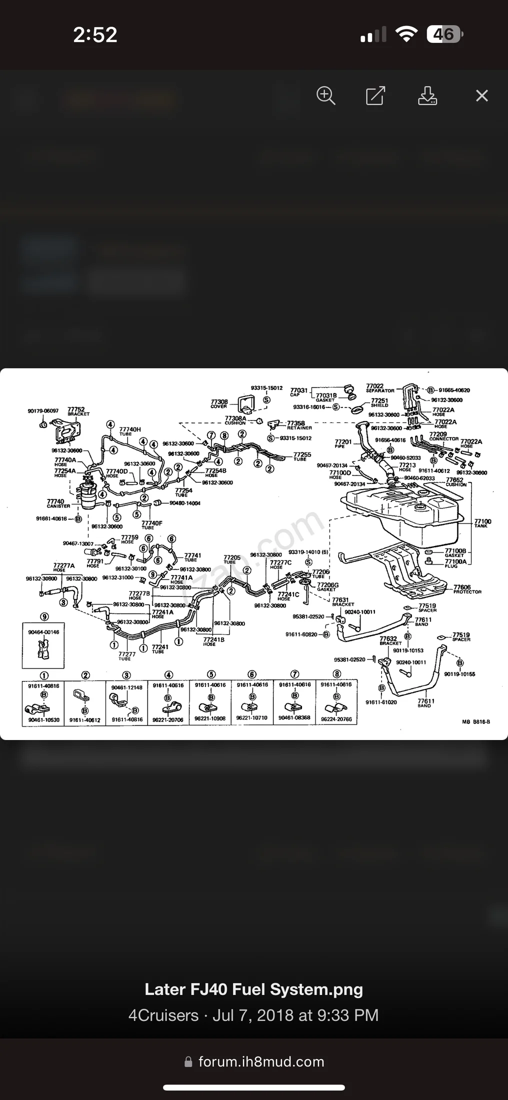

top left is the fuel line pickup assembly
bottom middle is for the fuel level sending unit
Okay. I’m excited to get the body back on but need to sort out this fuel situation. Finally got the new tank. Sending units are easy to find. The fuel pickup is another story. I don’t think I can salvage the original, so much rust. Any thoughts on alternative solution? Am I missing some obvious source or keyword search. I found this with the part number 77206 but seems to be discontinued. Planning on reusing the electric pump from PO.
The answers i’m finding on similar pests are, find a part out, make your own…
If you're planning on using an electric fuel pump, the pickup should be available from the same manufacturer, or shoud be one of the manufacturer's recommendations. There is no reason to obsess over OEM parts if you don't have an OEM system.
I tried looking all over for alternative with mine recently - gave up. How rusty - my was bad too but cleaned up nicely. DM or post a picture of it.
EDIT: post pict of what mine was like
I don’t think you’re familiar with a Japanese supplier called tosshin.com but their site shows 19.86 usd and the part number is 77240-60050 for the pickup. You could reach out to them and have them verify stock.
