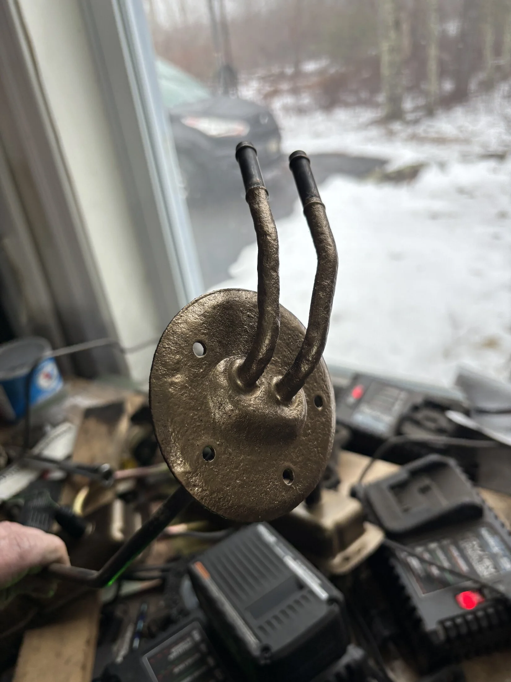

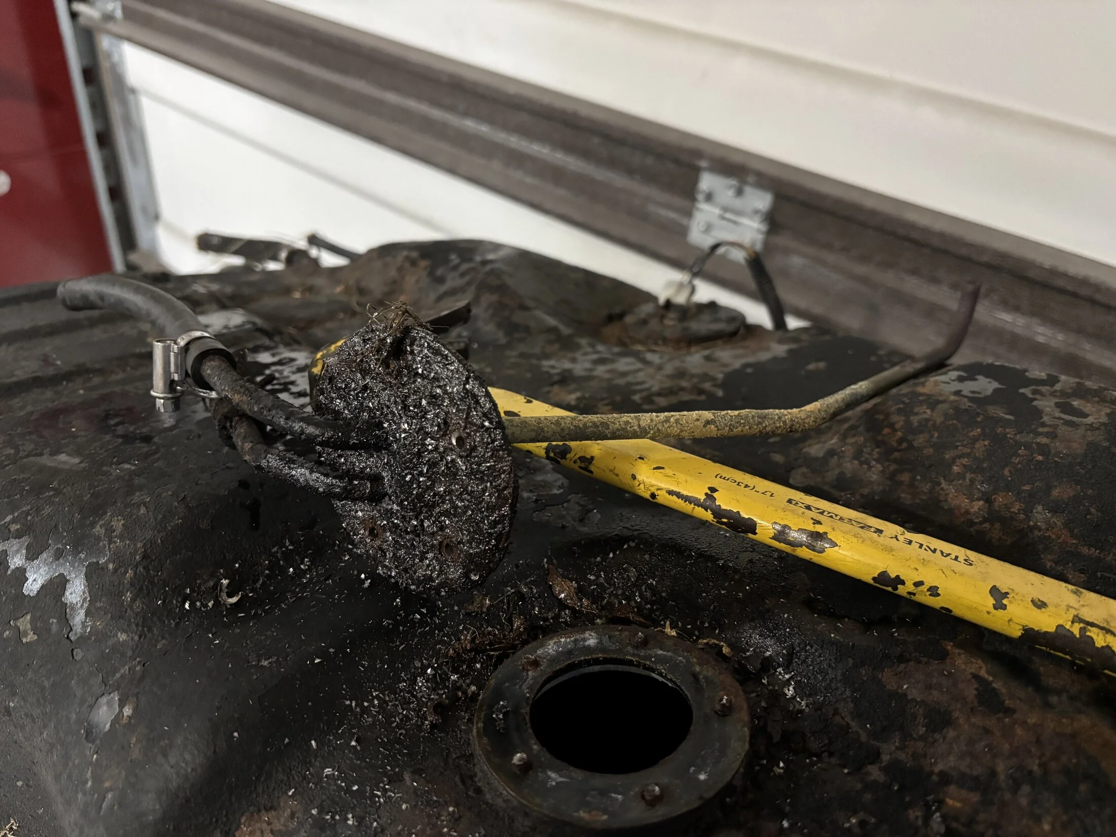

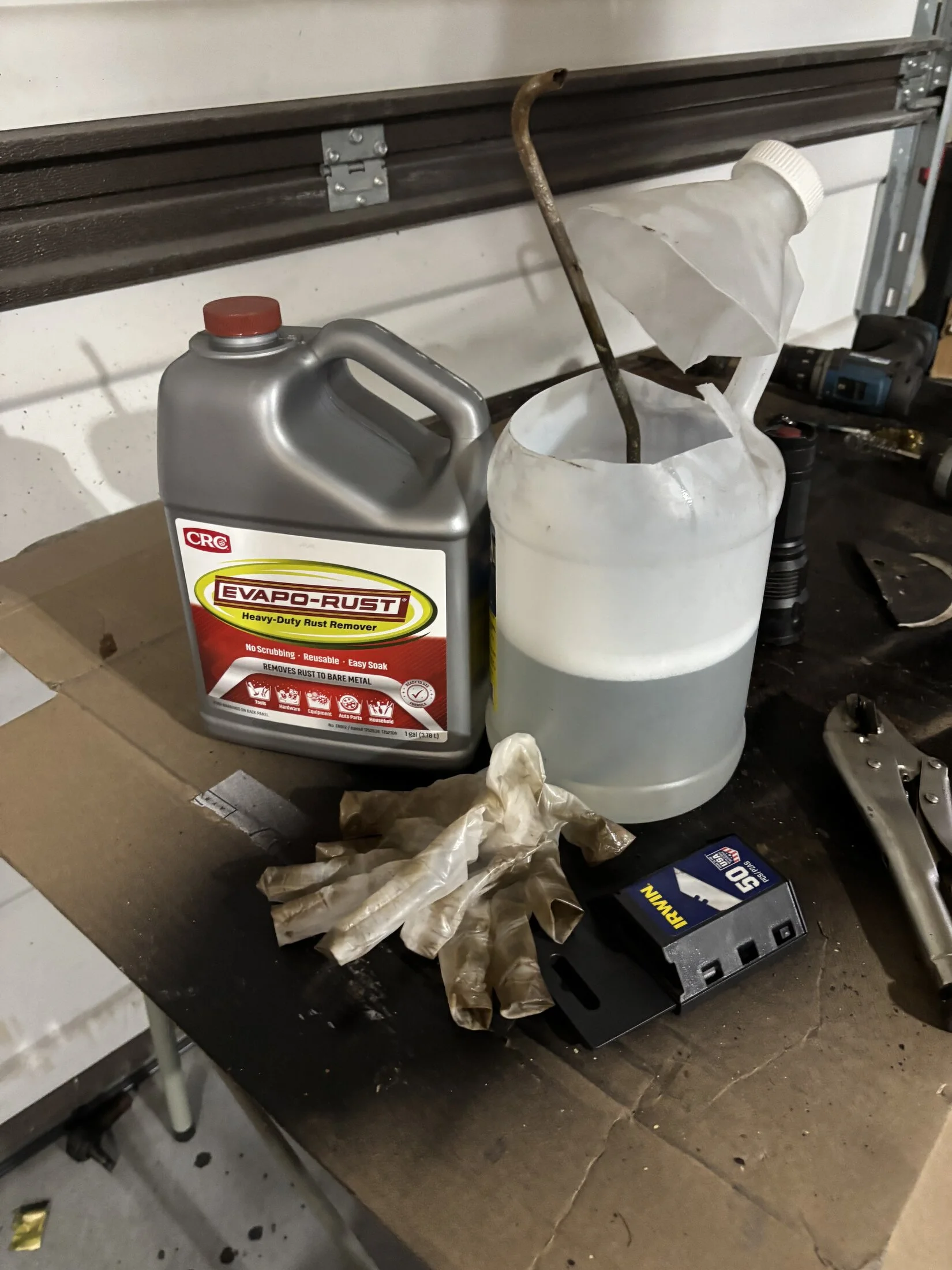

If the tube is rusted near the top in the tank, fuel will likely not make to the carb. I'm sure you could attach some 1/4 or 3/8 ID copper tubing to make a new one. Low temp silver solder or gas tank epoxy puddy
It is just a suction tube - don't go wild with a wire wheel etc. It was tedious - if you have evaporust - that would take some of the labor away - then can do fine sanding if needed - IE Emory cloth. and yeah like @charliemeyer007 said - make a different one and get hose to fit the end - those ends are 7.6 mm ID for hoses.
I just started putting my hoses back in last weekend (tank too). These 79+ tanks are a PITA to get in.
EDIT: Do you smoke or know someone who does - have a smoke machine? - plug one end and put some smoke in the other. My friend in KC did that with my carb - not going to tell you what he was smoking, but it worked. we found the problem.
Another option:
I would try cleaning it up first like already suggested. Soak it in vinegar for a while and see what you have.

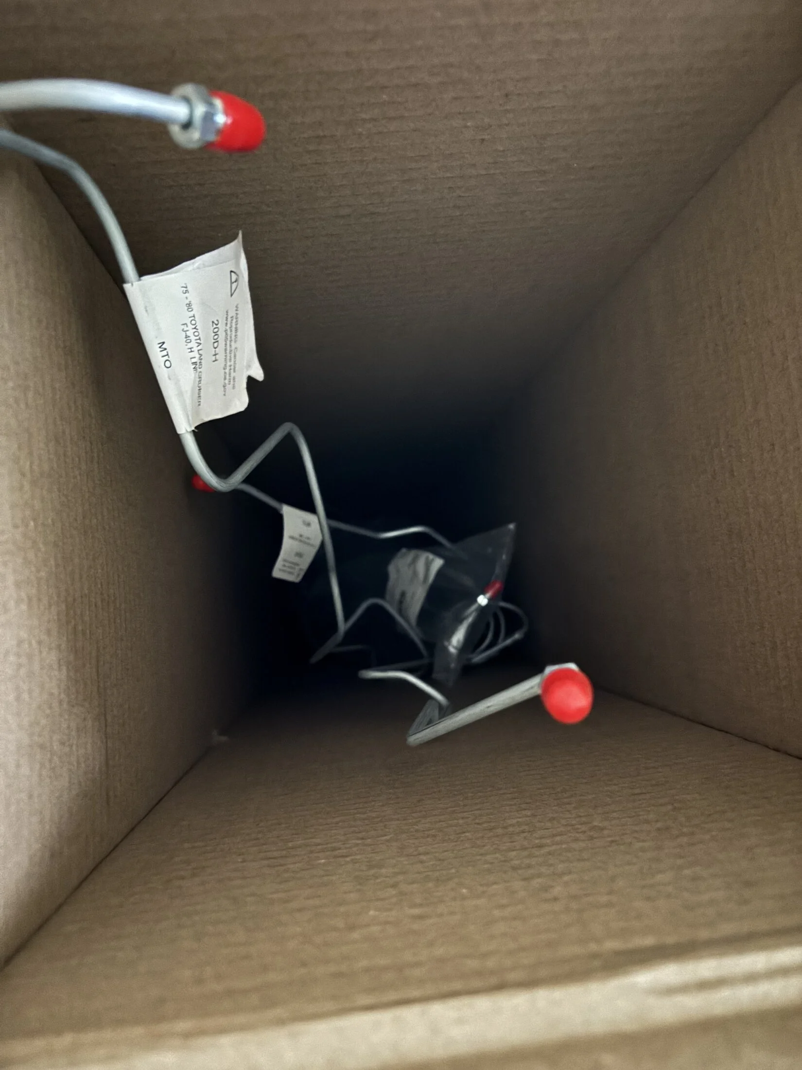

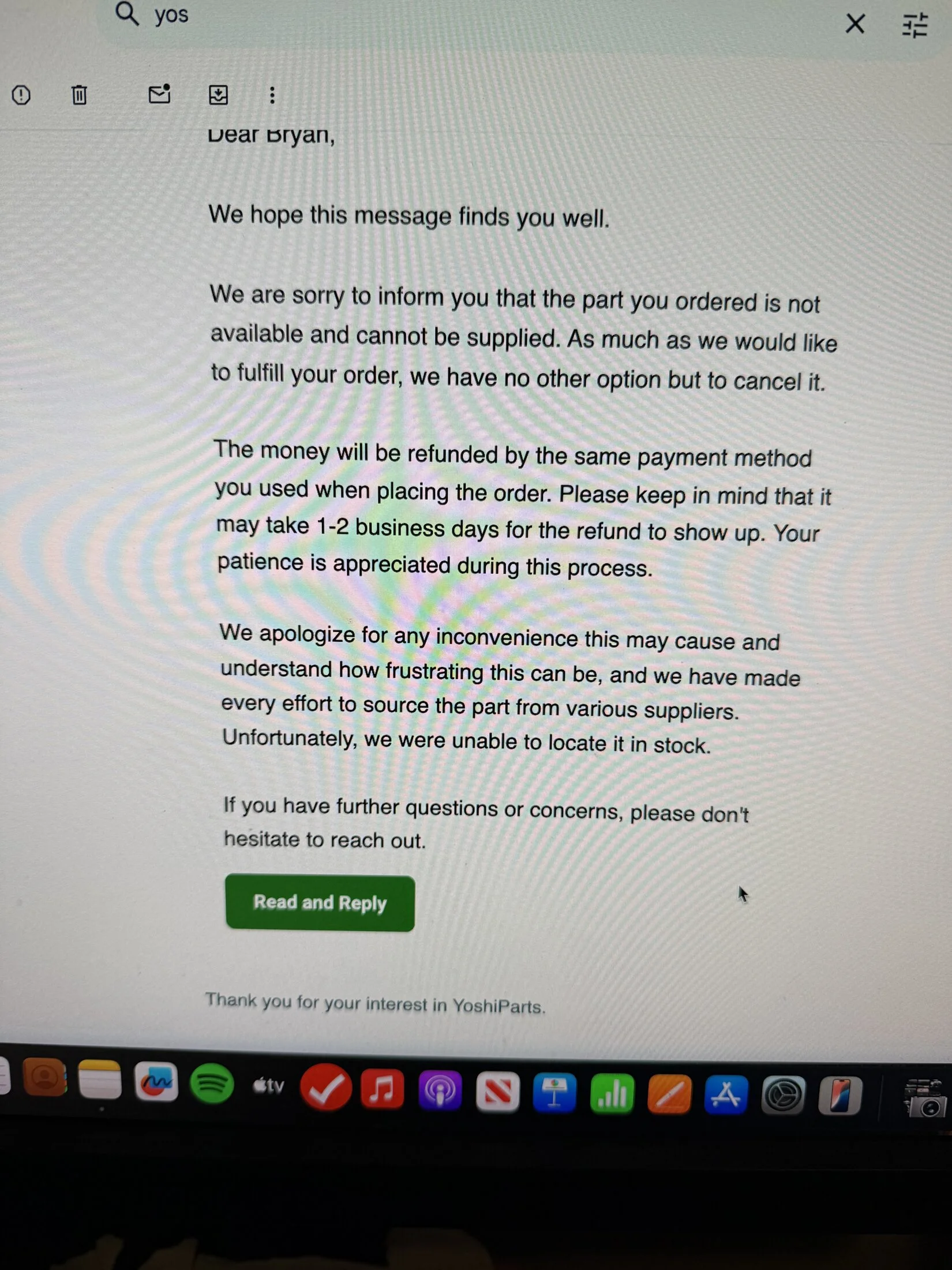

I tied them early Dec as they said they have it and 5 days later got email saying they don't and canceling it...
I caught that and updated the link to a different vendor. Has anyone tried the fj60 pickup, it’s available and looks similar.
without putting them side by side, I'm thinking the 60 one isn't long enough. the 40 tank is deeper/taller than a 60 tank
there are good used ones available.
Well I’ll try to use this
Wow - somehow, I think the patient will pull through.

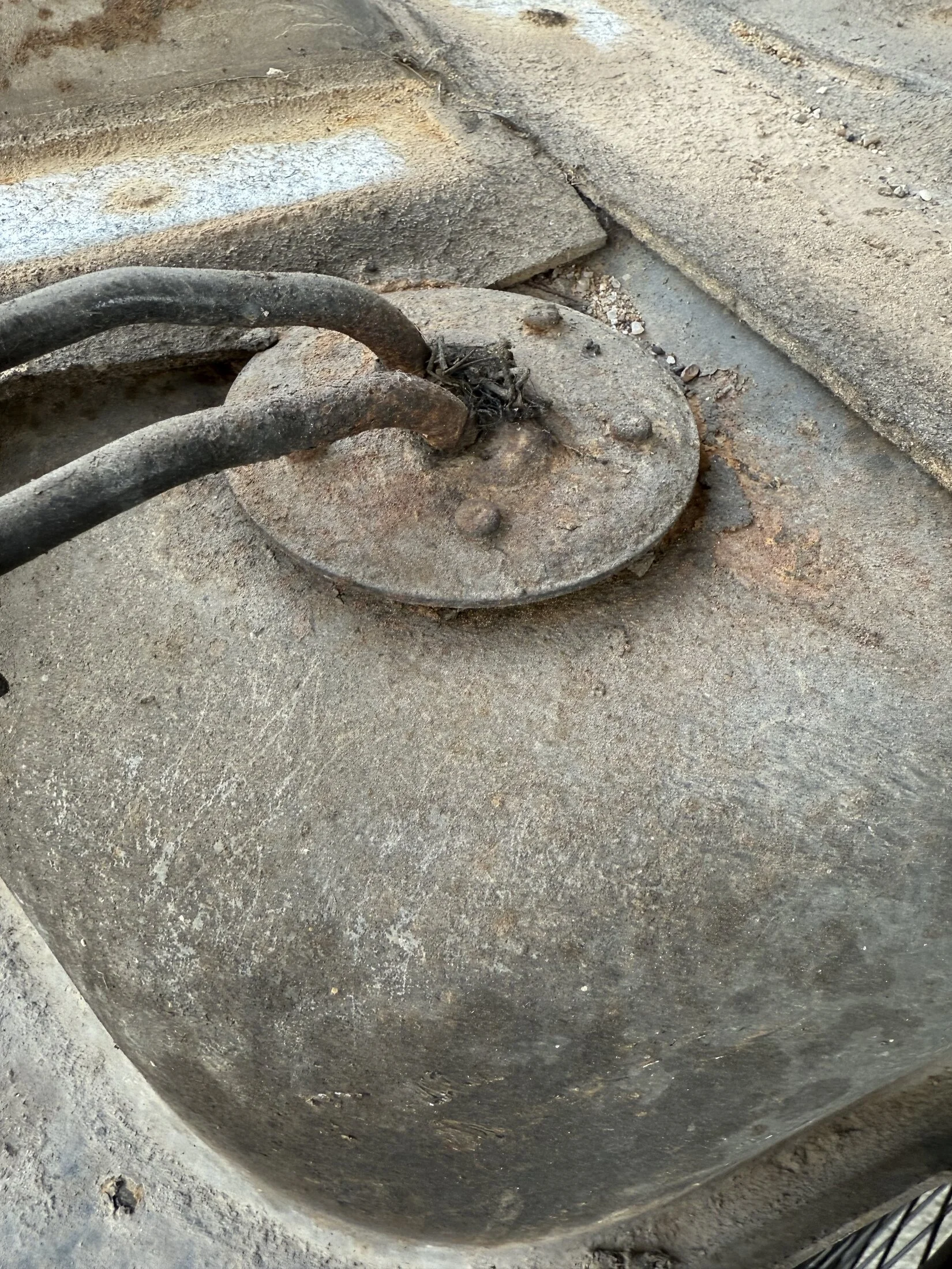

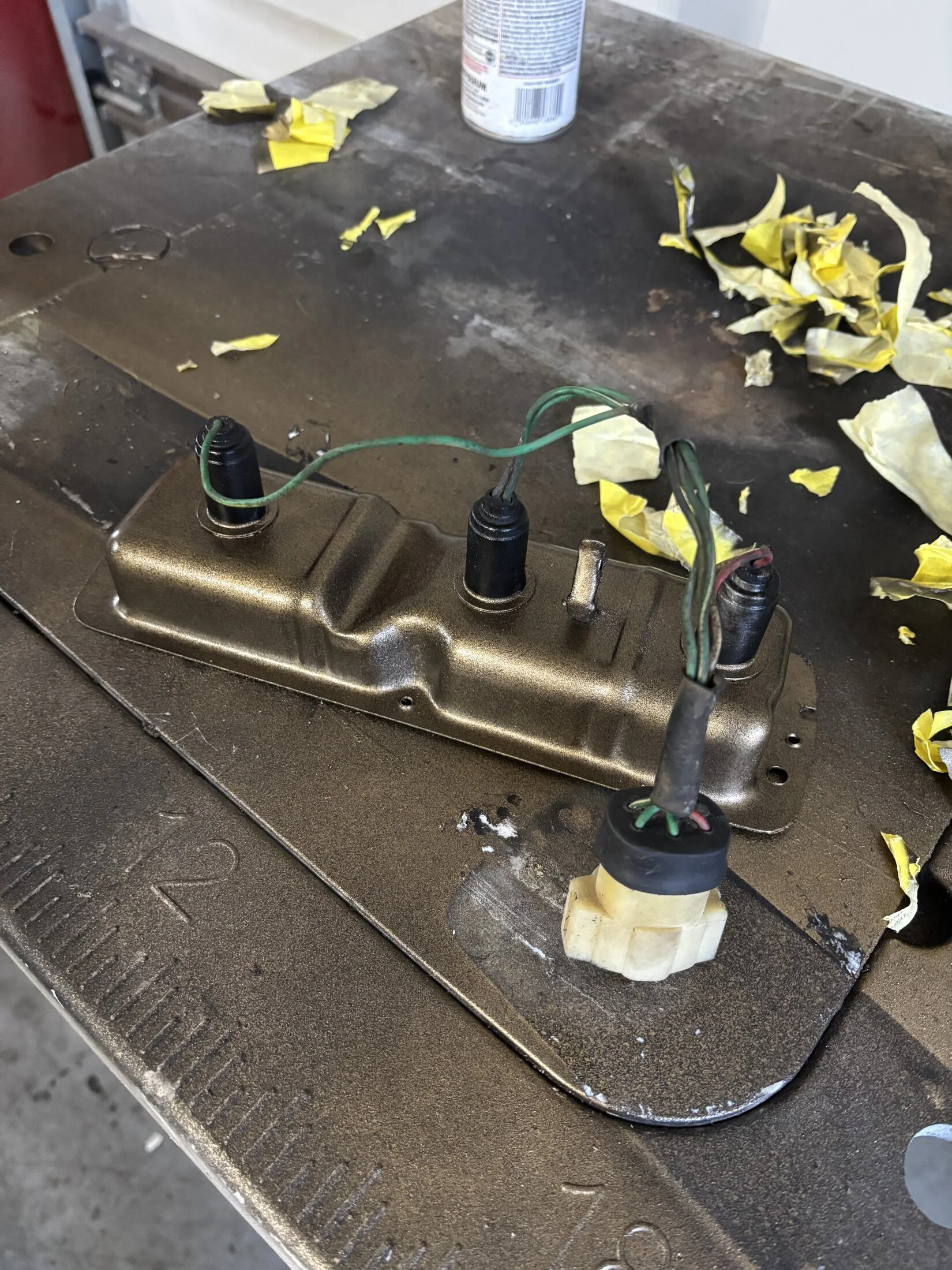

with the sending unit, my connects were corroded, pins/wire brittle, etc - redoing the wire harness - will post picts on my thread over the weekend after install etc of the new wiring. Got the connectors from coolerman - but oddly enough not for the fuel tank, just worked out that way
