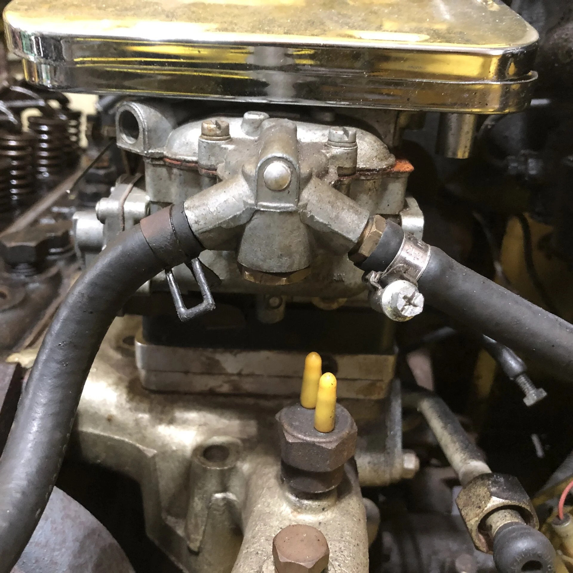

checkin my fuel delivery. So, the left side line is from the electric pump and the right side is from the tank not sure why PO did this. All the photos I’ve seen of 40 engine bays only have the one fuel line. Thinking of eliminating the old one from the tank and solely use the electric line.

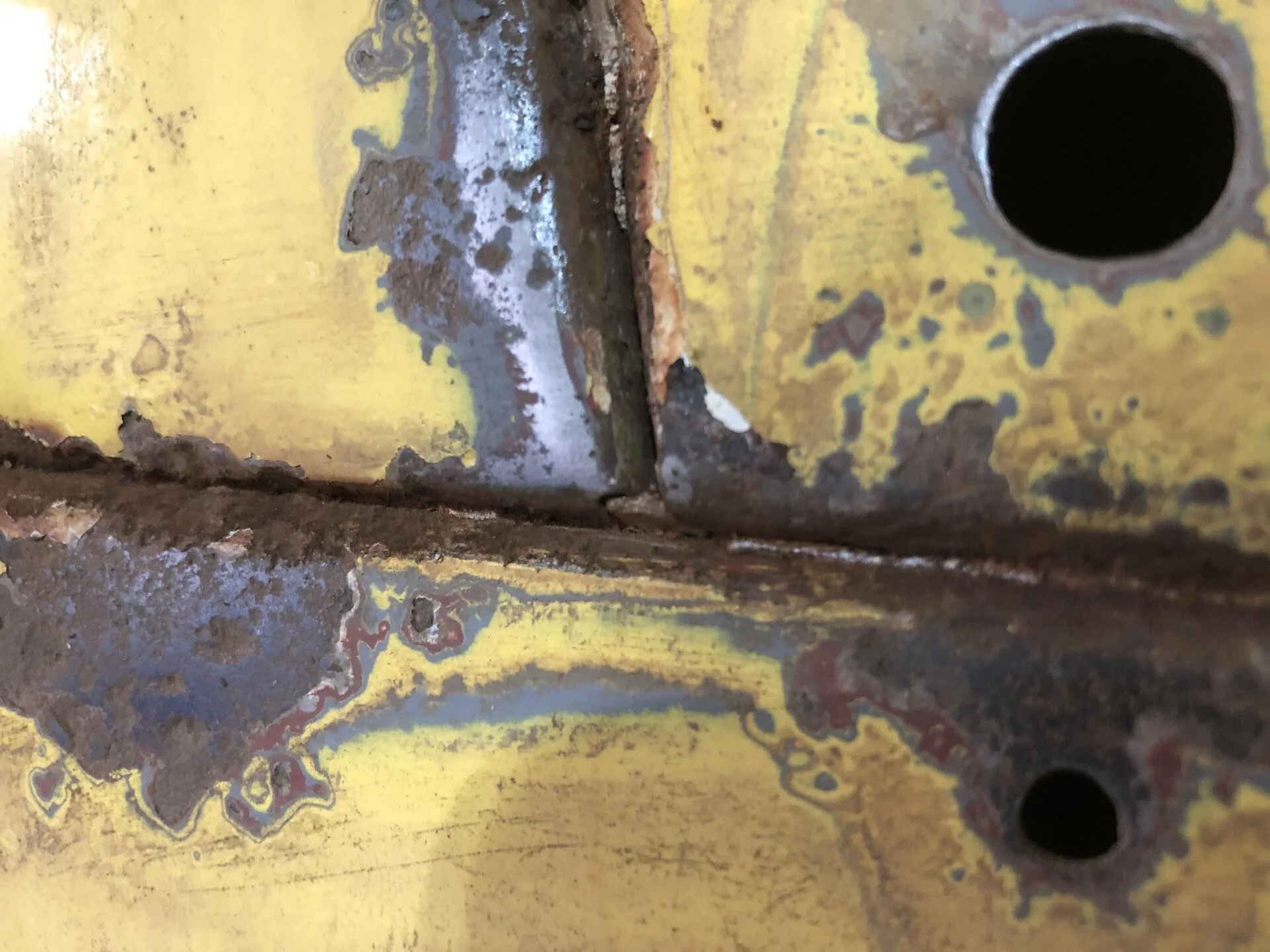

On these body joints I’m digging out some kind of joint compound from the previous resto job (pass side at antenna). Did these come factory with a joint compound or is this some body shop trick of the trade?
anyway thanks for the insight!
One fuel line could be a return line. The factory used seam sealer. I guess those pics are from or near the cowl. The seam where the windshield meets the cowl can leak. There's a lot of info around here on using 2 part and single part seam sealer. You might try using the search.
Thanks! Wasn’t aware of seam sealer regarding joints. Will definitely research this topic!
late 1979 which from the pics above look to be what you have,
the return to tank line should be at the fuel pump on the engine,
the earlier 2F's had a return from the carb
hard to say what a PO has done.
Very true!
Sorry to be lazy I didn’t research this. Having the return at the carb vs the engine pump, will that cause a negative effect?
Very true!
shouldn't be an issue as that was how 75-78 2F's ran with the return from the carb.
