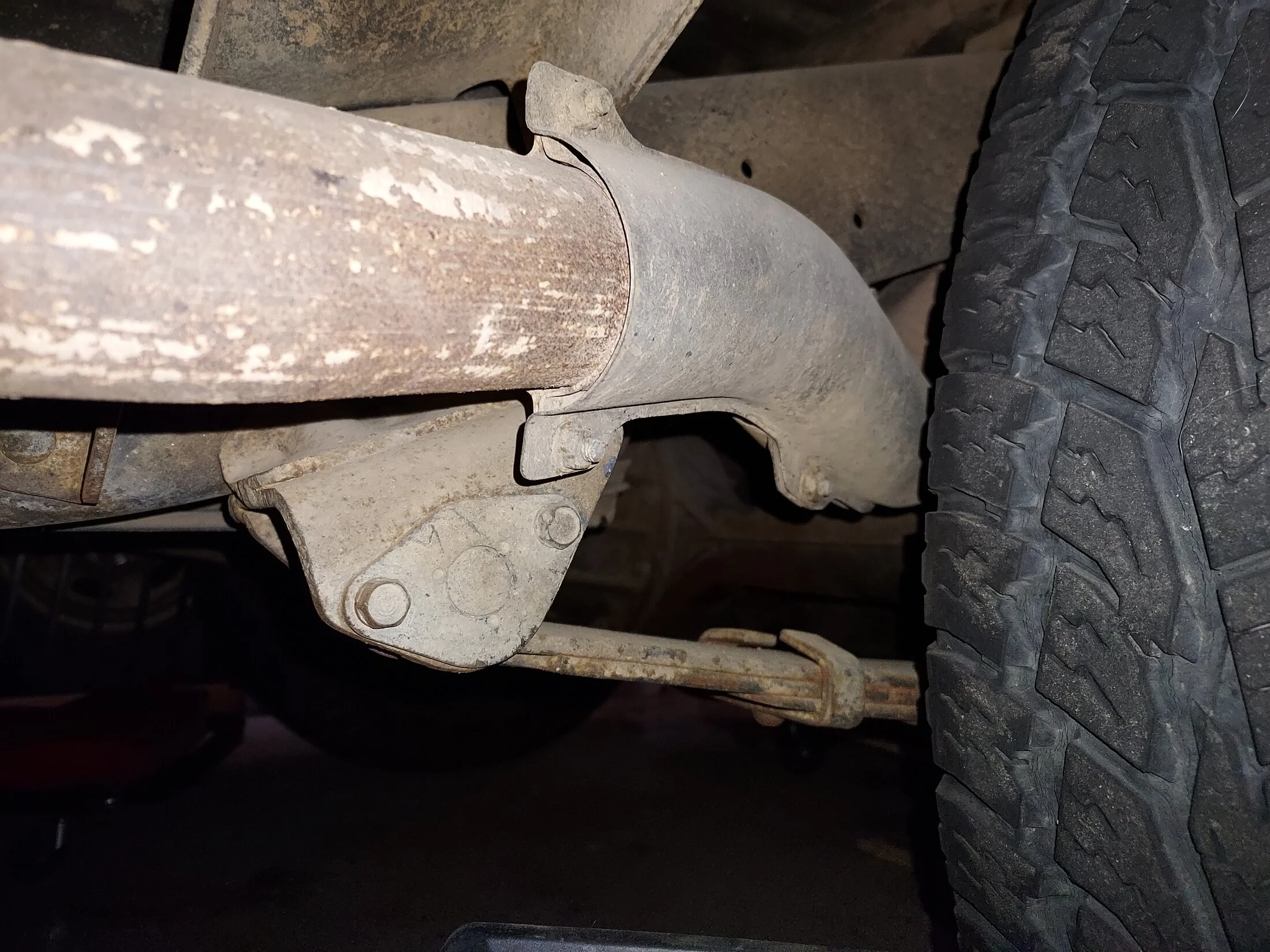

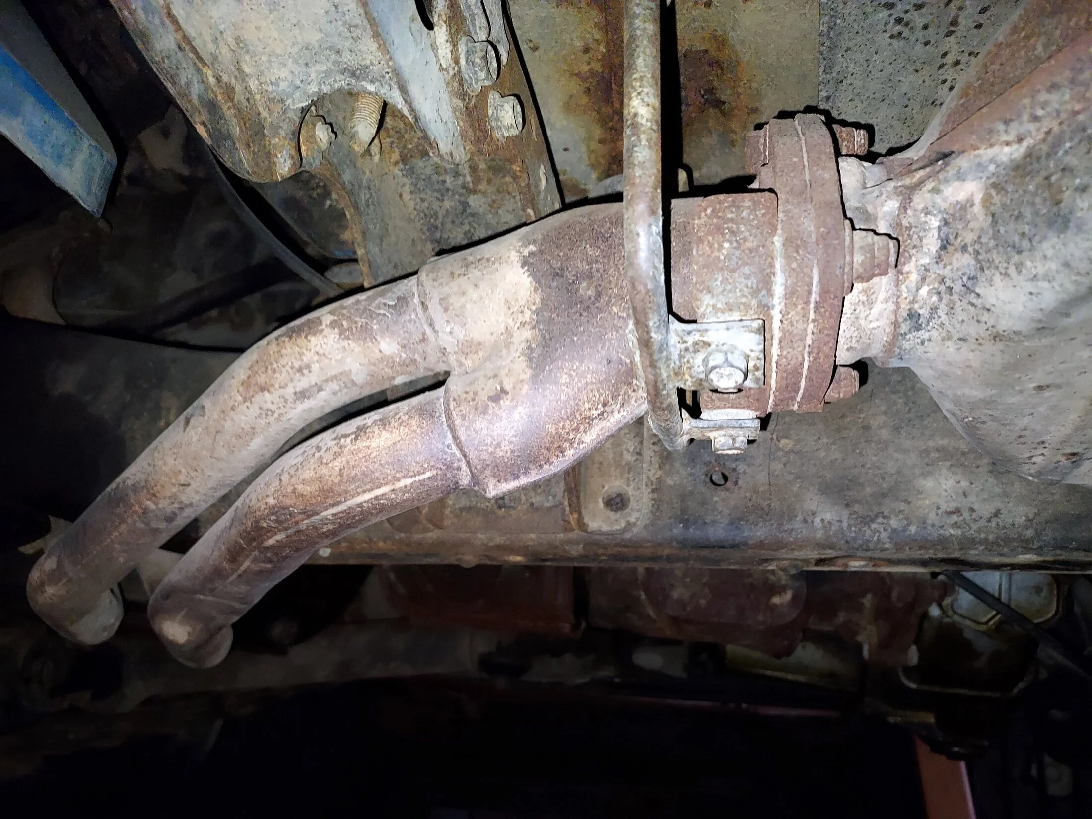

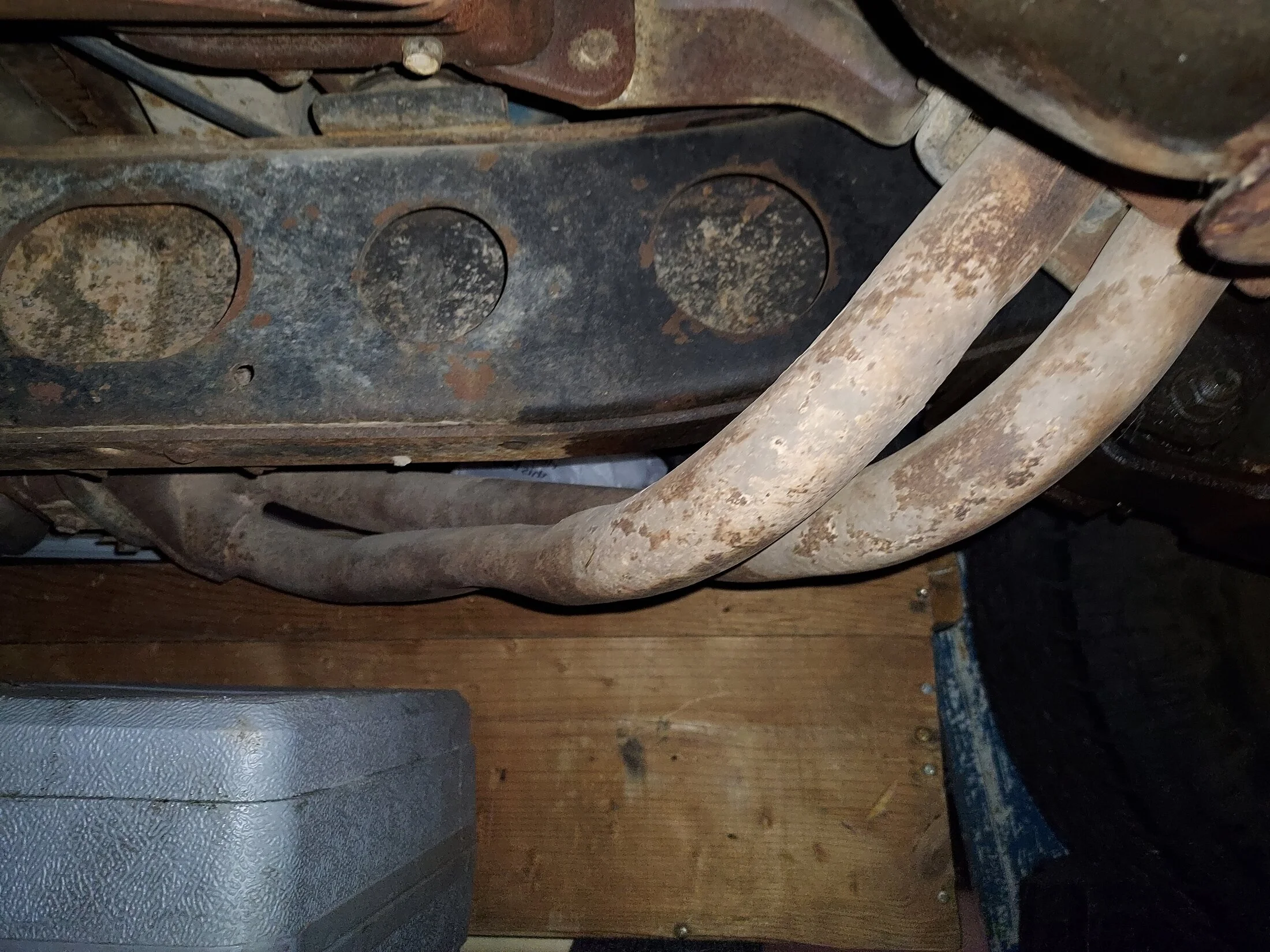

Here is my 79 which stock up to the muffler. Here is under the frame at the cowl.
Here is the routing at the rear wheel.
to add on the 79 stock setup
it had an adaptor to go from the round 3 bolt flange on the manifold to the 2 pipe setup under the frame, it was 3-4" long
