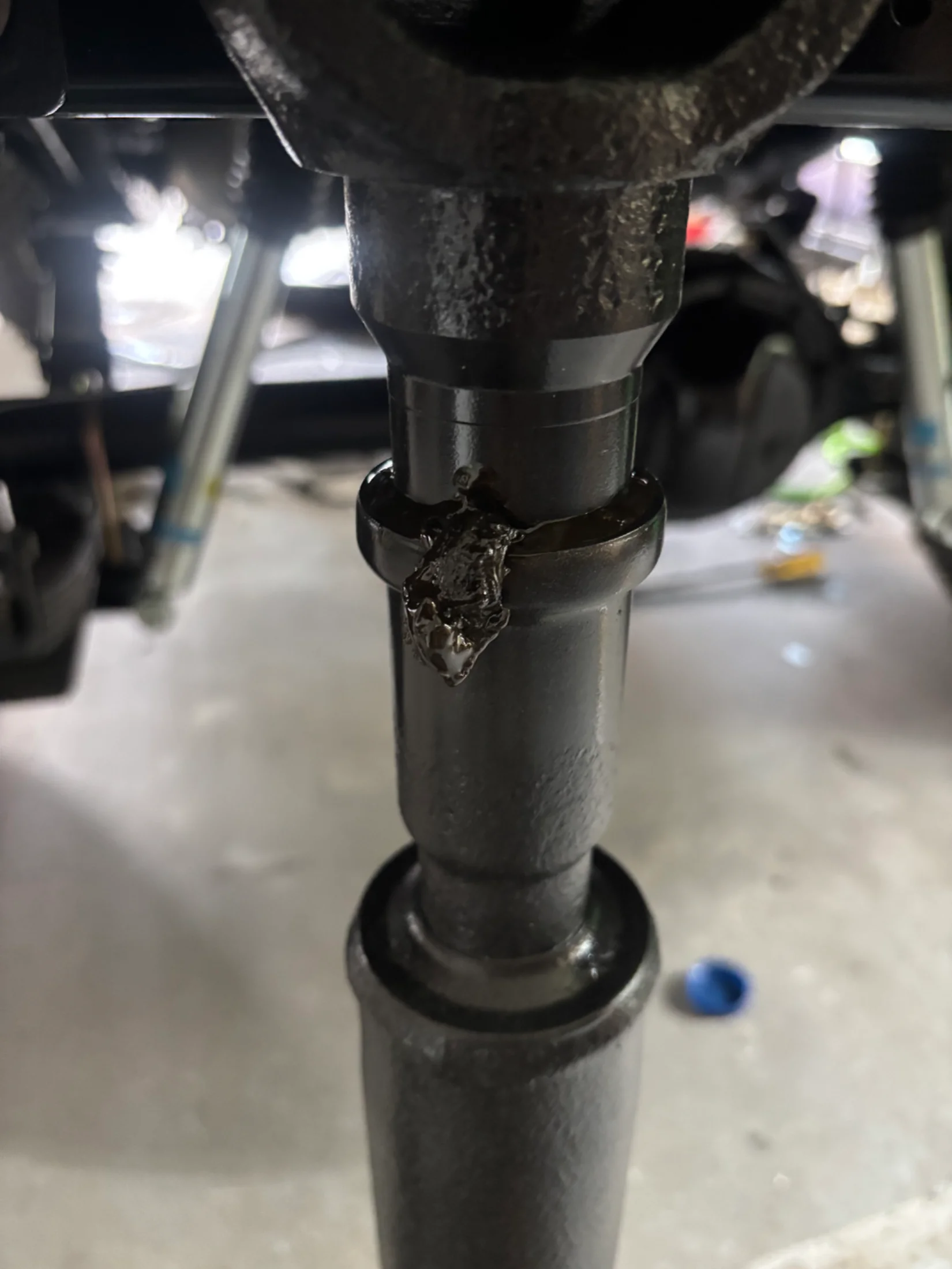

Ok this has been a while. Closing in on the finish line. I went to install my driveshafts and noticed they need to be compressed. But all this grease is coming out the yoke so I’m assuming I need new yoke seals?

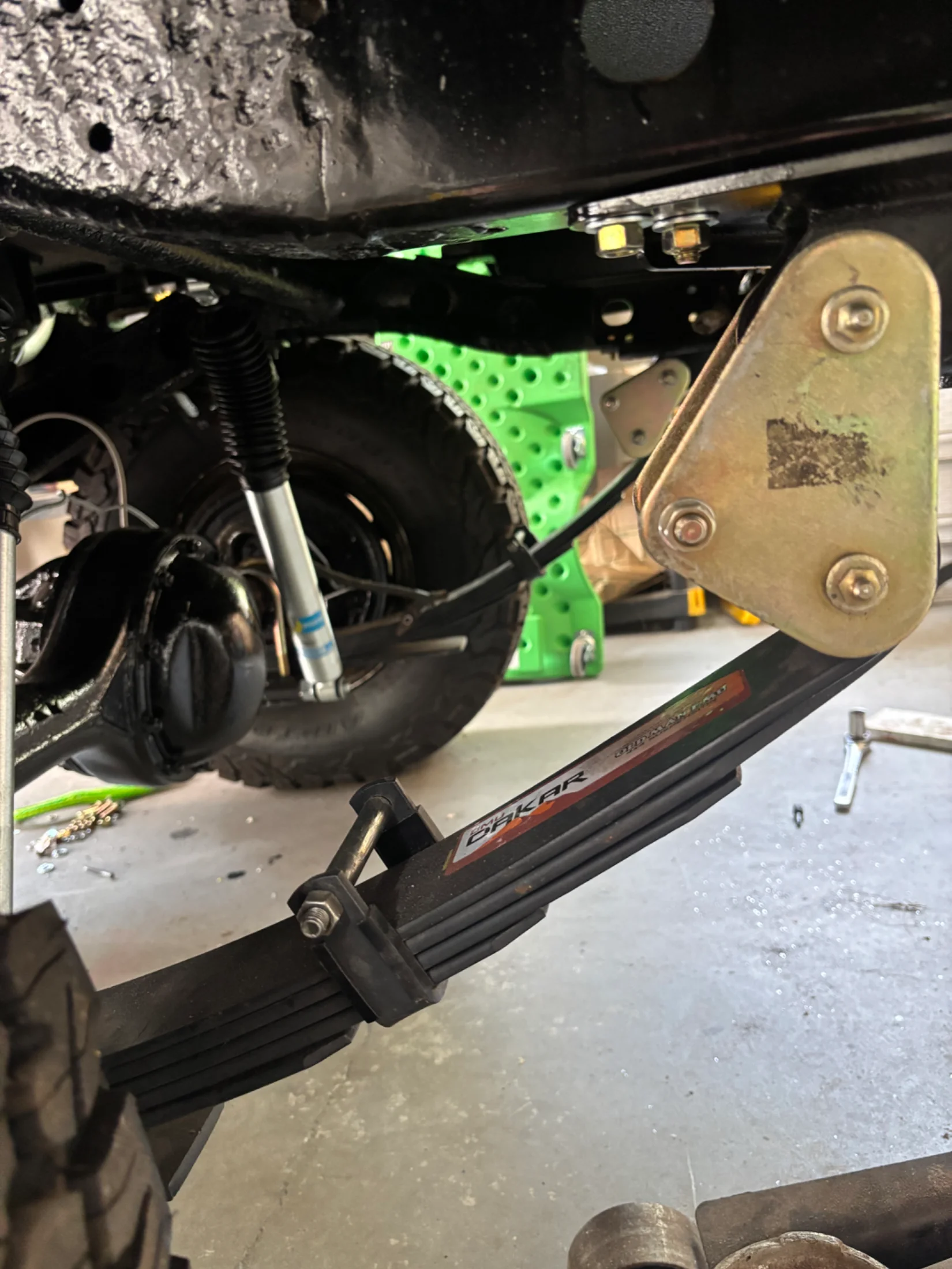

Also this is super weird. New springs. As you see the shackle angles are very different. Pin to pin the pas side is 1” shorter than driver. And is pulling the axle forward on pas side…
Idk if they will wear in? If I should swap springs
Driver side has the +which should indicate driver side correct. Oh unless these were for a driver side right setup hmm. Bought of FBM😬
No, there's just too much grease in them. Let the excess squeeze out when you compress the slip joint.
Meant also to say, you can unscrew the zerk and the excess grease will come out of that hole.
Any chance you have one front on the rear?
This won't affect it but your shackles are also upside down.
It appears the overload spring is on both, which assumes you have them in the rear correctly, but I'd definitely measure them off the truck to compare free camber and pin to shackle side and pin to fixed side to find out what you're dealing with.
Sometimes it also just has to settle in, but above is the only way to know for sure. When comparing off the truck, if one has more free camber (depending on how much) It is best to put that on the driver side.
Planning on taking them off and checking.
Then I can flip my shackles also 😉
No lean yet. And I agree, typically driver side unless necessitated by some other reason. I will also have my spare tire on that side. I’m wondering if although marked +, the - spring is actually stiffer. Just need to take them off and see.
