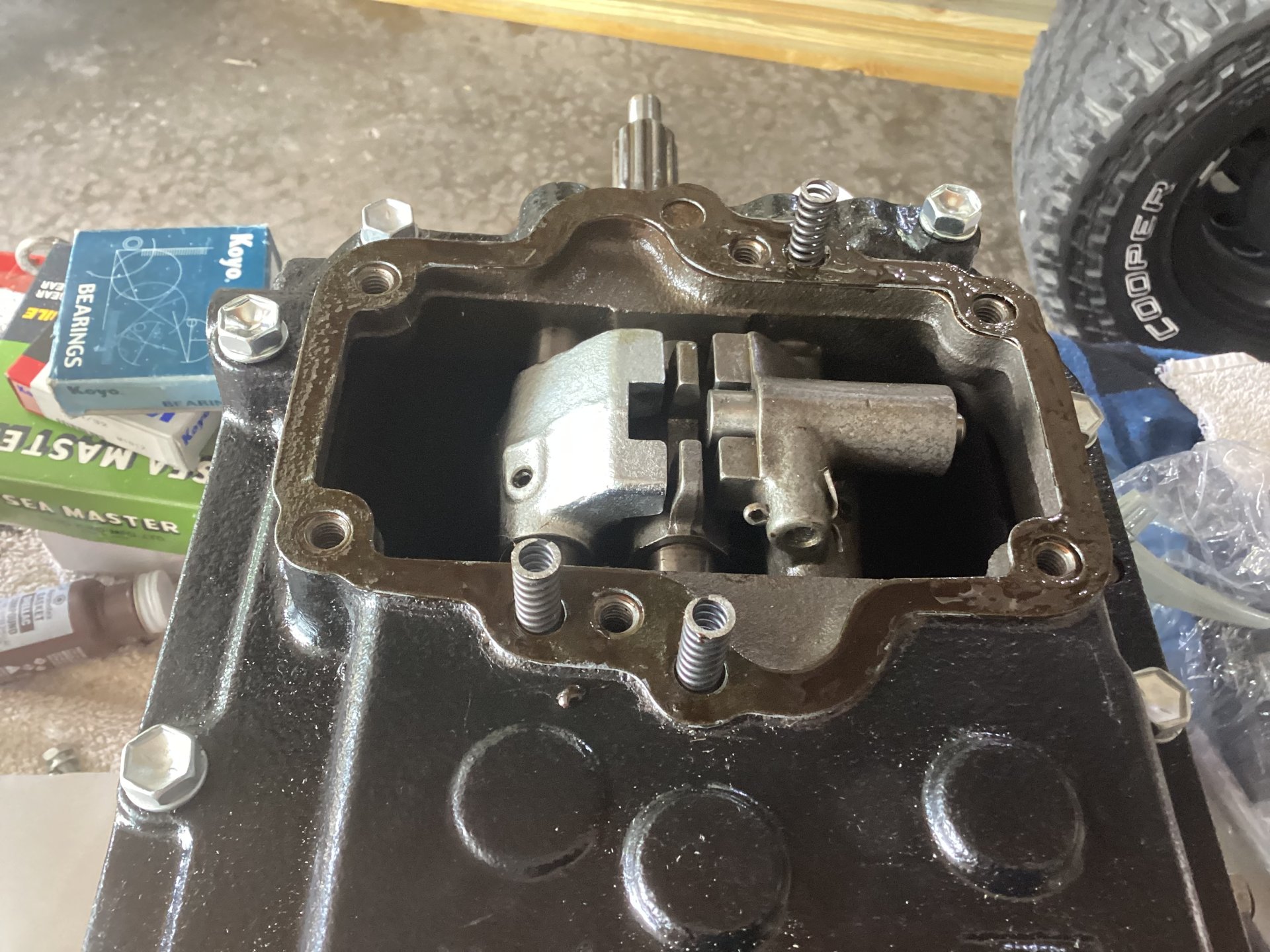

For a visual, I think this is what @3_puppies is describing to you.
There it is.
Thanks for the visual reference! I’ll try to adjust to neutral. I guess I don’t need to worry that I messed anything up until I have the clutch slave/master and fluid all ready to go and test then.
