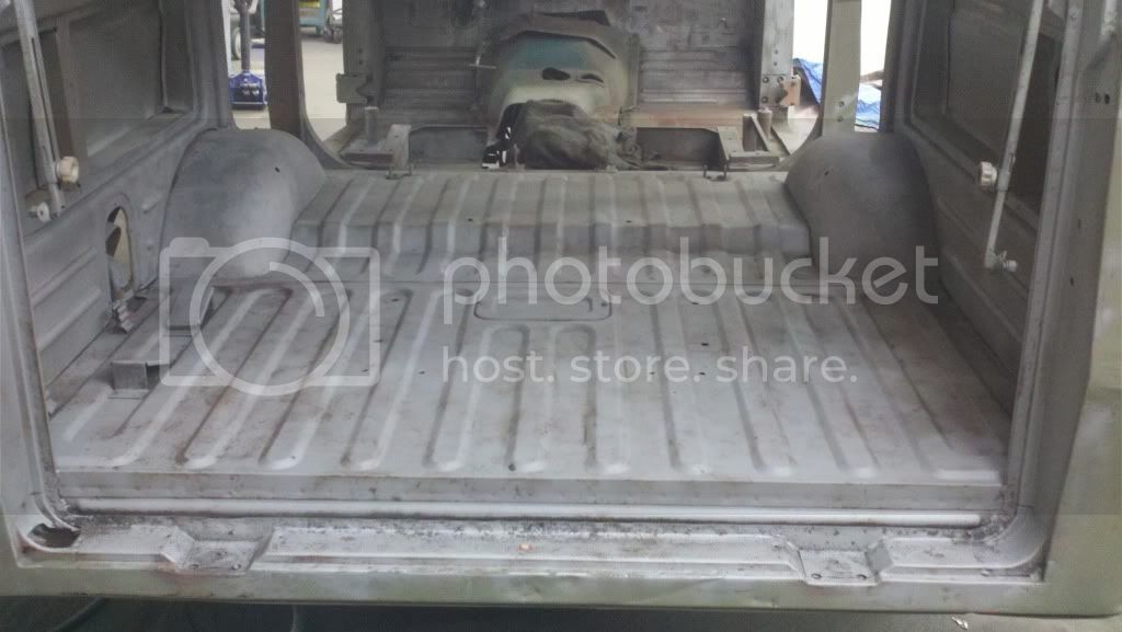

I got in the sandblaster today.
I tarped the LV, put the sandblasting pot inside and crawled in with it.
A few bags of media later and it's looking pretty good. I have another bag or so to go, but I needed to clean up a bit to mark with sharpie what still needs to be done. It's tough to see in there.
What a difference 95CFM at 100% duty cycle makes. My cheap pot worked pretty good all day.
Nice, how much sand is in all nooks and crannies....better clean thoroughly before surfing the net. Wouldn't want to chafe.
Day 2 of the sandblasting all done.
Two more pots cleaning up the areas I missed the first time.
Then an hour or so cleaning the shop.
Then a couple of hours with the DA and the right angle die grinder getting the inside roof to bare metal and cleaning up stuff like the window frames.

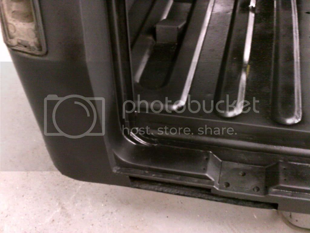

Then a guy came by the shop just as I was leaving. he wanted to throw his car on the hoist real quick, so I started messing with the left corner of the tailgate opening.
2.5 hours later I had the corner all done. 5 separate pieces, all with curves.
Then I cut out the sill below the left tailgate hinge. It was packed with dirt. It'll be an easy patch, but much bigger than I expected. Great design putting that little gap at the end of the sill behind the tires.

Thanks. That corner in post #142 is what I re-built. The area below the left hinge had a line of pin holes. Now it has a square cut out of it about an inch high and 8 inches long. The patch will have to curve under the edge too.
God damn man, that's a good repair. It looks like that's how it was from the factory!
The patch just keeps getting bigger and bigger.
I cut back the corner past the rust to eliminate a dent at the same time. Seemed silly to patch right up to the edge of the dent and then pull and fix the dent.
I'm not allowed to work on it tomorrow, but I'll prime and seal the inside of the corner on Friday before I put the patch in.
Finished the corner patch.
