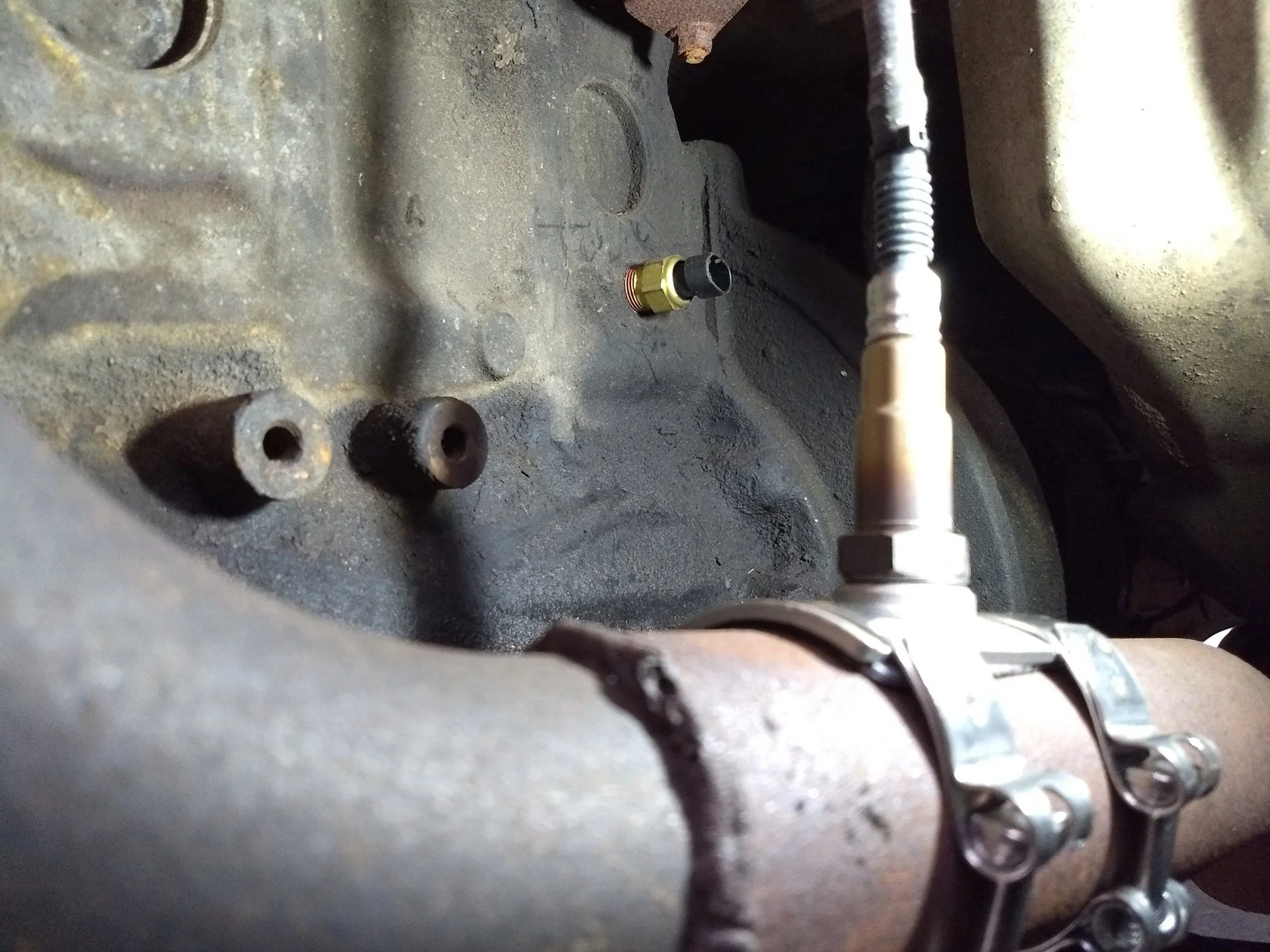

Direct into the block - see my picture a little ways back. That's looking through from the left front wheel well back towards the back of the block.

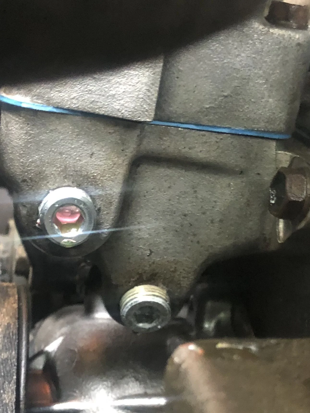

I have mine in the lower threaded hole in the thermo housing, but I plan on moving mine to the block in the location you have circled. They can get clocked at times, however, if you open yours and have good flow its not blocked. You can also run something in there before you install to make sure its clean if you'd like.

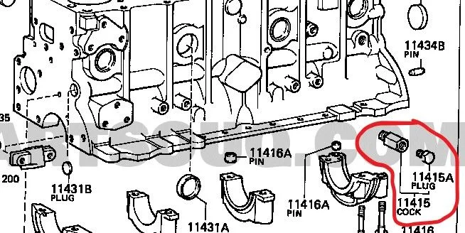

So that drain there are 2 parts, do you or anyone know if the sensor will go in the initial plug, or do you have to remove the adapter/ part in the actual block?

@FJ60Cam does the temp sensor thread directly to the block or in the adapter for the drain block?
Directly into the block
It was direct thread

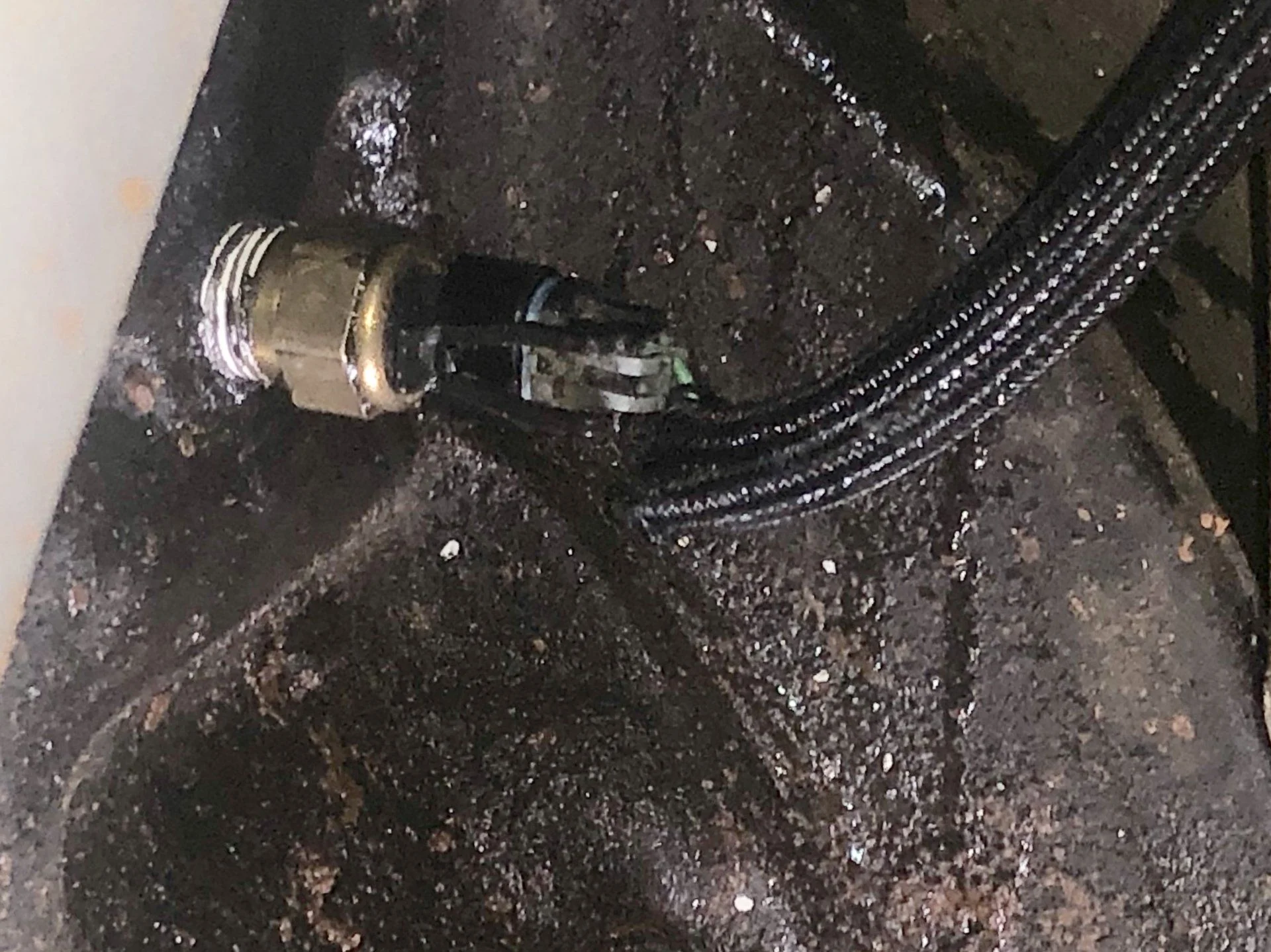

So, I went ahead and decided to make the move from thermostat housing to block with my temp sensor today. I haven’t liked how my thermostat was acting so I took this time to install a new OEM stat as well. Over all I like this a lot better and looks even cleaner. I didn’t even lose half a gallon of coolant changing the stat, plugging the hole, and removing the drain block. This is the setup!
Ok so you skipped the little adapter and went straight I tot he block.
Nothing needed then. I am going to do this tomorrow now that the carb is still off.
Yup straight in! Just make sure you have some heat protection for your wires. This passes close to the header.

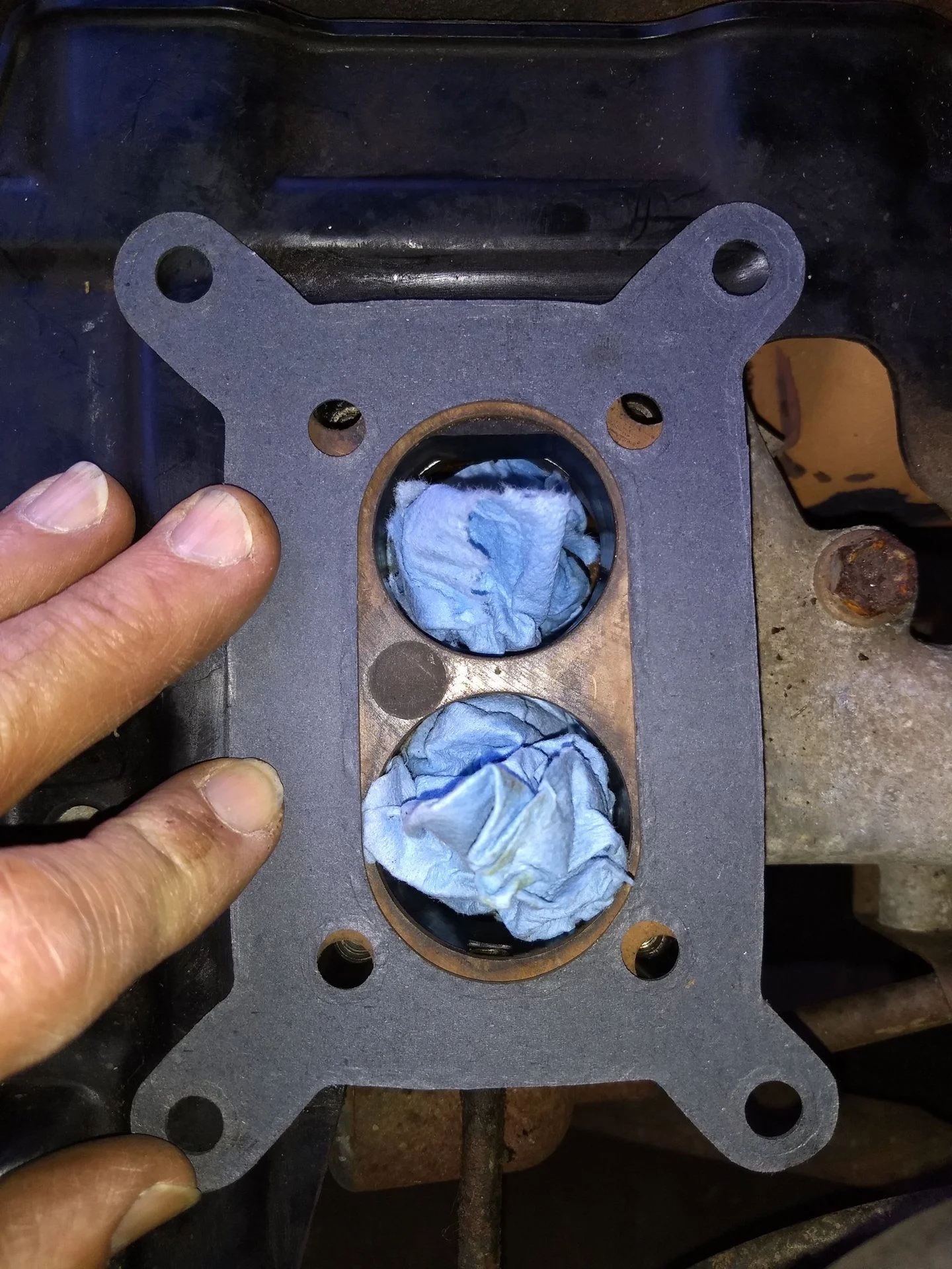

Ok so have a question. While I do not mind making my own gaskets. for those of you who used the Downey adapter, did you use the gaskets?
My gaskets will not fit no matter what. The holes for the 60 intake is WAY off.
I decided I will modify the stock intake insulator and use it (need longer bolts). But am wondering anyway.
Thinking my intake was different for a '86, I used my older intake and same issue.
According to Jim (Downey) the gasket that was sent to me has holes that do not QUITE line up. He suggested "just cut holes into an oval shape. "

I used OEM carb/intake gaskets on top and bottom. Worked great.
