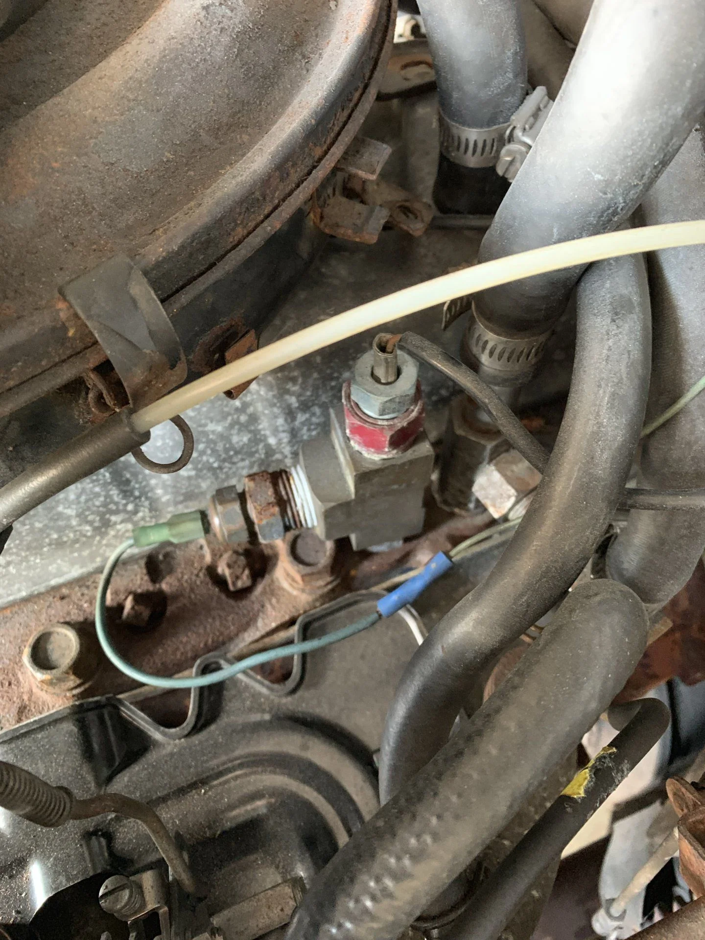

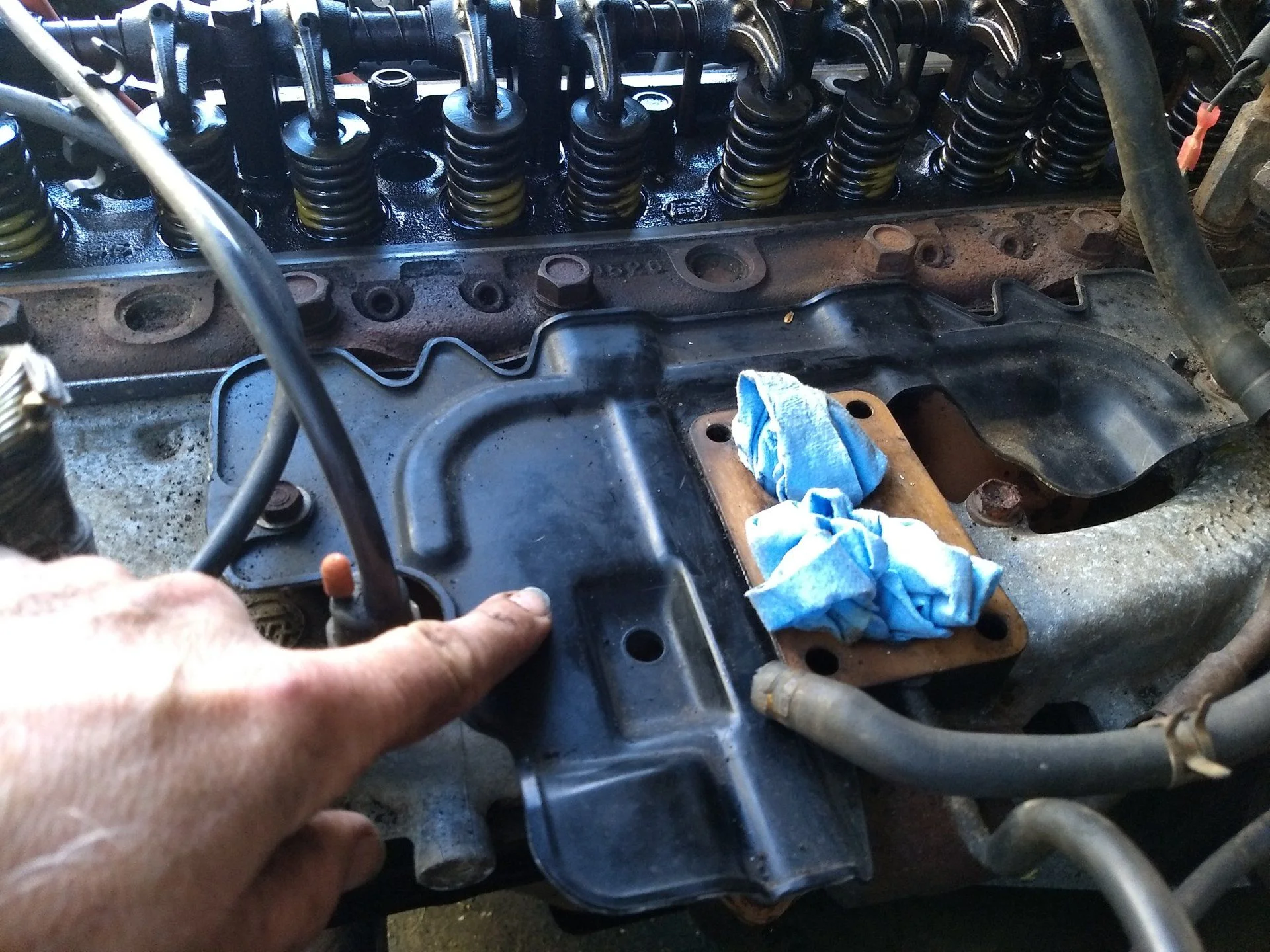

Another option (I will take a pic of mine later today) it is pipe off the stock sensor location. My stock gauge and my manual gauge are using the same location and I was planning on using this location as well for the EFI temp sensor.
Ok was able to snap one quick (need to fix that crimp connection)

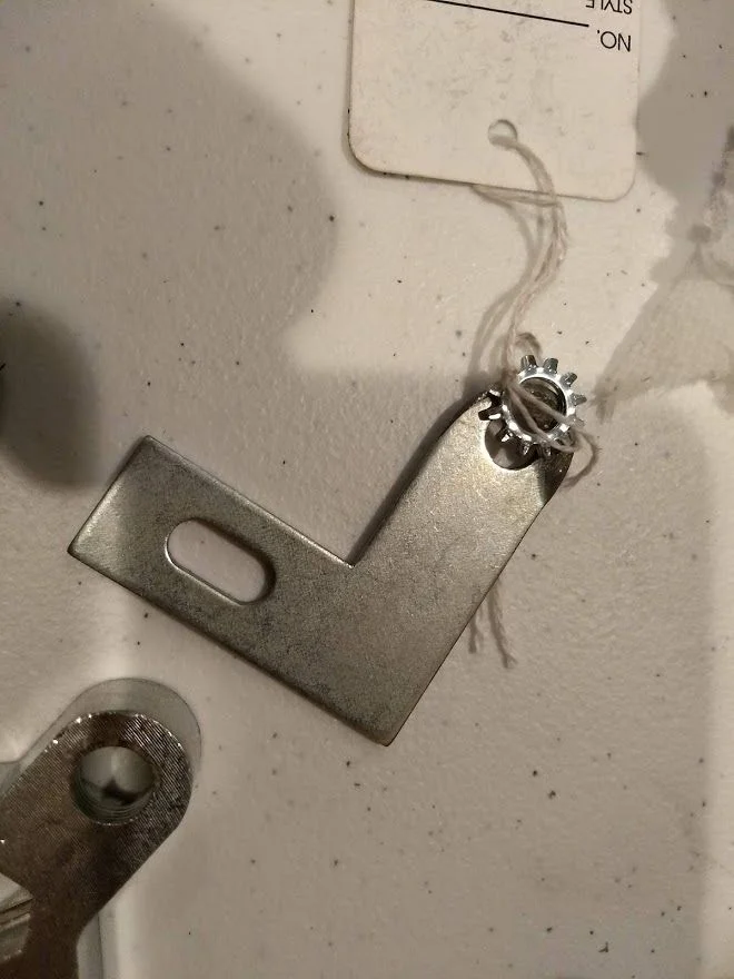

Next questions:

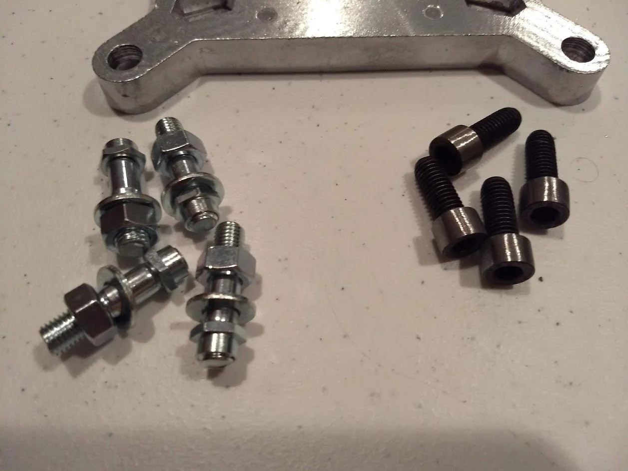

Downey adapter...
1. "L" Bracket is for...? And where does it go?
2. Bolts provided...
a. Bolts on left are bracket to Holley?
b. Bolts on right Downey to manifold replacing the studs?
@Willard am I being overly anal if I worry if the coolant that reaches the sensor probes up in that "T" fitting are an accurate (enough) reading of the temp deeper in the head?
I can see your point, But I have yet to have any reason to doubt it. Plus thermo probes on various parts of the engine and fluids have shown the mechanical gauge to be within 1-2 degrees. So I will call it good. The factory gauge is questionable, but then all are.
Did you leave the spacer that goes under the carb? The heat shielding sort of thing?
If you do not have the thick Downey adapter (I don't think he makes this one anymore) then you will have to to use the carb insulator to get the height you need to clear the Sniper.
You can also you the tube coming off of the insulator as a dump for your charcoal canister. I think @FJ60Cam had some luck with this.
I have whatever adapter Downey is selling now.
Its the thin one then. I believe I snagged the last thick one. You should use your insulator. Just grabbed some new gaskets and roll.

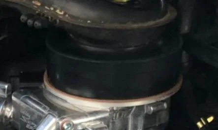

1. Fitment of Mr Gasket air cleaner adapters between Holley and stock air cleaner. One of the two cone shaped adapters fits into the air cleaner the other one is a little too large. The one that fits in seems a little too small reducing the air that will flow through.... Is this going to be a problem? Are people modifying these parts? Secondly the fitment to the top of the Holly doesn't seem to work snugly with the adapter rings. Should any of this have rubber gaskets or anything to seal it up better?
This is a pic of Dustin's... how does the cone top fit to the ring?

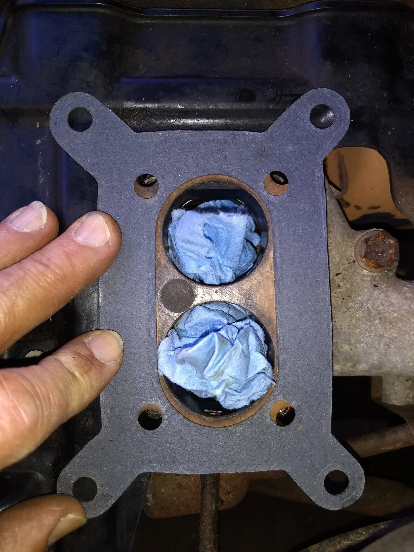

2. The holes in the gaskets supplied with the Downey adapter don't line up with the four holes to mount it to the top of the intake. Do I have the wrong gaskets or should I just open up the holes a little?

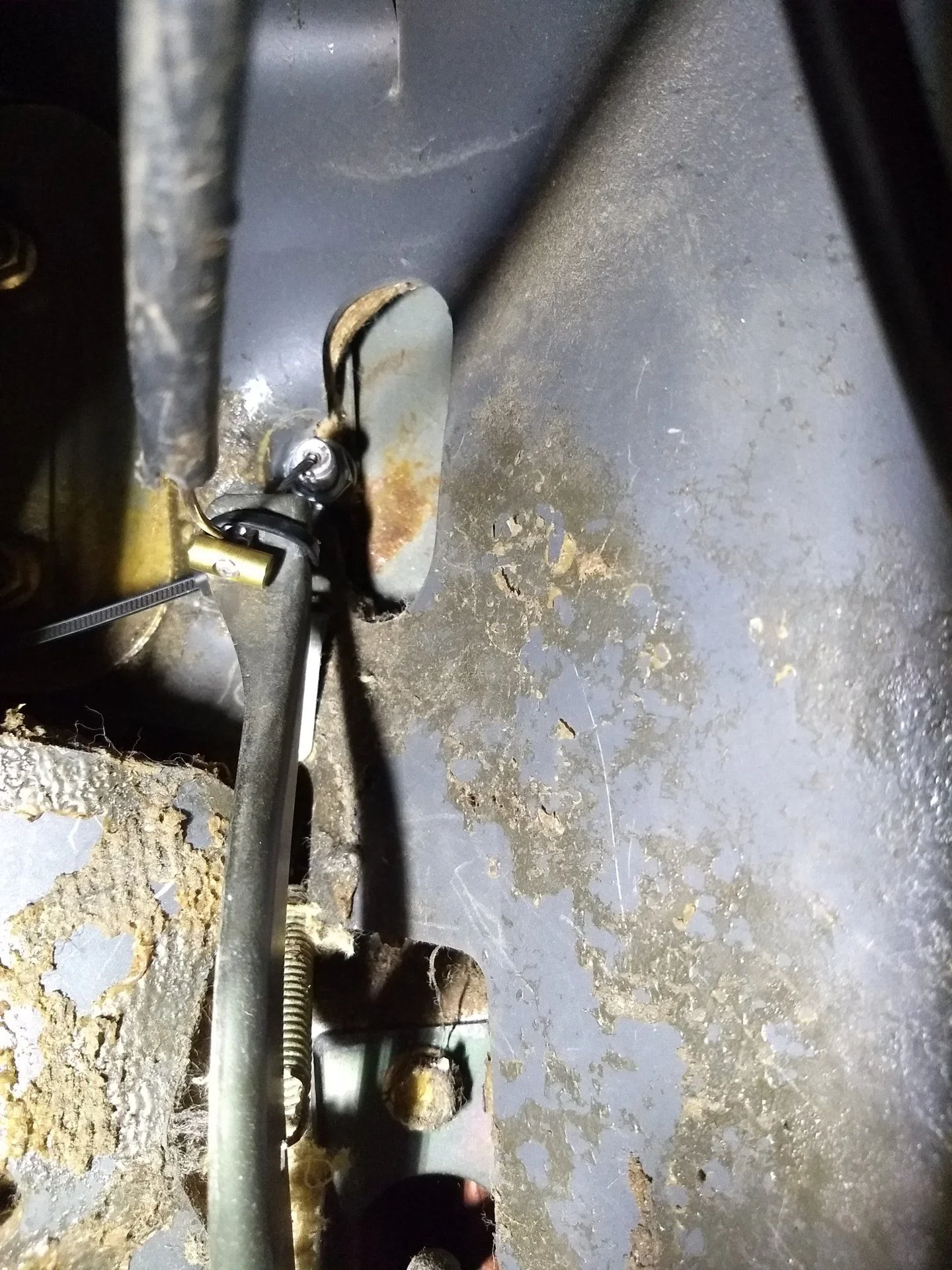

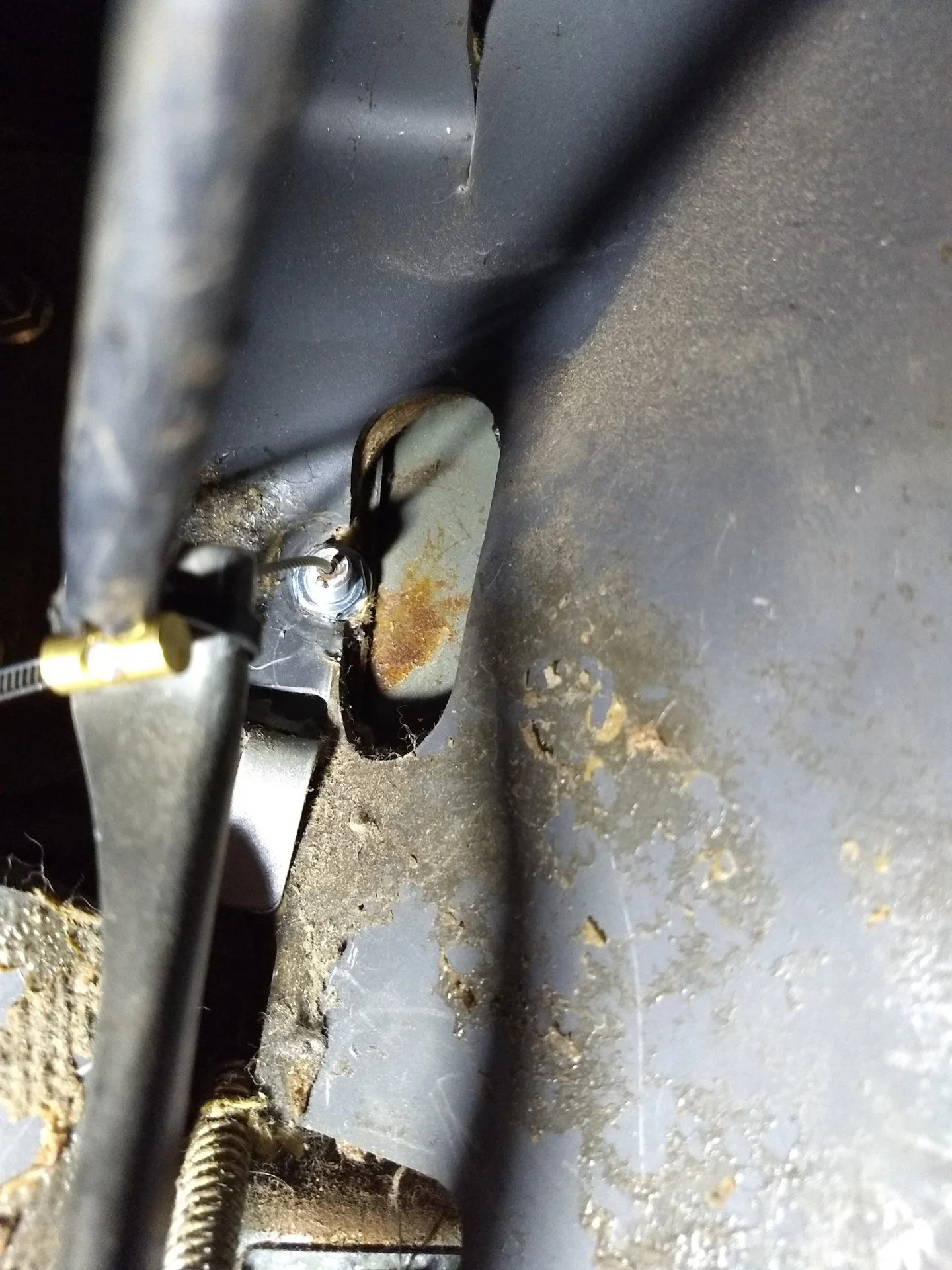

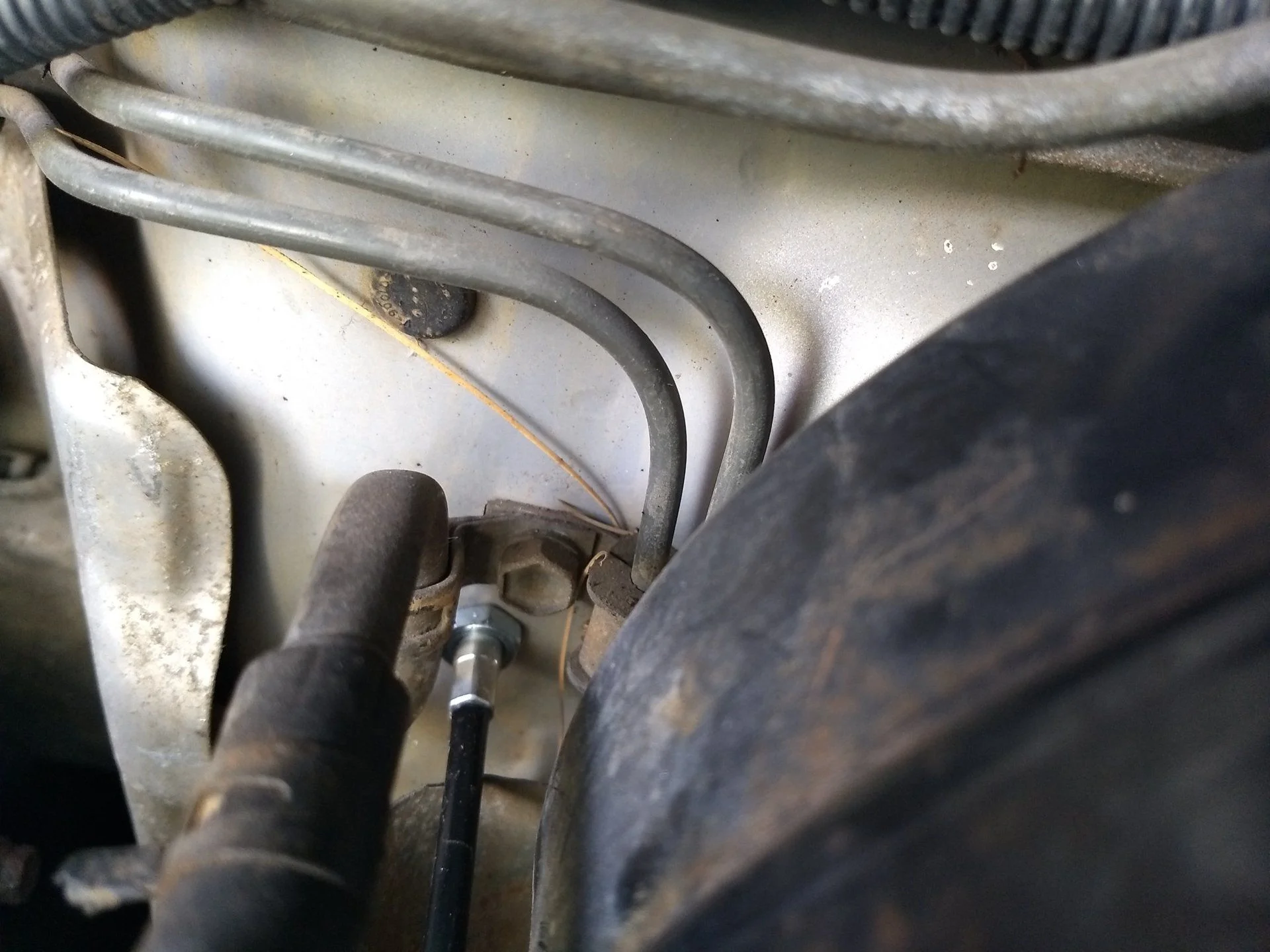

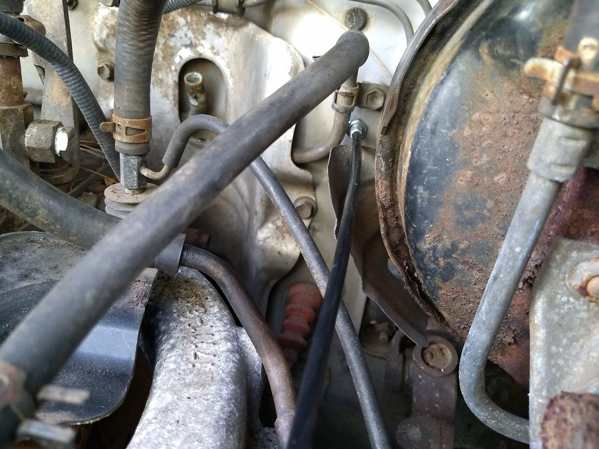

Here are some pictures of my mounting of the Downey throttle cable.
And the temp sensor and O2 sensors...
so there had been some discussion about a hand throttle.... You can see that I have a hand throttle style gas pedal on my 60 and I have had an OEM (diesel?) hand throttle for a while. The Downey throttle cable looks like it's going to work with that spot on the pedal... Will report back.
So for the air cleaner I had to take a file to get rid of the lip on one piece so it sits flus on the gasket supplied with the Sniper. Once that was completed it fit snug. I’ve had zero issues using the Mr gasket adapter. Plenty of flow. I did rethread my rod to take a Toyota wing nut and my factory air box snugs everything up nicely. If you decide to use factory box you’ll move a few brackets around to make it work. The small round air cleaner Downey sales that says efi on it doesn’t look terrible. It really cleans the engine bay up too!
For the gasket if I remember correctly you keep flipping it till you get it right. It’s a one way only setup
If your running a throttle cable to your hand throttle bracket that would knock you out of installing a ha d throttle.
I have two I’m trying to fit only because I want one and my bracket is free.
