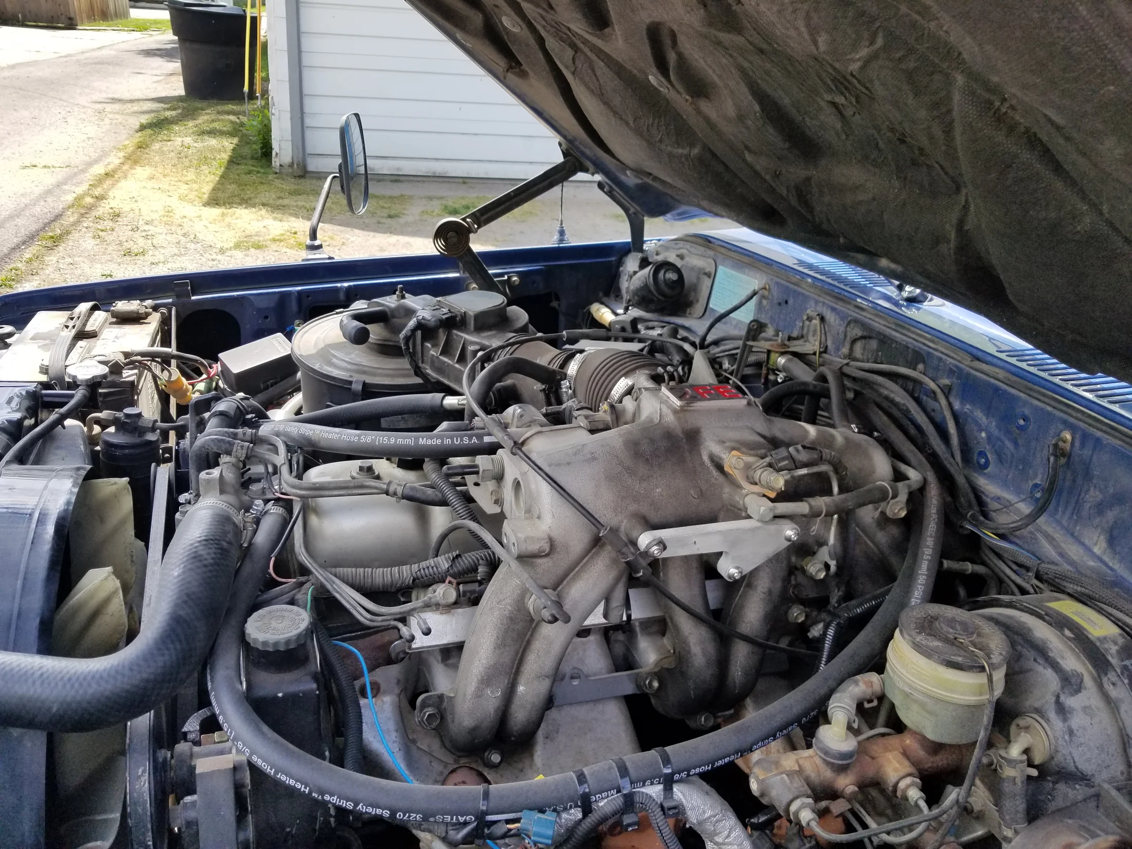

While it was not cheap, I went the all Toyota EFI route. I installed a 3FE head on the 2f block in my FJ60. I also had the 2F built at the same time. It cost me a little over $10K about 6 years ago but it was well worth it. It now has a ton more power and it gets 16-17 mpg. It cruises at 70-75 no problem and I rarely have to downshift on hills.
^2FE Route.
