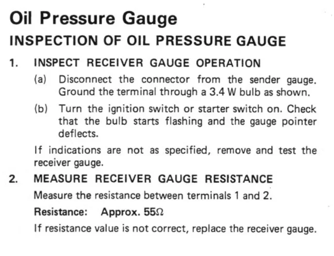

We known problem look in the faq section for more information on it. The water temp gauge does the same thing but gives you a whole different feeling when that happens
I would also guess in this case, the sender is bad.
Just in case - REMEMBER - DO NOT hook up the wire on the sender spade by mistake, instead of the brass center nipple - you will FRY your gauge.
