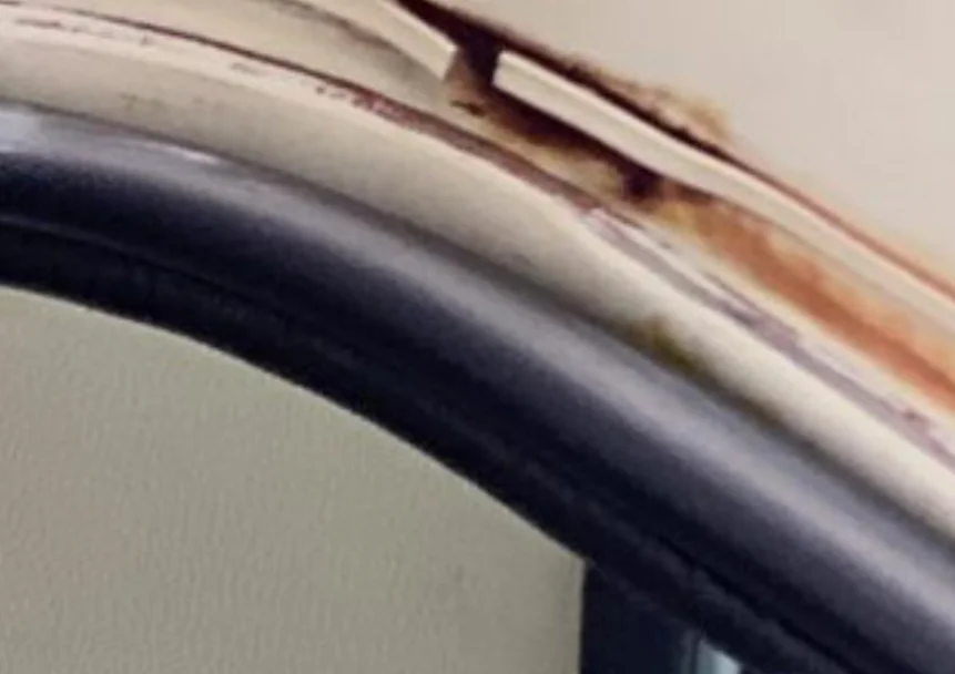

It might be worth removing the peeled up seam sealer to see what the corrosion looks like. Either way, probably the quickest and easiest way to deal with it would be the Fluid Film method.

Was going to dry ice blast the underside of the truck, then neutralize and paint/undercoat the body. Might see about getting into that drip rail, then fluid film or similar. This all in the name of making it last until I have some of the others done.

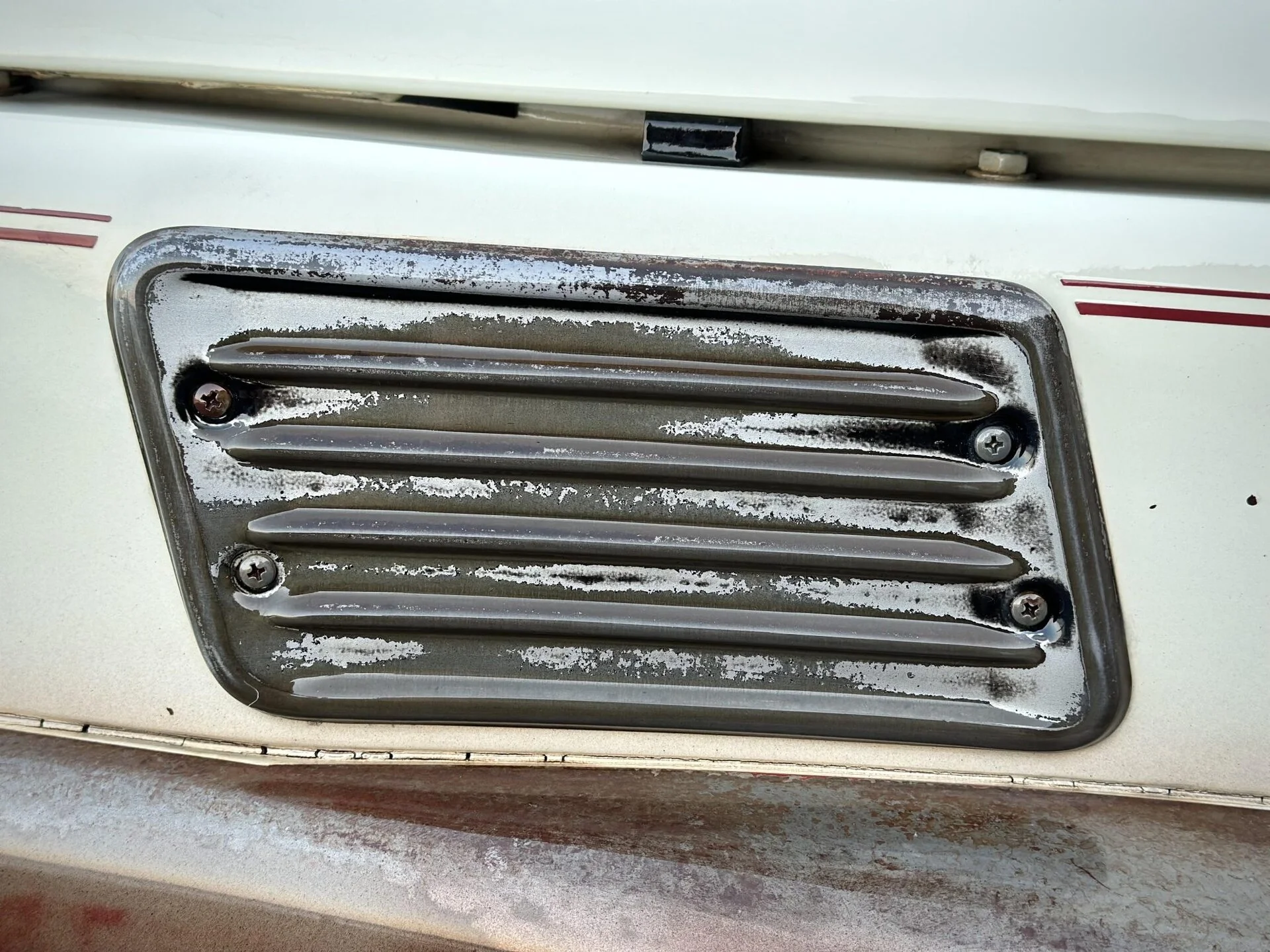

Question for the sty: the fender vents are different. The DS is open, the PS is closed. Should these be the same and if so, what’s “correct” for an April 1978 build? There is also a pass through in the DS inner fender that I don’t think belongs there. Opinions?

Fender vents - I know some are open. My '74 came with closed vents. I found some open ones and went with those. IDK if they allow more air in for the passenger compartment vents, but I liked them.
That DS pass-through - maybe someone was running a snorkel on this Pig at one time? Which might explain the different vent.
It's possible that they are supposed to be different. There is a cooling fan vent behind the driver's side one on a 1978 so maybe that's why it's open.

SOR doesn't list the upper fender vents - maybe @WarDamnEagle can find the different vents with his look-up magic?

Would have to try but I think you can interchange the sides by turning it 180 degrees (after it's flipped to the other side).

The carb-cooling fan, yes!
That would explain the pass through hole.
I am guessing this Pig no longer has the fan based on the picture that @gonzopancho posted.

That's for the carb cooling fan! Mine is exactly the same! Theory is to pull outside Cool are to blow on carb and manifold to prevent Vapor lock 🤔🧐😉😘😘
