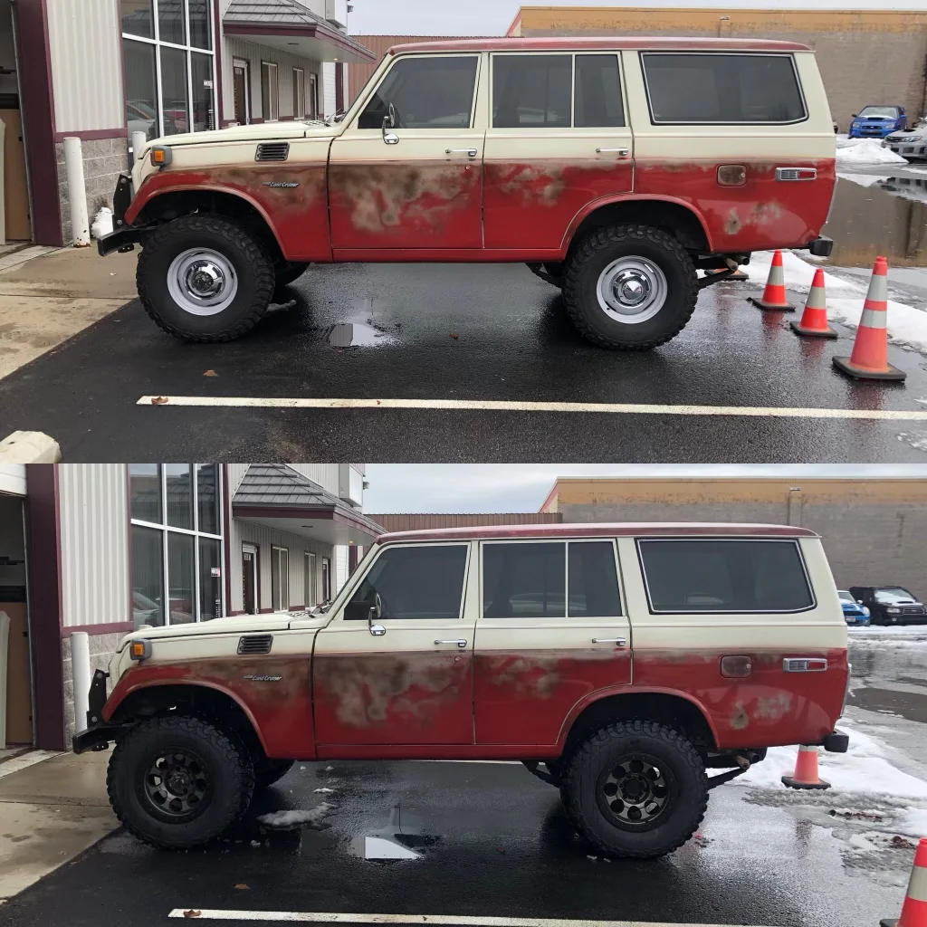

So much better with the steelies too! 😎

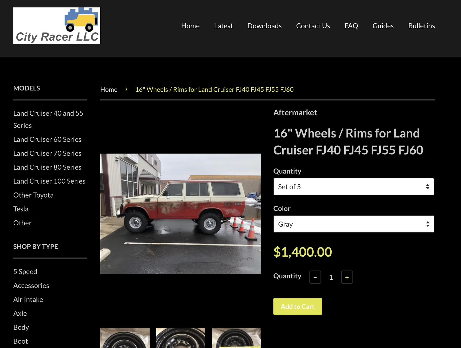

I actually have a set of five city racer 16” wheels with 255/85R16 km3s mounted sitting in Idaho that were for another project, but now they go to this truck.
If those beadlocks ended up in Idaho with nowhere to go, I might have spot for them

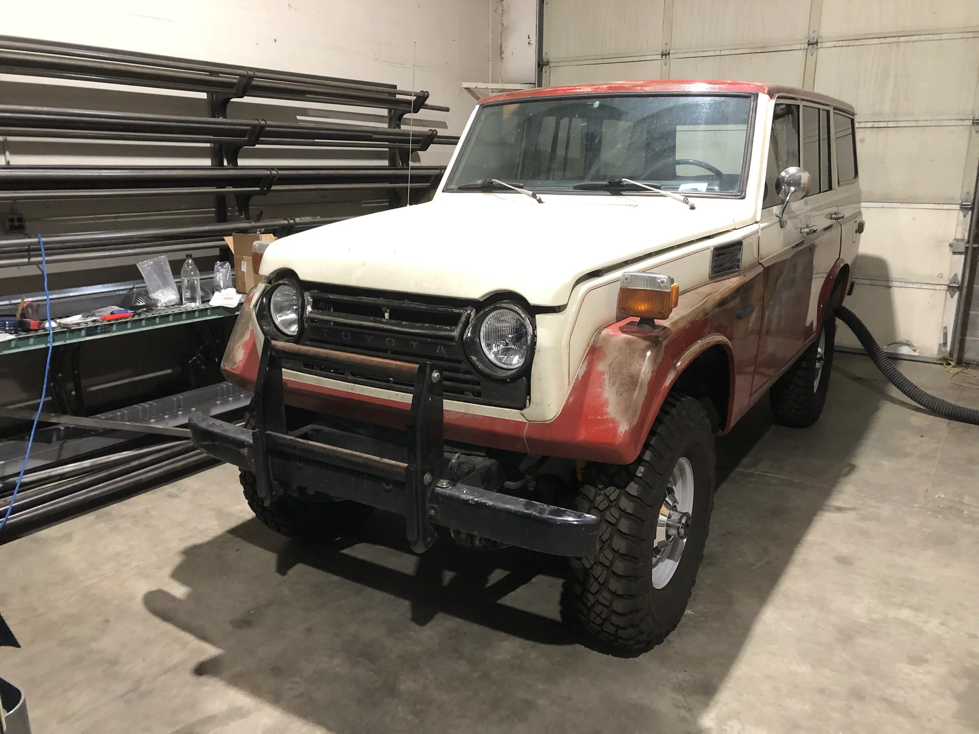

Frames pretty clean, body is solid. Few dents here and there.

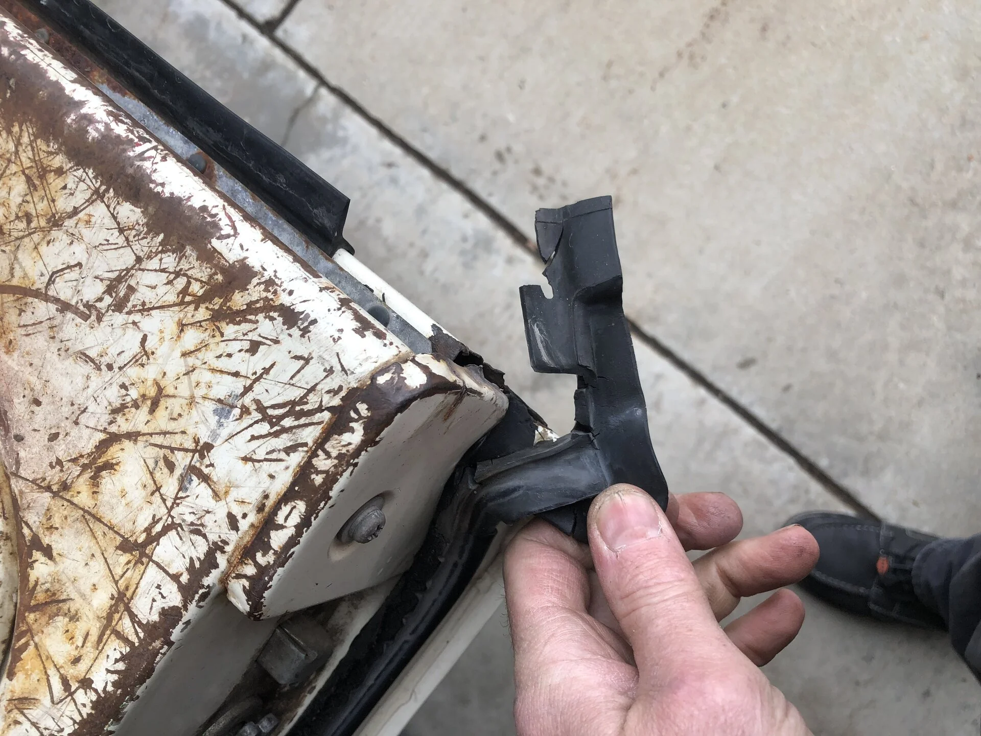

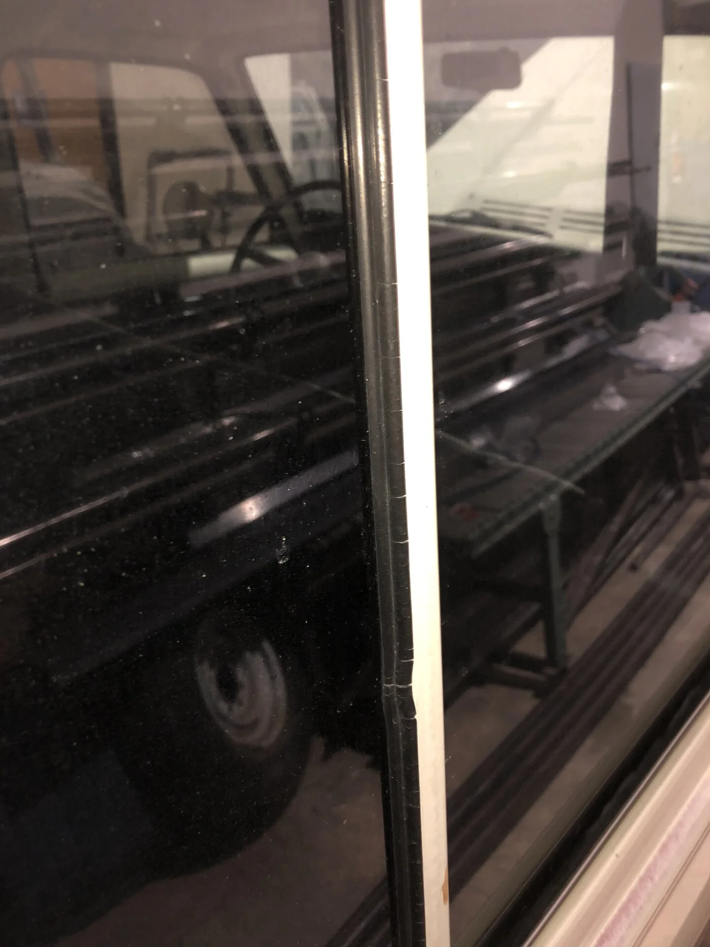

Door seals could have been done better. They look generic .vs oem. Replacements on order.
Doors all close well.

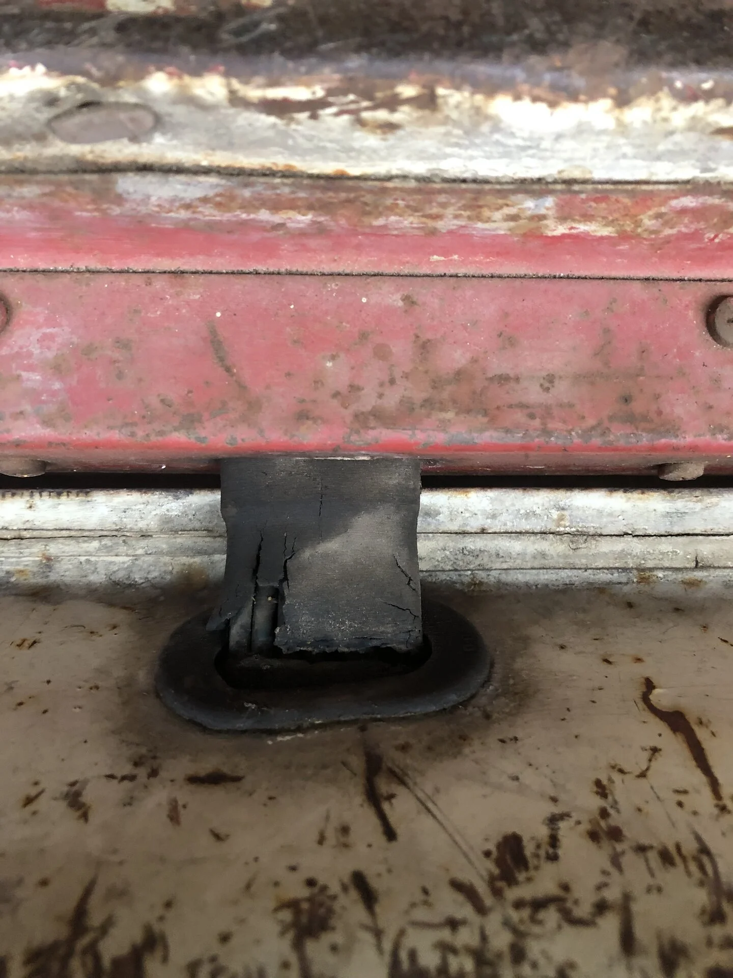

Hood bumpers need slight adjusting, hood pin adjustment.

Rear bumper has a few dings needs some love. Front bumper same. Grille needs a bit of tweaking.
Brush guard: I’m thinking shorten a bit and run it, doesn't look out of place. A nice piece, but the top bar blocks the “TOYOTA” on the grille.
Then the grille, headlight surrounds, front fender vents, bumpers snd push bar all go to the powder coat shop for some “Vegas Gold”.

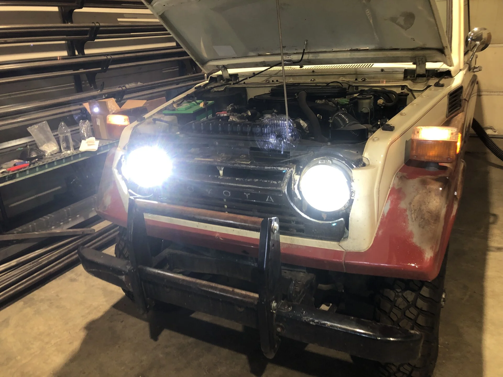

Since I’m replacing the rear markers I went ahead and ordered the front turn signals, too. Replacing the dark LED headlights with a set of LEDs that look period.
