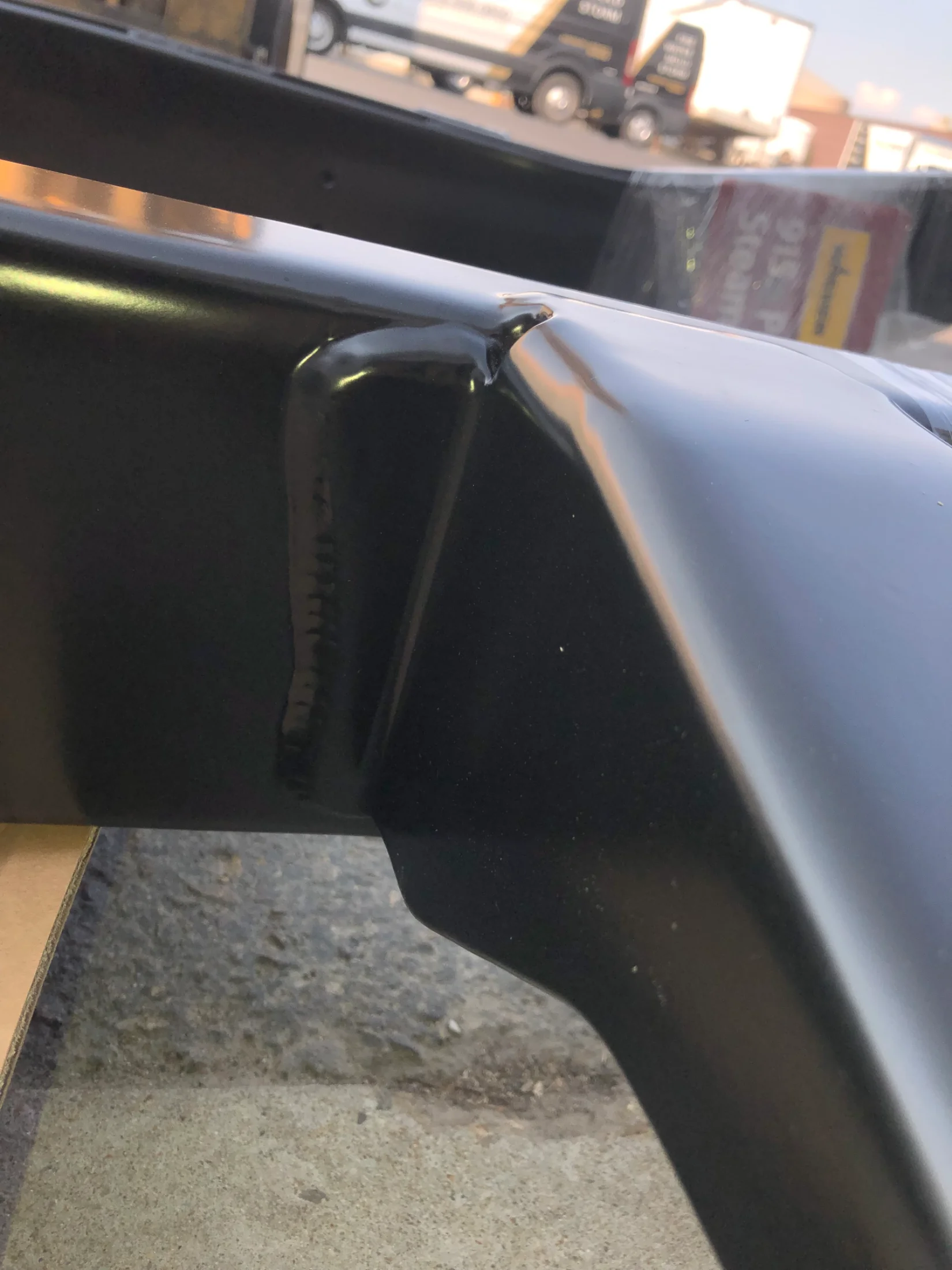

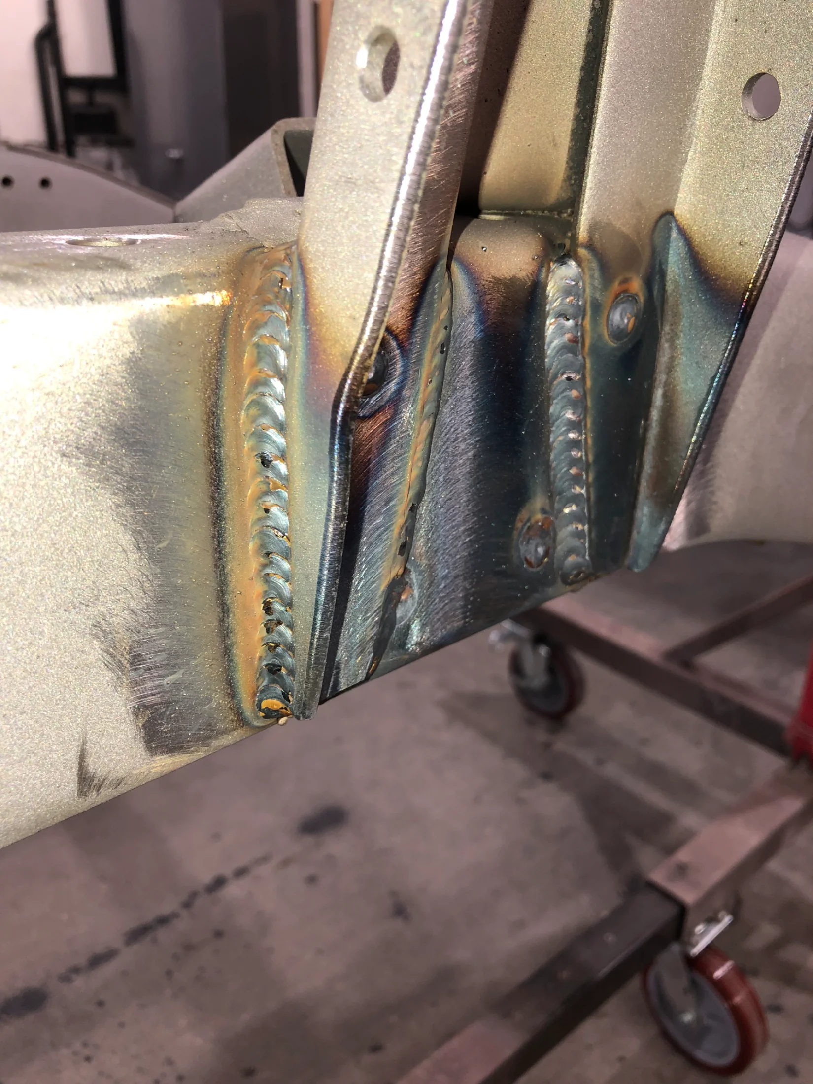

by wrapping the welds is key and what I always try to do.
So pretty
img_1396-webp.3958202
The peanut gallery, who is unlikely to have ever had a metallurgy class, and wants to talk "stress concentration", has spoken. It's all wrong!
I'm sure I've forgotten everything I did back in college on finite element simulations of welded structures, so you're probably right.
Every (factory) hole in that frame represents an area of stress concentration.
If you want to continue, let me know if you're asking about notch stress concentration factor of fillet welds or something else.

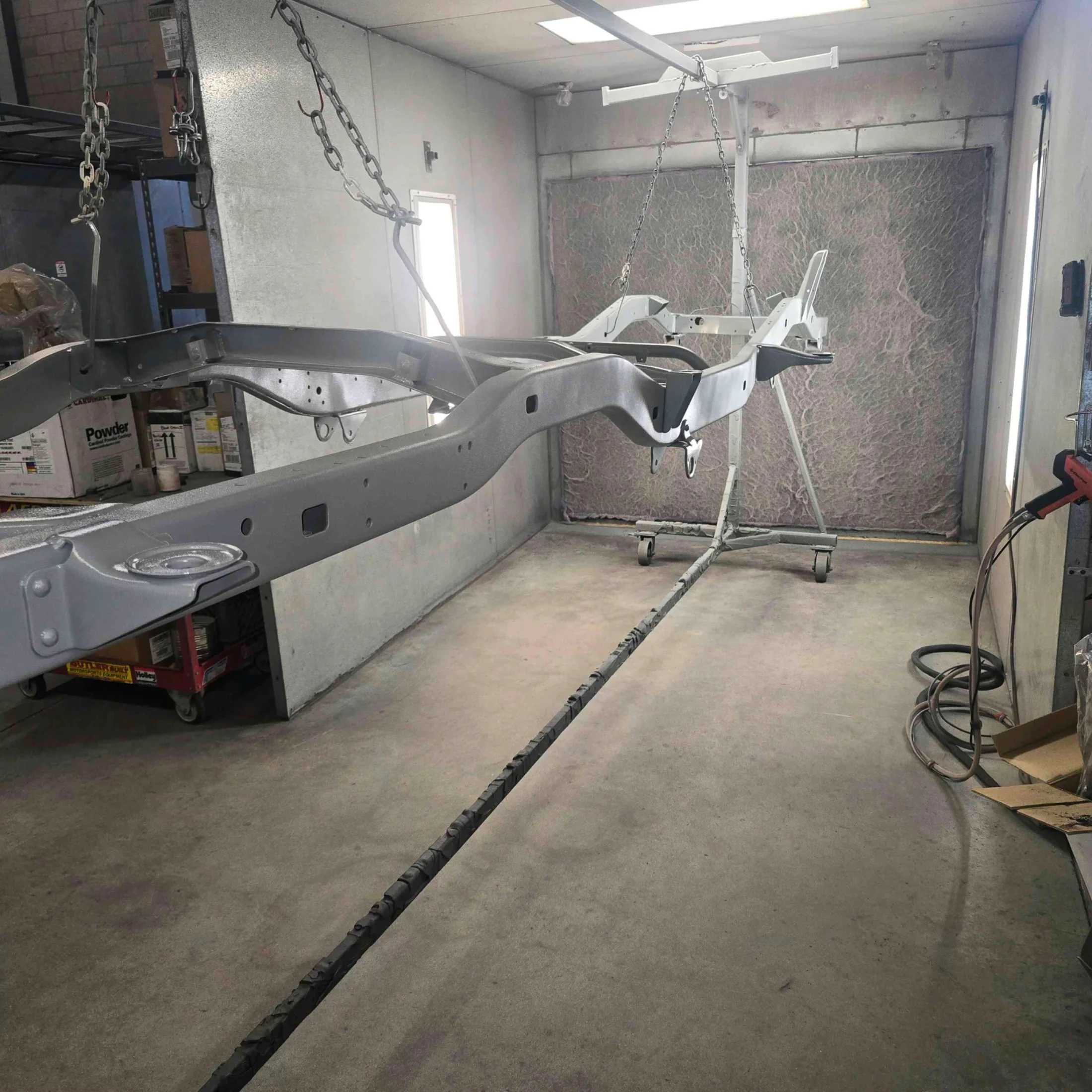

Do they have a way to get the powder inside the channel? That's one concern that motivated me to e-coat before powder. I asked my powder guy about a long wand, etc. but he just gave me a rather long reply which translated to "no".

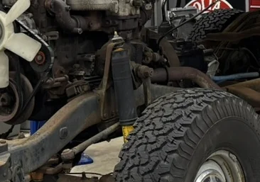

Where's other shock tower??
That's how my '77 frame is configured.
Driver's side bolts on. I think there is a reason for that but can't remember at the moment.
I went and laid hands on mine. It's in the "to be sand blasted and powder coated" pile. The steering box bolts onto the backside. In fact, that's the steering box bracket. It just doubles as a shock tower.
Nope. Just going to spray heavy paraffin or similar inside. Eastman and others make a long wand.

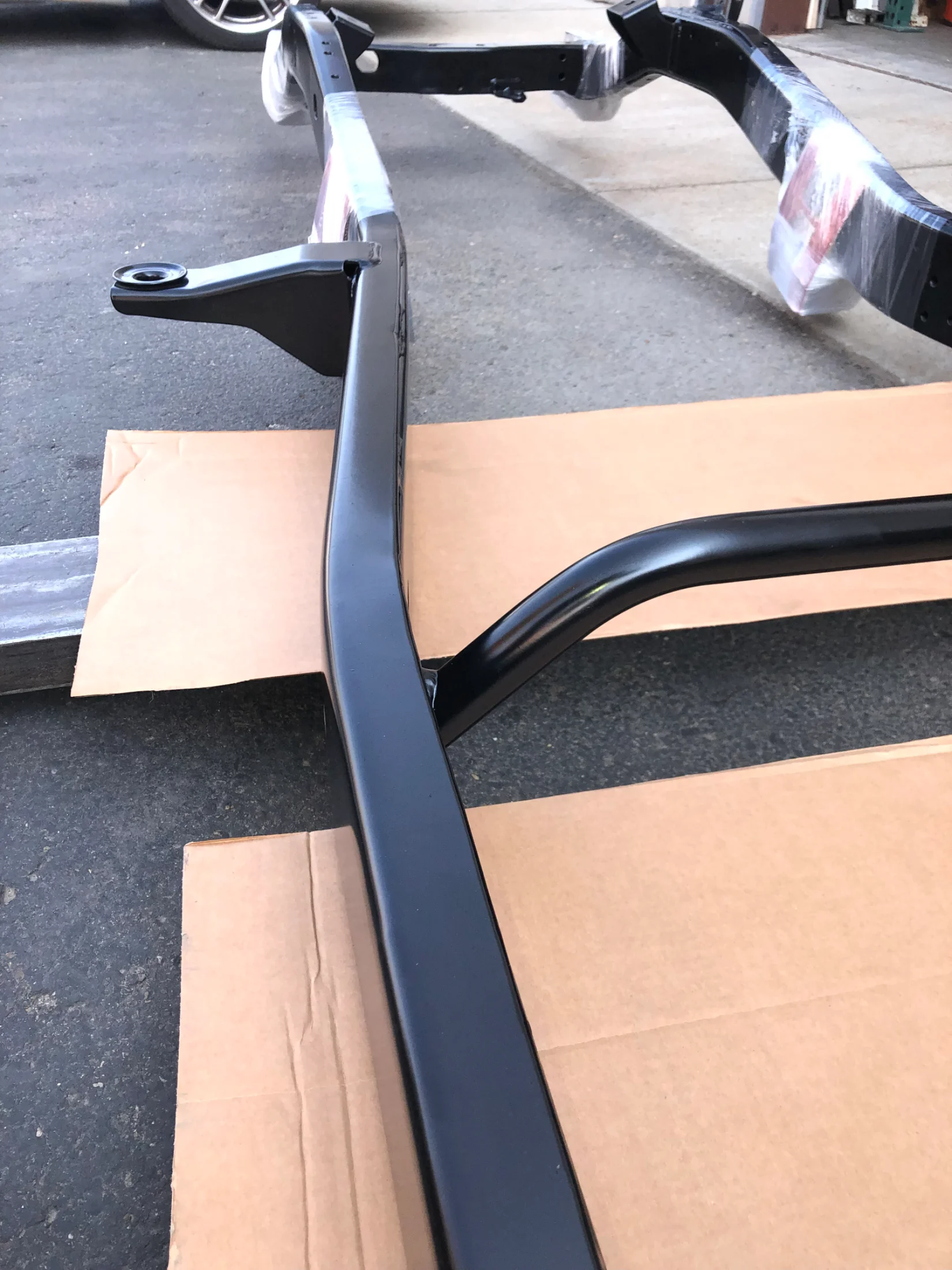

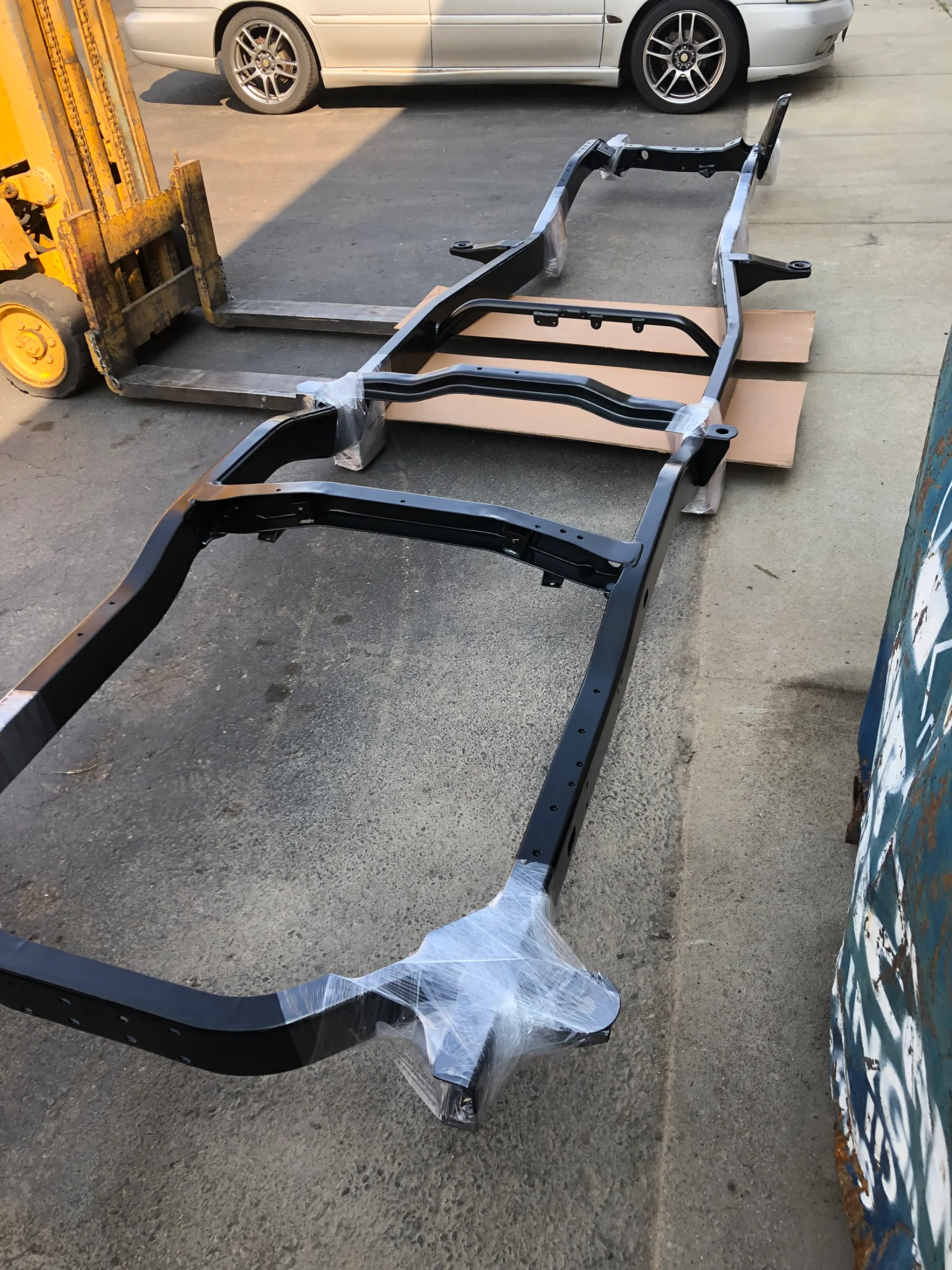

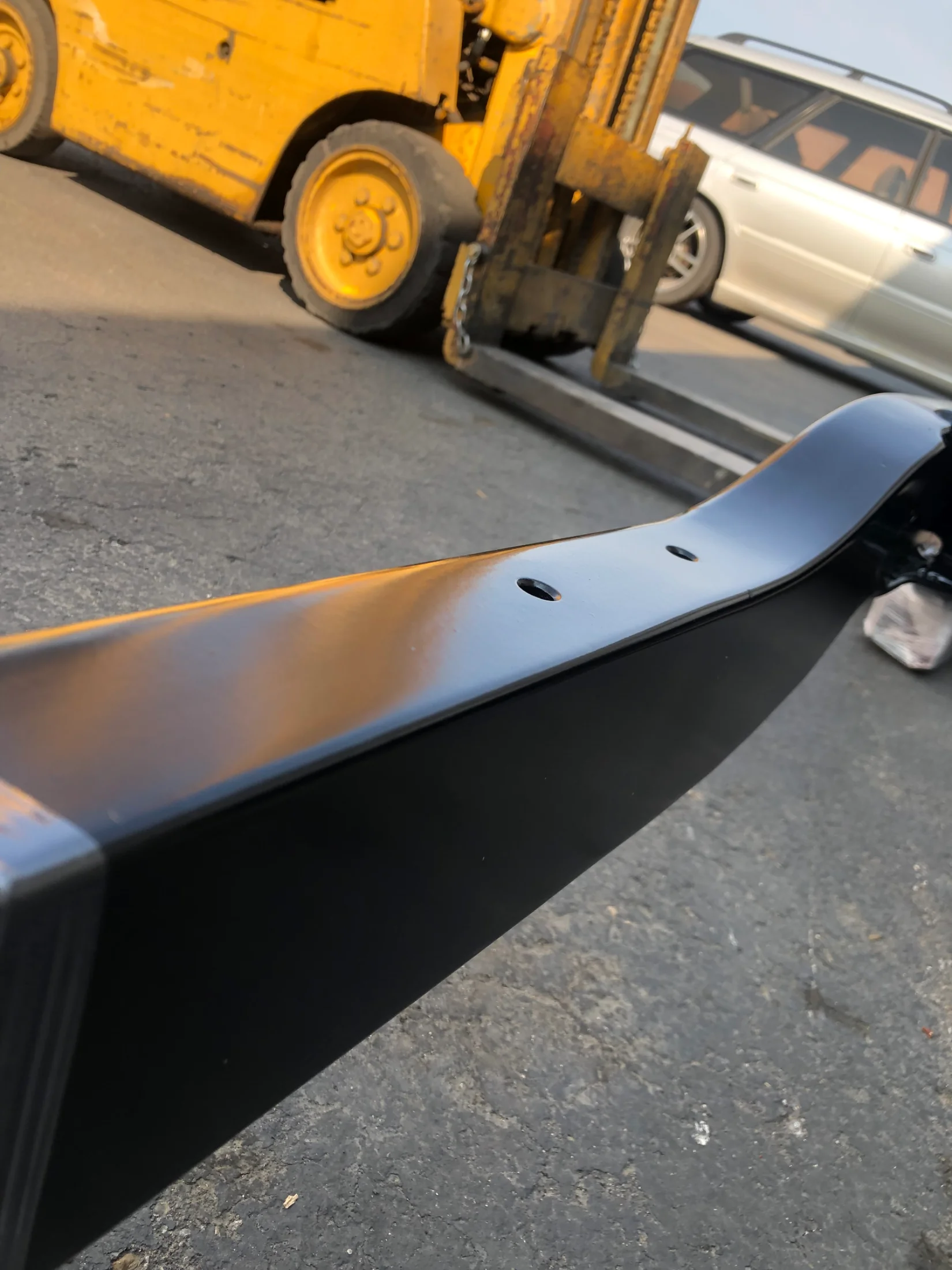

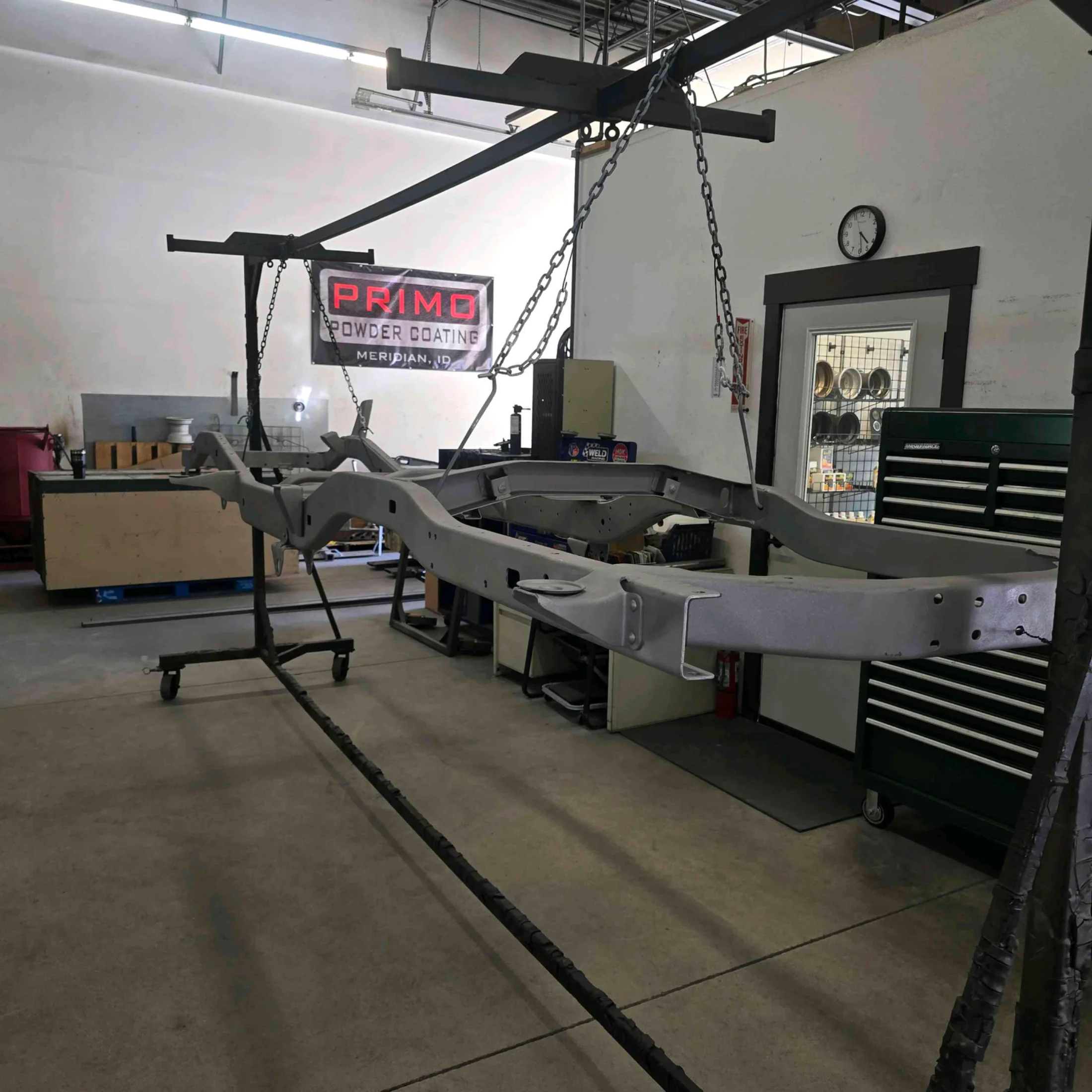

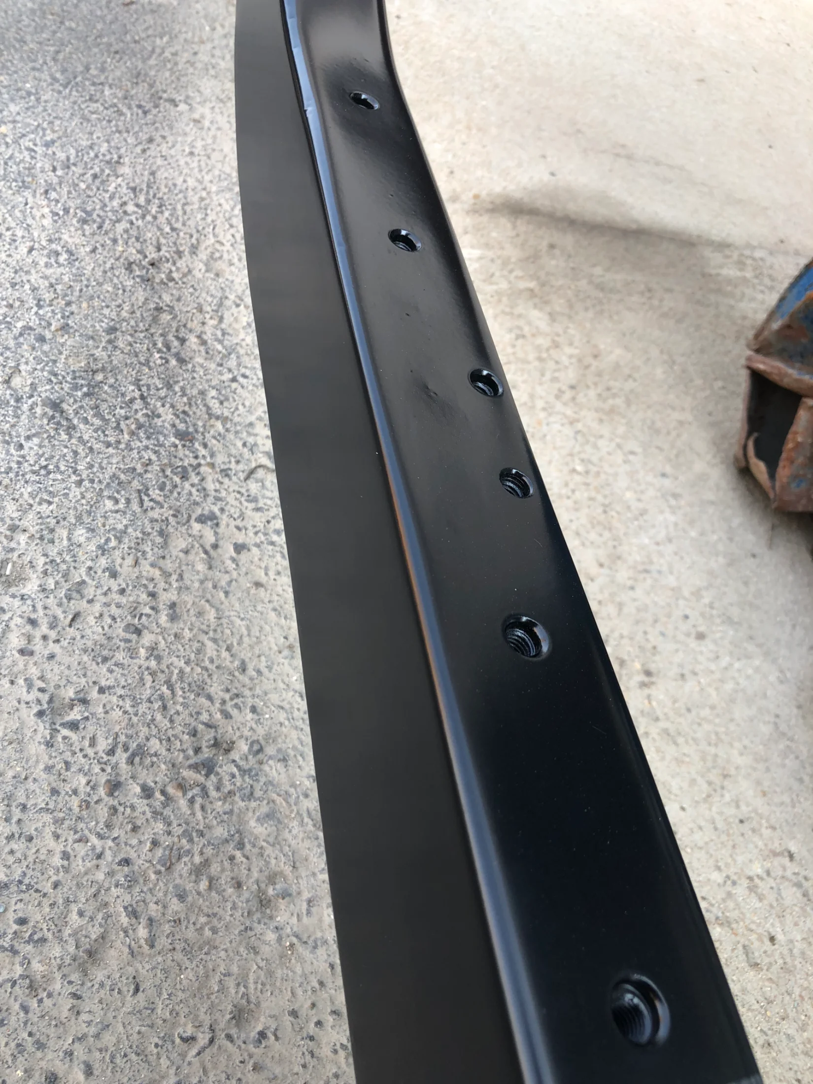

FWIW, I just had my 55 frame chemically cleaned and derusted (total immersion process), e-coated (total immersion process), and finally powder coated. The e-coating in itself is a very robust coating which doesn't really need powder except that it's not UV stable and the black will dull over time. I feel really good that it's coated in every crack and crevice.
First I've heard of e-coating but I like the immersion vs powder coating idea
Can I ask what it cost to get it e-coated?
IIRC it was around $750 but that included the frame and a box of smallish parts that bolt to the frame. The chemical cleaning and derusting was 2x that. If you want to read a bit more and/or ask more you might do it in this thread. Chemical cleaning and e coating starts at post 1046.
