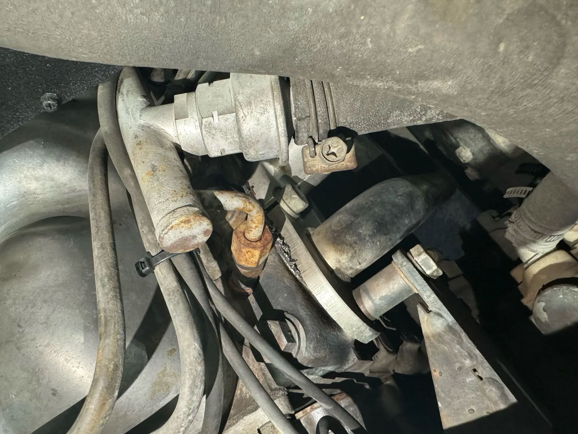

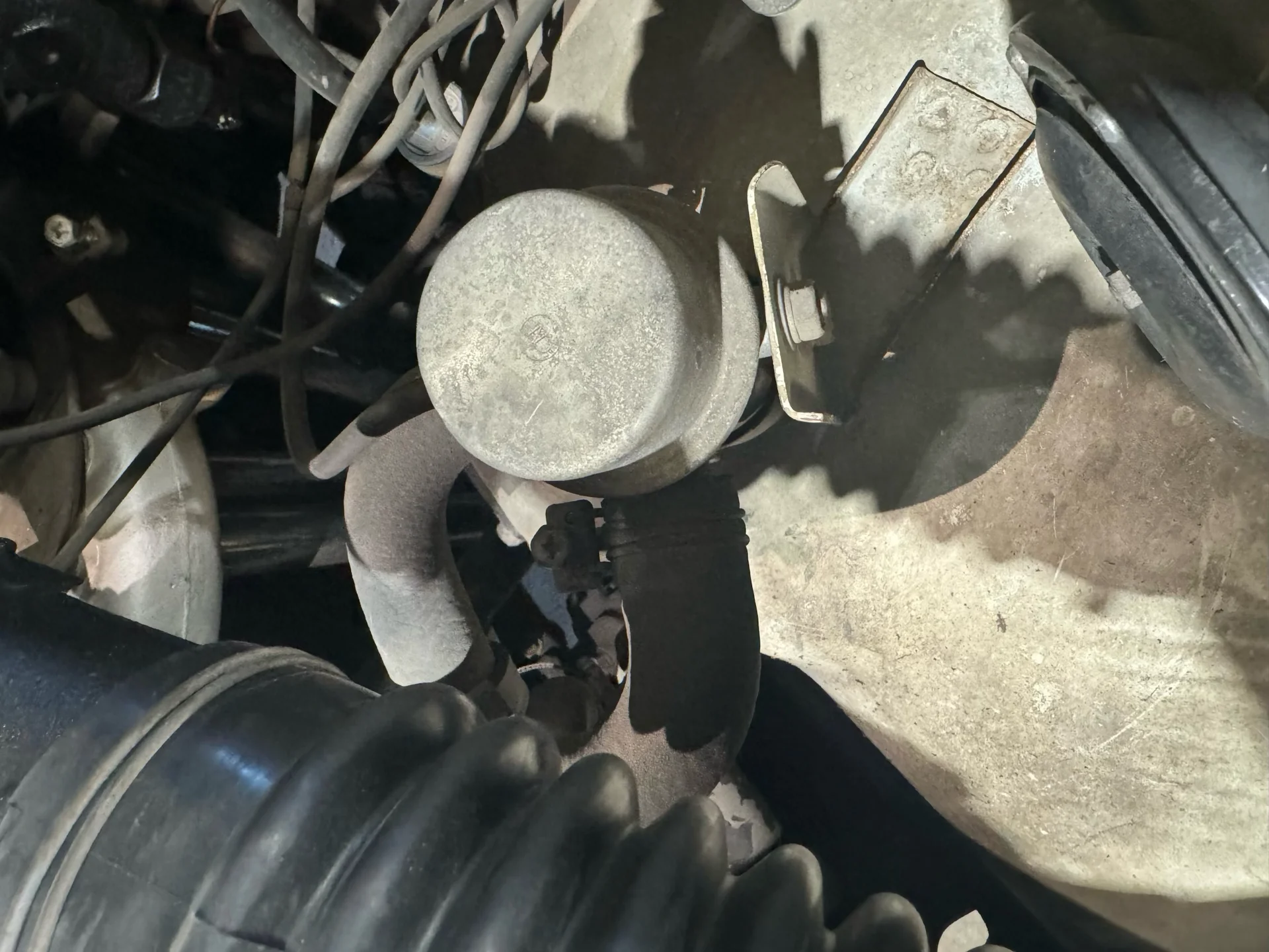

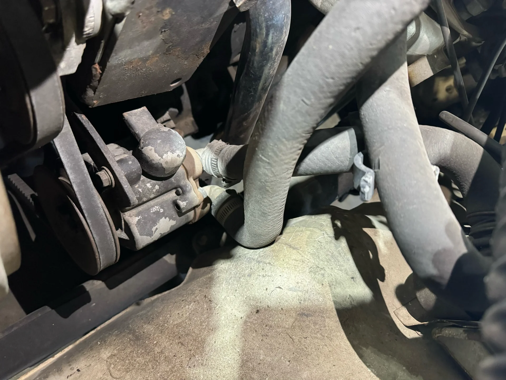

The truck appears to have a Downey/Mark's 2F header on it, but without the provision for an EGR. There appear to be a few pieces missing / disconnected as well. I'd like to refurbish this. I believe I have a Mark's/Downey header with the EGR provision in Austin, and maybe @S14B23Racer can put his hands on it. If not, I can modify one of the stainless headers.
The goal here is two-fold:
  1. be able to register the truck in Colorado.
  2. take the initial steps to have a 2F header in stainless that has CARB E.O. "exception" and is therefore legal in California and Colorado. The former owner of Downey has offered to transfer it to me. (Y'all know I'm one of the crew trying to recreate the Downey/Mark's 2F header, right?)

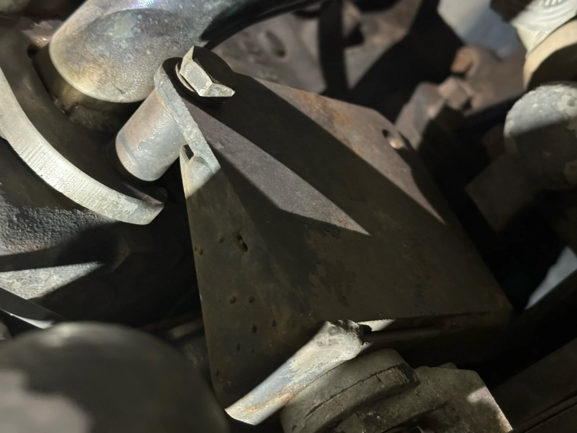

Problem: I have no idea what might be missing, or where to source same, so this is going to be a bit of a challenge. (and no, I don't know what that fabricated bracket holds.)

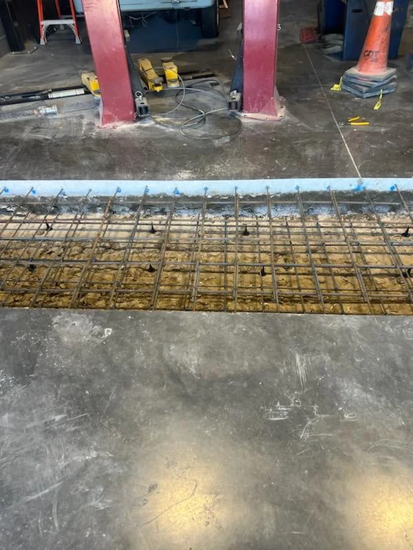

of course, there are challenges everywhere, right? The concrete floor in my shop turned out to be only 3.5" thick (that's less than code for a residential floor.)
  • lift removed
  • 4' x 14' section cut out
  • dug down to min 12" - 13" depth, tamped dirt
  • added 2 rows of 1/2" rebar on 12" centers, tied the top row into the existing slab
  • poured new base for the lift with 4500 psi concrete and a 2% hardener so I don't have to wait 30 days to put the lift back on top of it.
Now I wait.
  • lift removed
Kudos to you for doing it the right way. I know others who don't do their due diligence, not worth the risk.
That's a respectable list; not too long but enough to keep you busy. Nice thing is there isn't anything that requires a lot of downtime so you can keep driving it at will.
It was so nice to find 6"+ of concrete in my shop. Whoever did yours used 2x4 batter boards and stopped there.....shame.
