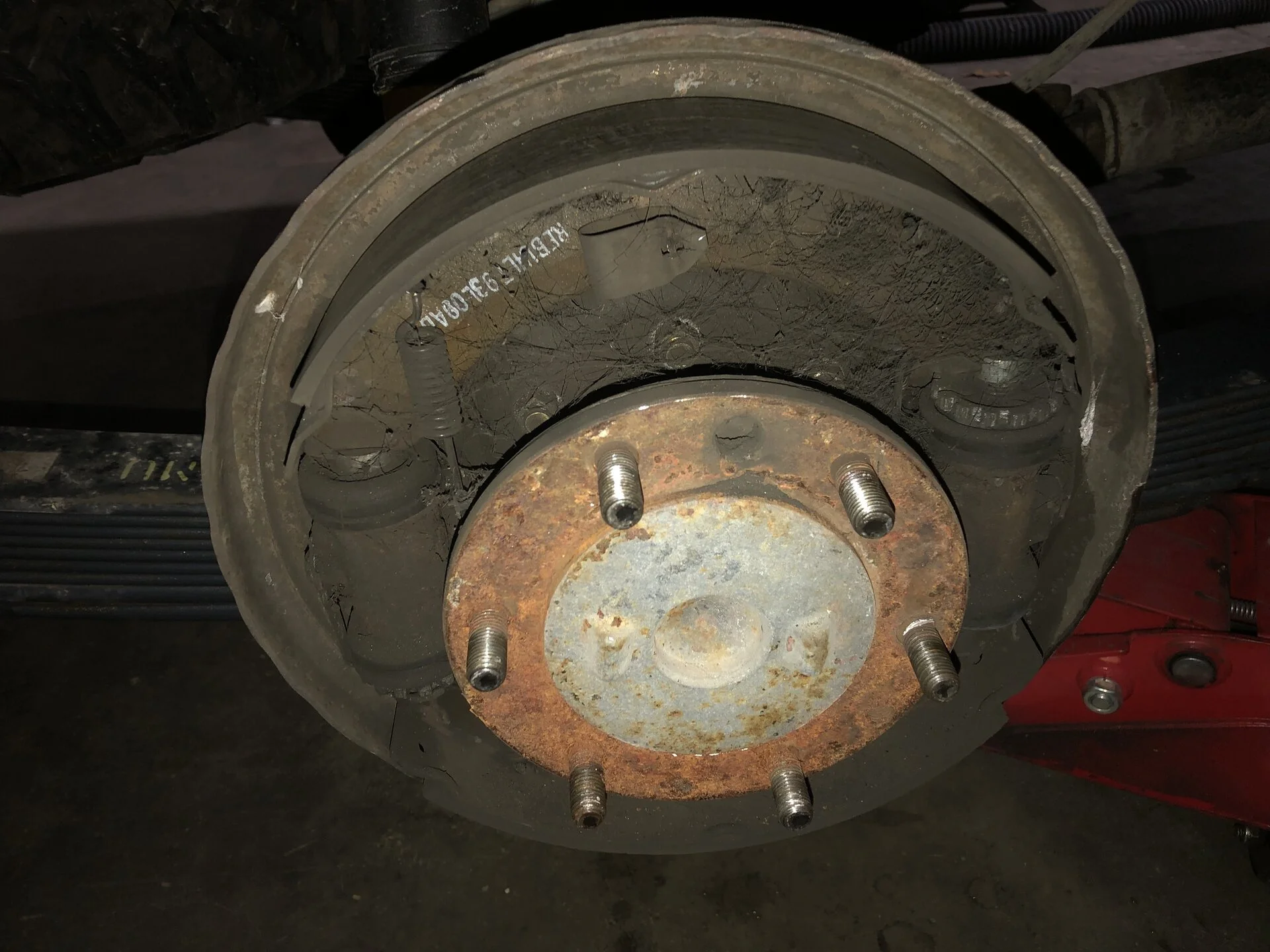

Front & rear brakes look good, stops well. No leaking axle seals or rear wheel cylinders or pinions.
Greasy knuckles but no soup leaking.

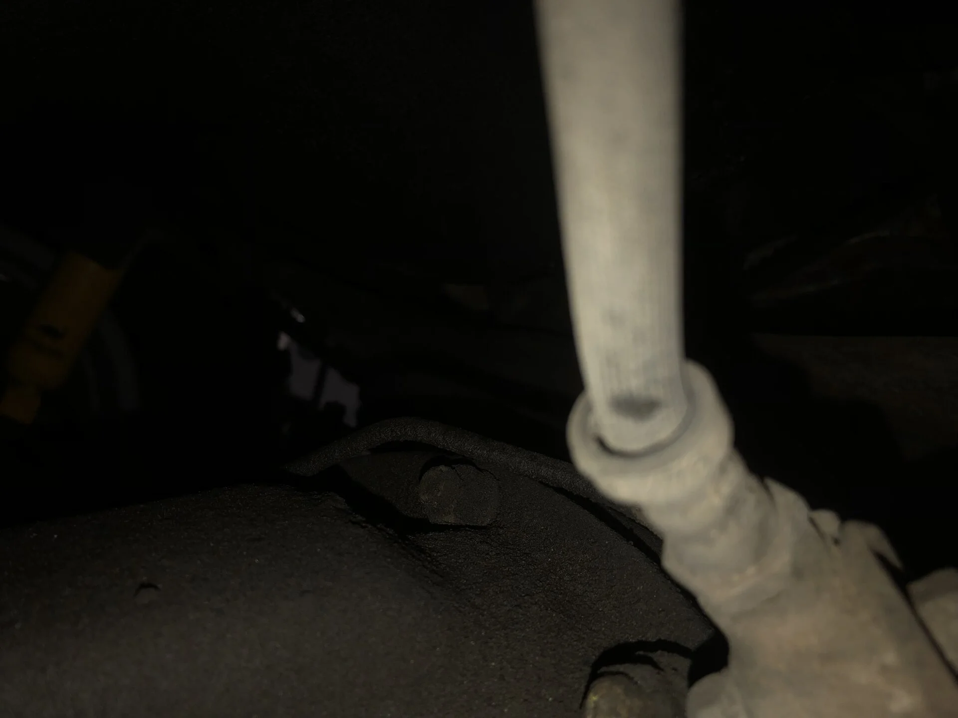

Front brake lines all rotted,
front frame to axle line too short pulled tight.
Rear brake line frame to axle is rotted.
Hard line across axle needs shortening a few inches and reflared.
