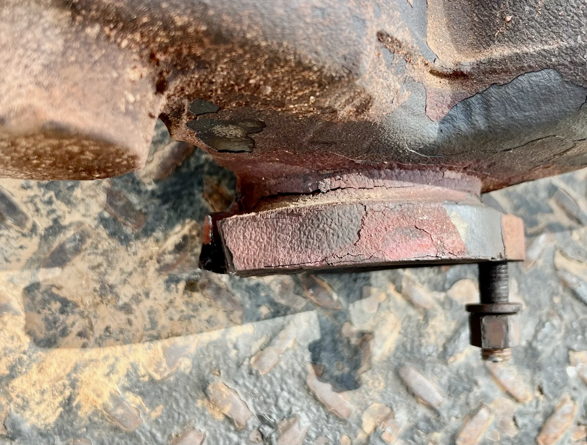

I don't know why it's taken me so long to post this here. Our Toyota Landcruiser has been in our family for over 30 years and has been passed down to me. It was my first car and I drove it all through high school. It has been parked for awhile due to a exhaust manifold crack and brakes. I'll start with the exhaust manifold; I tried fixing it by brazing up the cracks and brazing a stud in where an ear had previously broken off but everything is just too warped for it to ever seal up again. Looking at exhaust headers again for a substitute and it looks like the price has gone significantly since I last checked a few years ago. Should I go this route? If so what brands/sources are the best?

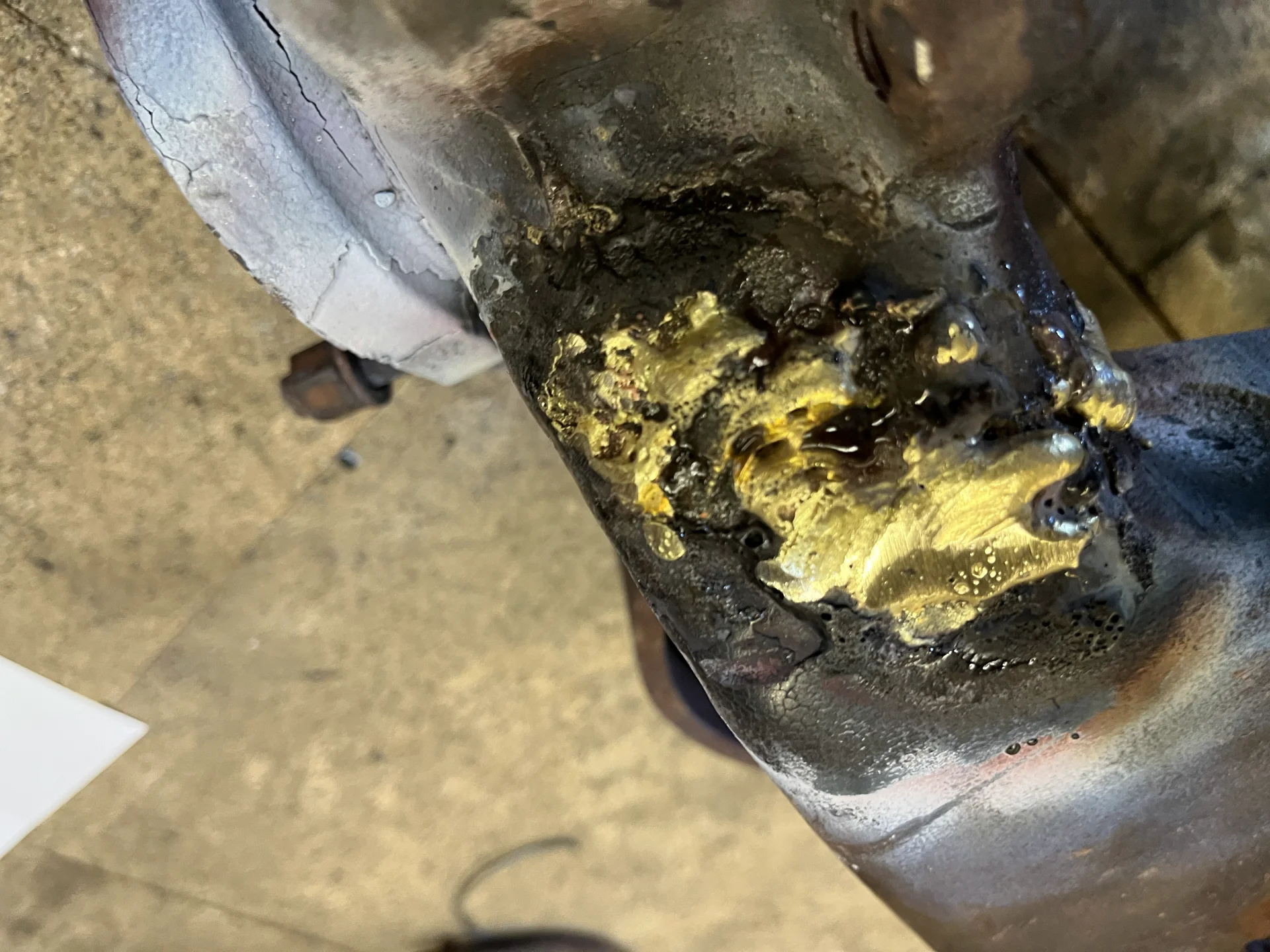

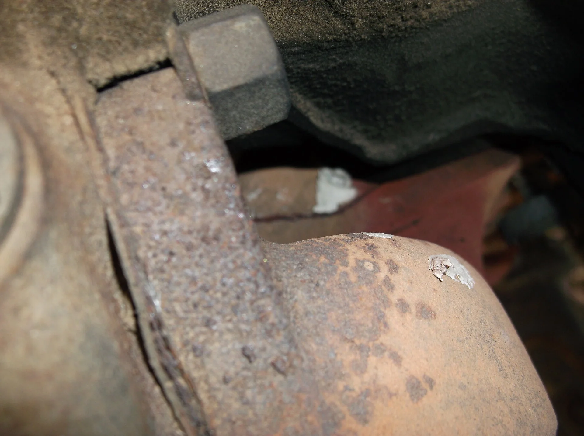

I found some pictures of my damaged manifold along with the "repairs" I did. Also does anyone who's switched to headers notice any difference in MPG or performance with the carb being unheated? Thanks

As for headers, Marks/Downey headers seem decent based on what I’ve read. My 40 came with a different brand… hated the set that came on my 40. They were noisy and always leaked. The 1.5F ran way better and got better economy after going back to a stock manifold. Unless you are going to tune an F motor to be optimized for headers I’d get another stock manifold and call it a day.

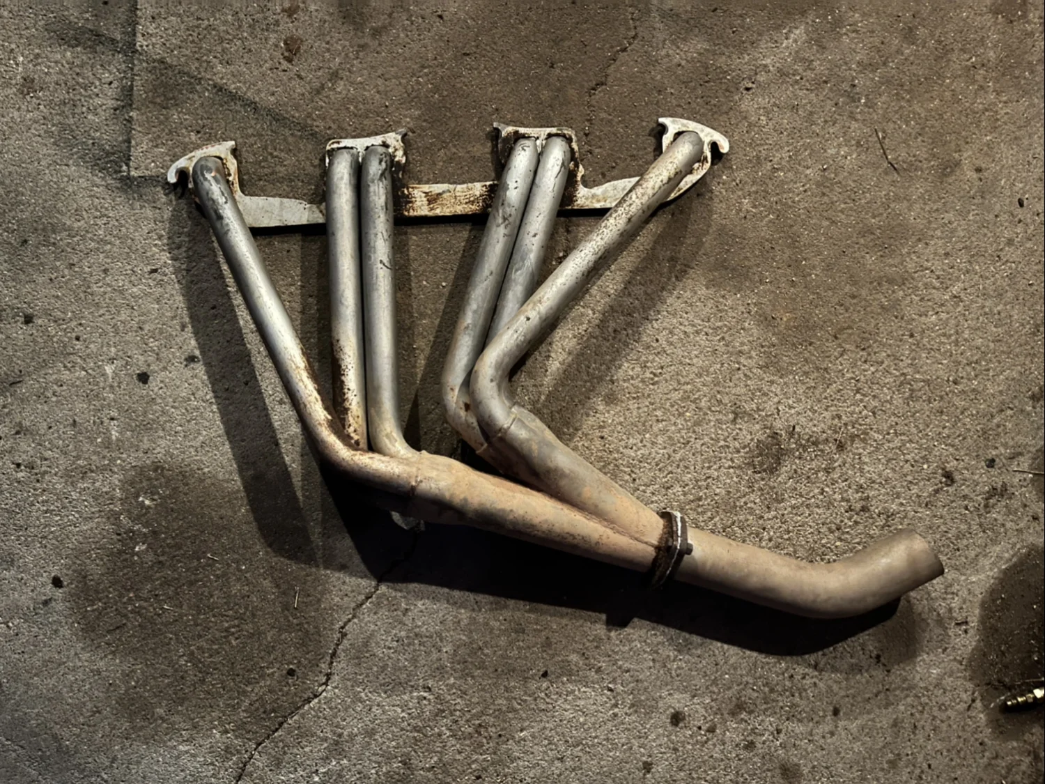

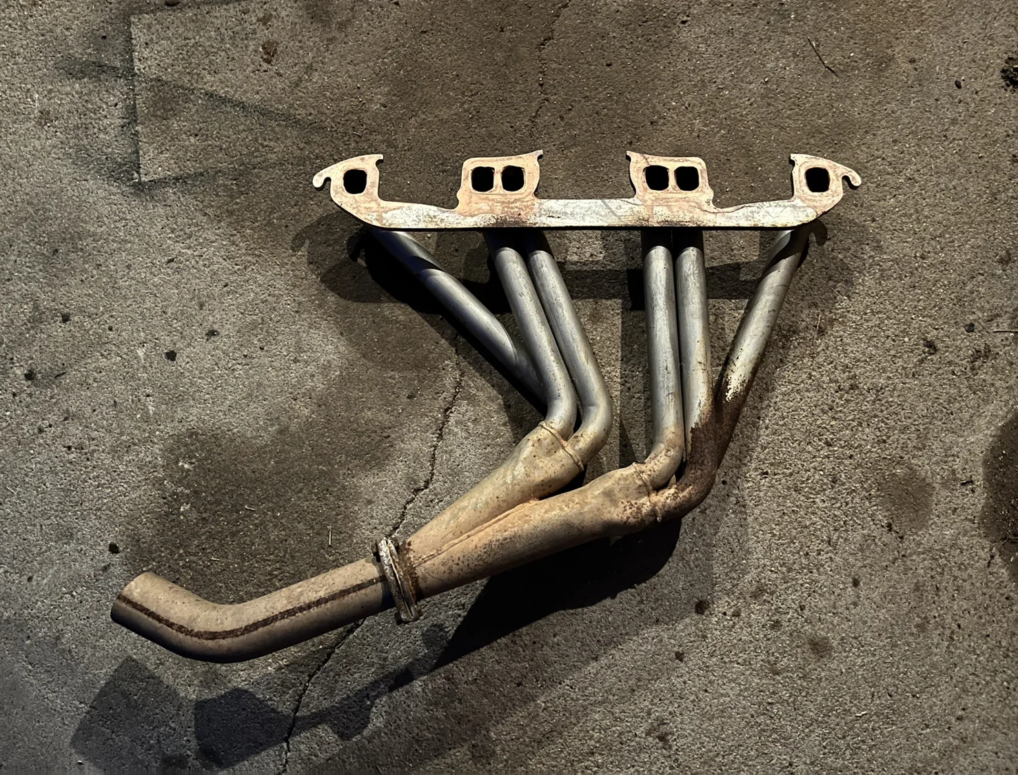

The day has finally arrived! Thanks to @cjmoon for the exhaust system and headers, now I can get going on this project again!
The next big hurdle to leap over is brakes. I think I want to go with an fj80 master cylinder but I read somewhere that it has an integrated proportioning valve of sorts. Since I will be keeping the 4 wheel drum brakes is it possible to eliminate this valve? Thanks

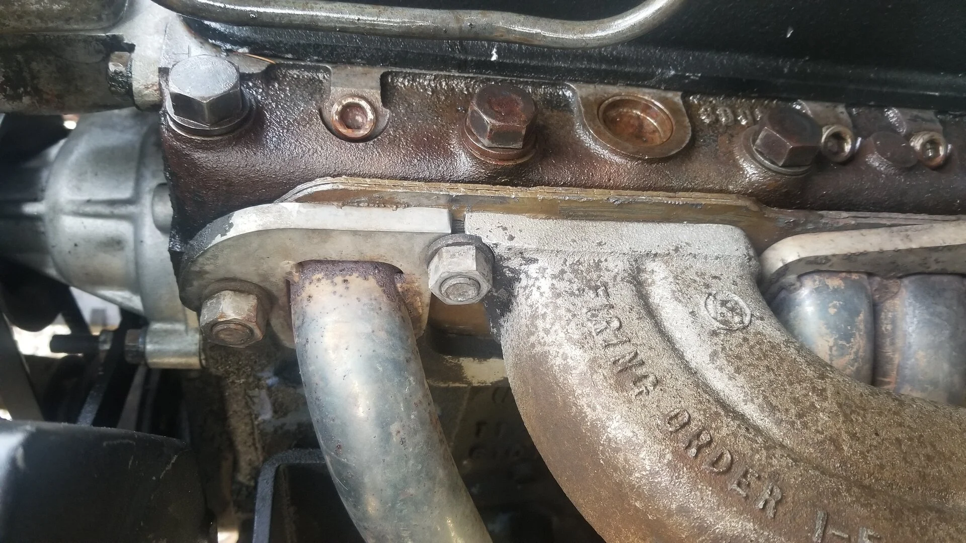

any pics? I have a set of 3FE manifolds on the bench and in most cases they are plumbed together and then back to a muffler. Did you use the 2 inlet muffler? Assuming your running a carb as well but also asking as I planned on adding an O2 sensor bung when I put mine together.
Here are some pics. Since I have a F1.5 engine do I need to cut off the end bolt flanges? Are any coating or wrapping recommendations?
After looking back your right I do have a provision for a stud although not sure if its threaded. My old exhaust manifold didn't have the provision for the stud.
