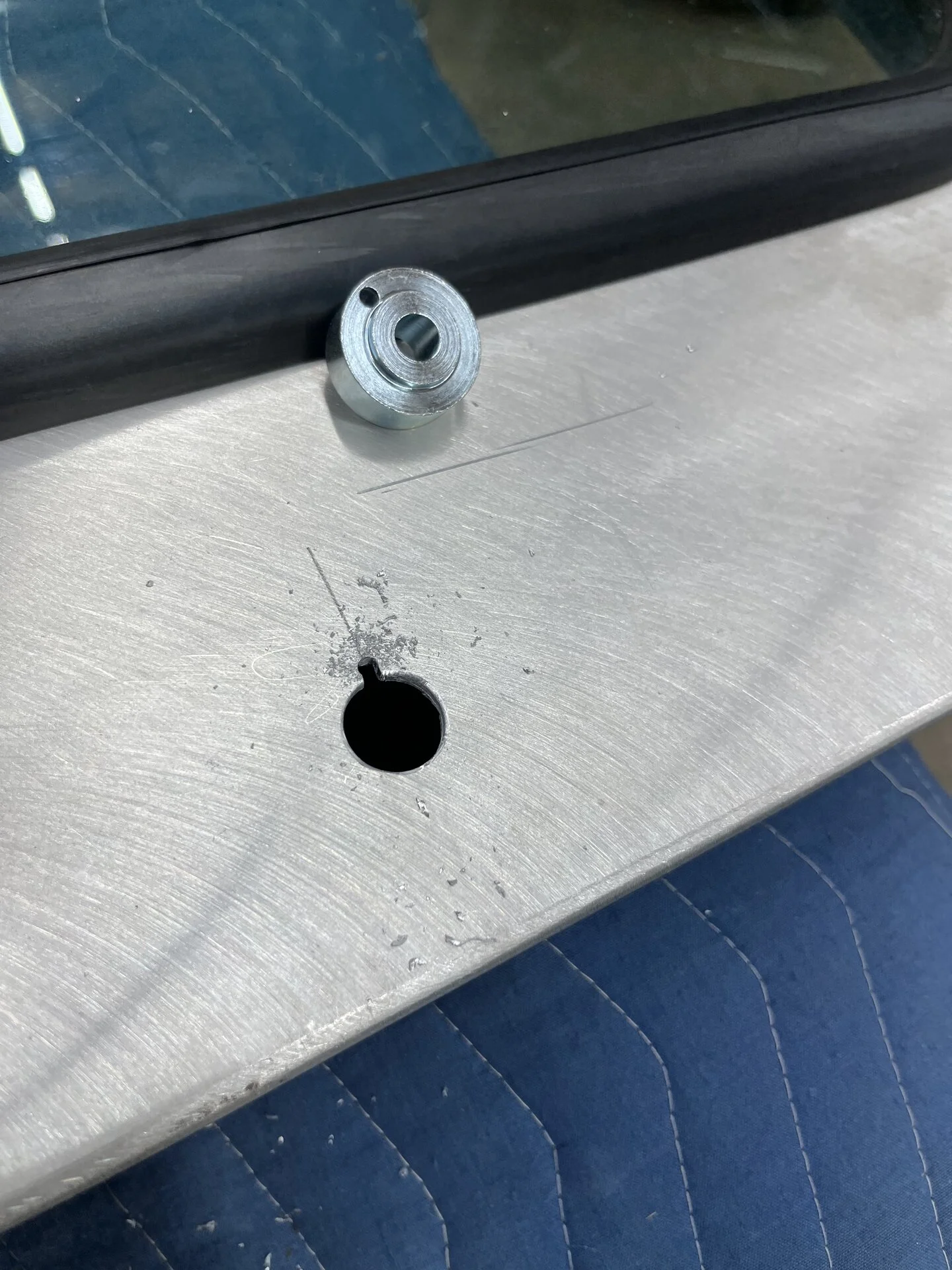

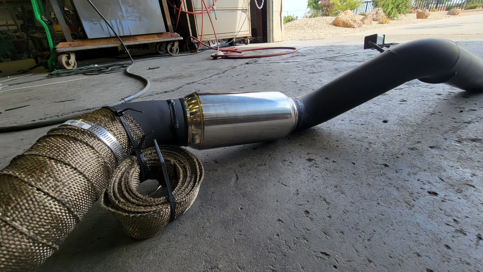

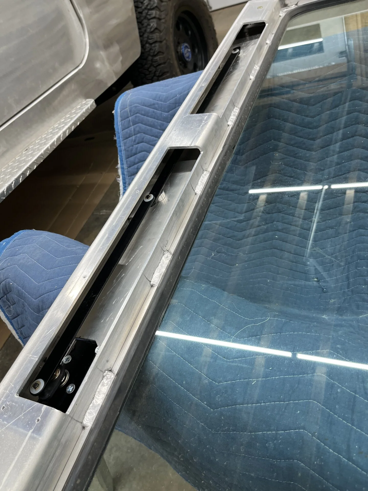

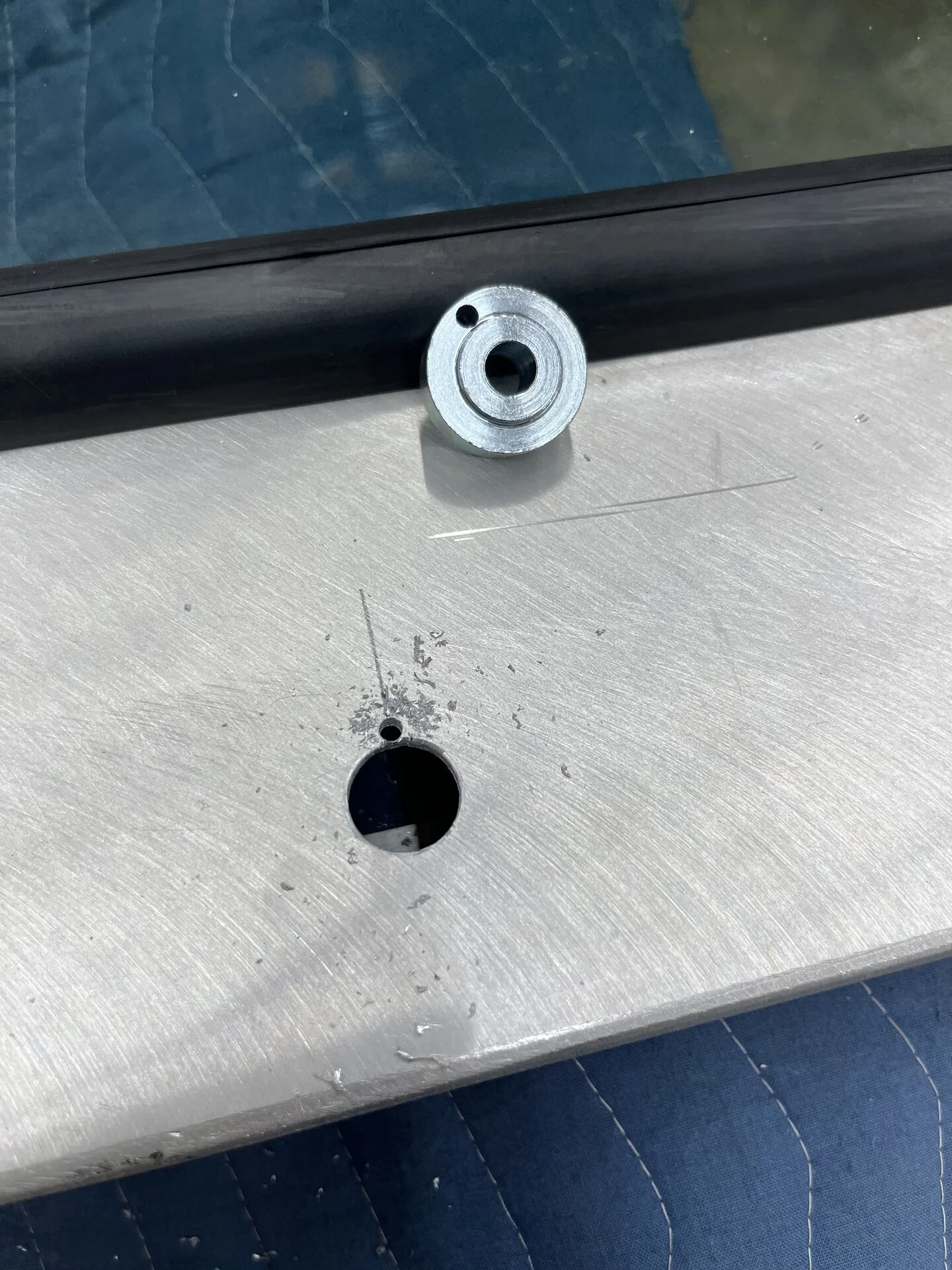

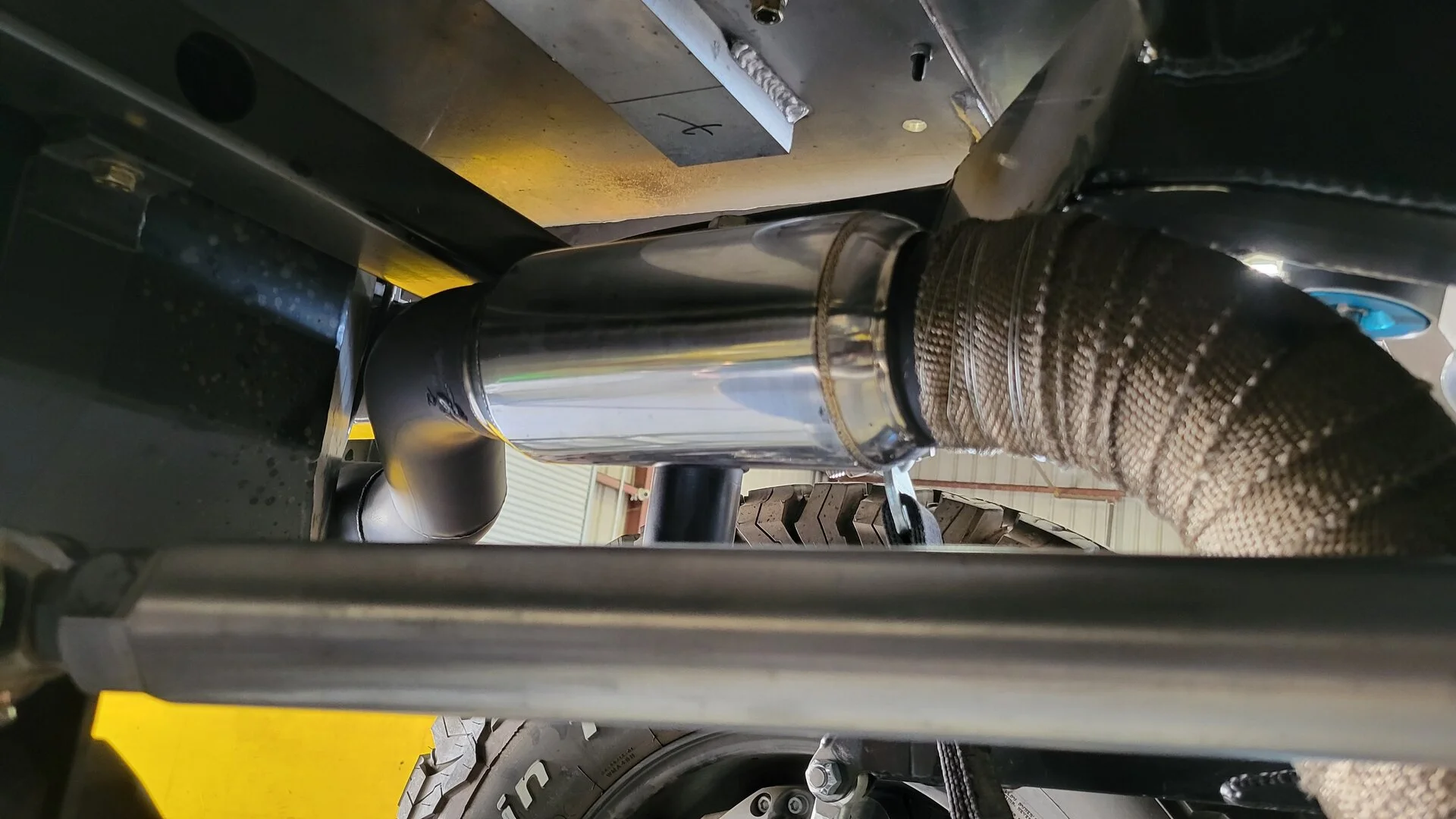

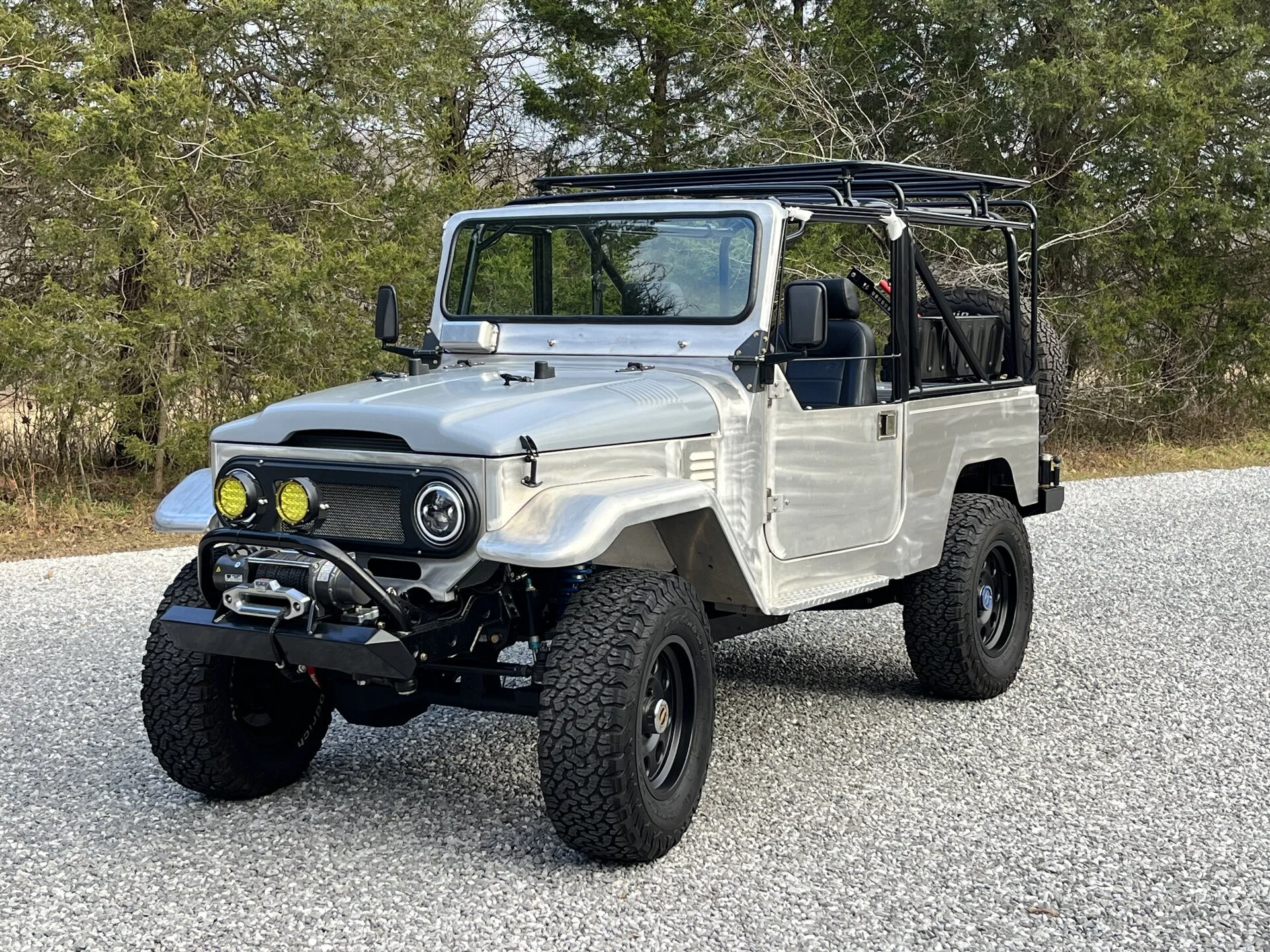

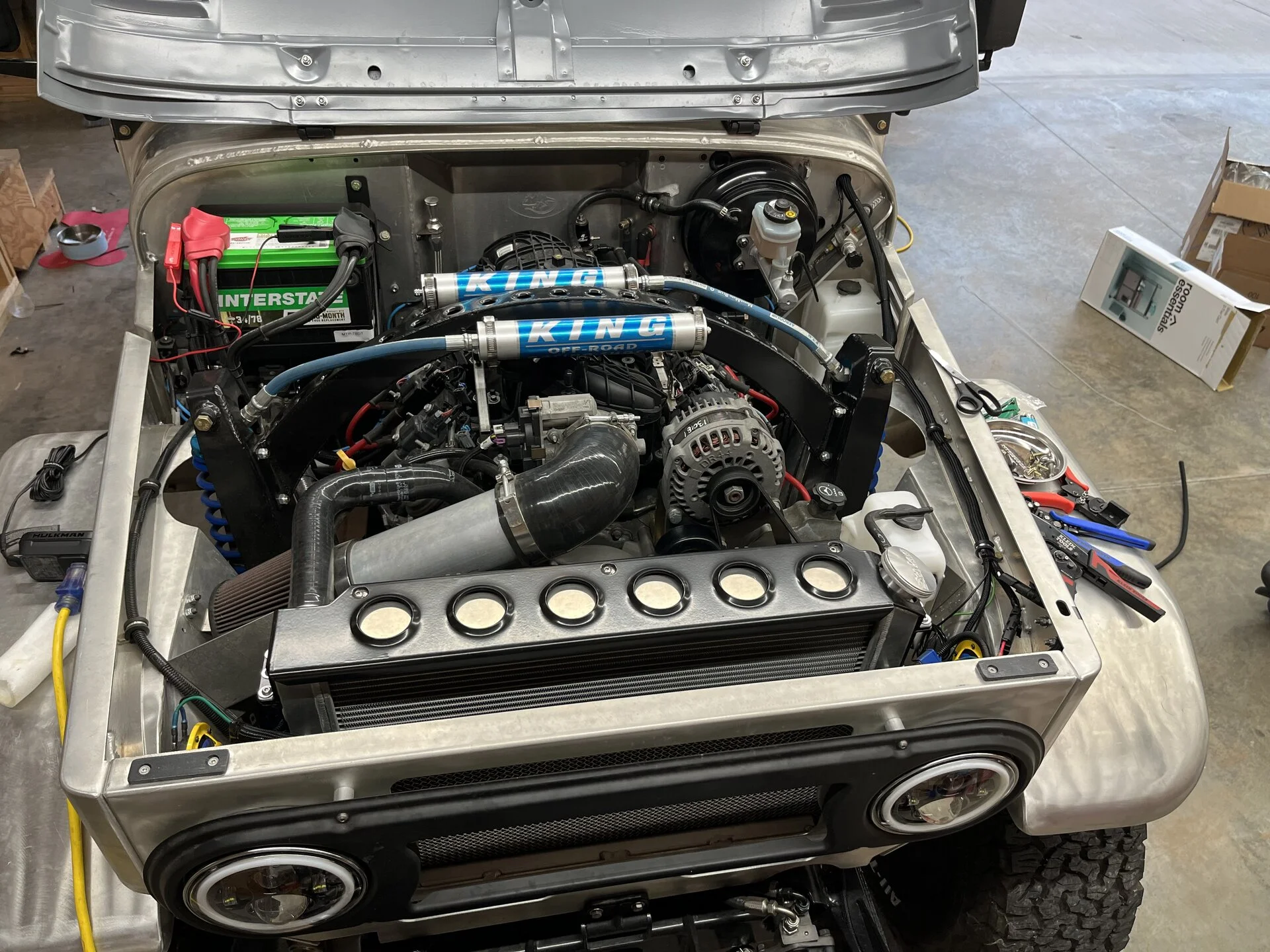

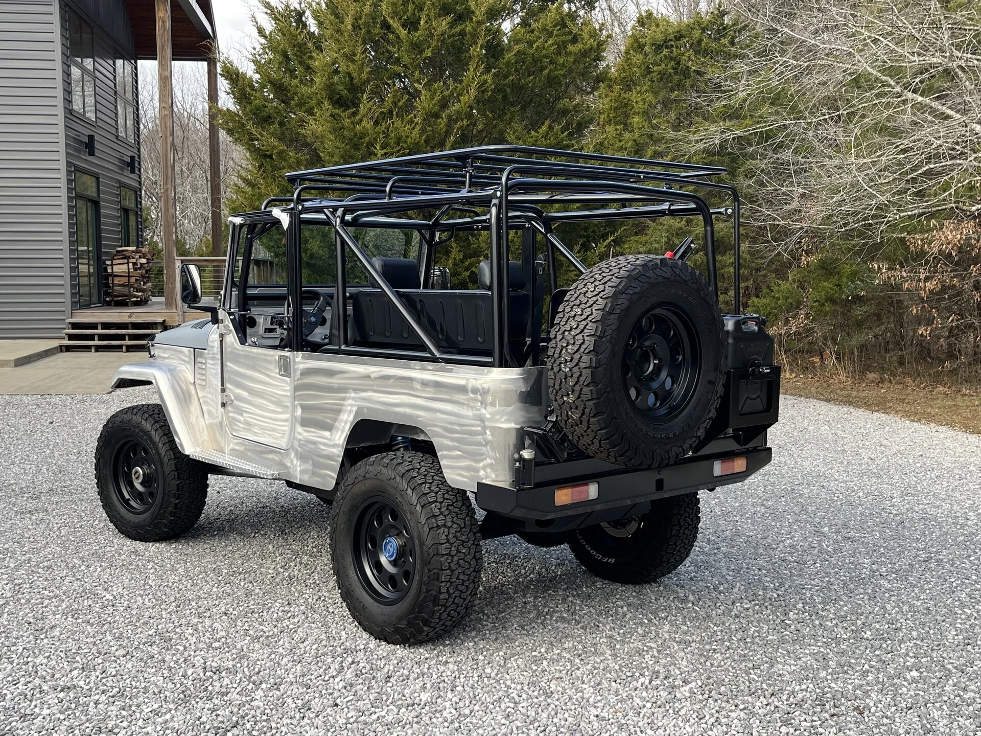

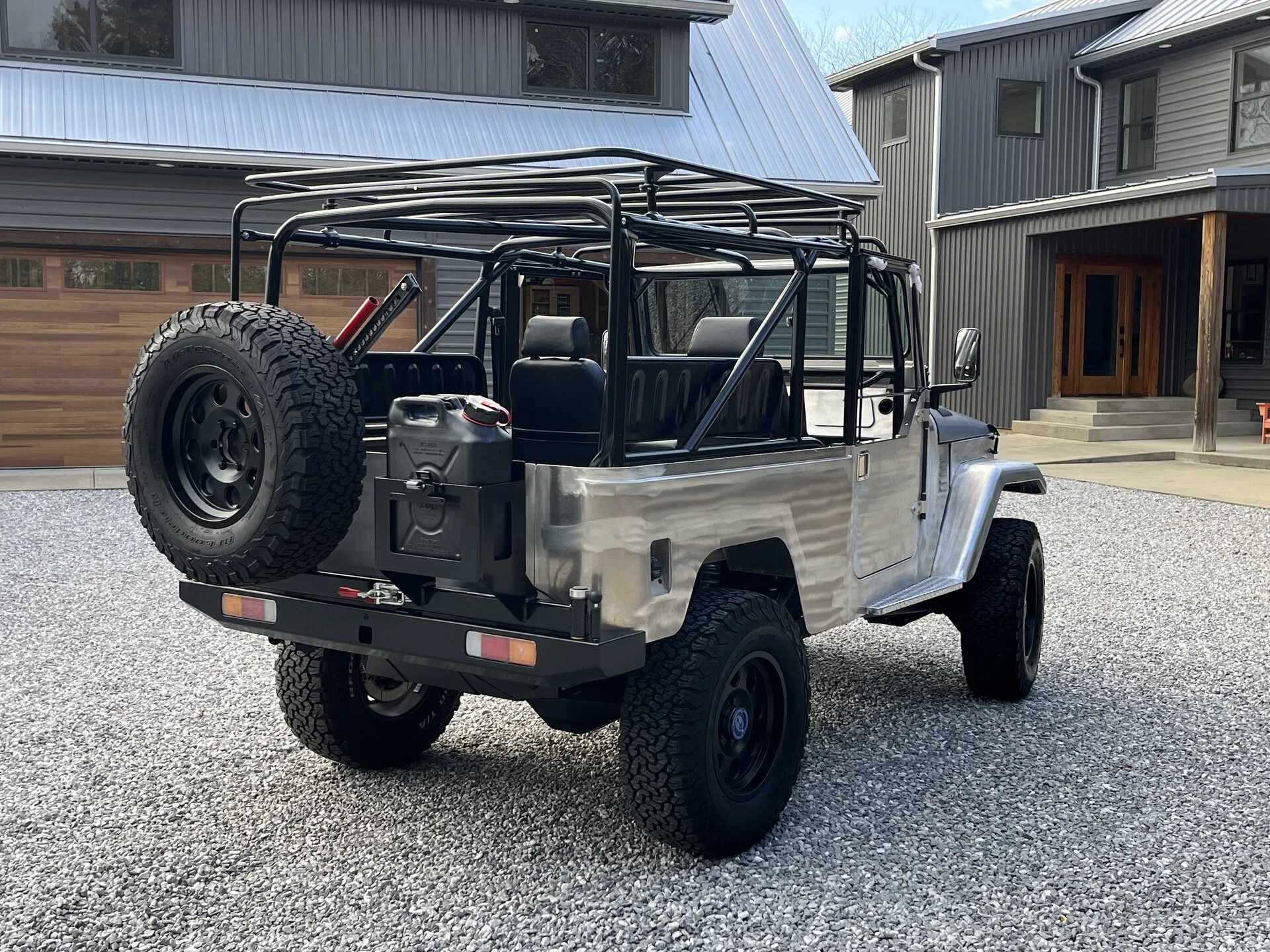

Previous post was heavy duty brackets for windshield frame stays. Addition to exhaust to mellow it out a bit.

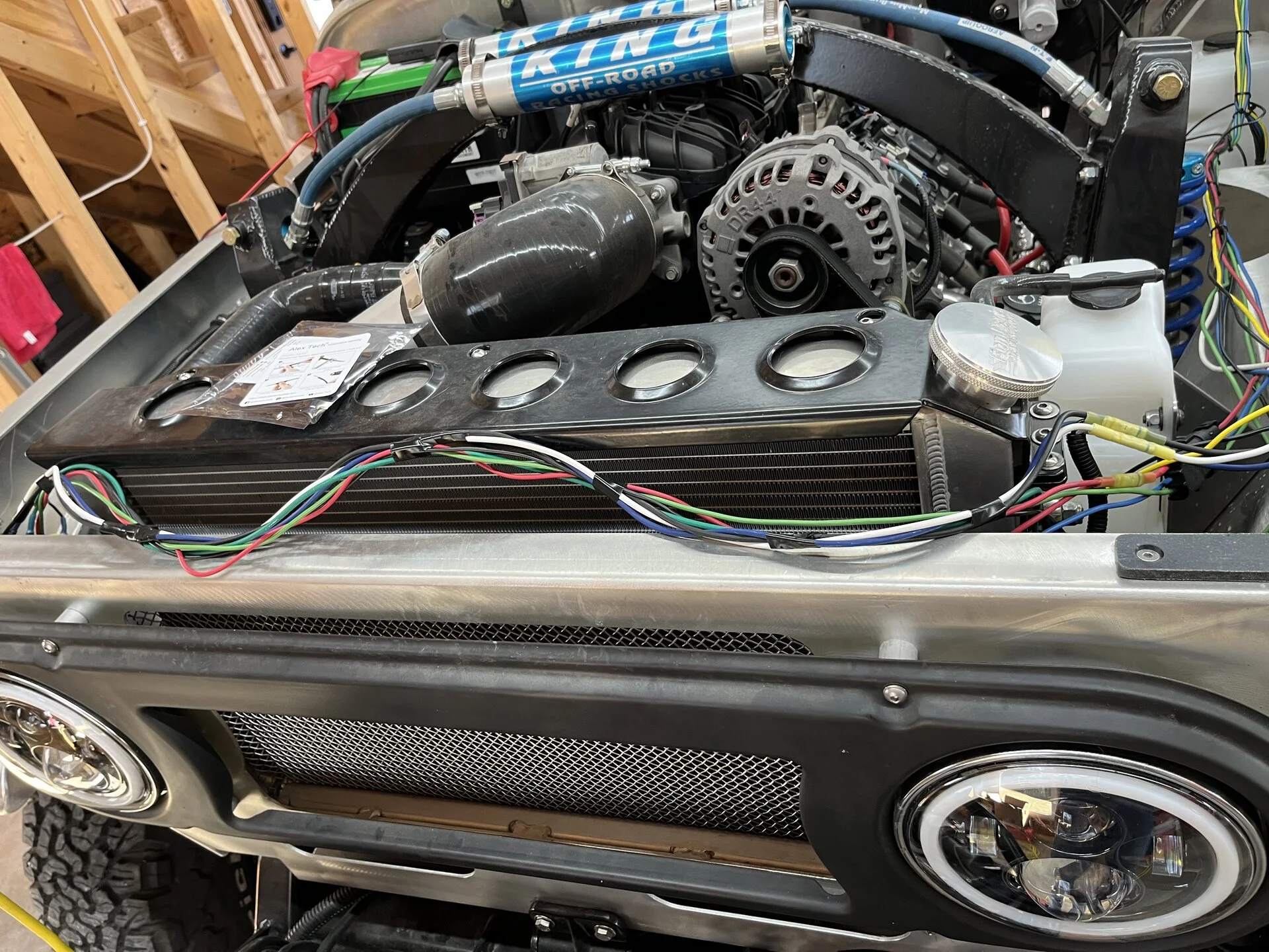

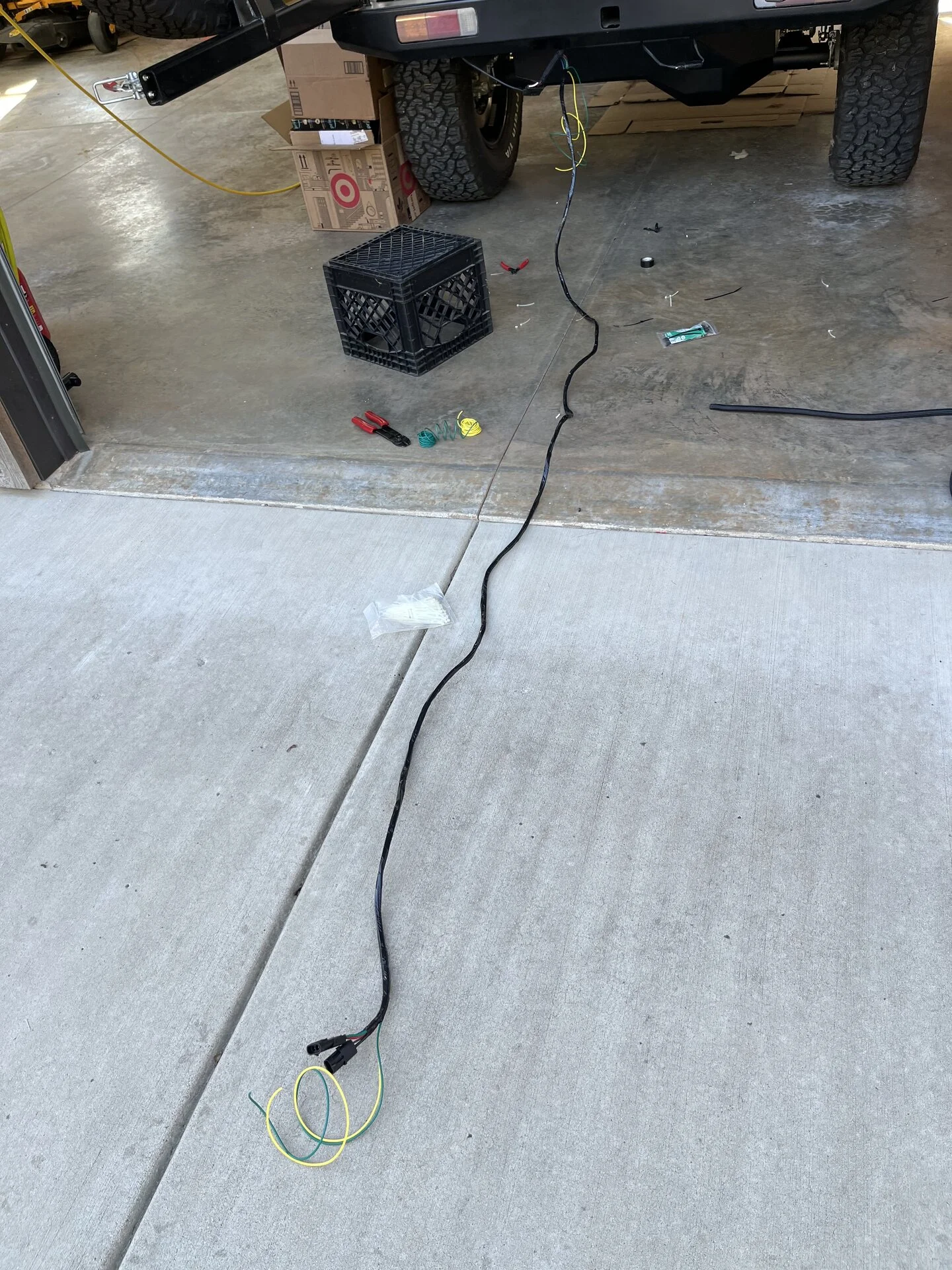

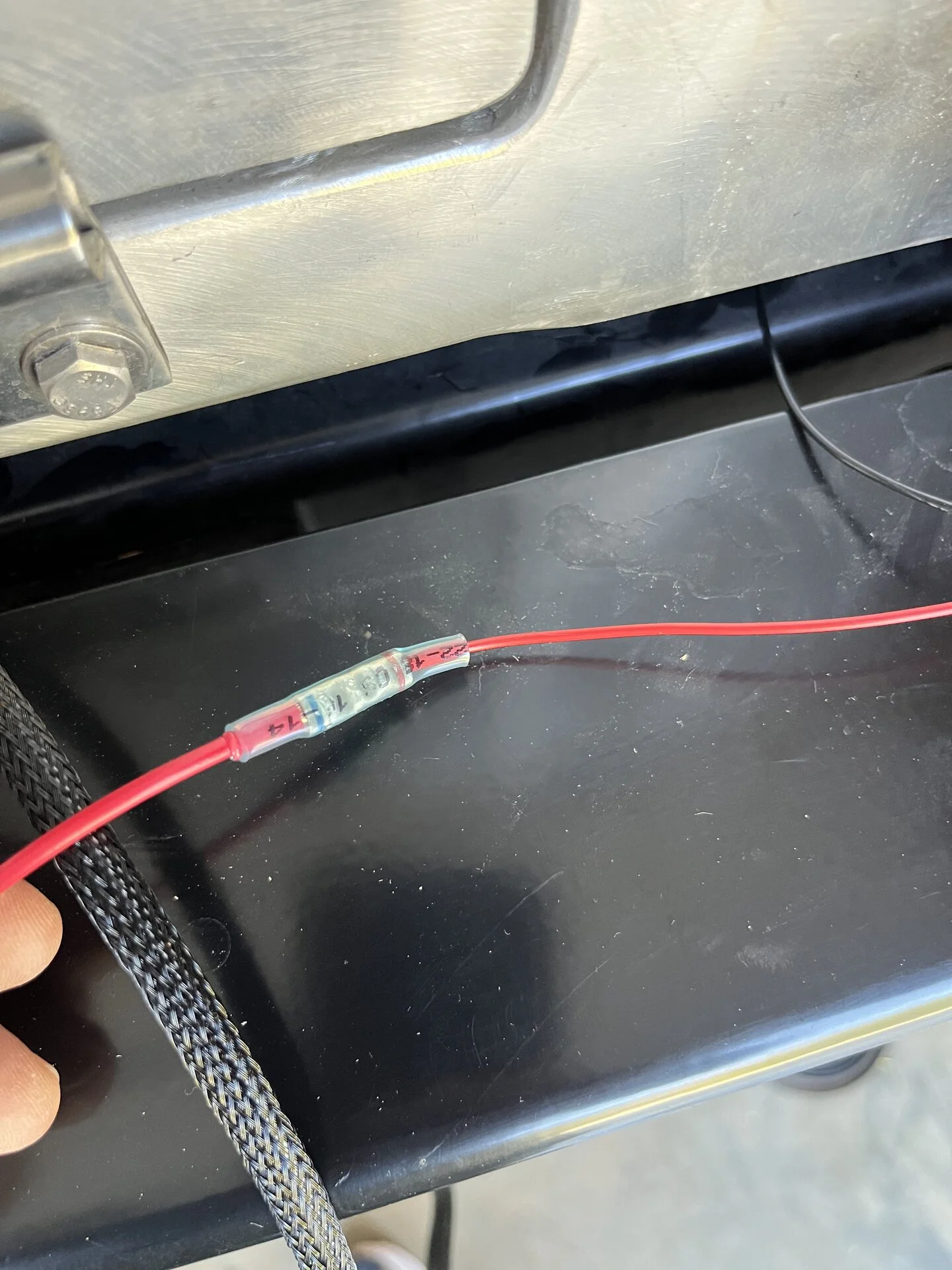

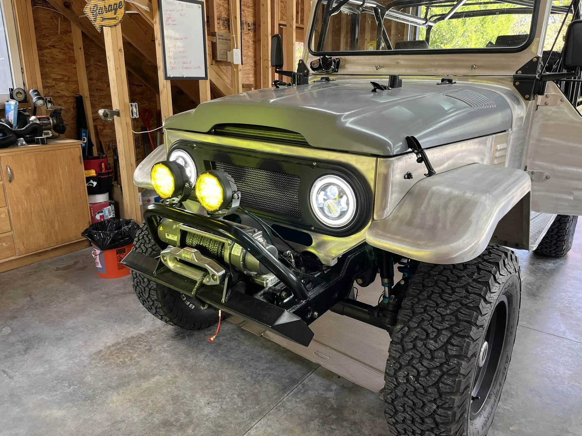

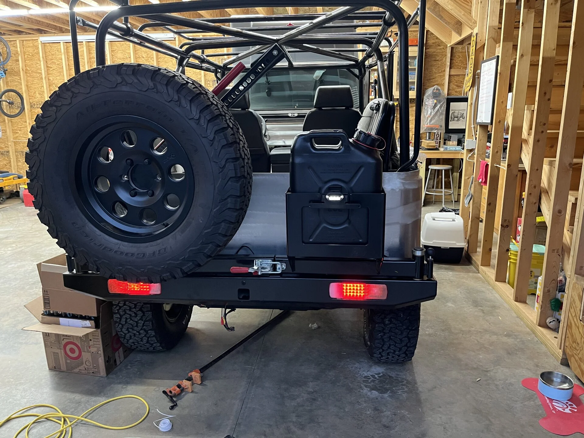

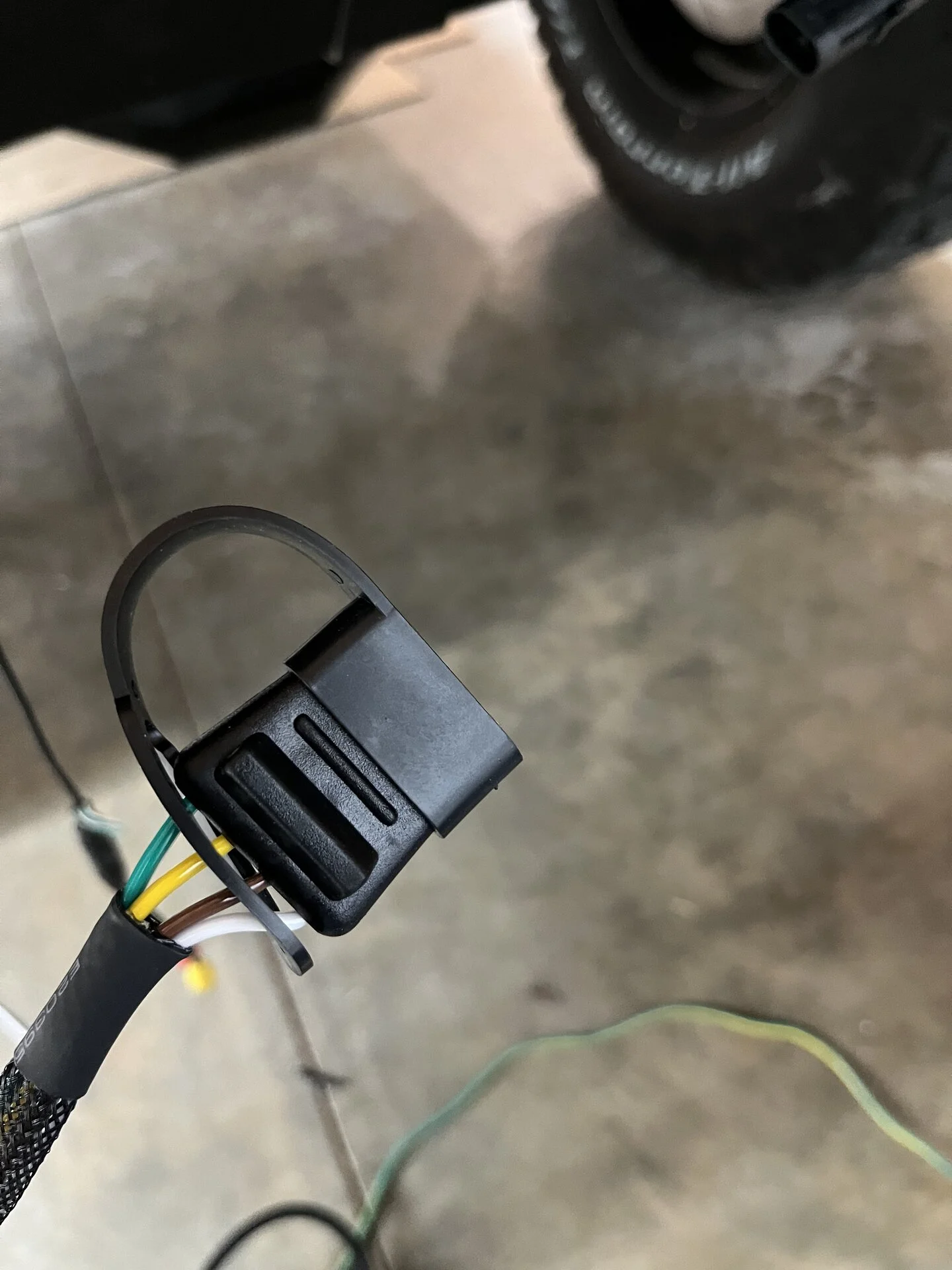

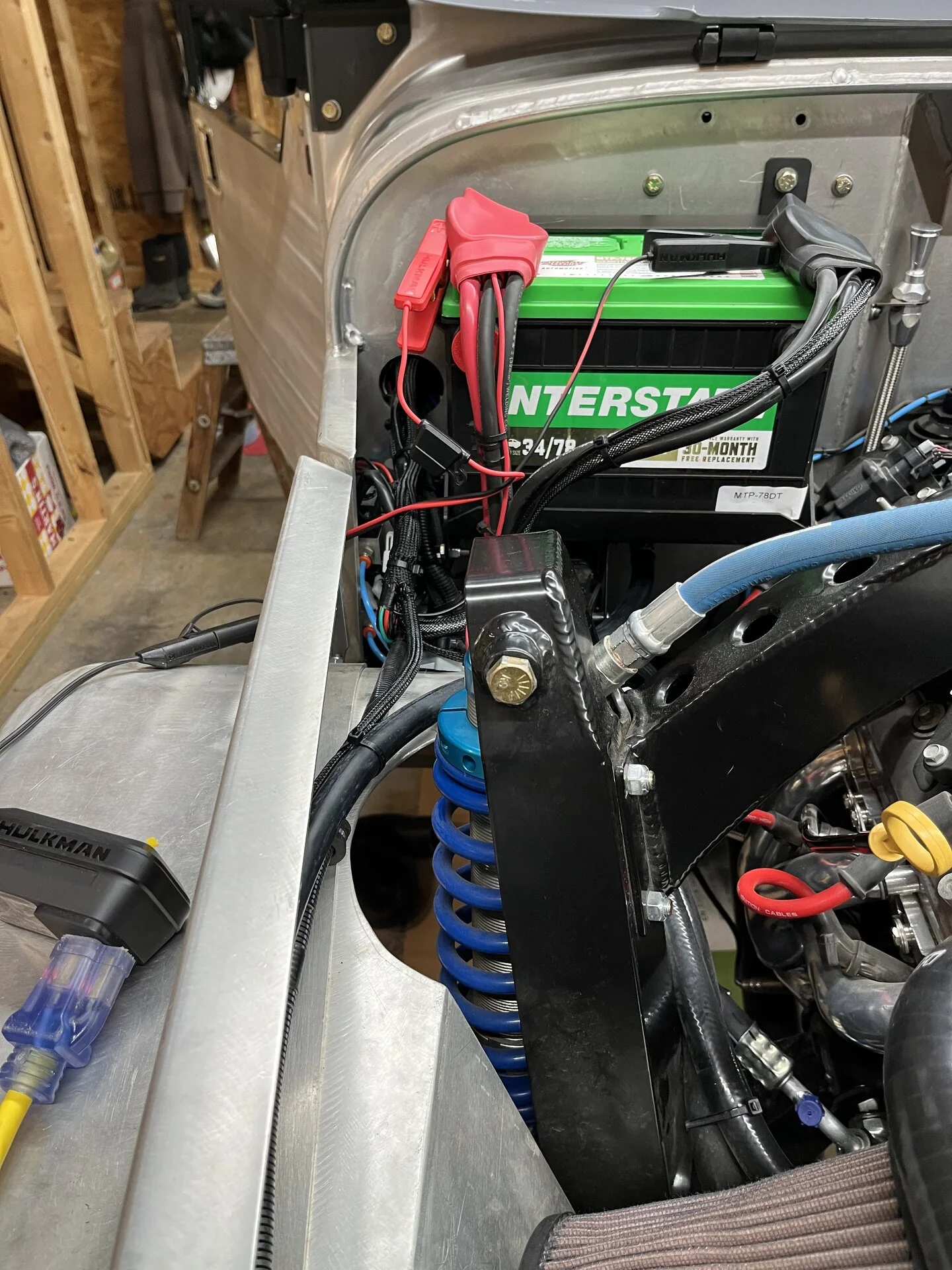

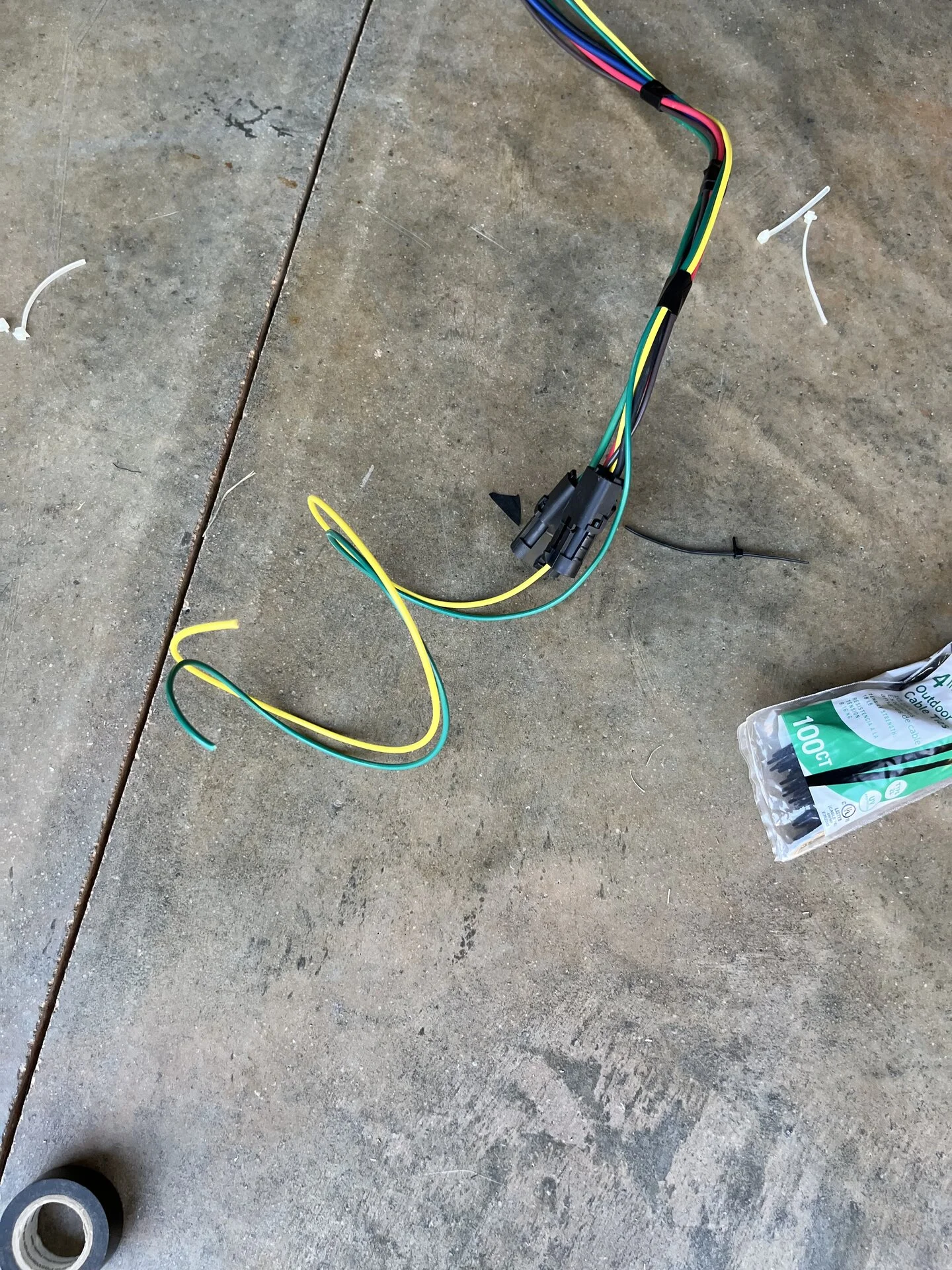

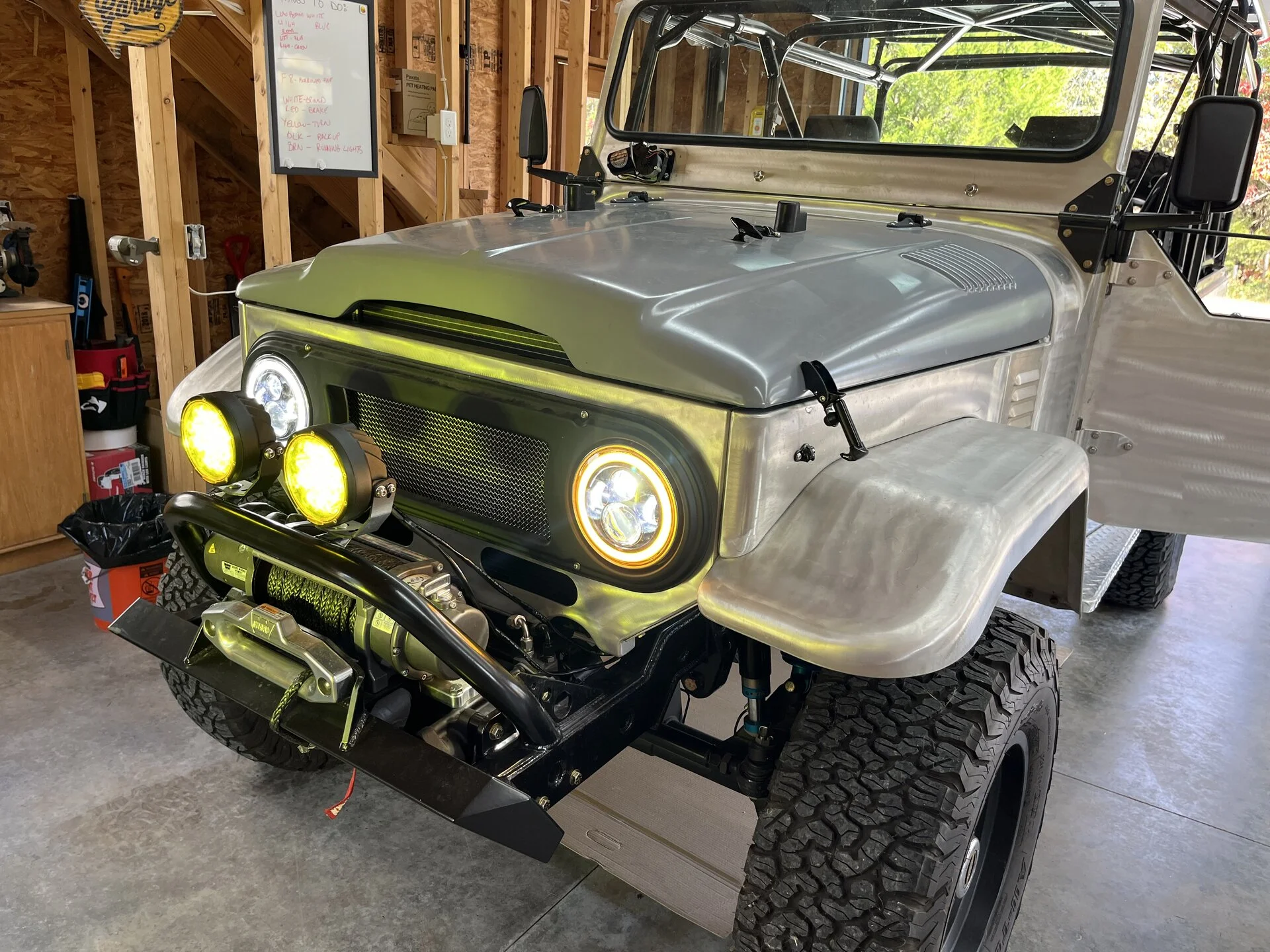

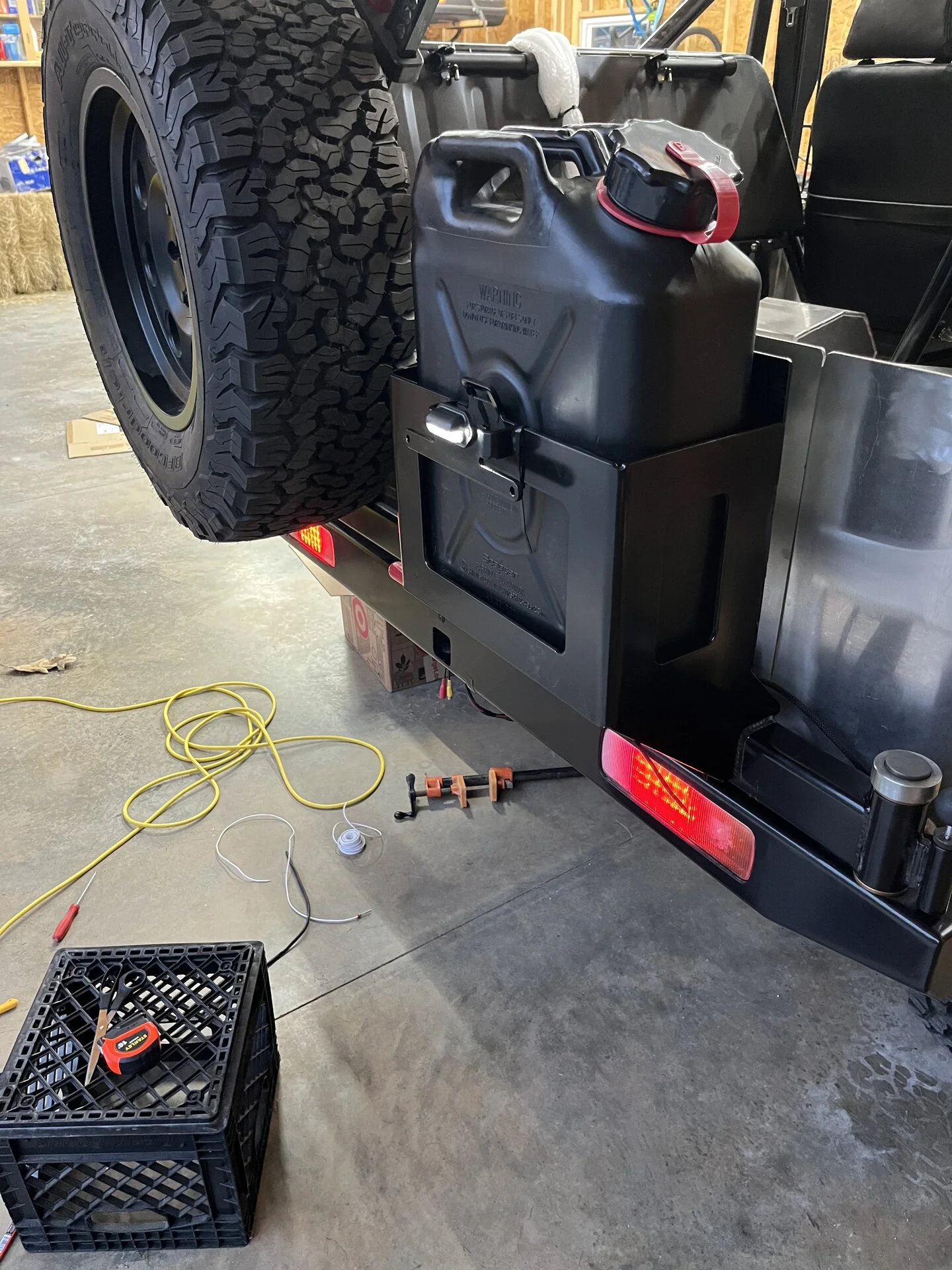

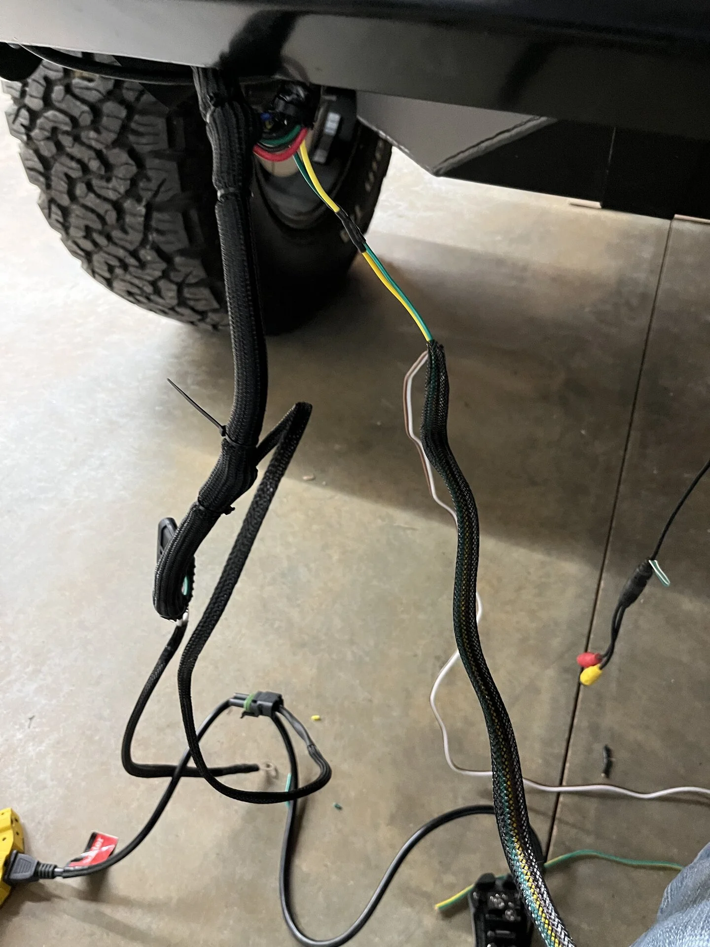

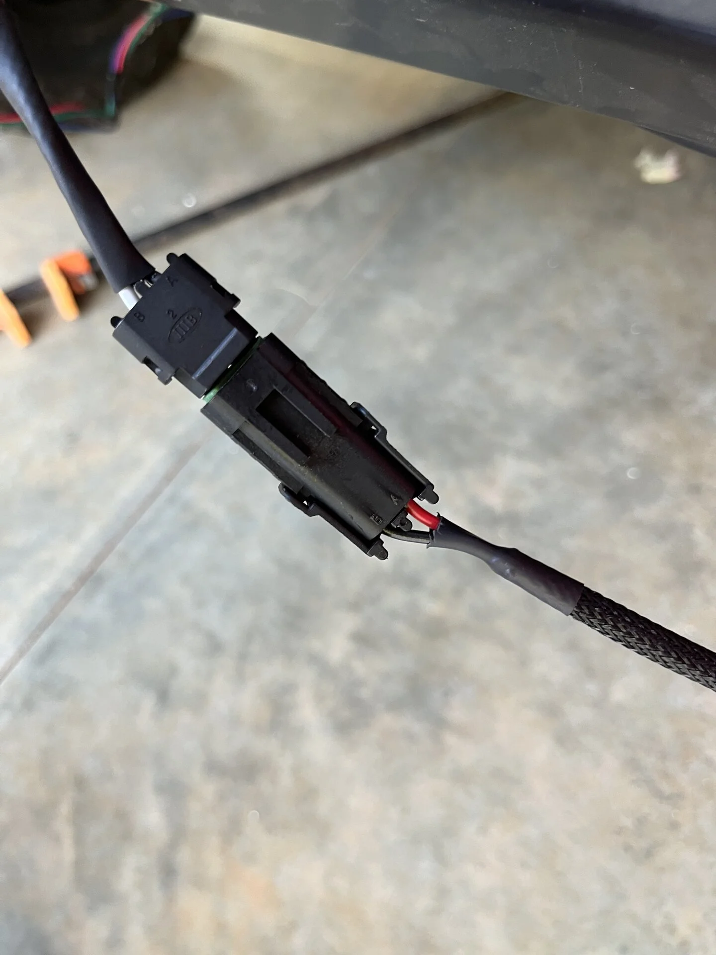

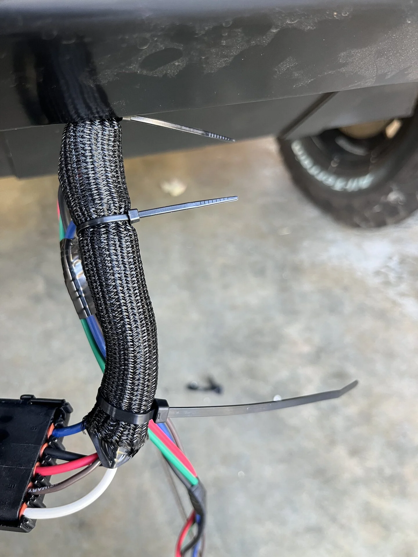

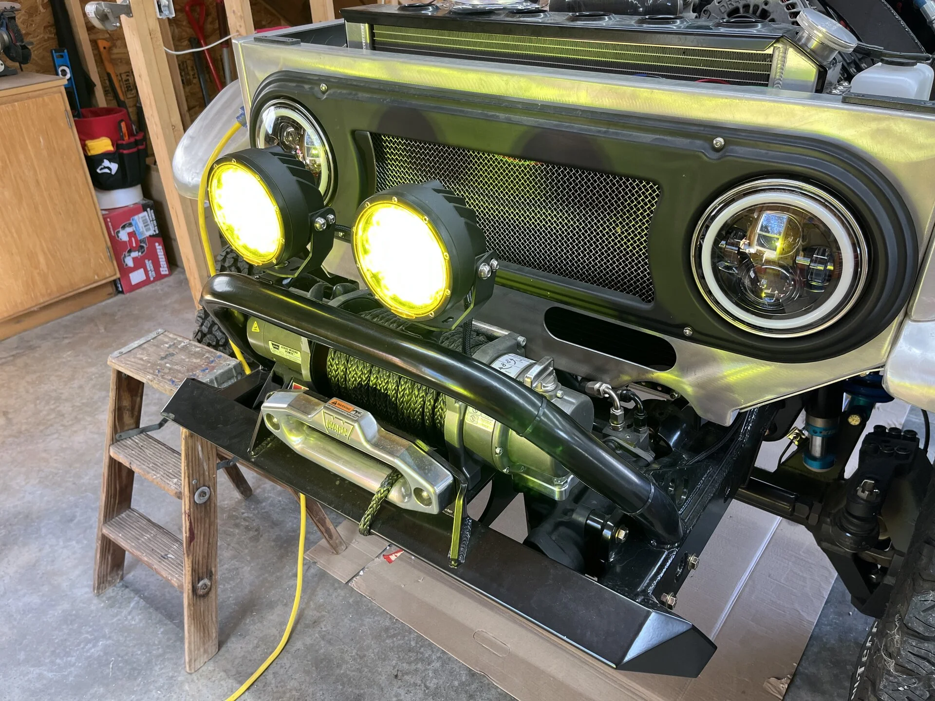

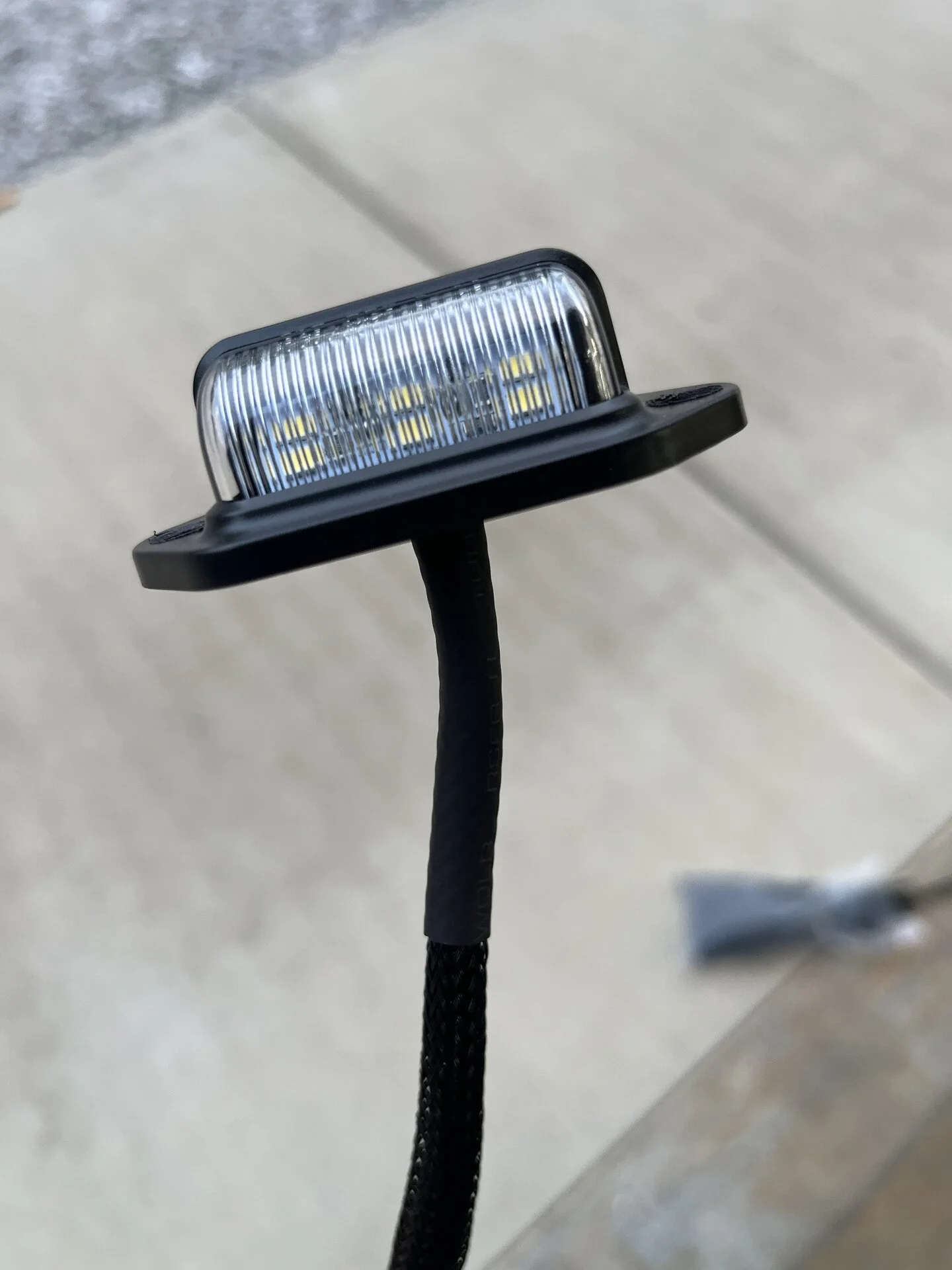

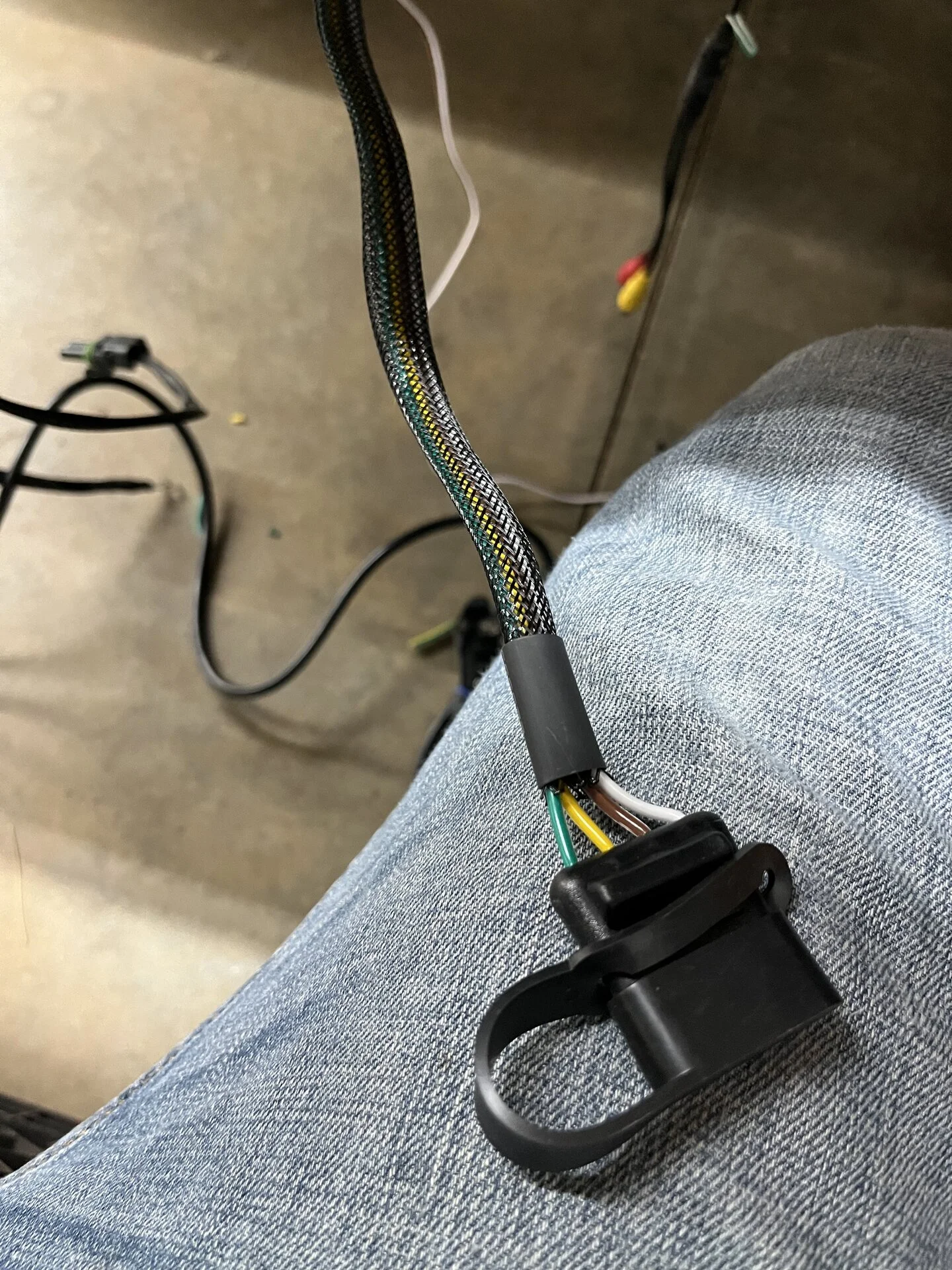

Chassis lights, all LED, wired. I went with these projector halo lights so they could incorporate the turn signals. This is wired separately so if the next owner would prefer turn signals on the fenders it would be easily done.

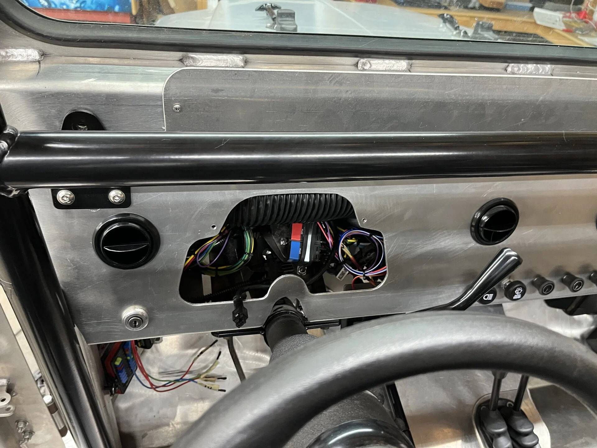

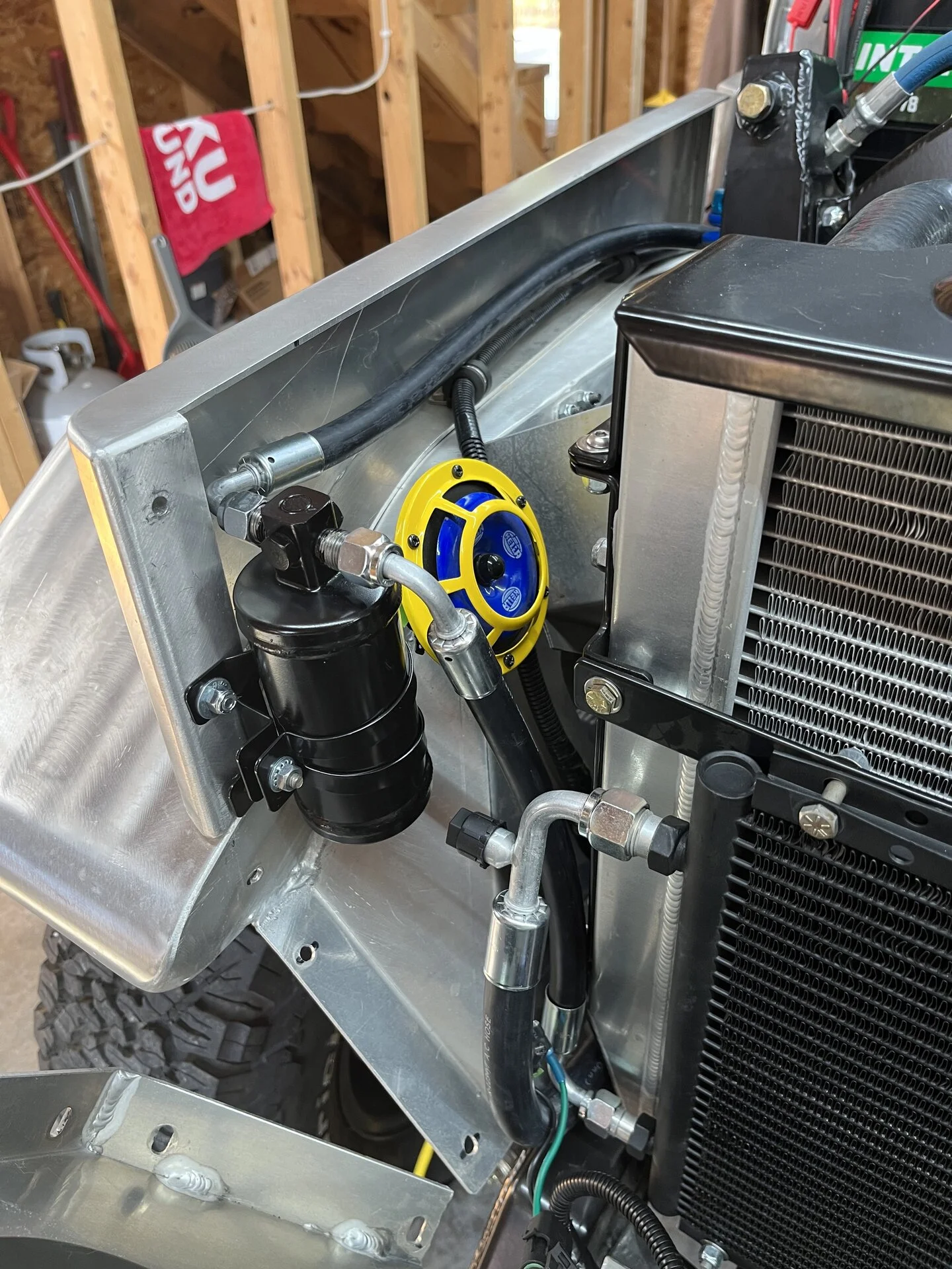

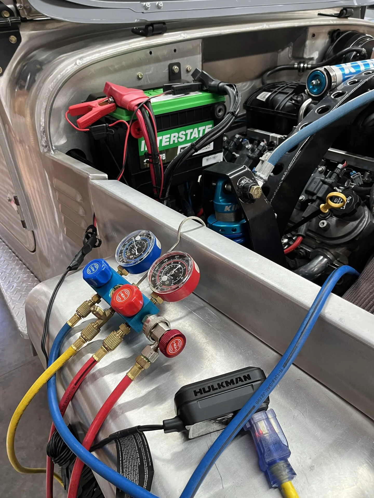

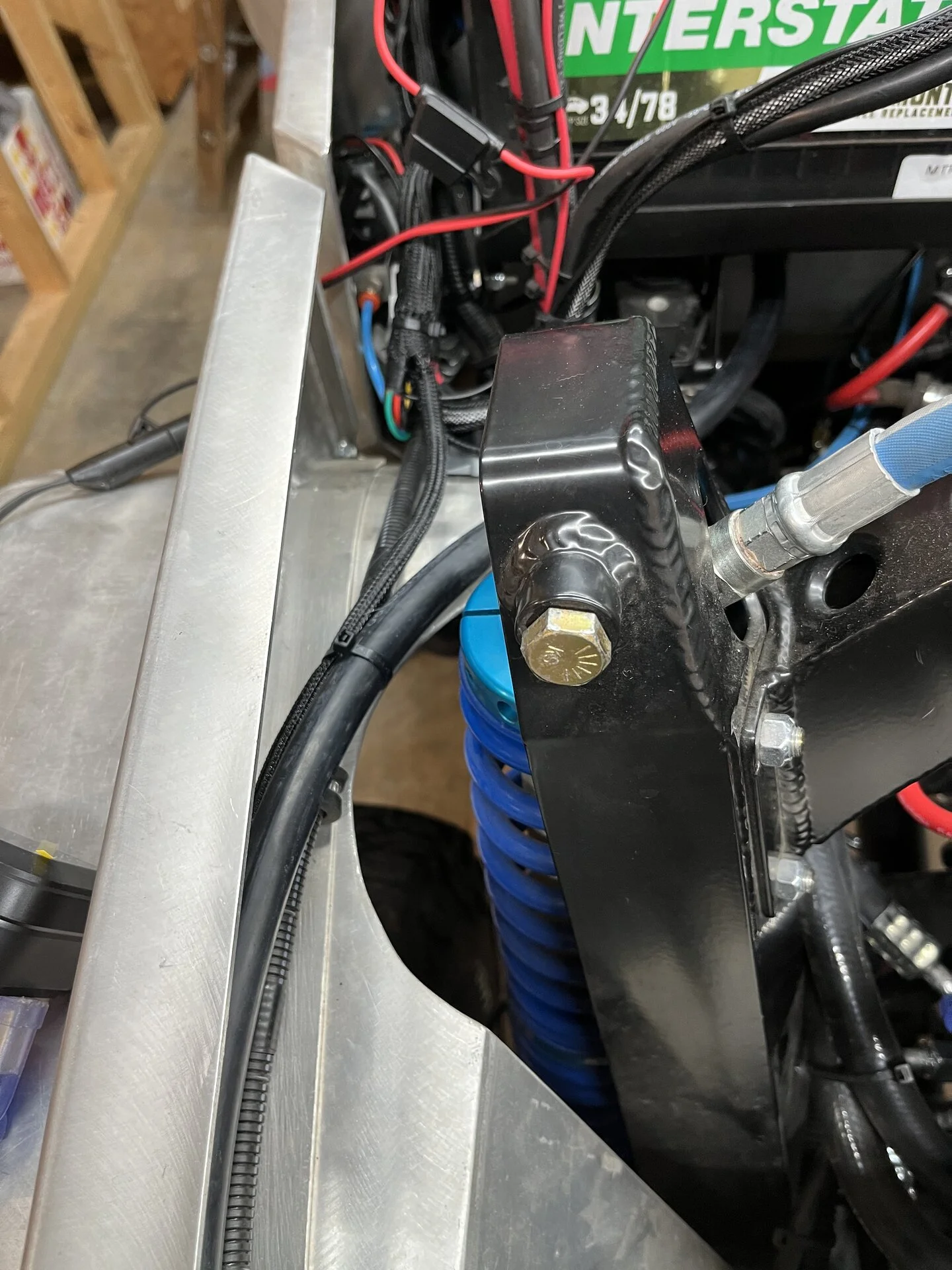

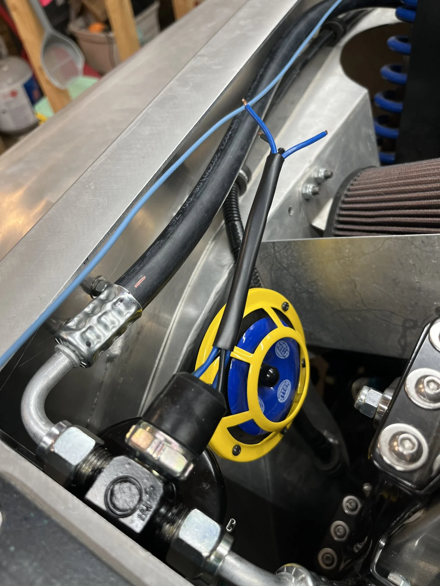

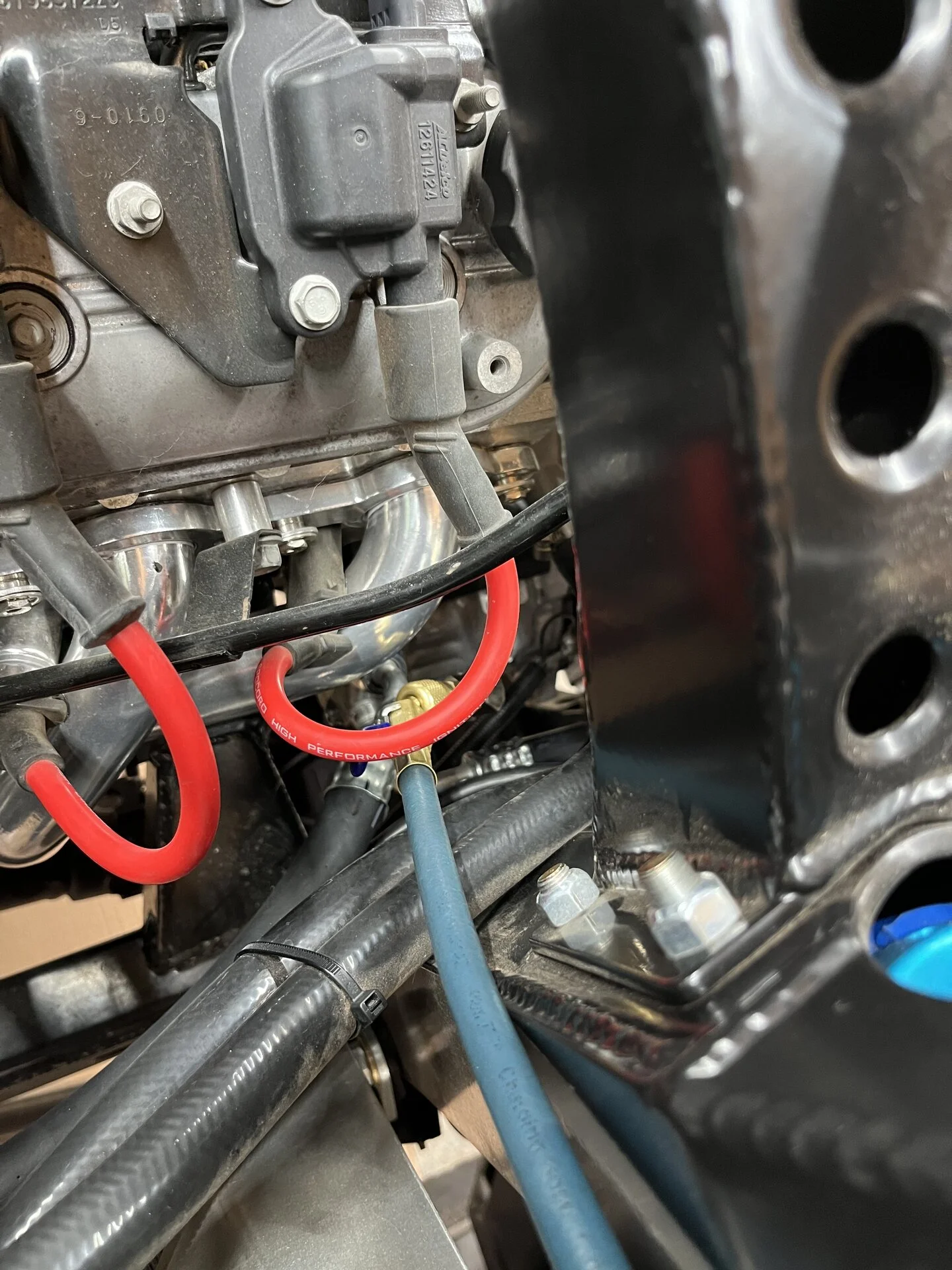

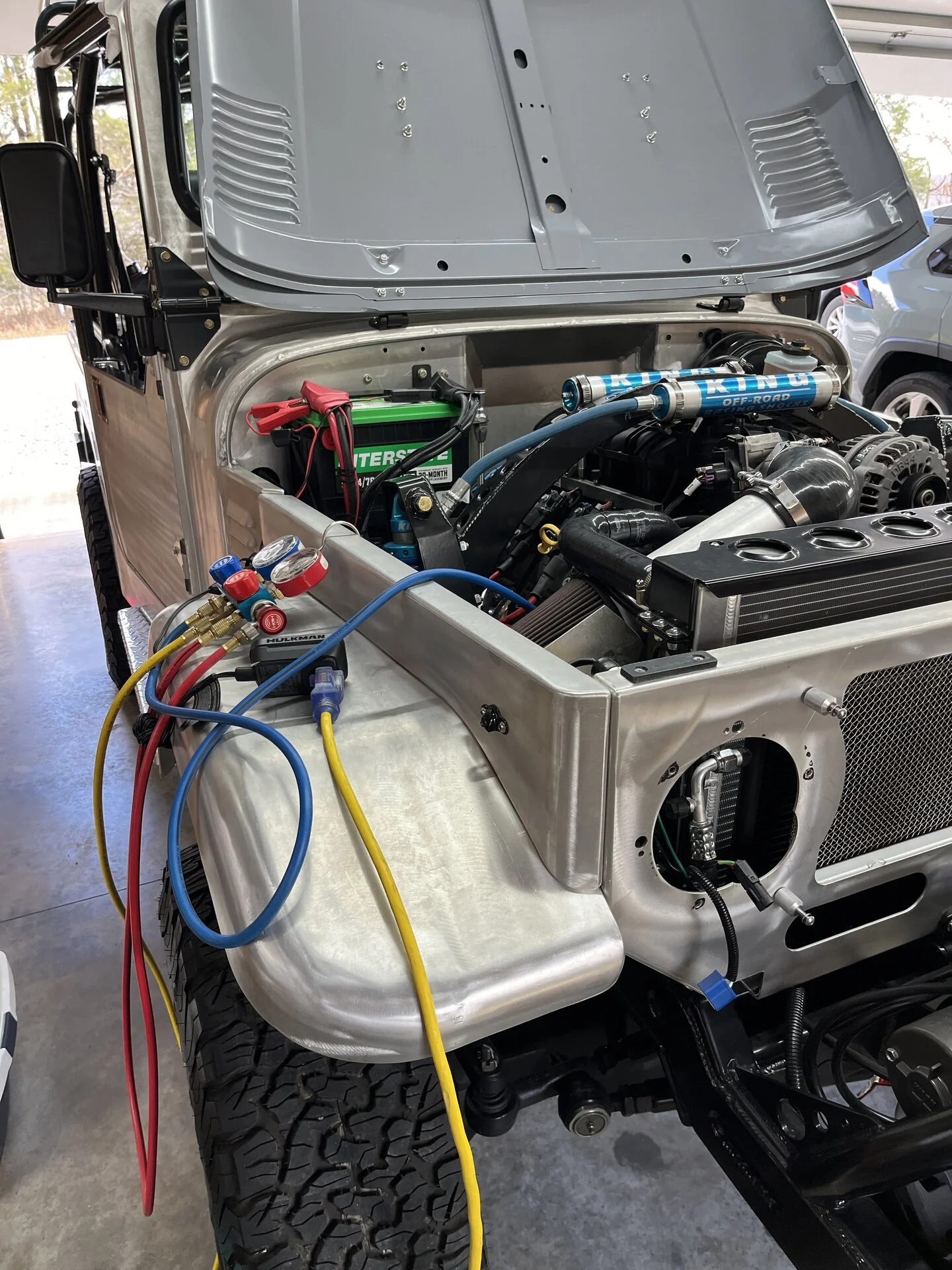

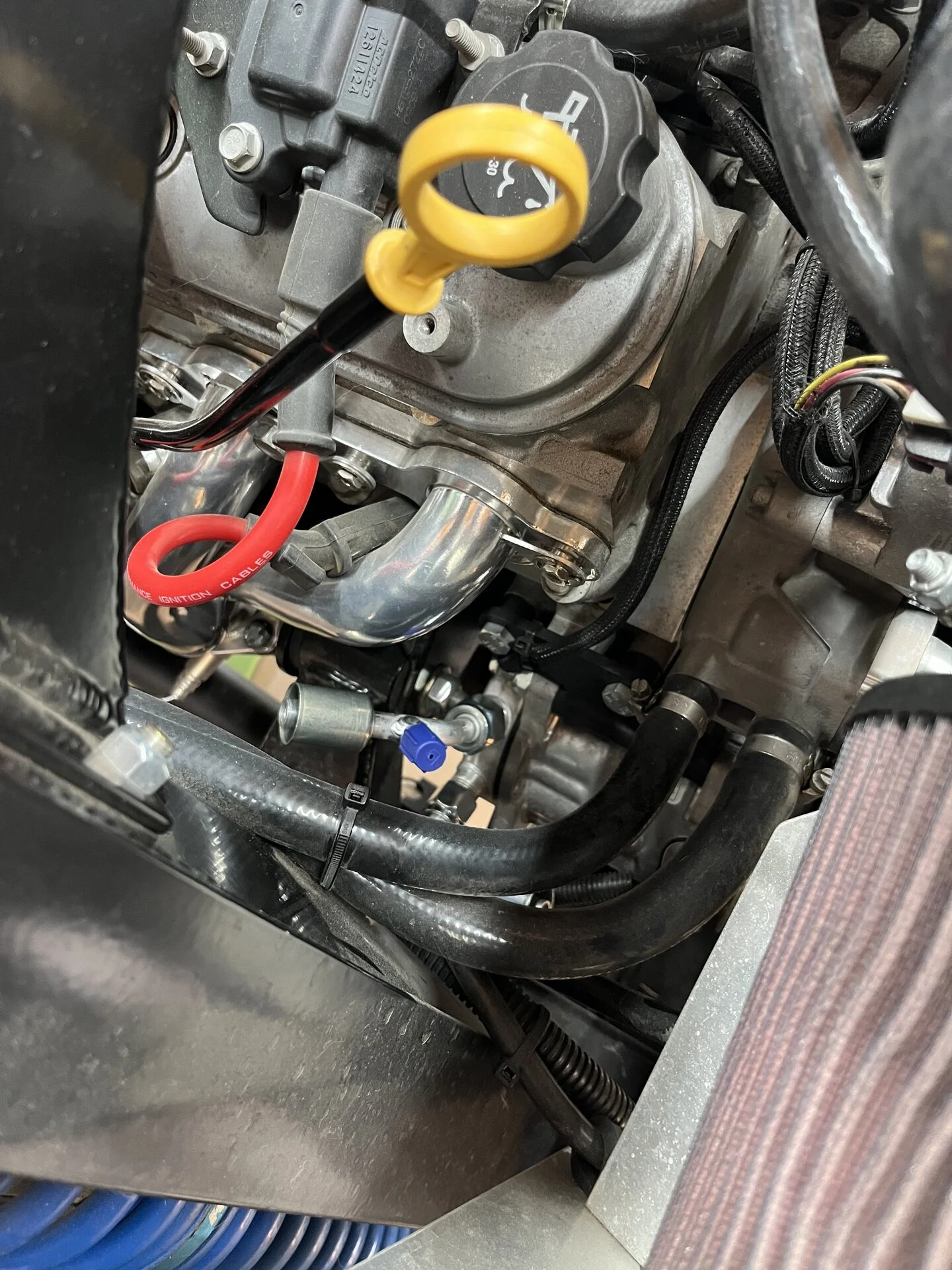

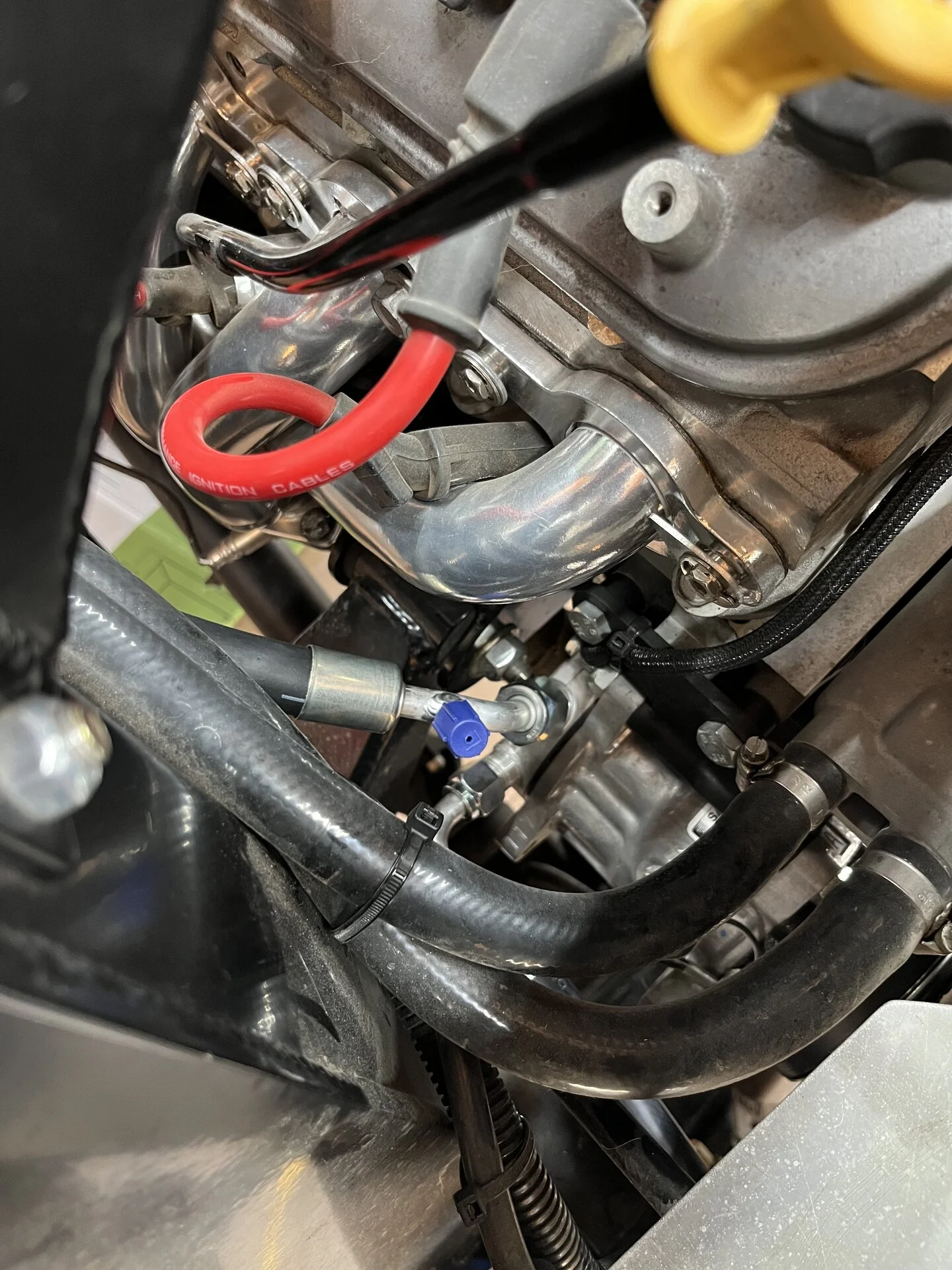

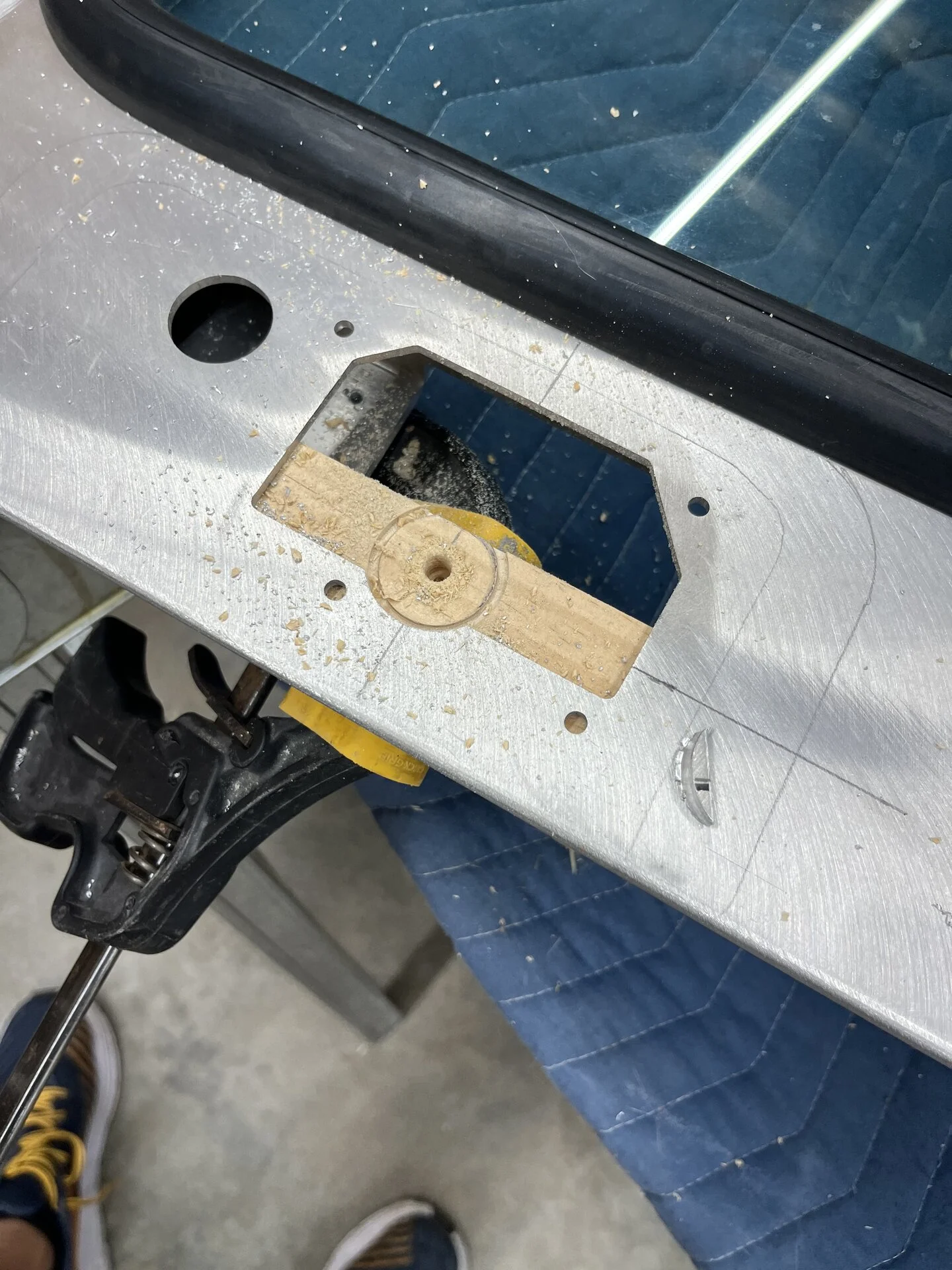

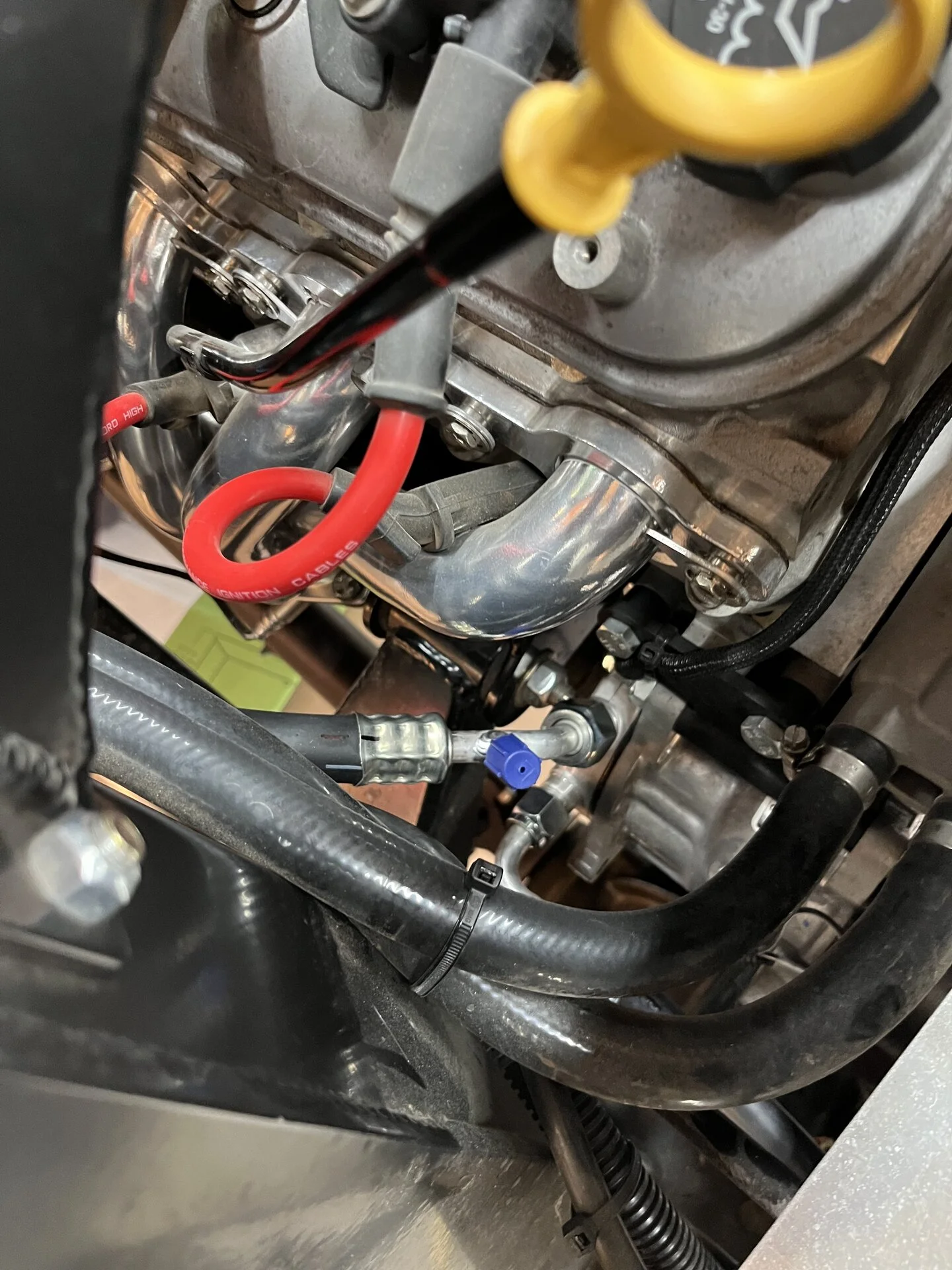

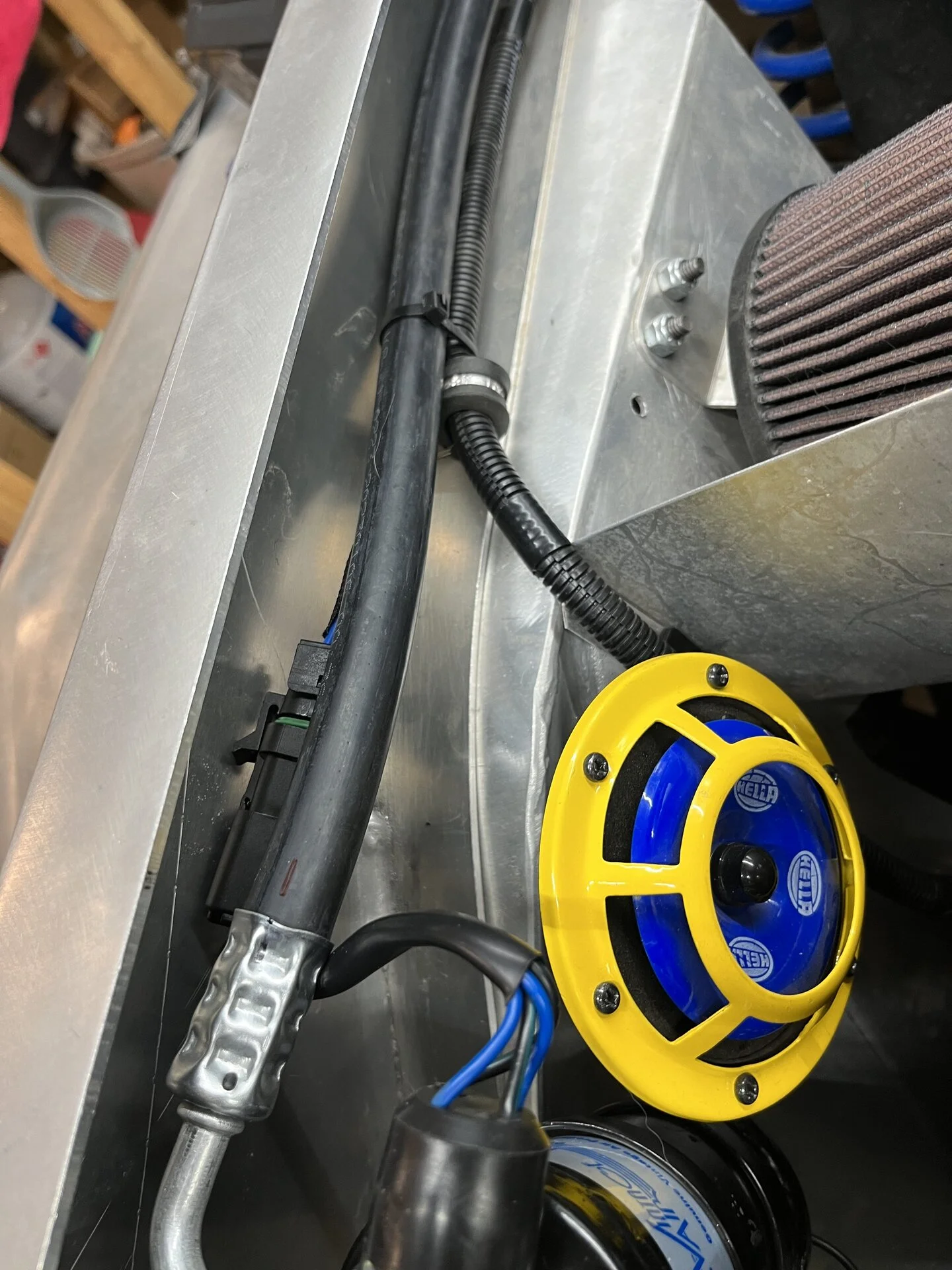

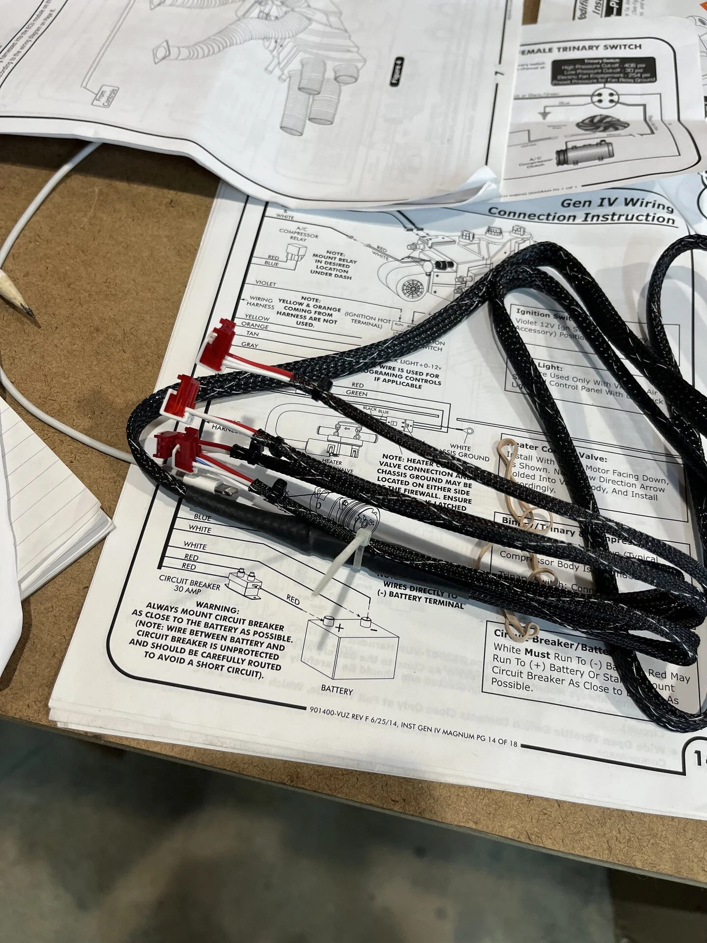

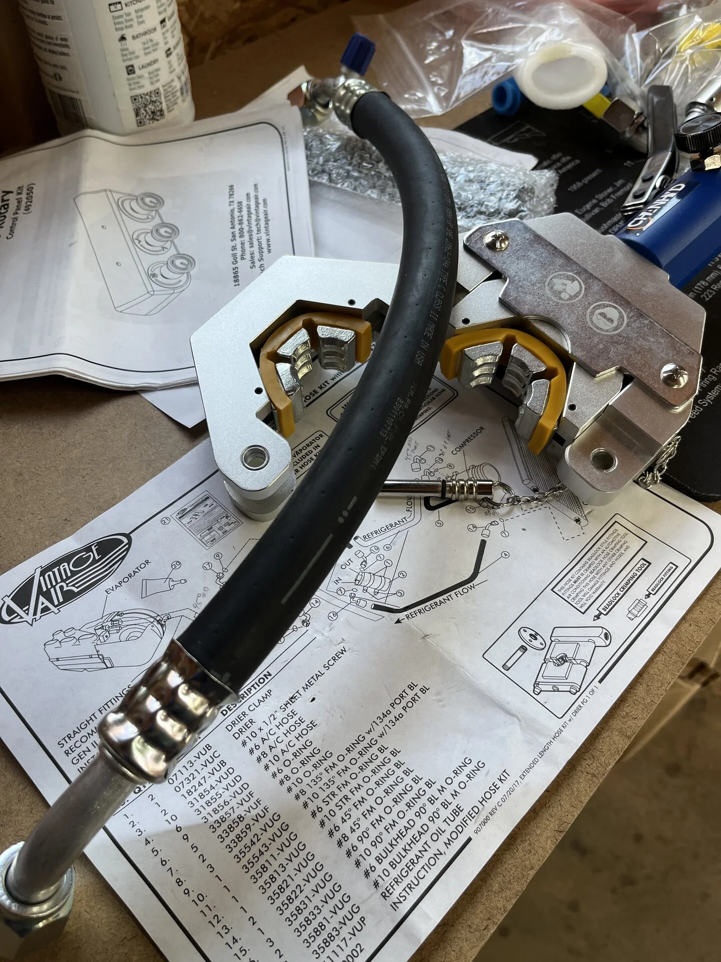

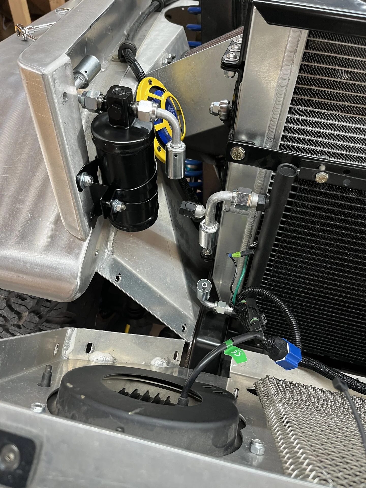

Once all the lines were run, a vacuum was pulled to guarantee no leaks. Controls and HVAC unit was wired and system was charged and checked to confirm proper working order.

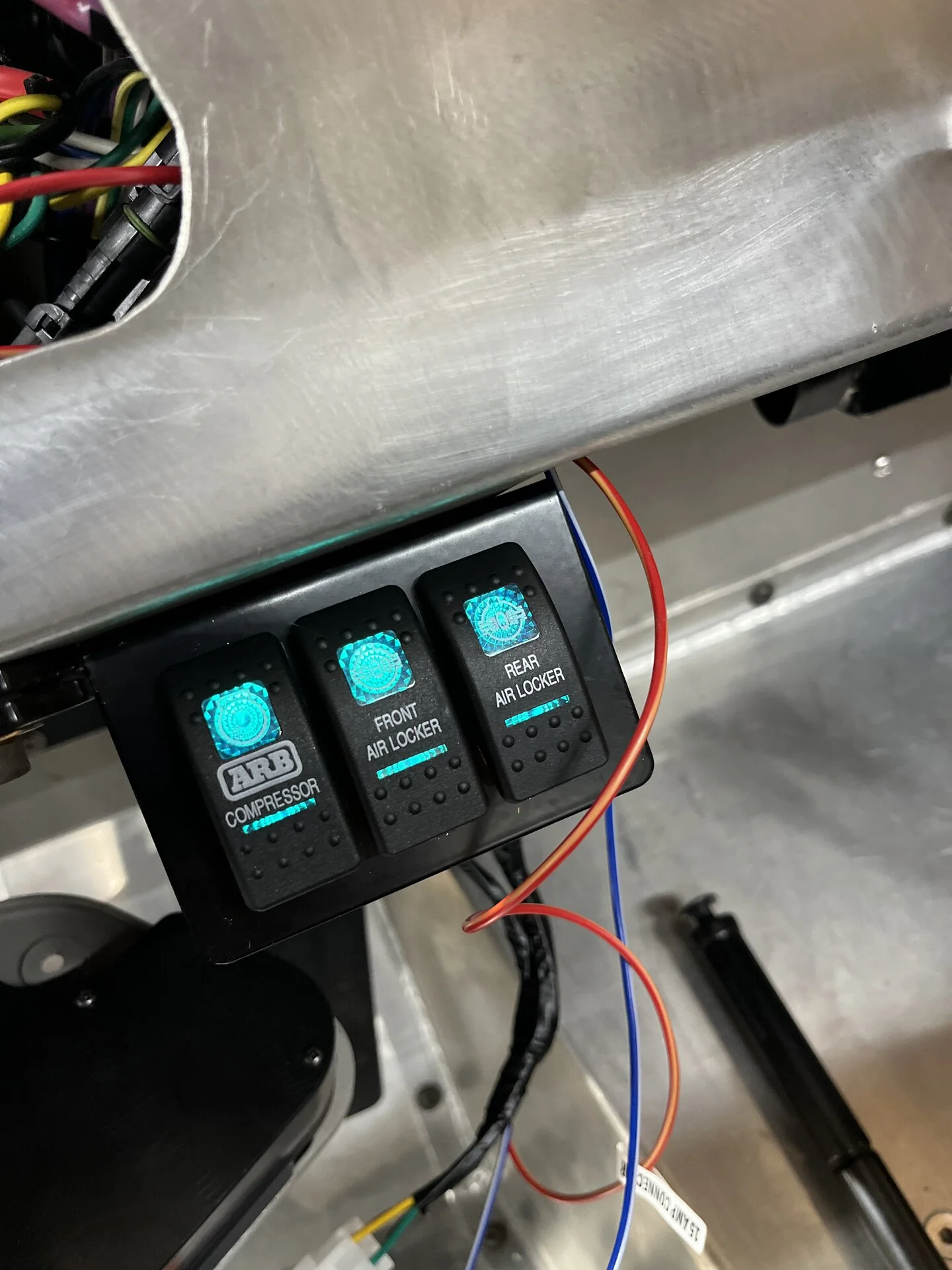

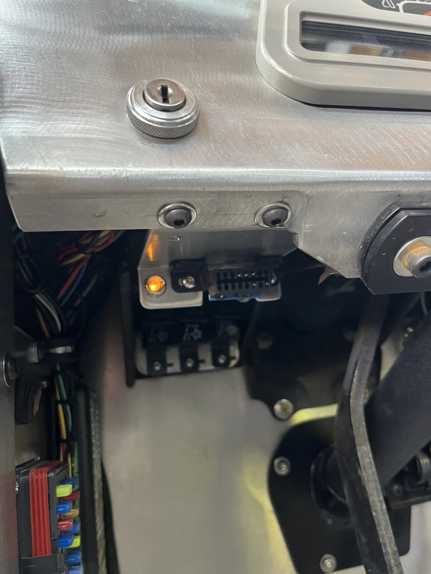

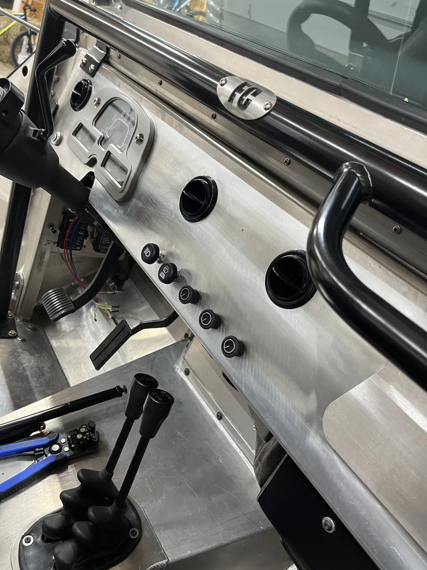

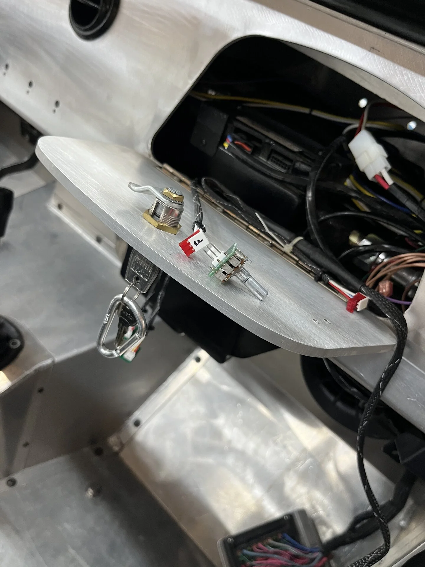

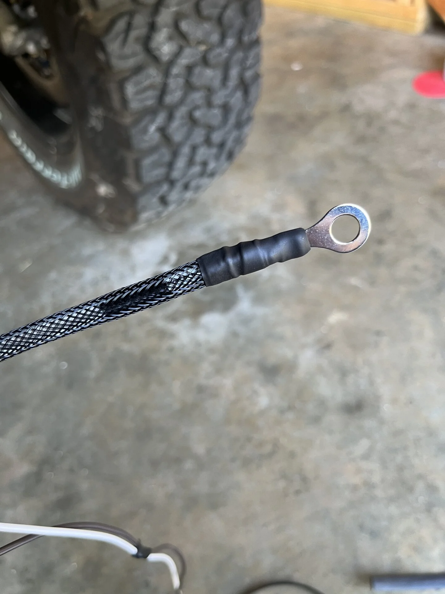

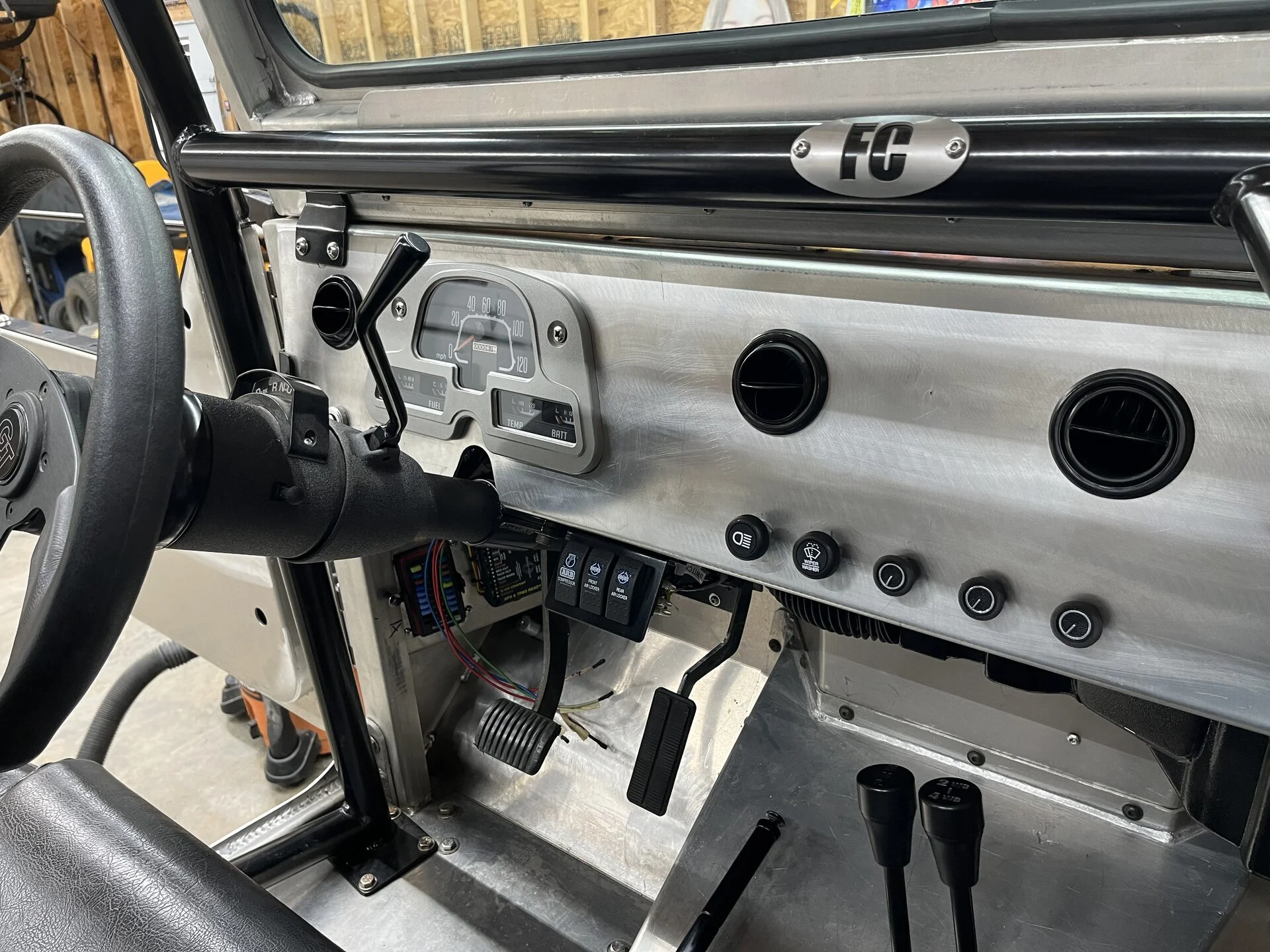

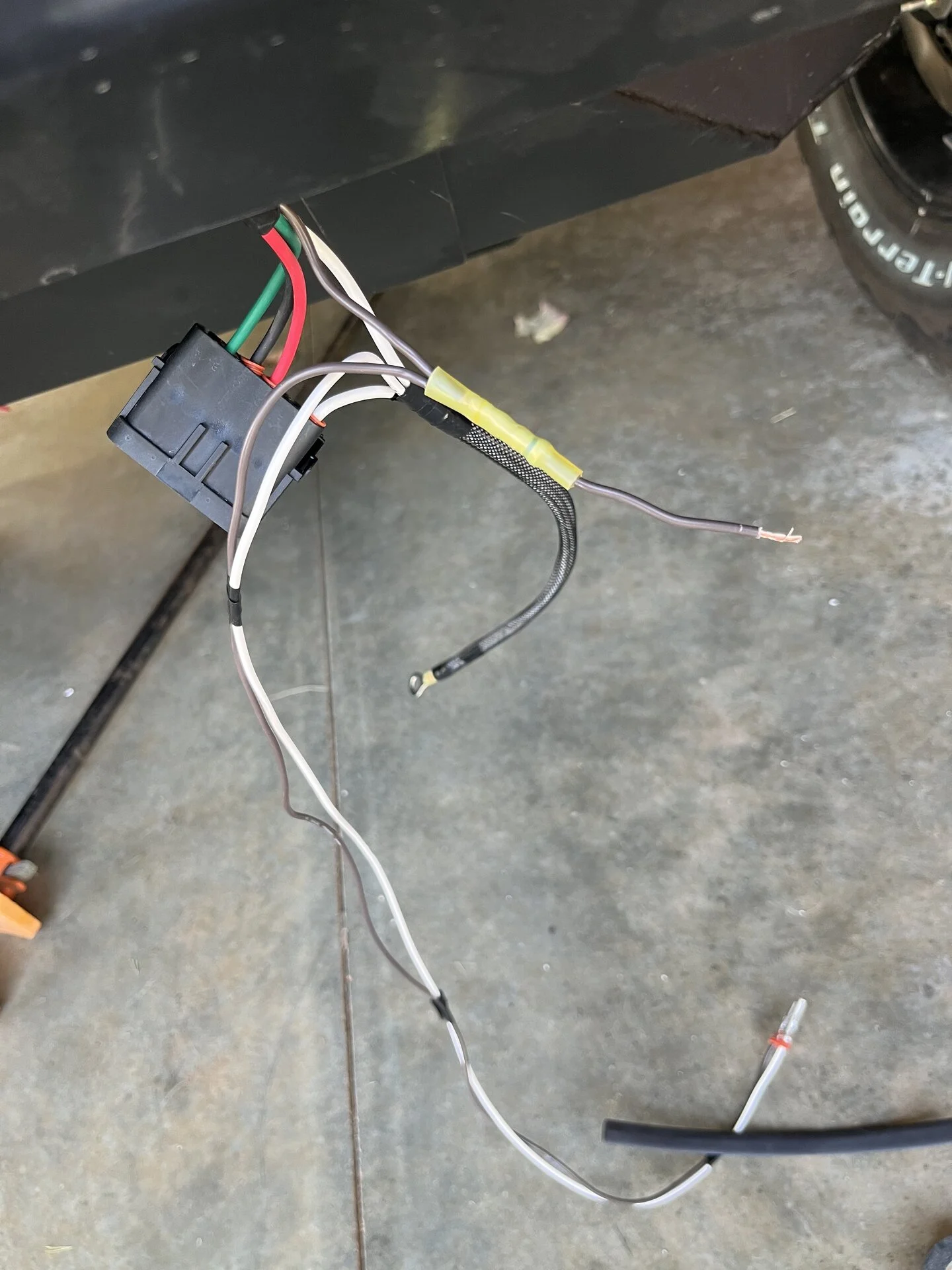

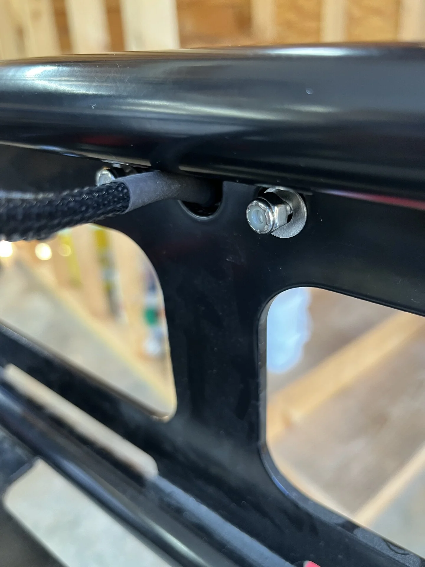

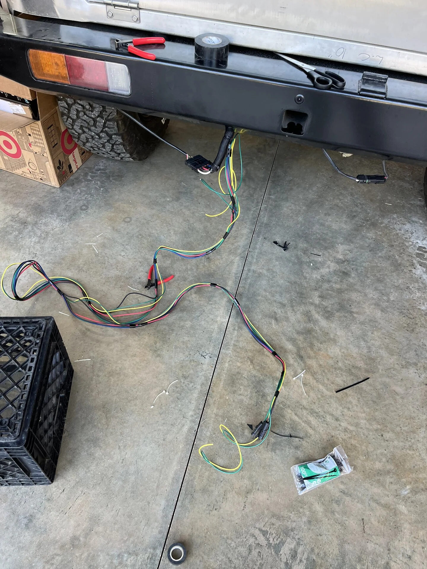

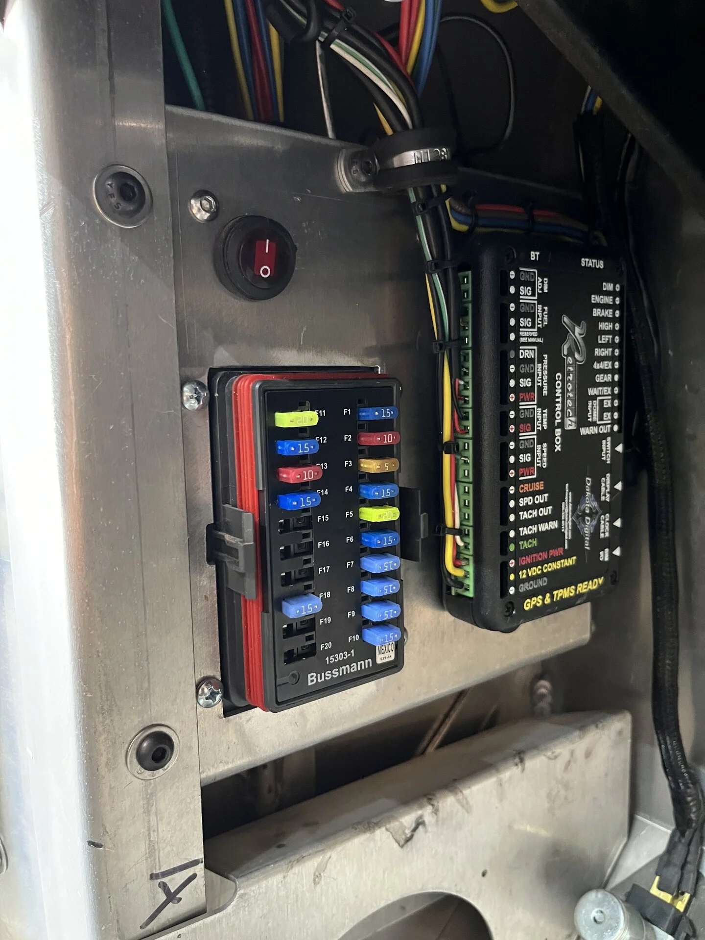

Final wiring clean up. I kept all the "whips" for the ARB and HVAC controls their full length in case next owner wanted to relocate them. All HVAC ducts ran to 4 dash vents, 2 defrost vents and 2 floor vents.
