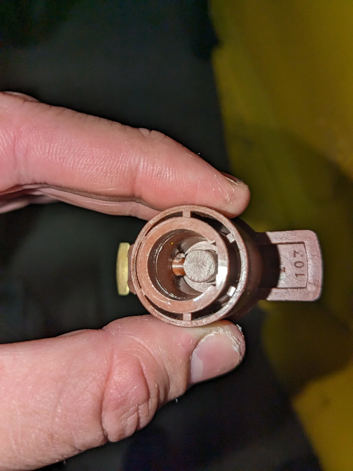

I have a 1974 FJ40 that has been misfiring and running rough. It starts out with one or two misfires and gets worse over time. I am 99% sure it is the dizzy. Every time I have these issues I replace the rotor in the dizzy cap and the problem goes away for about 50-100 miles or about 8 hours of run time. Then the issues repeat, I notice fouling on the points and rotor. I also notice some play in the rotor probably 5-10 degrees or so. When I take the rotor off it is chewed up on the inside. My question is, should I replace the entire Dizzy with a DUI dizzy or should I attempt a rebuild? I am pretty sure the previous owner put an aftermarket dizzy in so I am not concerned about losing an OEM part.
Because of the Play I am thinking the gear at the bottom has worn out and should be replaced. But I want to know if any one else has experienced anything similar.

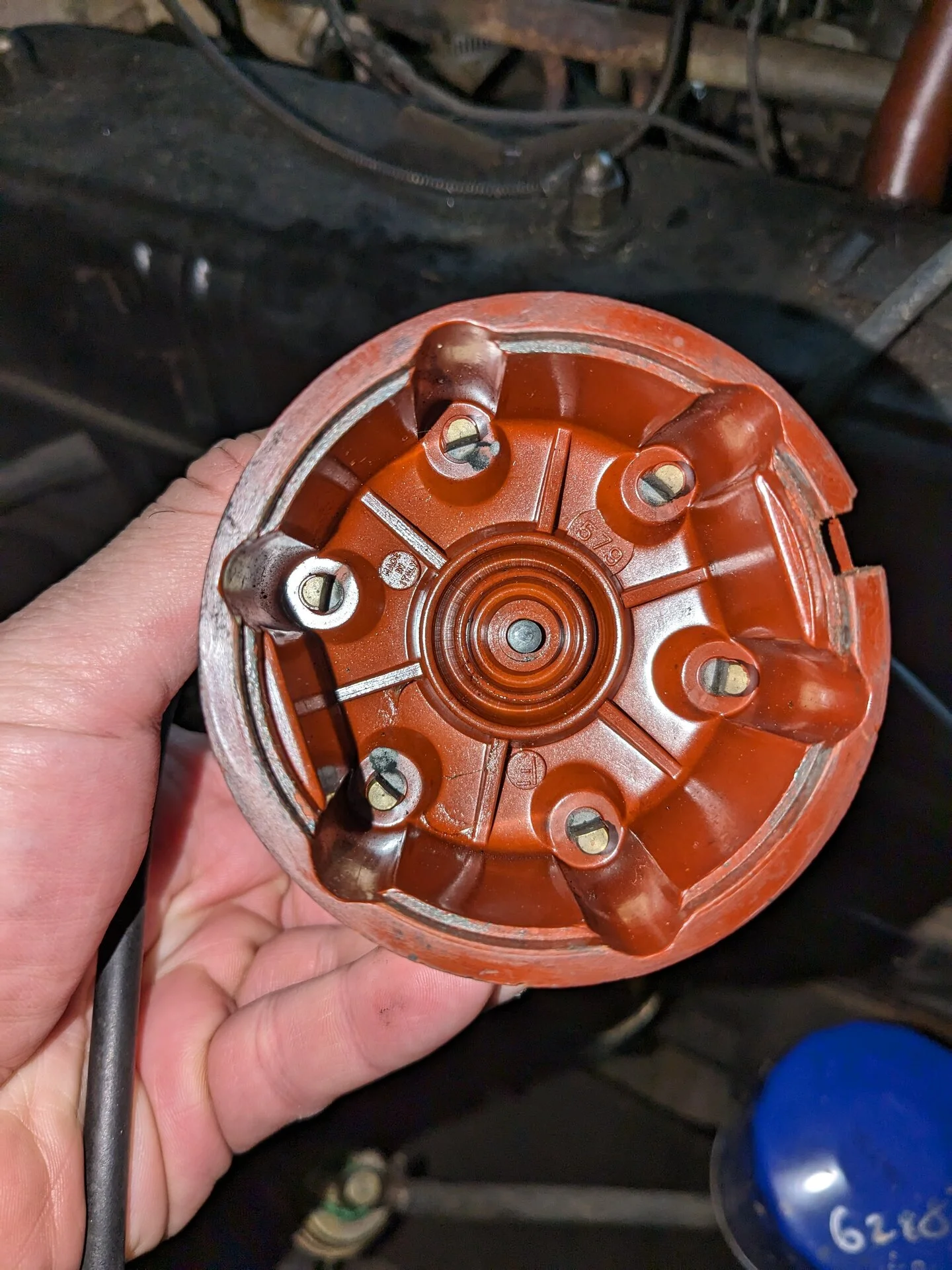

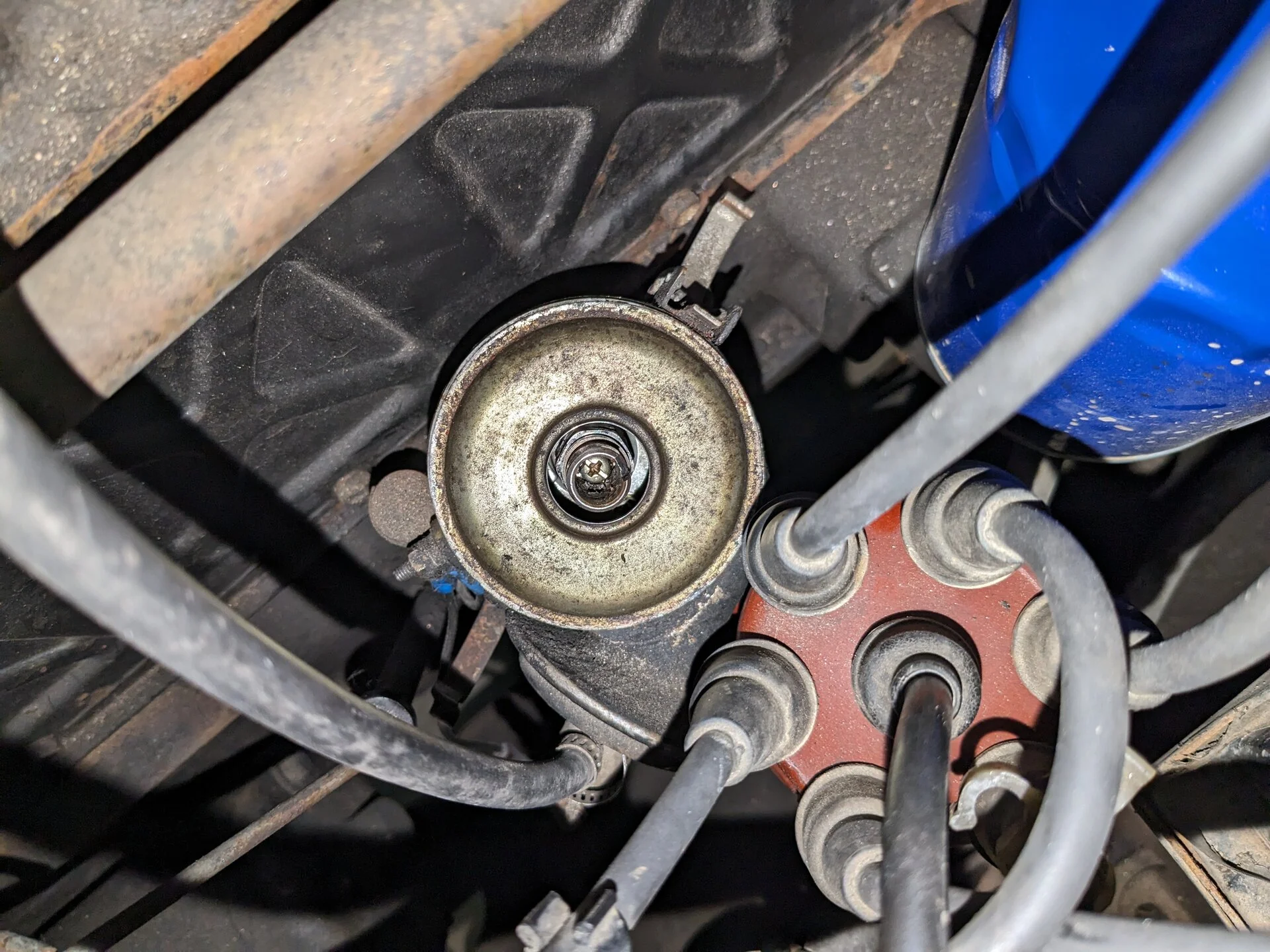

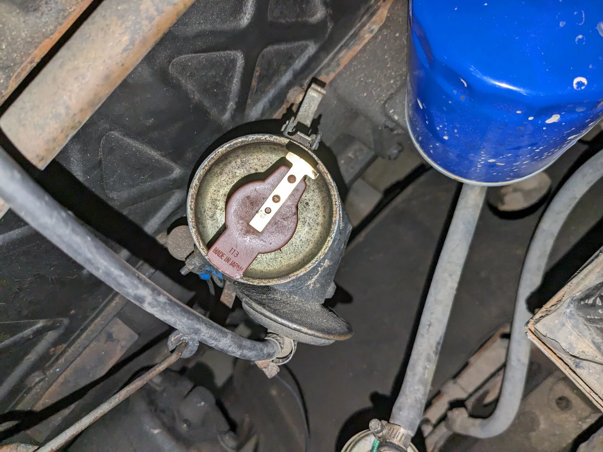

Here are the pictures. The Open Distributor, the Underside of the Rotor, The points and the top of the rotor. After the last time I ran the truck I opened the dizzy and checked the rotor, I wiped some soot off the rotor. So it had more build up.

I bet the bushing is worn more than the gear. I don't like dizzy caps with aluminum contact's.

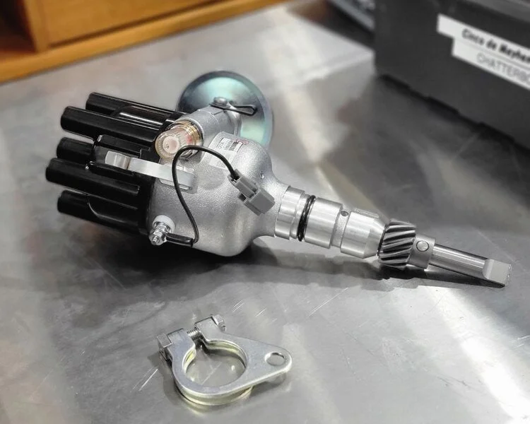

19100-61080 Is what you want.

To make matters worse, it looks like you’re supplying vacuum to the retard diaphragm.
Get a vacuum advance dizzy and hook it up to a vacuum advance port on the carb and call it done.

I have a mid-74 FJ40. I'm running the -61080 Distributor pictured above. This is your easiest and *best* upgrade. The stock Vac retard dissy is a vestigial smog item and chokes performance and mileage. The 61080 is a genuine Toyota points distributor so it will be a plug and play. It's amazing that it's still available. If you want an aftermarket electronic ignition, Mark (65swb45 above) is a Pertronix dealer so he can install the correct one in the distributor for you.
FWIW, first thing I did when I got the truck was ditch the Vacuum retard dissy for new Toyota unit.

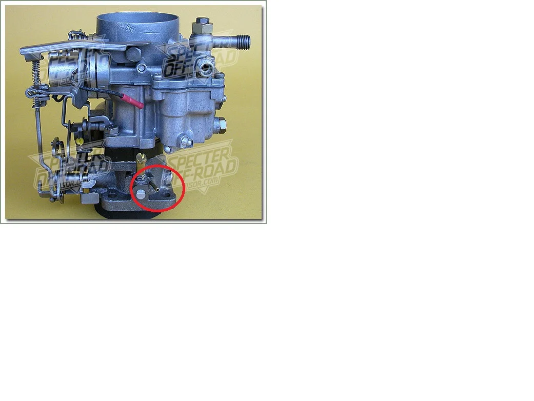

btw, I have a Calif-spec '74 FJ40. Don't know if yours is Cali-spec, but there are differences from the Fed-spec trucks from that year, on the carburetor. Post a picture of the base of your carb, right next to where the Mixture adjust screw is. If you have this port, you are golden. If you don't have it (Fed Spec does not), you will need ported vacuum for the dissy vacuum advancer to work. Mark's Off Road can fix that, too. ;)
Good luck.
