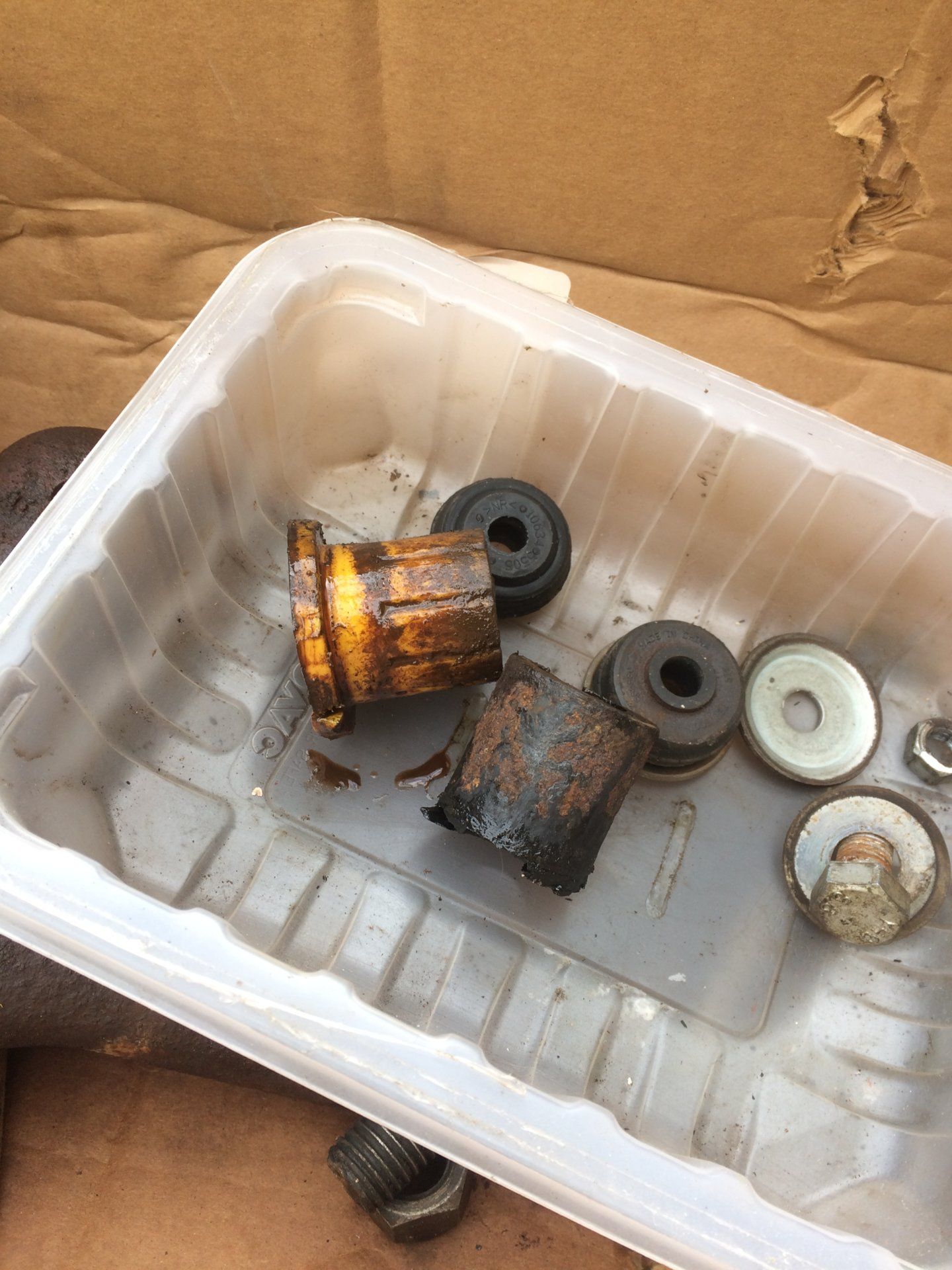

You did catch a break. Your existing bushings are yellow OME bushings, so obviously someone else already went through things.
Trust me in the North East, that means little. Mine were the same and I had to hammer the bolts out. My original OME was done around 2000. PO never greased the bolts (they were greasable) and they were frozen in place. The bolts were rusted out and all pitted. Nothing was salvageable.
