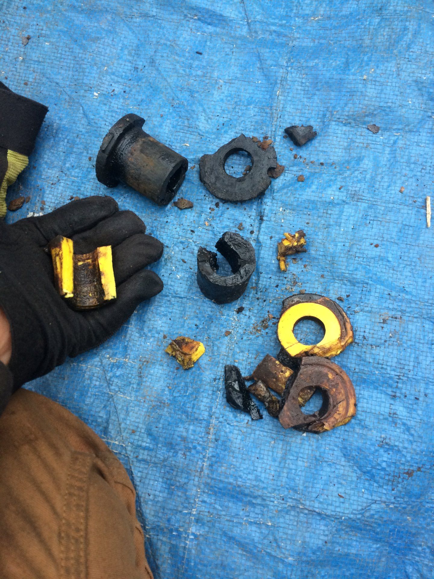

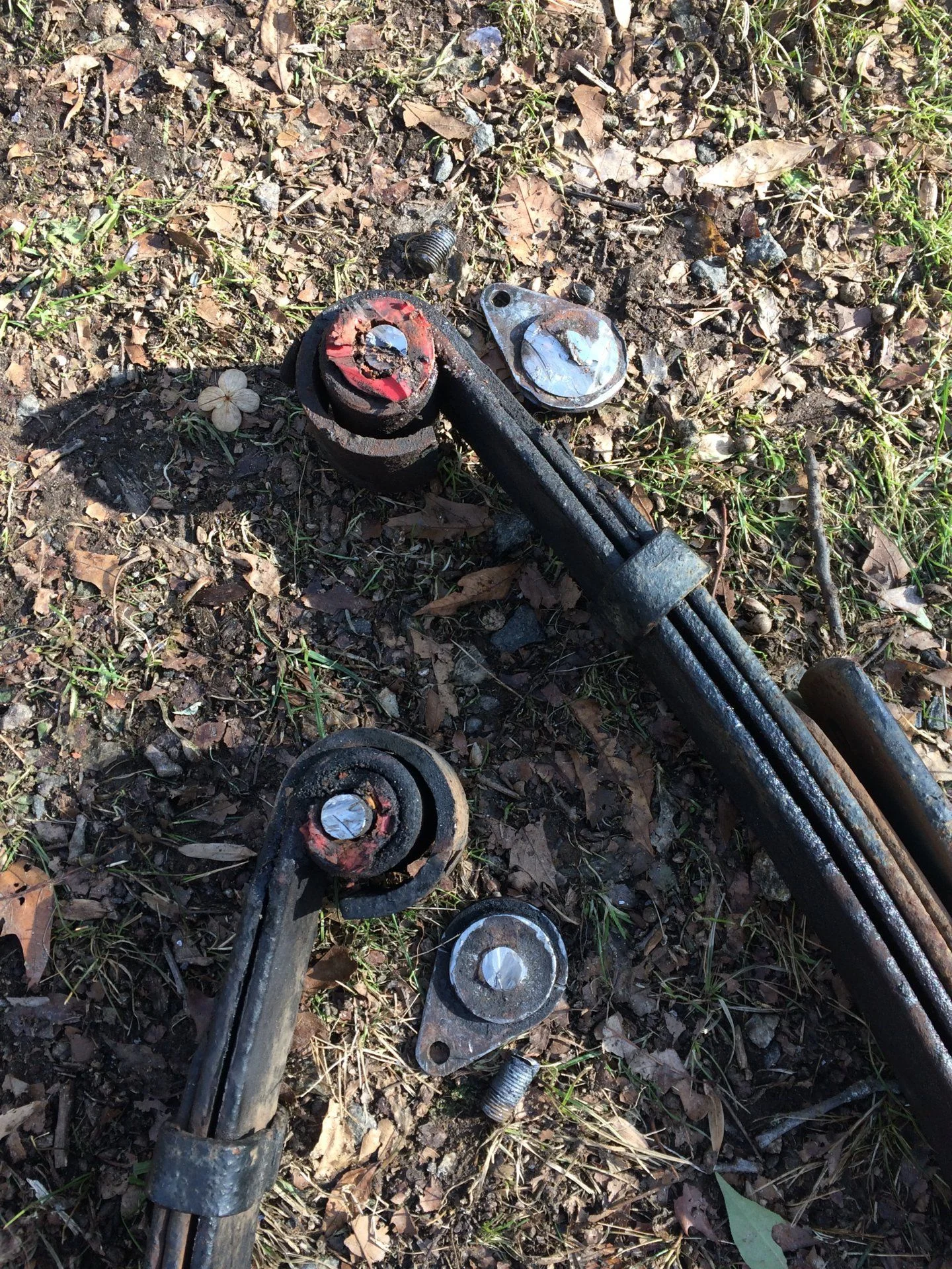

So I have learned from this experience. After one hour of struggling it’s time to pull out the big guns.
I cut the nut off in no time and had the bolt knocked out w/in mins this AM.
Then cut off the overlapping lip of the bushings and then chopped out a section w/ a long flathead and a chisel, squirted in some acetone and ATF and the pried inward and pushed out fairly easily.
Fought w/ both pins for a while before closing up shop to put together a Shepard’s Pie and go get a sick child from his dad.
Both pins are pressed outward from the locked side but still not moving much. Squirted each liberally. Will tackle them later in the week.
And there she stands to wait for her girl to get back to her pampering.
Use your torch to burn the bushings out. It will stink, but it’s effective.
It takes a lot of time w/ the propane to get a good burn. These bushing honestly seem fairly new. Odd that I’ve got a mix of yellow, black and reds. What’s the story w/ a a mapp gas torch? Is that an Ace Hardware buy or a big box store like Home Depot? Same idea as the propane torch nozzle w/ a gas cylinder?
The torch is the same idea, common hardware store thing. MAPP is sort of an older term - I don’t actually think they still make it. That said, you can buy yellow bottles that say MAPP - they require a different torch head then propane.

2 things just for future reference. This is info I found when I've worked on my suspension.
A) all your bushings may be yellow. The top ones in particular get to looking black over time. I cleaned up a couple of my 'black' bushings...just because I was wondering 'why some black and some yellow'? Found out they were all yellow.
B) a Sawsall with a 4 inch blade with 3-4 cuts will make short order of those pesky bushings.
I used the yellow can mapp gas. Let it burn for about 15 minutes or longer before you can expect the bushings to really melt and soften. propane is only about 100 degrees cooler..like 3600 deg vs 3700 for mapp. Just have to be patient and let it do its thing.

But no the one black one is black because I cut through it and it was black inside too.

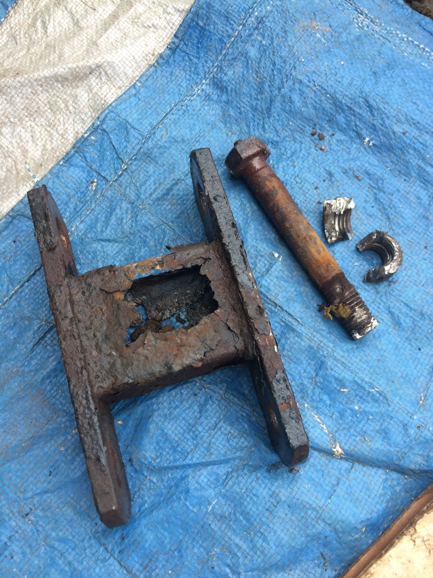

Pins are out. I bought a map gas torch but honestly decided I didn’t like it. Too hot and was just making glue out of the bushings inside the spring. Ended up cutting both sides w/ the angle grinder and dropped the spring out that way for each.

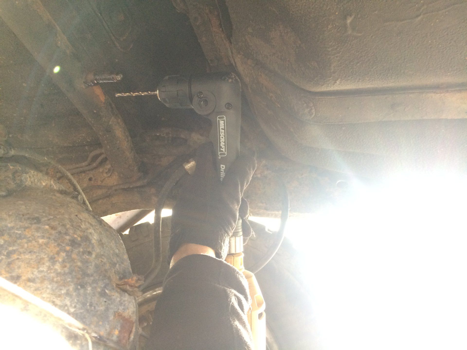

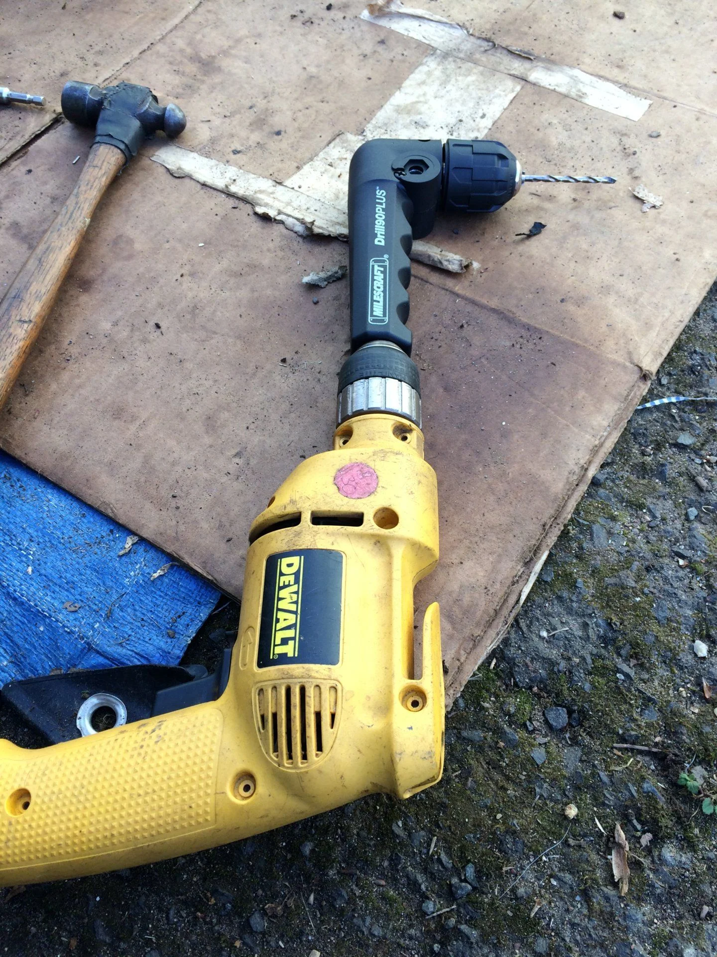

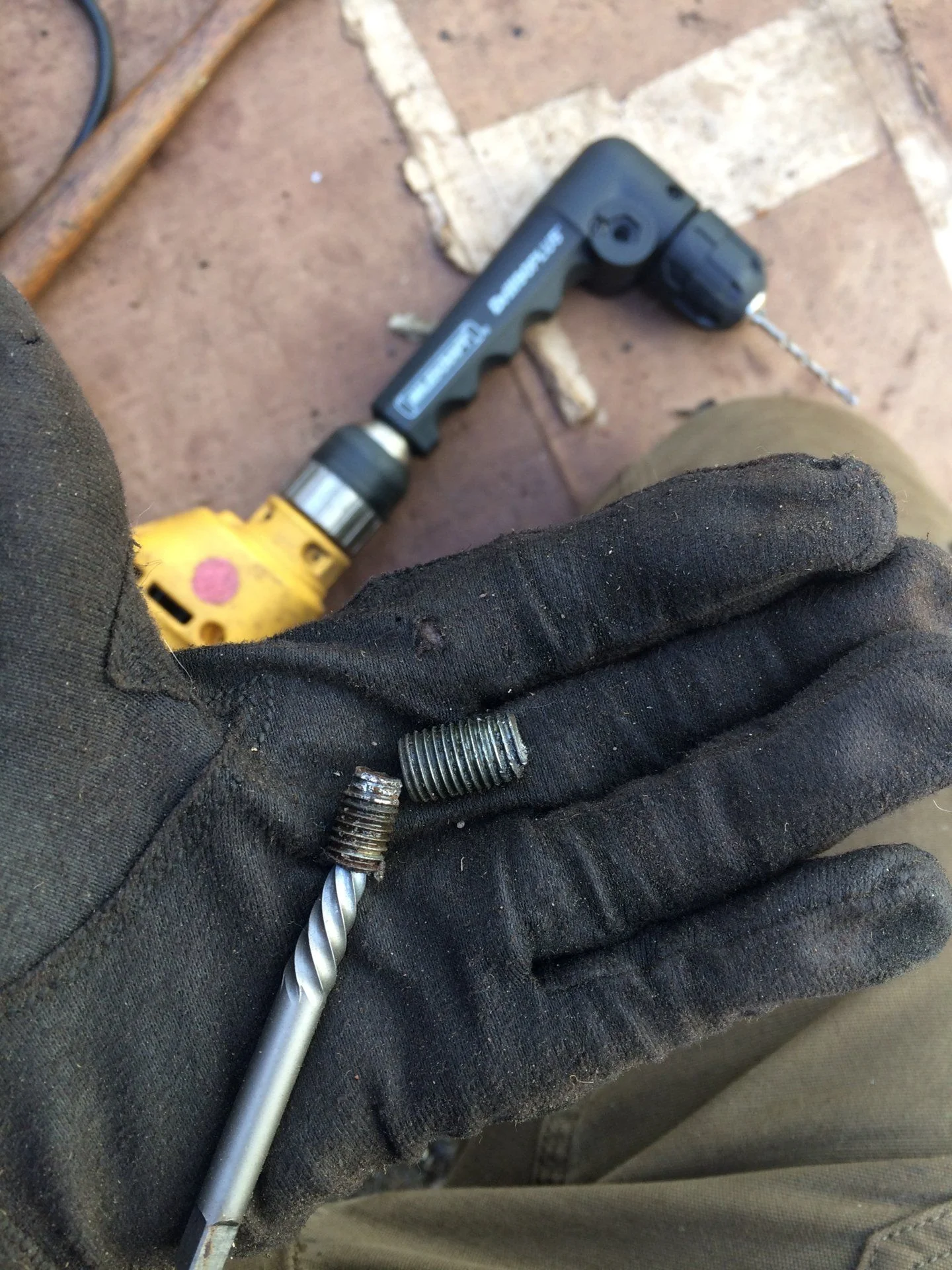

Also got two sheared bolt shafts out after that. One was in the upper shock mount and the other was the passenger lock pin. Whatever they’re called. Too tired and rushing to get ready for work. Bought this cheap ($22) handy gem at Ace for small spaces and it worked awesome. Drilled a little in the shaft, pushed a chisel punch in and turned it right out easy.
