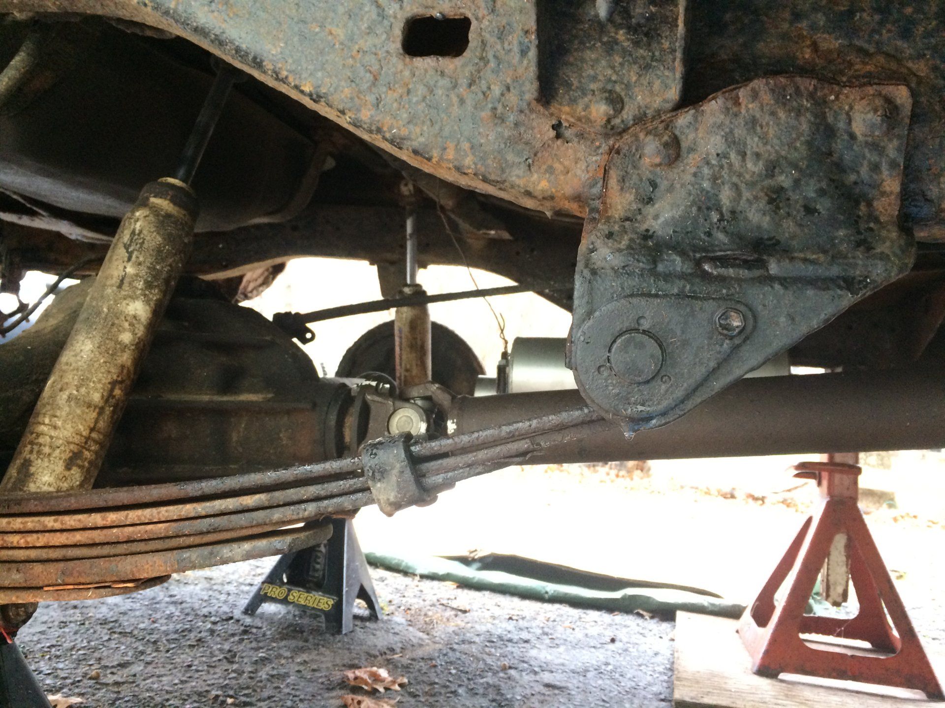

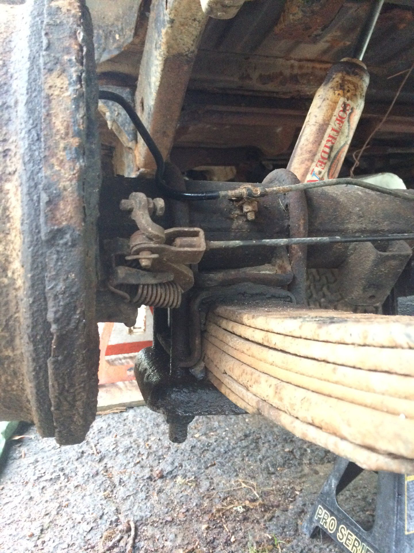

Before in all her ugly. Appears I had an extra thick leaf added at some point?
That's an add-a-leaf, poor man's way to shore up a saggy spring pack.
The little part is the e-brack cable guide that is usually attached to the rear diff cover.
Ah that was what I figured on the leaves. And darn no real challenge on that bracket. Kinda funny I thought it disappeared during a trail meet awhile back but there she is in all her rusty glory. ;)

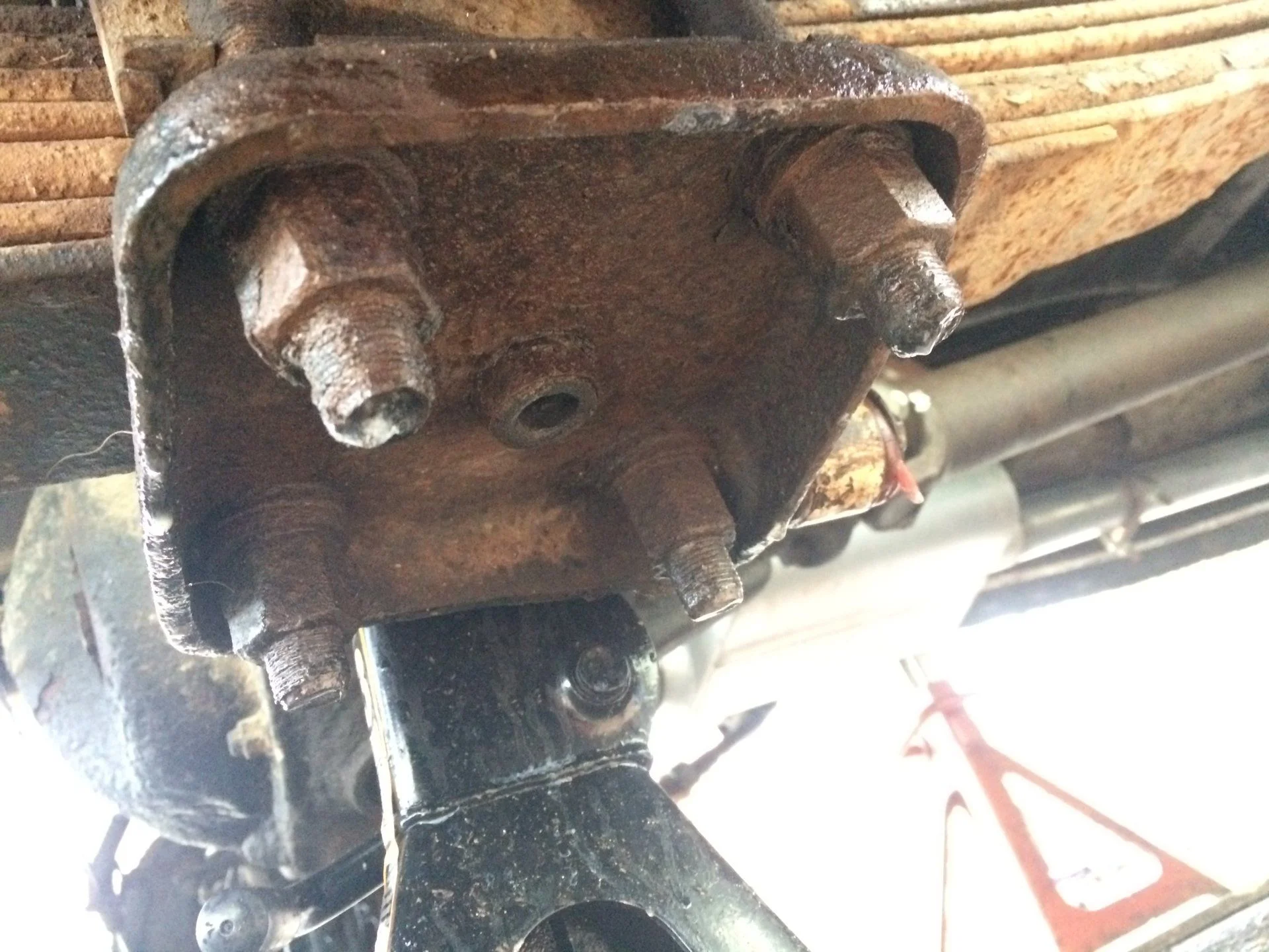

Did you put penetrating oil on the U-Bolt? Why not just cut them off?
Ofcourse I lubed, multiple times in fact! It’s not the u bolt on that side which is the problem it’s tje top bolt on the shackle.

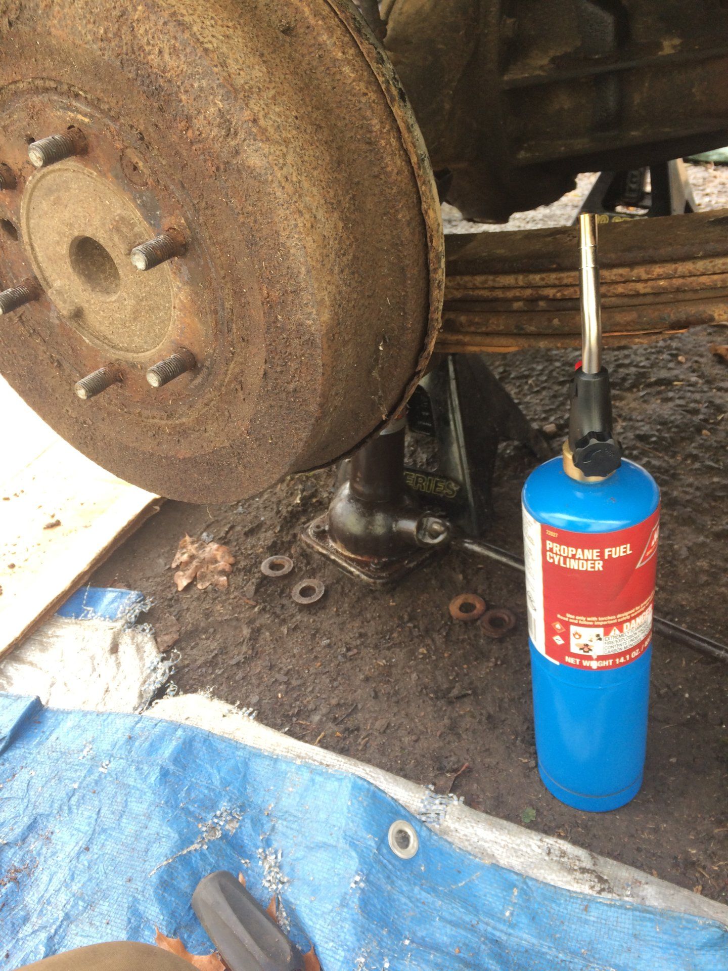

I’ve torched and soaked w/ acetone/ATF mix but it’s just not letting up w/ my 2lb sledge. And clearly that shackle has zero life left in it. I gave up for now to move to the driver side.
There I found one u bolts washers (they each have two installed) are glued to the plate by rusty corrosion. Got three and one chose to not give up. I did finally cut that one.

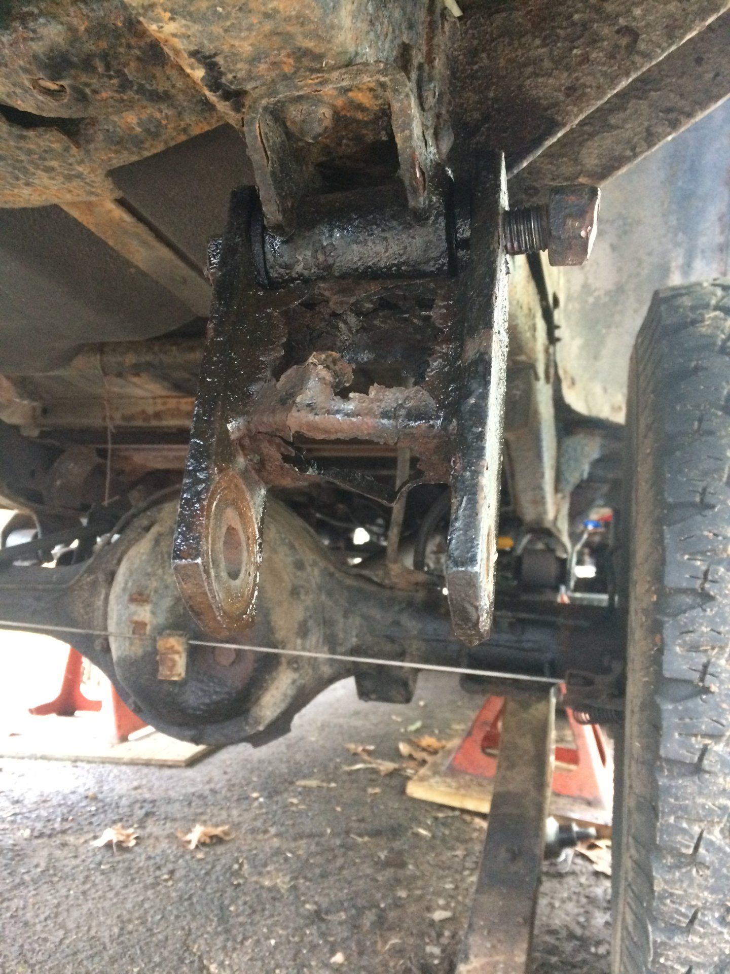

When I have to stop to rest my shoulder this is what I have to look up at.... not the worst weather today here in CT, 48 degrees and dry for now. Rain coming tomorrow.

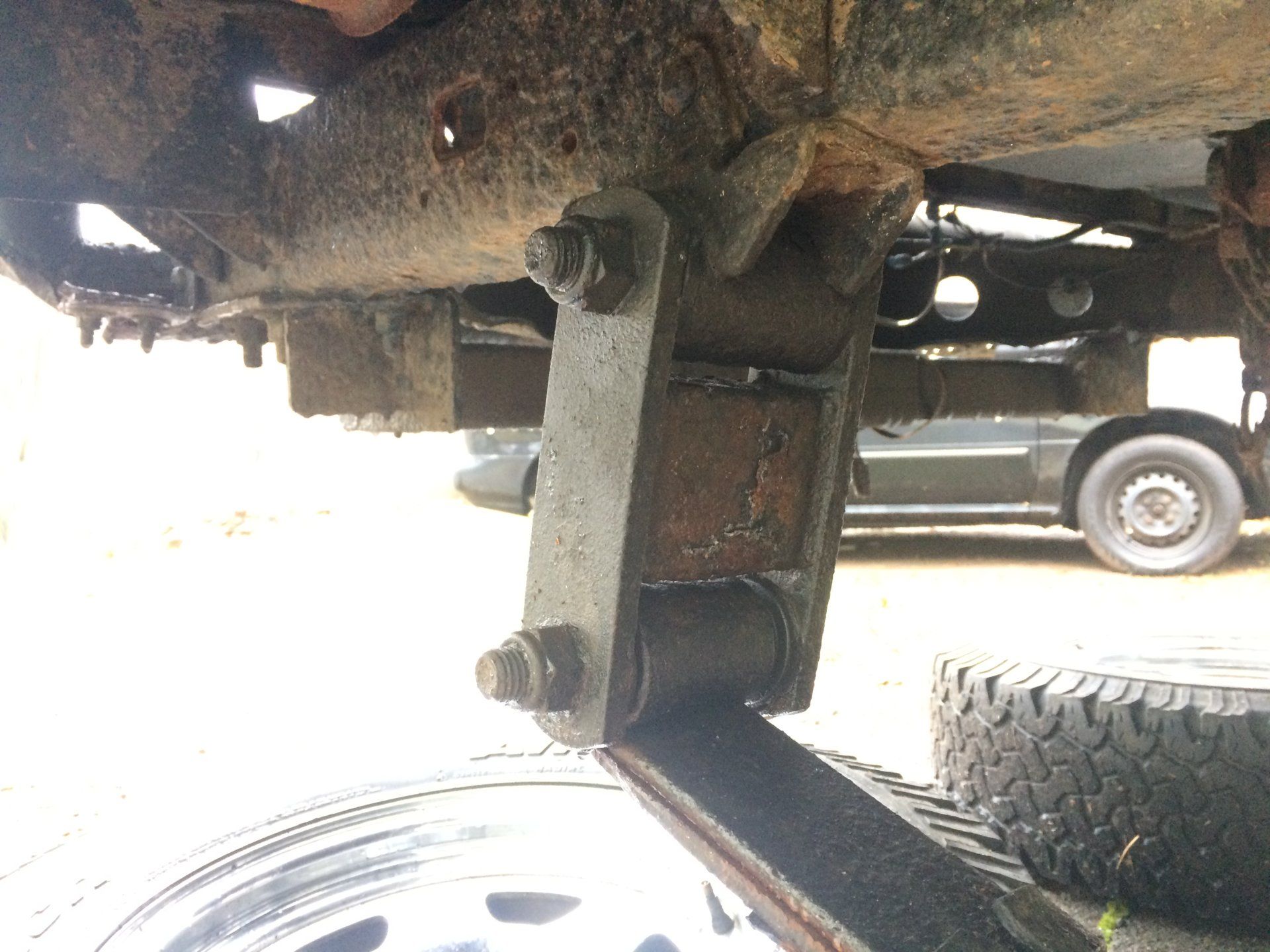

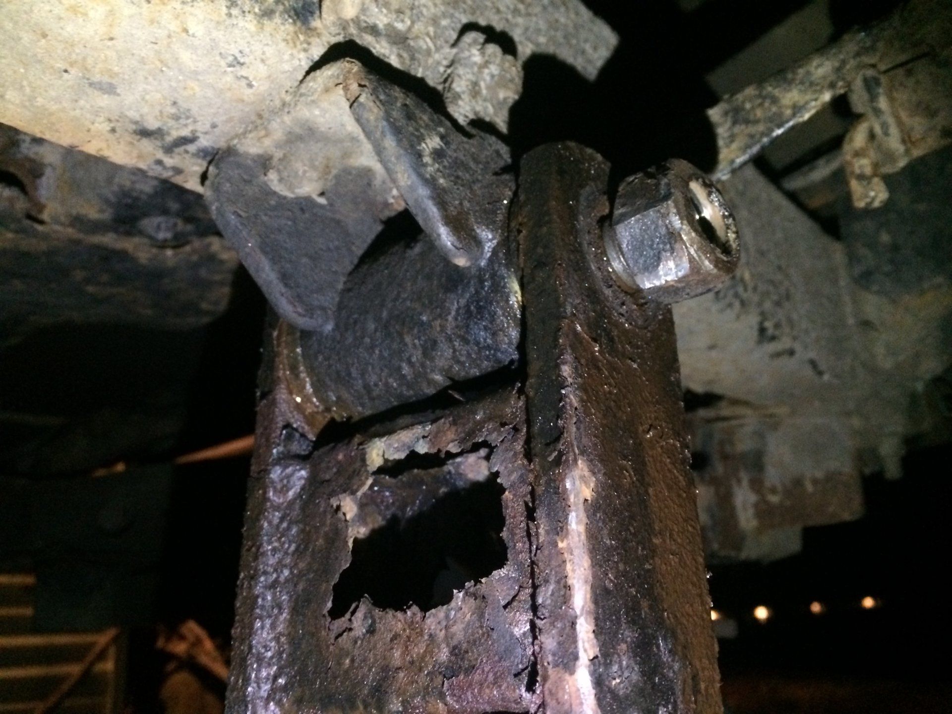

Holy crap. Help. Both top shackle bolts are locked right in. Torch, 2lb sledge, nothing is making them move.
If you've gotten the nut partially off, you can grease the threads and turn it back on. Then grease the threads where the nut had been and try to remove it again. Wire wheel the threads first if you can reach them.
If that fails, you'll have to cut or grind either the nut or bold head. The heat from grinding should help with the bushing removal later. It's going to take a lot because the bolts are probably Grade 5. Pretty orange fireflies.
I agree that drastic measures will be needed. I would heat the bolt until the rubber starts to melt and stink. Heat both ends and heat it glowing red if possible. That will usually get them moving. But it may take 10-15 minutes of continuous heating to achieve the desired results. Mapp gas works a bit better or oxy-acetylene. Both burn hotter than propane.
I also agree that with the rust in that frame, I would not be too rough on the mount.
Grinder with (several) thin cutoff discs. Take no prisoners.

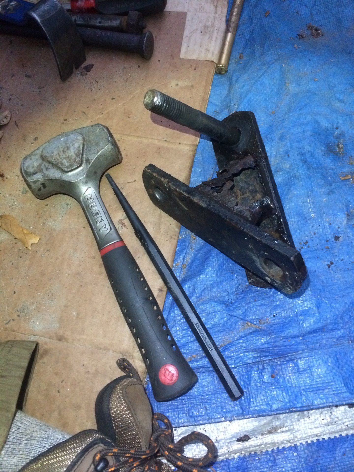

Well my per usual routine is beg for help and then just do it.
Granted okay I’ve pounded potentially more than I should but I finally got the passenger side. And I now have fancy art for my garage wall.

At some point in my future my truck will have the chopped quarter panels. My driver side appears to have been a bondo job and took a few hits the edge of my sledge and decided to give way. Whatever I’m okay w/ it.
