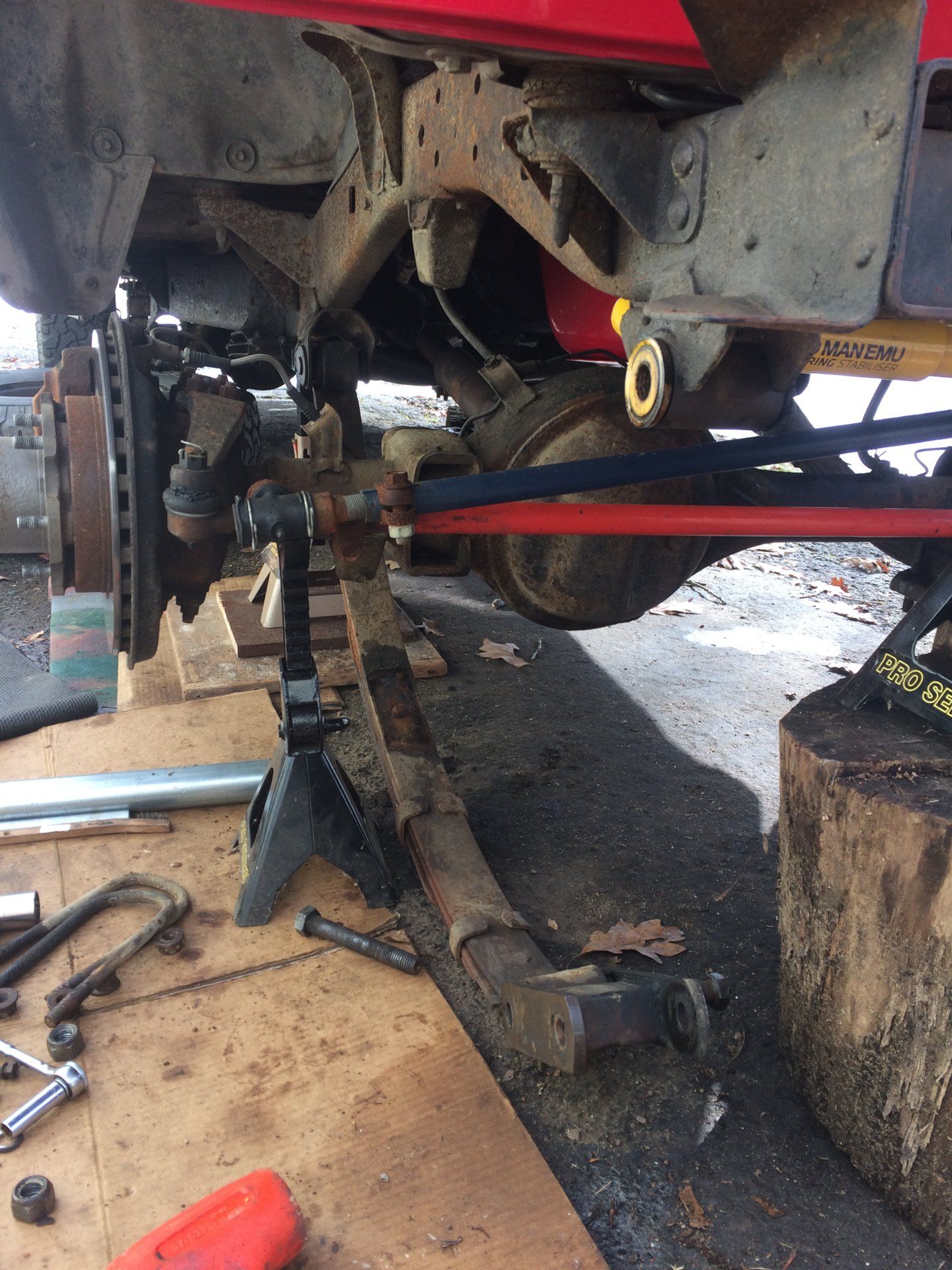

Thanks. I do have a stack of fresh wheels. Obvious tool, angle grinder, that I flaked adding to my list. I also have two very stout black walnut cords (?) that I can use for stands. Was trying out positions this AM and getting feedback if I’m placing them correct. FSM photos kinda suck after being printed from mud. Sprayed down everything again too.

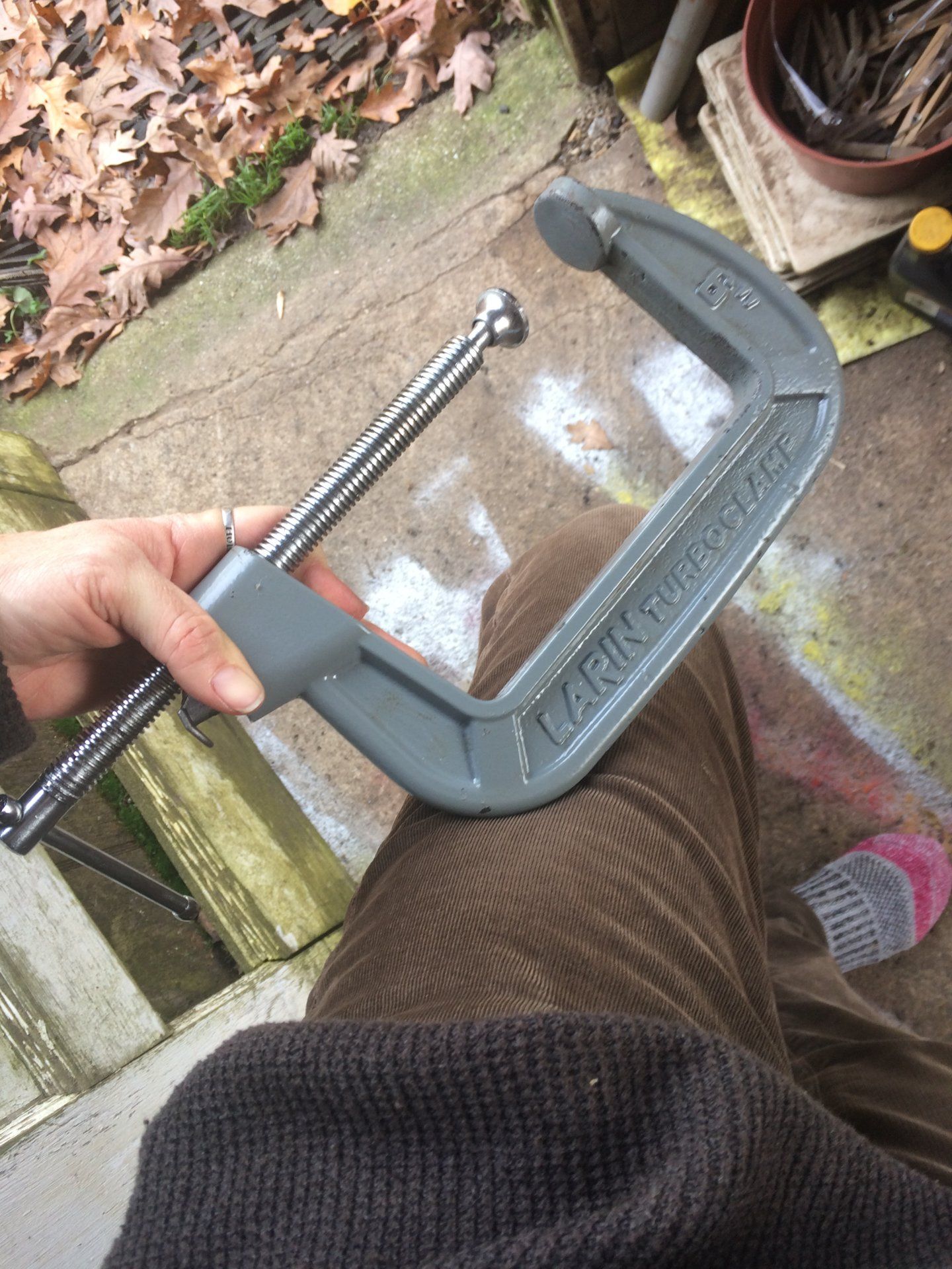

@cps432 and that’s different from this C clamp because the clamping parts move w/ the part that tightens it?
I used the F clamp because it openes wider and is quicker to adjust than a c clamp. My giant c clamp was bent in a way that prevented me from opening it to its maximum throat clearance. As long as you can get your crank pulley socket in there you should be good to go with the c clamp.

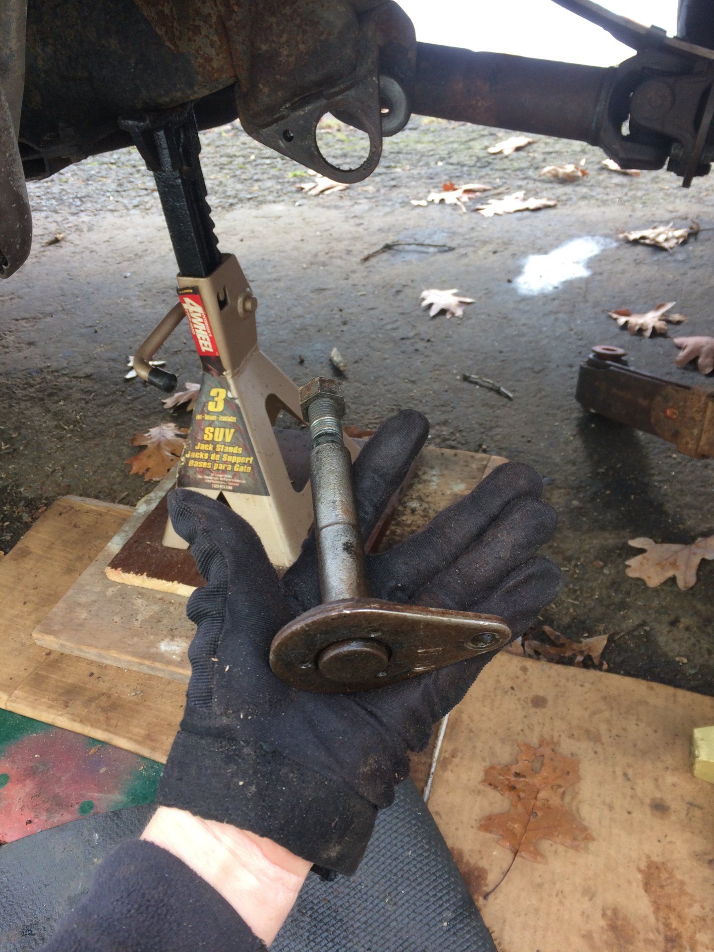

Started the passenger front leaf removal this AM about 9:30. By 11:30 everything was off.
Relieved it was so damn easy. No torch needed.
All by hand. Even the impact wrench wasn’t really needed. This girl, hands down, is so proud of her ability thanks to all you fabulous men all around the USA.
Scuffed the outer front frame rail that I could reach w/ a hand wire brush the sprayed it down w/ ospho.
Stopped for the day to run a few errands. Will start that side install tmrw. Thanks for checking in on my progress guys.

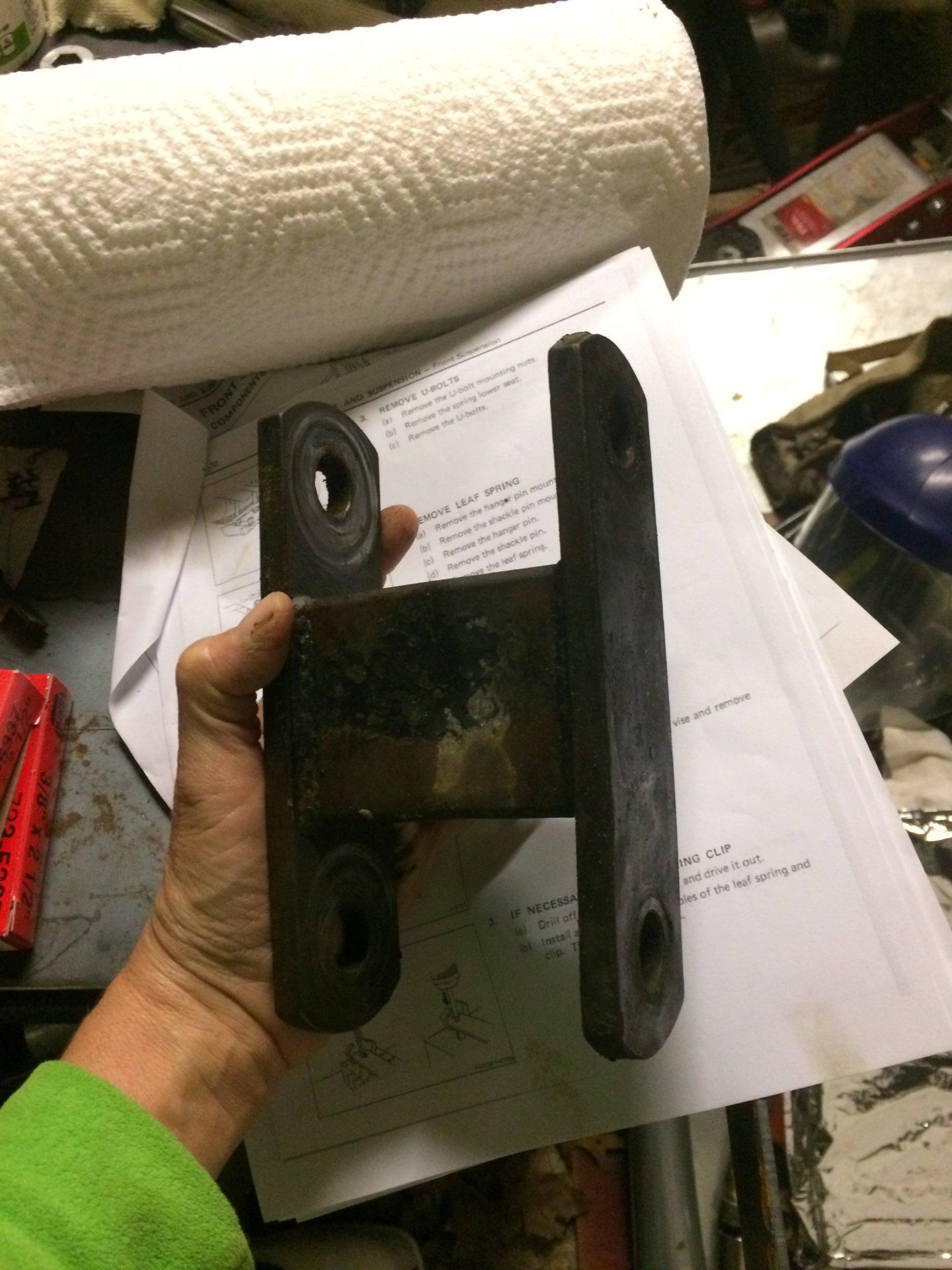

Yeah those old shackles are monsters. I’ll take some pictures tmrw.

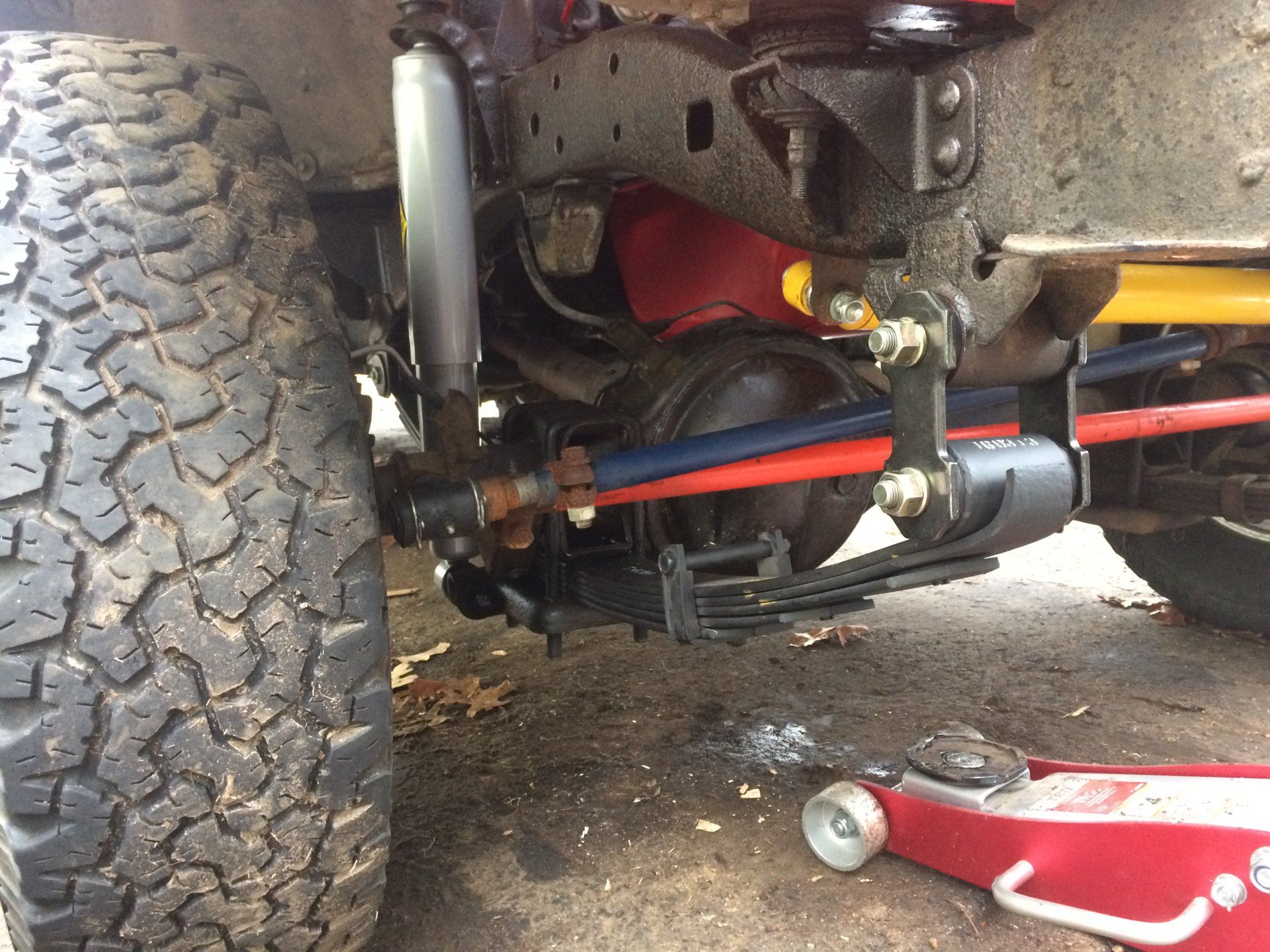

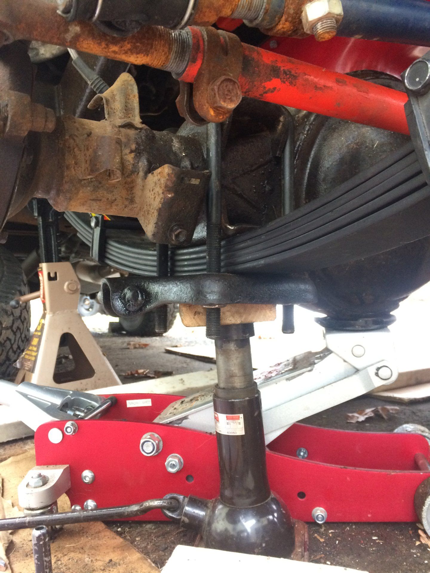

Well I obviously jinxed myself yesterday. Install stinks. Getting that center pin in isn’t fun. Thanks to texting I had some good suggestions tossed to me for using various methods of shifting this or that.
I’m less than a crescent from it slipping in. While I had everything tweaked I slide the U bolts and their hardware on. The threaded end and nut of the pin is centered in the plate at least. I didn’t fully tighten the nuts.
Decided to call it quits when I lost daylight and I had animals all waiting for food. Will tackle it a little tmrw tho I have to work at 3.
What a beast chore incapable of photos due to the fact I was using both hands and a foot for the most part.
It’s in. Staryedat abput 7:30am and it settled in place by 11am. What a pita. Can this be a one and done @TRAIL TAILOR? Ha!
