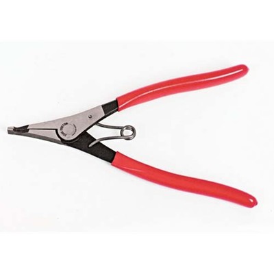

^ I picked up a $15 Craftsman pair of dedicated snap ring pliers, life changing from trying to get the clips on with the interchangeable point HF junk.
Yep, no comparison.
@flintknapper
I was able to find these on eBay, they don't look as long but they're the 250g model.
Those would work great and last you a lifetime (if you aren't bad about losing tools). ;)
I literally have tools I purchased 50 years ago. My brother on the other hand....loses tools 'daily' it seems.
It wouldn't be wise for him to purchase good quality tools.
Do you know of any retail stores that carry Proto tools? I don't recall seeing them anywhere?
