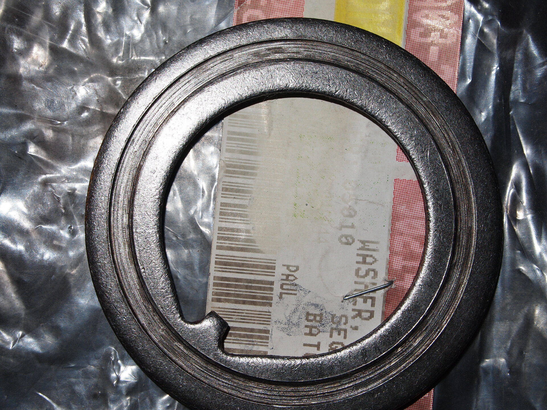

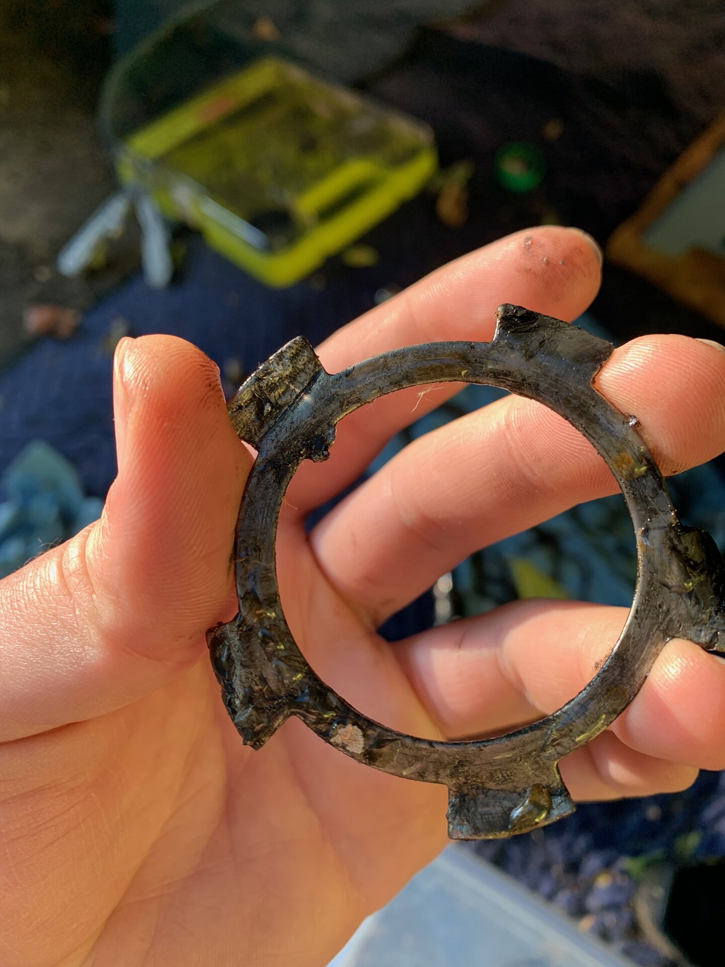

When wheel bearings serviced at each 30K miles. Claw washer scoring, indicates wheel bearing were to loose. Loose wheel bearings vibrate. Claw washer scoring, is due to vibration. As the scoring (gouge on claw washer) increases, wheel bearing loosen more and faster, vibration then increases, scoring increases more, bearing loosen more.
Wheel bearing service done correctly, claw washer will not be scored at 30K miles. I supper clean and uses very good grease and make wheel bearing very tight. I've seen them still tight, at 70K miles later.

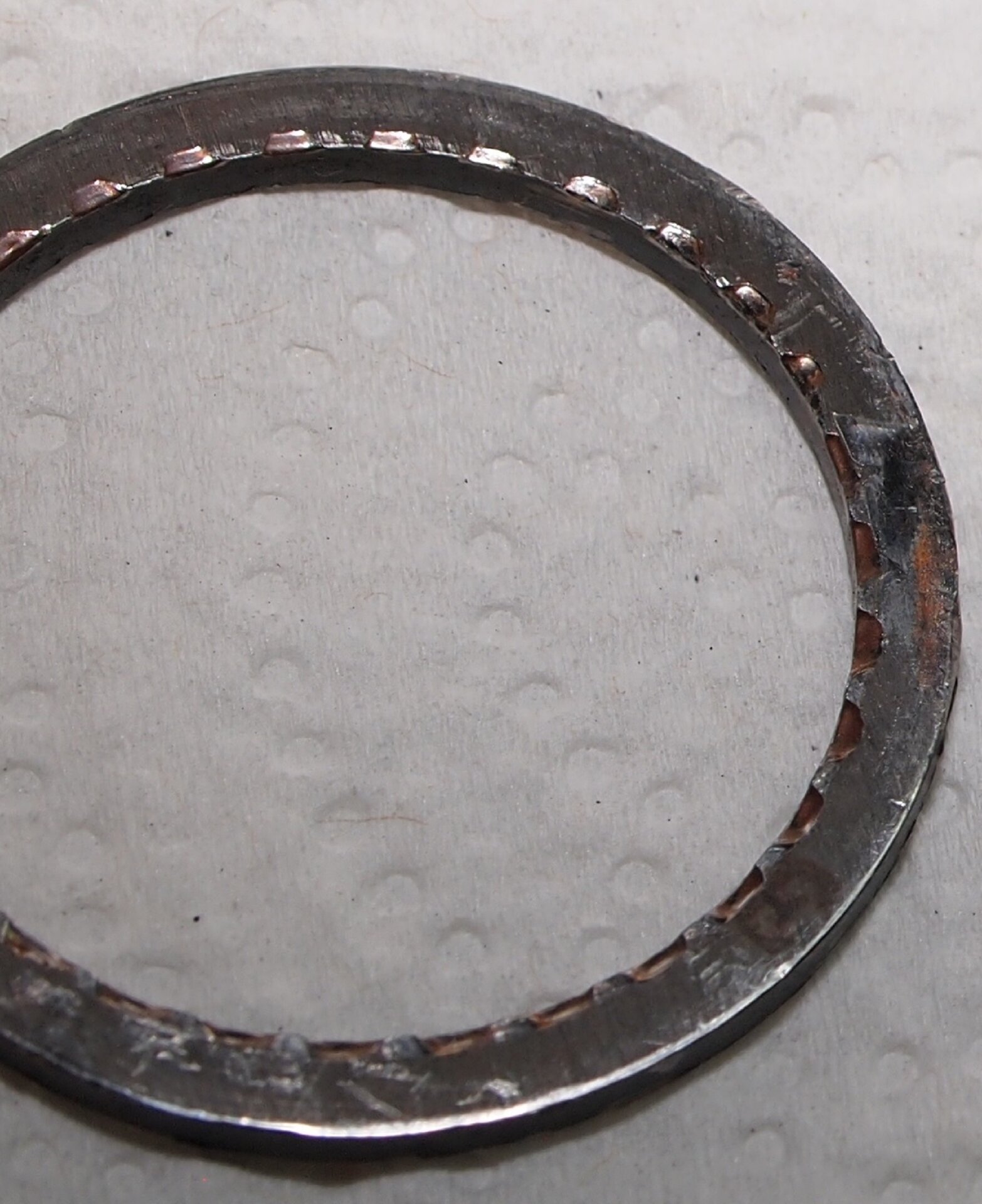

Gapping hub flange snap ring. Spec less than 0.20mm. It is non reusable.
Tight gap is important. It keeps, axle from moving in and out of hub flange, past design limitation. 1) To reduce saw action, on splines. 2) to keep FDS outer seal, sung (water tight) into rear steering knuckle seal.
New grease cap, keep water from entering Hub flange/axle spline area.
It's recommended, each 30K miles. Axle needle bearing and bushing be lube, also. When we do this lube. We need to settle the grease, between axle of FDS (AKA CV) and brass bushing in back of steering knuckle. Many ways to pull axle outward, to settle grease and set gap. This is one (in video), is with just stuff lying around the shop. One can also, install (old) snap ring, and drive around the block to settle grease. Then install new snap ring of proper thickness, once back in driveway. This can be done with tires/wheels on the ground or jack under LWC. Which pushes axle of FDS outward. Thread a bolt (IIRC 8x1.25mm) into axle end, and pull outward hard on the axle.
I use more 2.4mm snap rings, than all others thickness. Next most used, is the 2.6mm, than the 2.8mm. Once in a blue moon (very rare), after replacing bearing/races, brass bushing and FDS. I may use the factory std. size of 2.2mm. Never every, have I used and less than a 2.2mm.
If you use a 2.0 or 1.8mm thick snap ring. Axle not pulled out enough, and the gap will surly be greater than the spec of less than 0.20mm.
Anytime snap ring removed, replace it. They expand and no longer fit sung around axle.

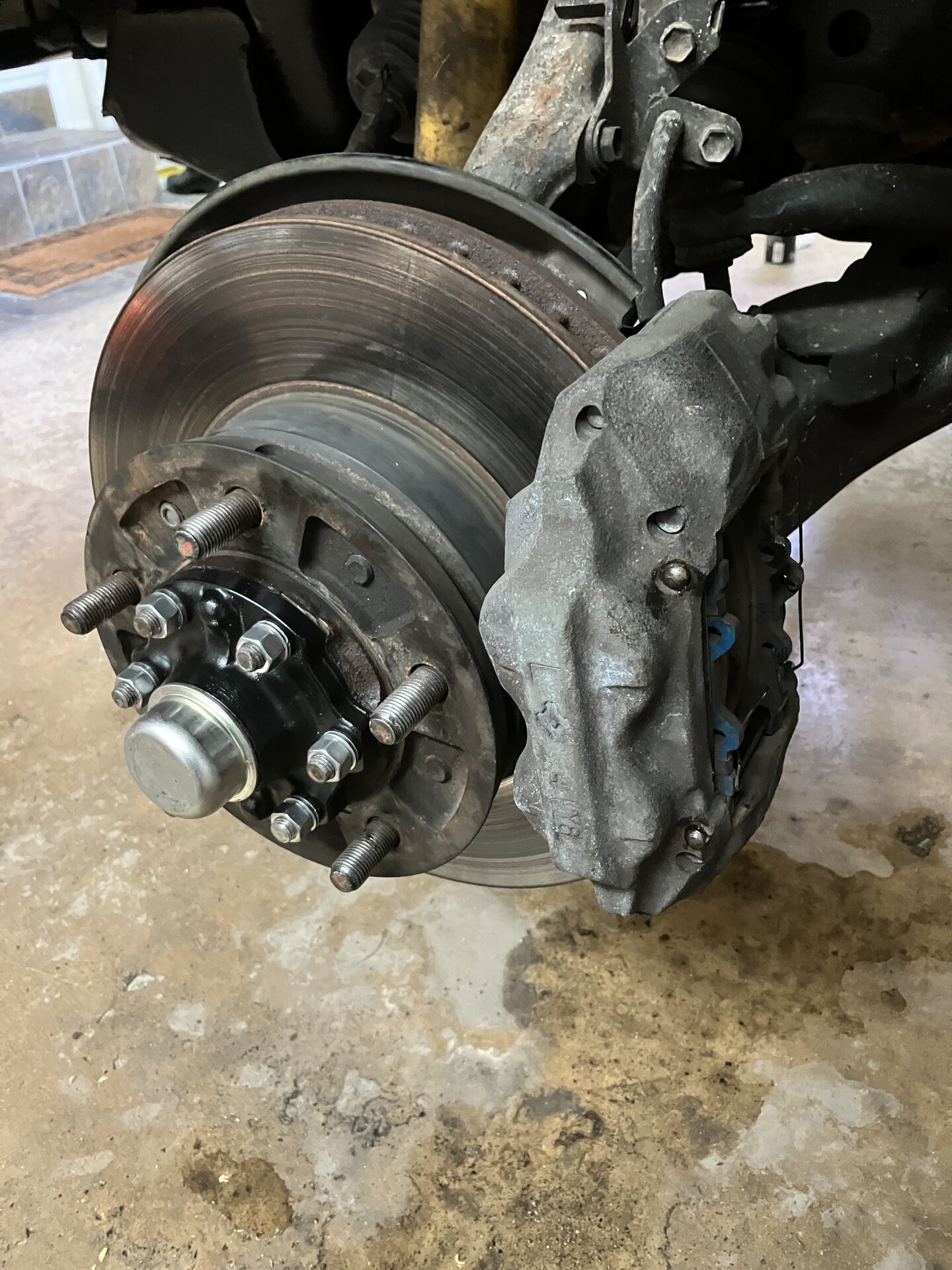

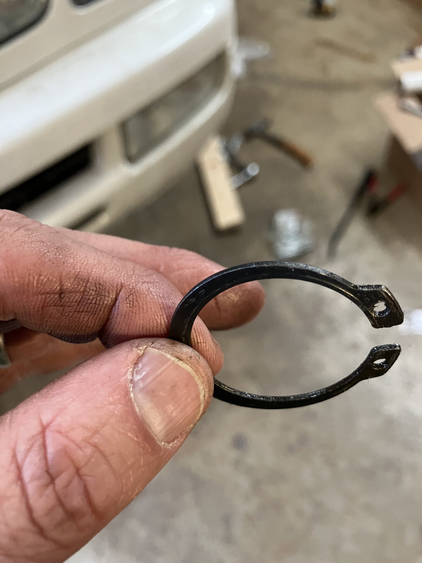

Reporting back…driver side almost done. I had to call a night since I’m almost 50 and my body started hurting. I took the front wheel off to find that a dealer had put the flange back on with LOTS of RTV sealant. Fun getting the cone washers off and everything cleaned up. I could see there was plenty of grease in the wheel bearings, but the axle stub looked dry. I could remove the adjusting nut by hand it was so loose. Again, dealer service < less than 30K miles ago. I used my newly acquired Slee spindle greaser (awesome) to pump a bunch of Mobil 1 synthetic grease into the spindle / brass bushing until it was coming out the back side of the hub. From what I could tell, it didn’t take much Mobil 1 red stuff to push out the old black stuff. Axle stubs looked surprisingly good- just a hint of corrosion in a few spots. It was a bear to pull the DS axle stub back out far enough to get circlip groove available. Following 2001LC’s YouTube video, it took about 65 ft lbs to hit ~14.5 ft lbs of breakaway pre-load. Everything is pretty much buttoned back up and I’ll hit PS side tomorrow. Not too bad, except for 25 degrees and a soaking wet garage floor.
At 25F ambient temp. I'm surprised it took more than 20ft-lbf to reach ~14.5lb BWPL. I've found grease needs to be room temp. ~68f or it thickens below 45F giving a false low BWPL. But at 65ft-lbf on adjusting nut, you're good.
You’re using “you’re good” pretty loosely. Haven’t driven it yet. Still need to do pass side- starting now. A 2.2mm circlip fit perfectly on driver side axle shaft- no slip. Better than the 1mm clip I pulled off.
