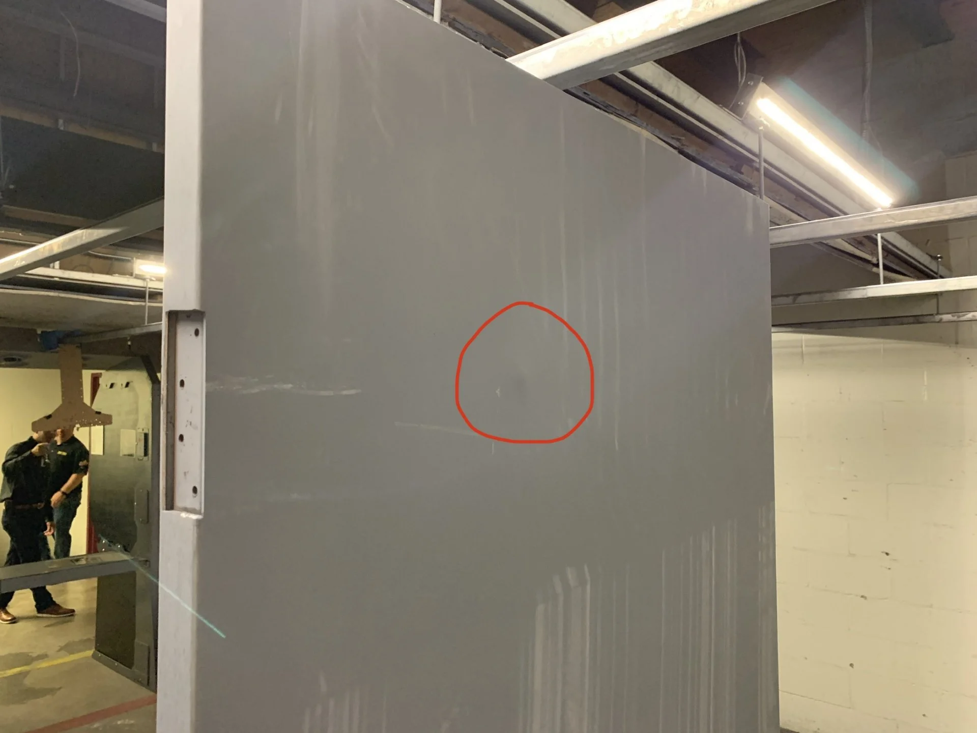

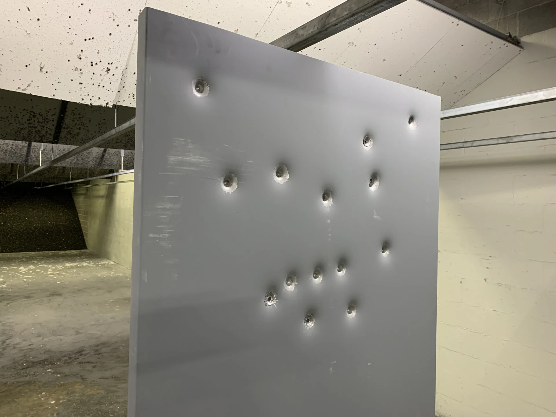

On a completely unrelated note: I did get to have a little fun. I’ve been working on a new design for a Level 3 rated ballistic door over the past few months, and my design was finally approved and I received my UL 752 Rating. It took 15rds of .44 magnum lead slug from 15ft with no penetration (only needed 3rds to pass). Even included 2 rounds in the exact same location circled in red which only caused a 2mm dimple on the top skin. All other rounds didn’t even make it all the way through the bottom skin. Next goal is Level 7 to withstand 5.56mm FMJ!

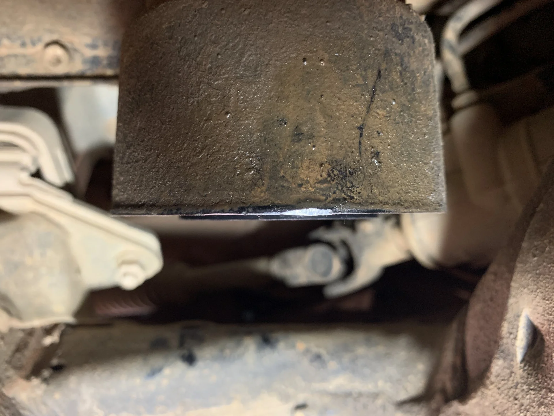

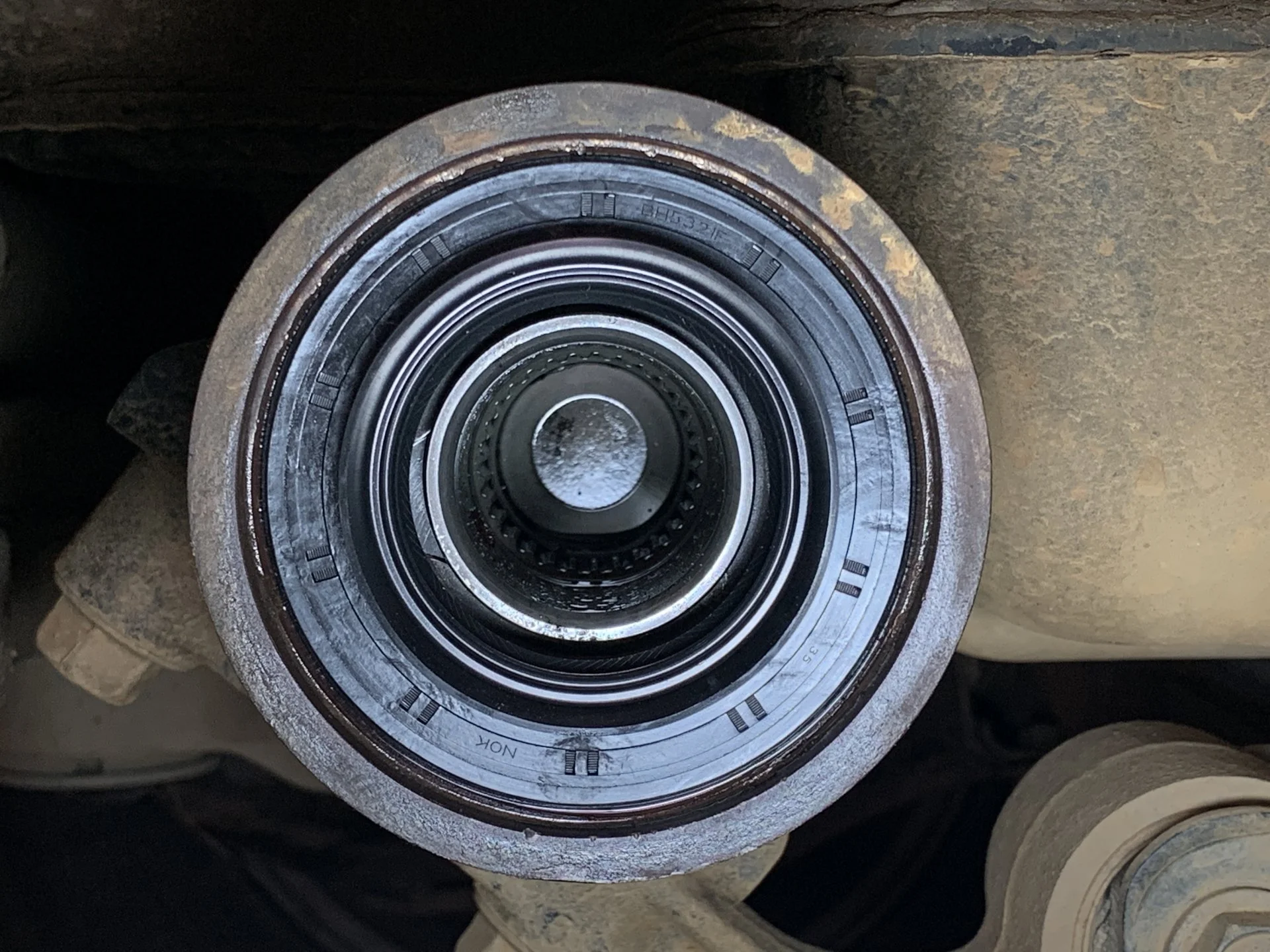

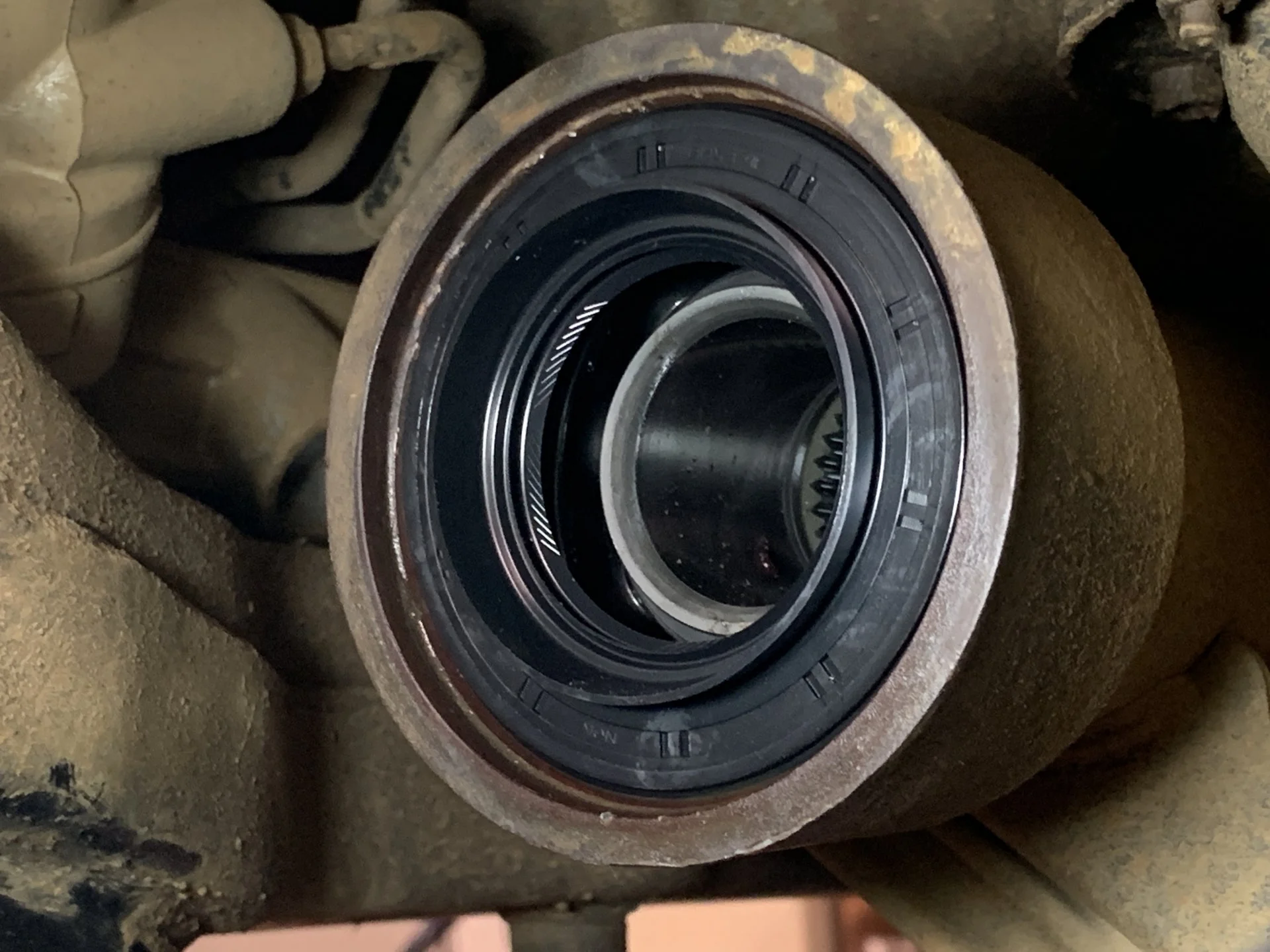

I didn’t want to risk it and went ahead and changed to my backup seal. The seal puller I used tore the first one but no big deal. This is where I’m at now. Right at about 1mm protruding beyond the diff tube. First pic is shot from directly underneath looking up, you can just barely see the lip of the seal. Think this is good?

None whatsoever! I’ve been very happy with how everything went back together leak and creak free hah

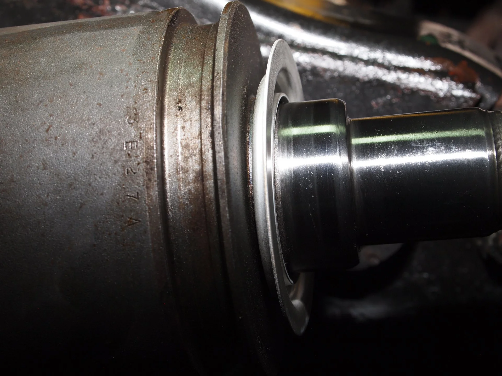

You want flush with inner shelf as @flintknapper pictured.
This puts protruding lip level with outer diff rim. You can be out 1mm, which ten seat even better in dust shield.
Than seals protruding lip, will fit snugly info FDS dust seal.

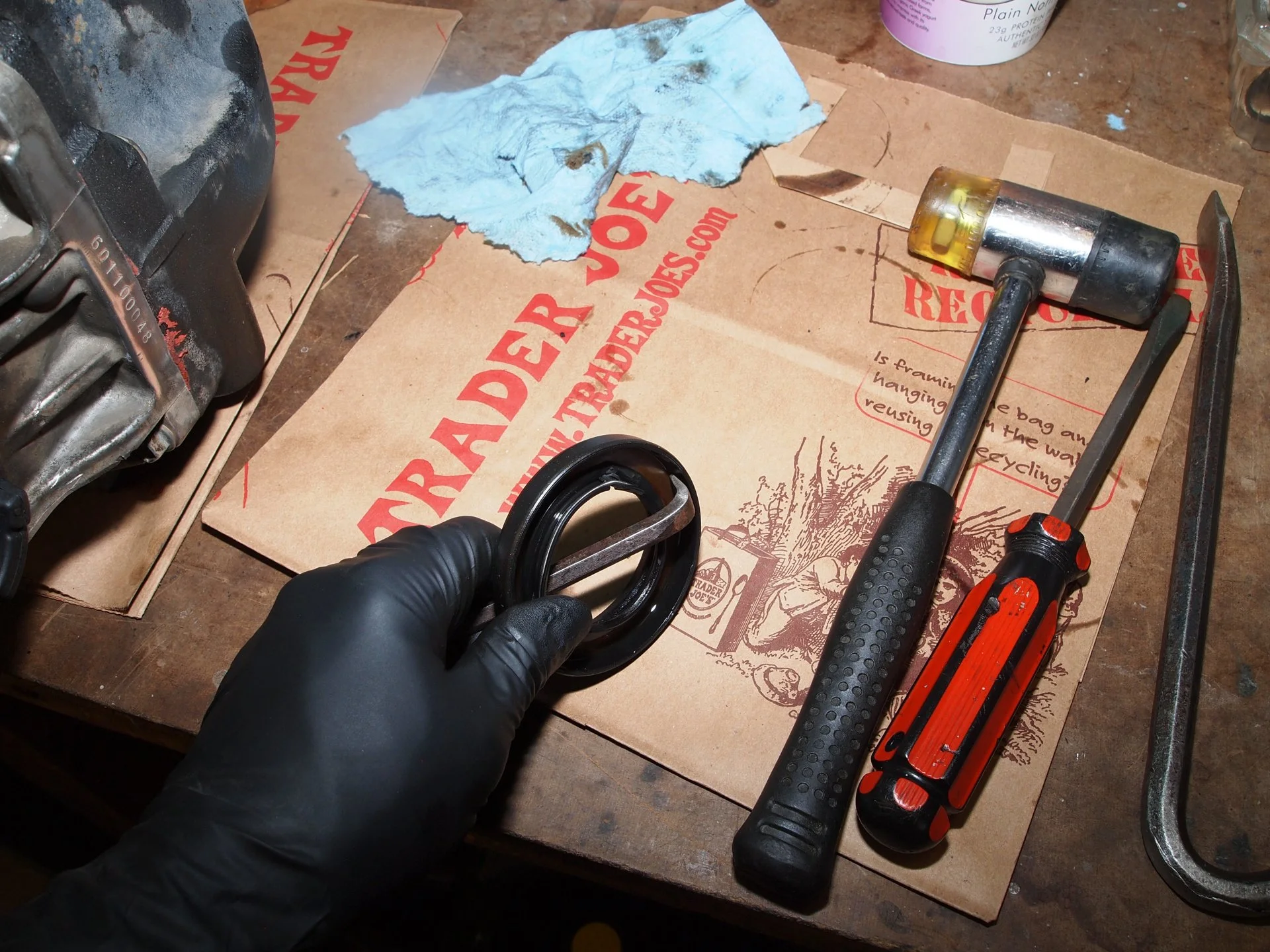

You can save DS seal if you like. I often find I've set in a little to far, and leaver off inner diff tube and off metal plate on back of seal .View attachment 2682698
Most important take you time and get seated squarely. One side in more than the other, is when they leak.
