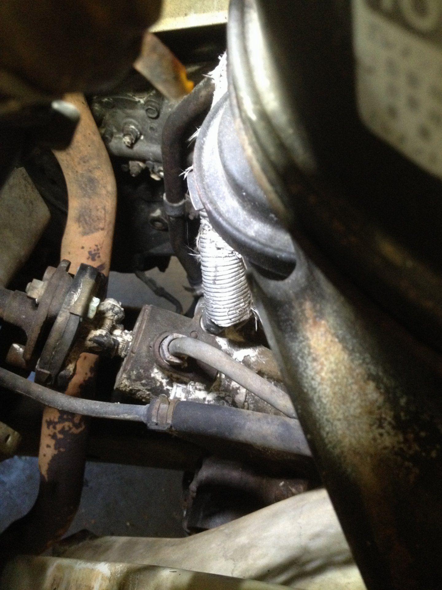

I also installed the power steering pump where you did with the alternator in the stock location underneath the pump. I wasn't able to loosen enough tension on the pump belt to change the belt if needed much less get it on. To long of a belt and I wasn't able to get enough tension on the belt but I could get it on the pulleys and to short of a belt forced the removal of the pump to get the belt on. I struggled with that for two days! And if I ever had to change the alternator it would have been a tougher job. So I moved the alternator to the right side and everything worked out perfectly.
Small world; we both use the same brand of oil filter, I date mine as well, your fuel line looked like mine before I changed it out and we changed the oil the last time within a few days of each other. I guess we all think alike to some extent.
If you look at the bolts I added a plate to the head then mounted the pump to the plate. That allowed me to move the pump out towards the fender and forward some to align with the front pulley. That gave me more room for adjustment and I like that it is on a separate pulley from the alternator. Also gives the water pump a second belt.
Now that you point it out I can see the extra plate under the PS mounting bracket. Good idea.
