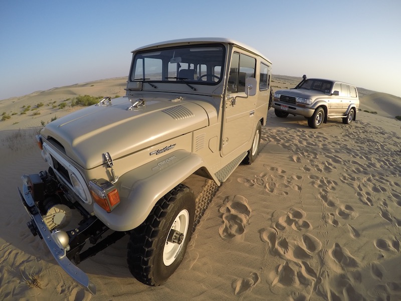

Had some friends visit us here in the UAE and took them out for a desert BBQ... required the 40 and 80 to get everyone out there (4 adults and 6 kids).
