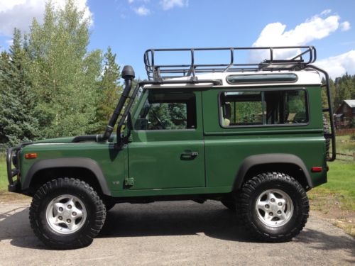

I, personally, like what you did. I like that hue of green. A hue that's rugged looking & nature-wise adventurous. And true to the heart of the nature of the '40 series, the paint is not metallic, but rather remains as a simple solid. I say nothing wrong with metallic though, albeit on a more heavily modified '40 (Metallics of course present a unique depth that the solid colors naturally lack).
And that you chose a Land Rover hue of color, I like that you went out of 'the box.' Which I think, in a number of ways, is cool.
No doubt an Uber-Attractive rig would be the one below, repainted a British vintage Jaguar color, 'Willow Green.'
And in honest, I can't imagine a better looking blue than Land Rover's Arles Blue. It's soooo rare of a color on "our Toyota" - a Land Rover color !! But how can one argue that it NOT LOOK GOOD ? Particularly to the novice, who constitute just shy of 100% of the people on the streets who will compliment you, daily, on your future rebuilt vehicle. An Arles Blue FJ40, which I find looks awesome, is below. The color is most similar to Toyota's medium bluish color of Cadet Blue, although Arles is more bluish, and Cadet is more gray.
The only Arles Blue I know of (belonging to MUD member, @nick ) :
And the only Cadet Blue I know of :
I say your Coniston Green will look Great on your rig !! ~Skydog
