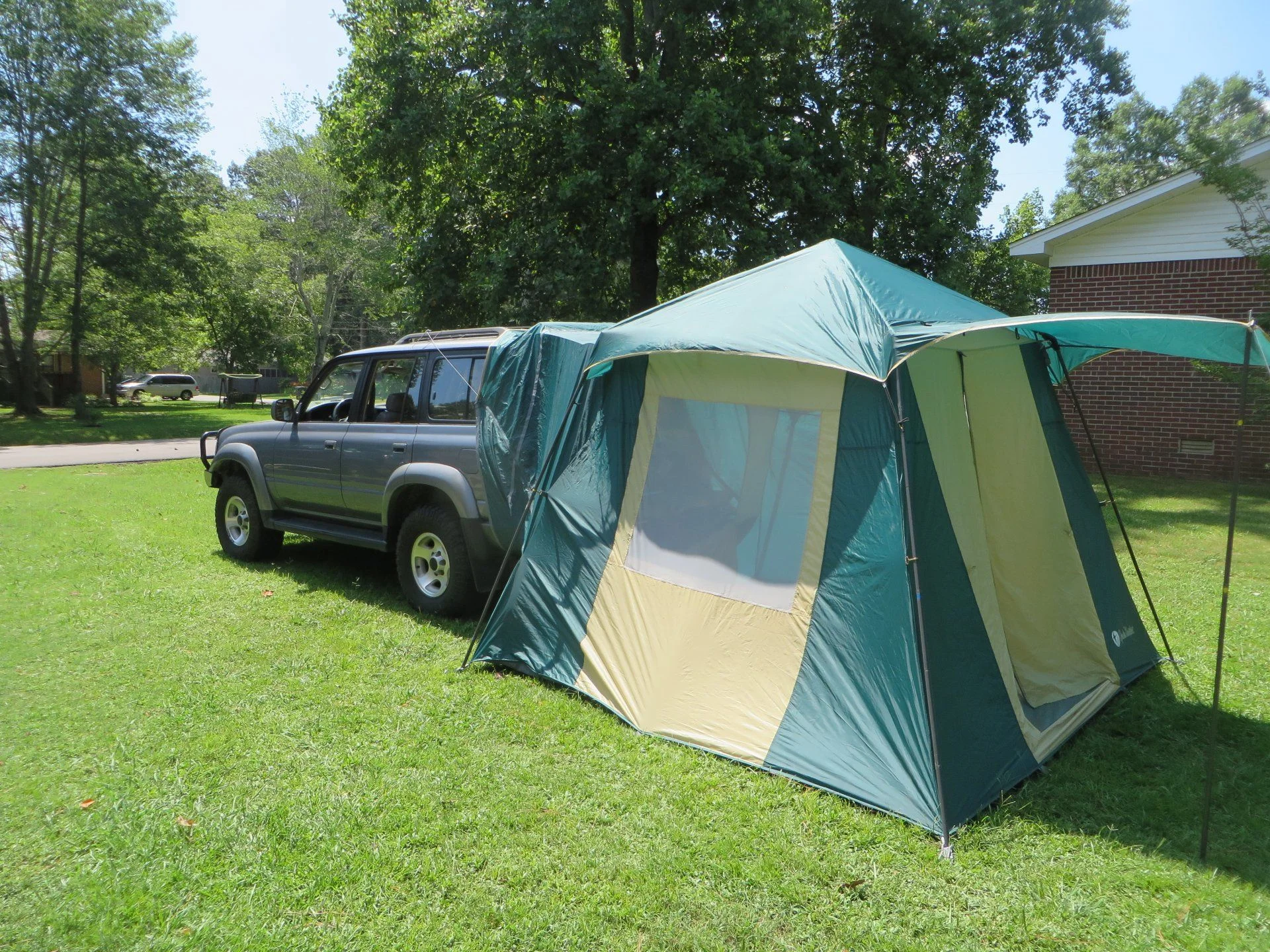

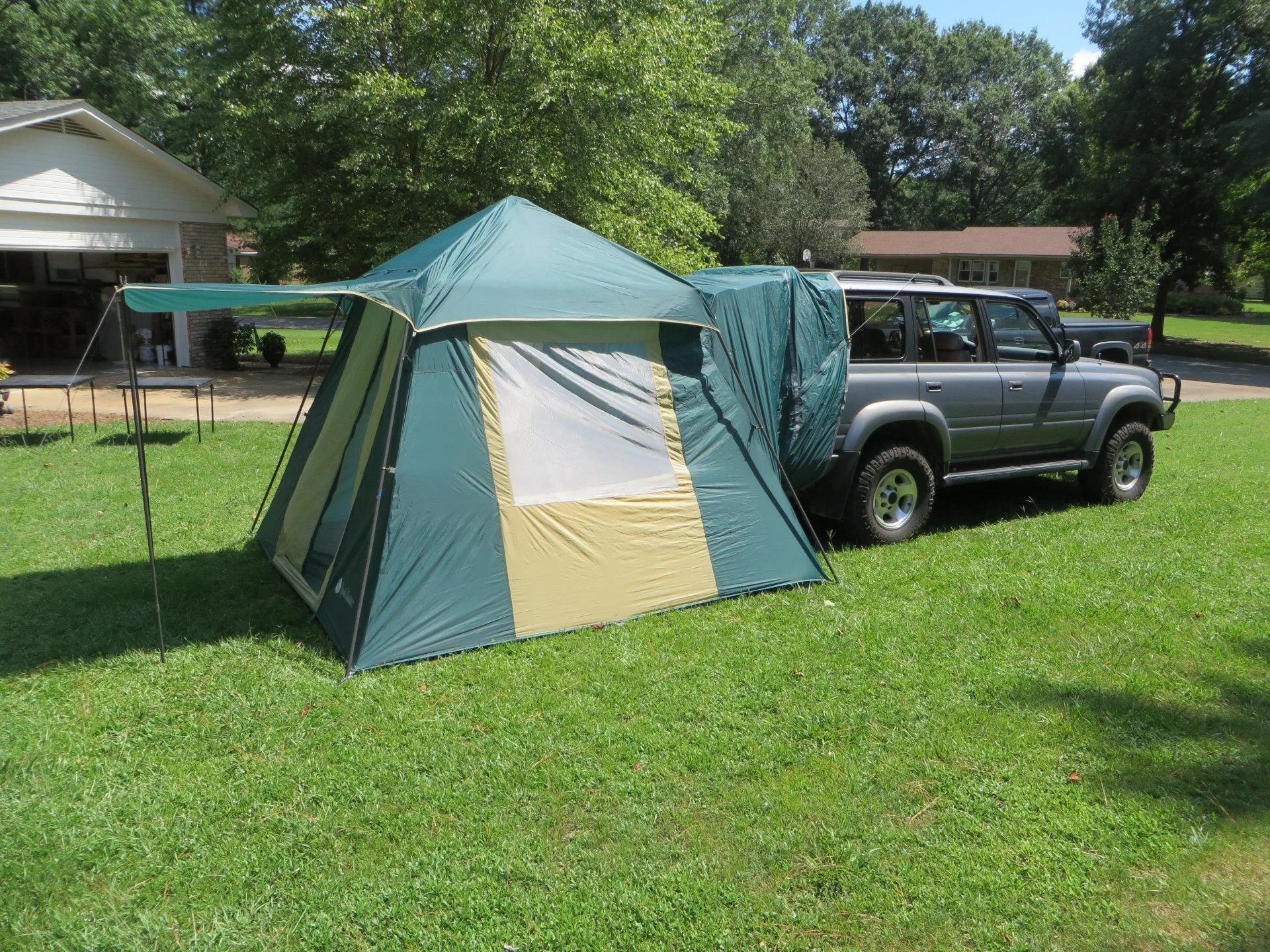

Setup my new to me Suv Tent, think we are going to really like this
That looks sweet - could you share any info on it, how it's working?
Just got it, this is the first time we have put it up. It is a Gander Mountain Brand Tent that is discontinued. I will post more as we use it this fall
