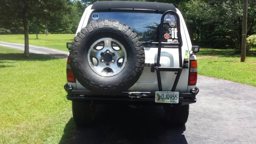

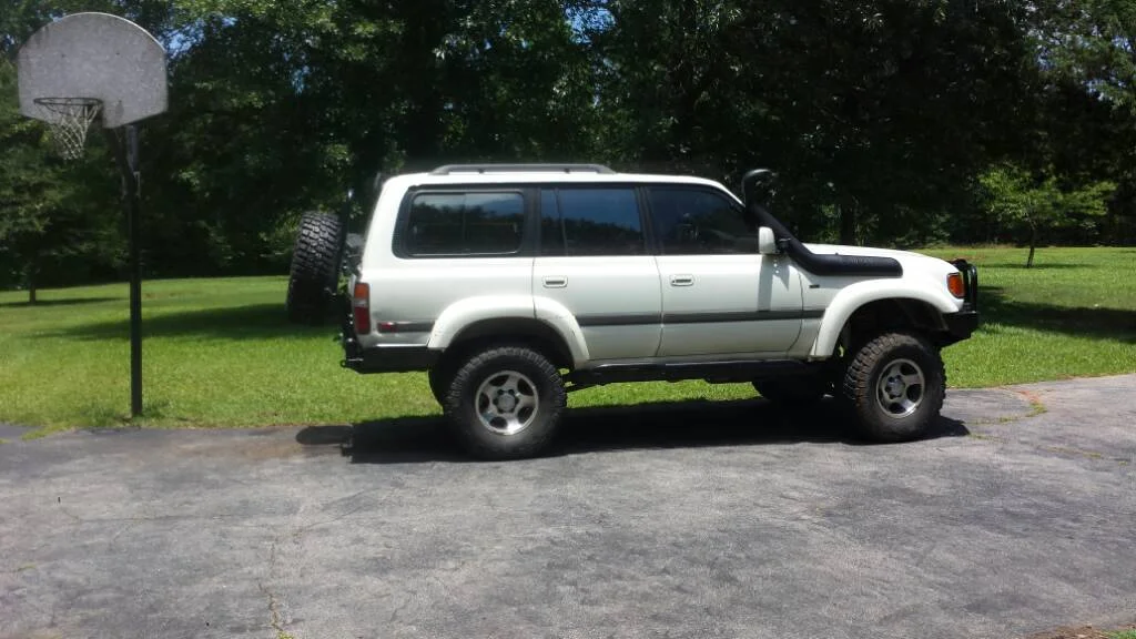

Installed rear Air Lift bags, TMS snorkel, front O2, water pump, hoses, idler, a/c tensioner, belts, distributor o-ring. Phew. Camping tomorrow!
