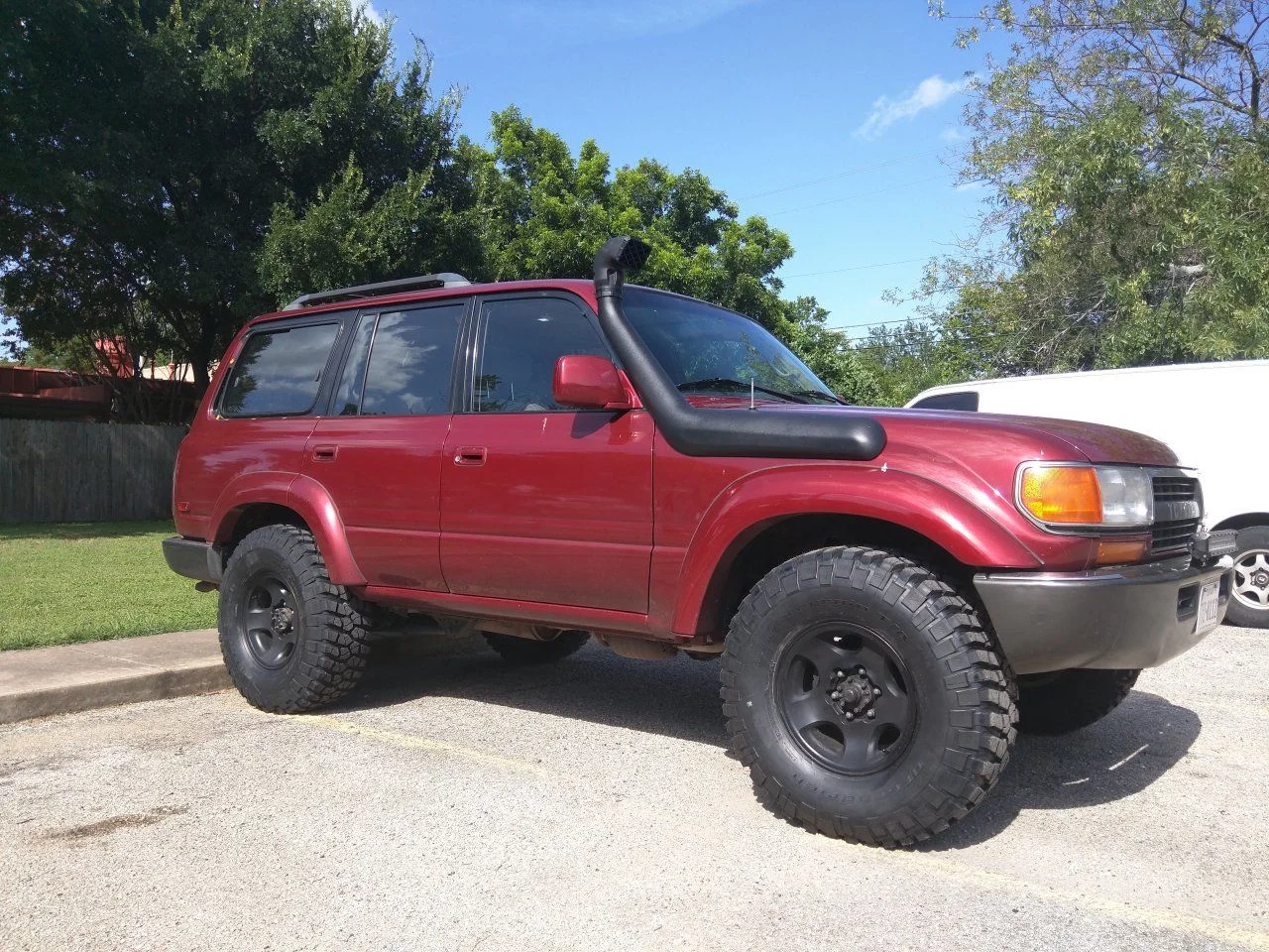

Chinese snorkel and got the 315s mounted. For now, stock height.. I have a MAF 30mm spacer on front to make up for sag on the stock springs, and both rear rows of seats + spare gone, so the rear went up a bit too. Very slight rubbing on front bumper.. but that is just driving it around town. I haven't had a chance to twist it up yet. Going to copy the swingout-carrier-in-a-stock-bumper soon.
TJM progressive springs & caster bushings, Fox shocks, OME stabilizer all on the way.

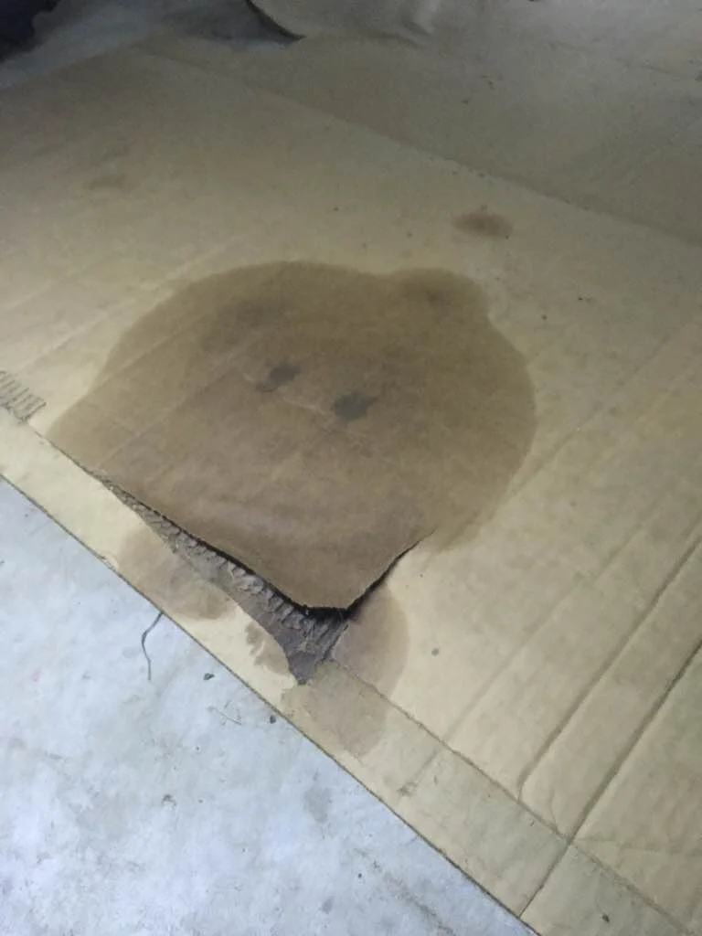

So after my trip to Texas I felt this unusual wobble I thought it was the wonderful Texas mud. I cleaned everything. Checked all the nuts and bolts. It drove fine on my next trip. Today I took the lx for a quick drive and noticed the same wobble. However this time I think I found the problem. A busted steering stabilizer. I replaced the stock one with a doetsch unit 4 months ago but it looks like all the oil is on my garage floor. Any suggestions for a more heavy duty unit? I have about a 4 inch lift.
