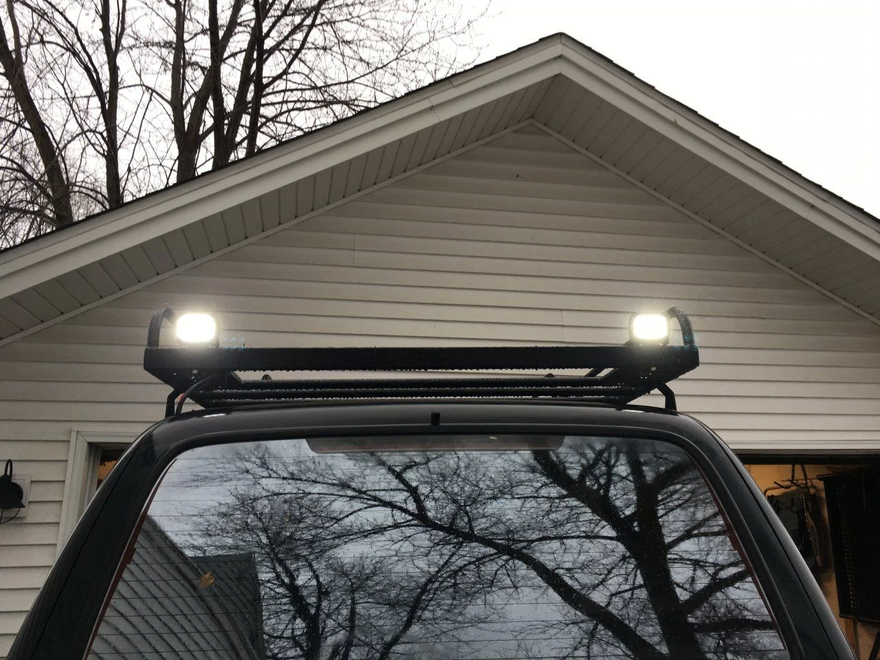

I was thinking the same thing. I haven't been happy with any lights on the roof. Between glare in the windshield and fog/rain glare I'm very close to removing my roof lights.
In the past I always ran lights on the bumper and lights on the roof. Two separate purposes. Roof lights wouldn't be used in the rain/fog because of the glare.
