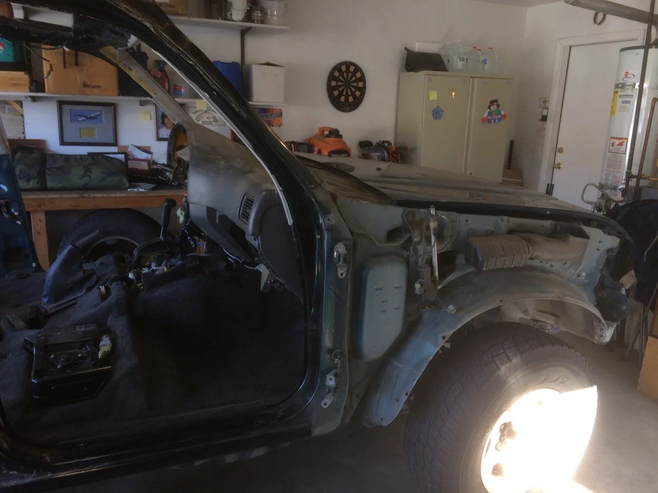

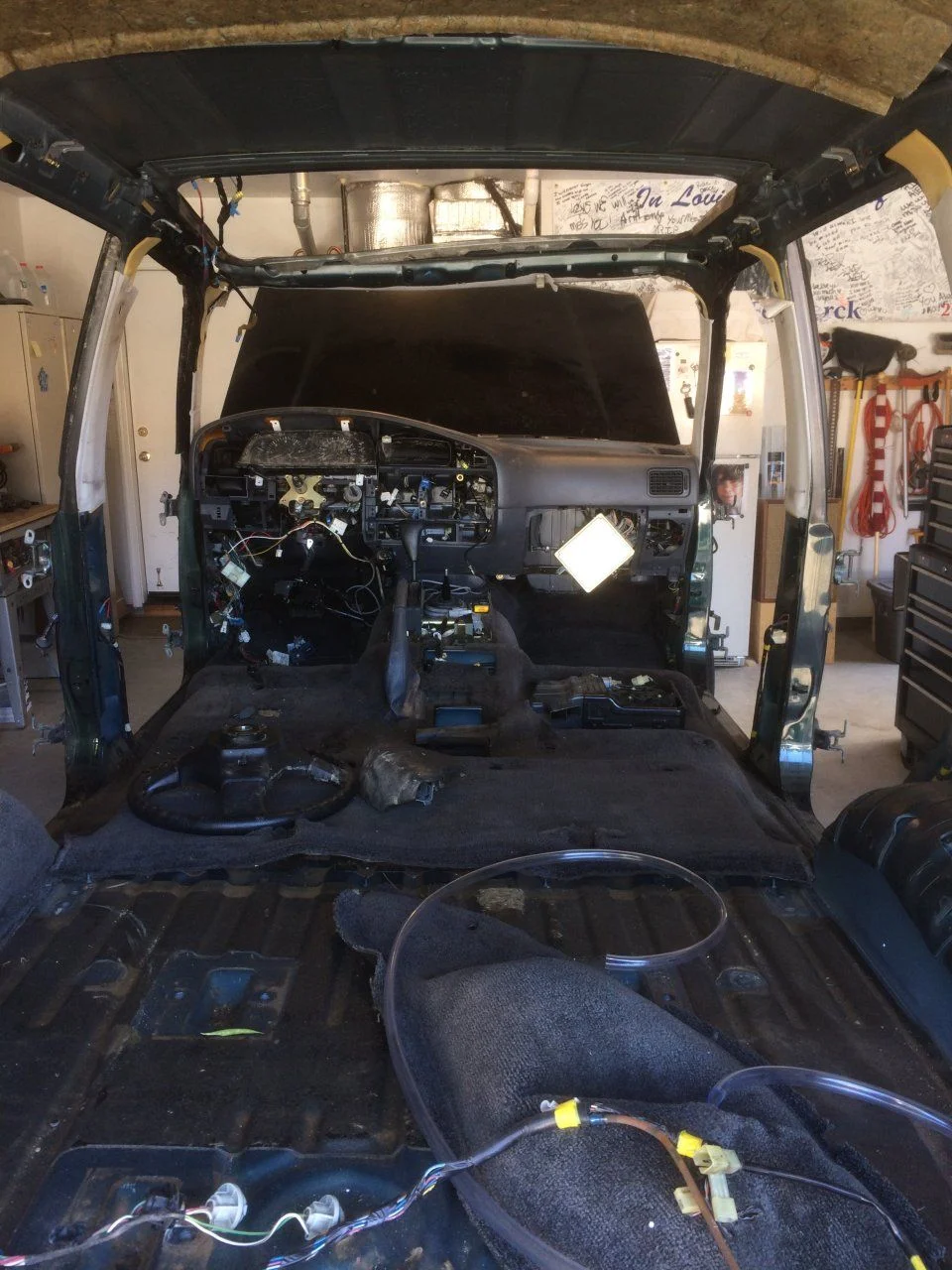

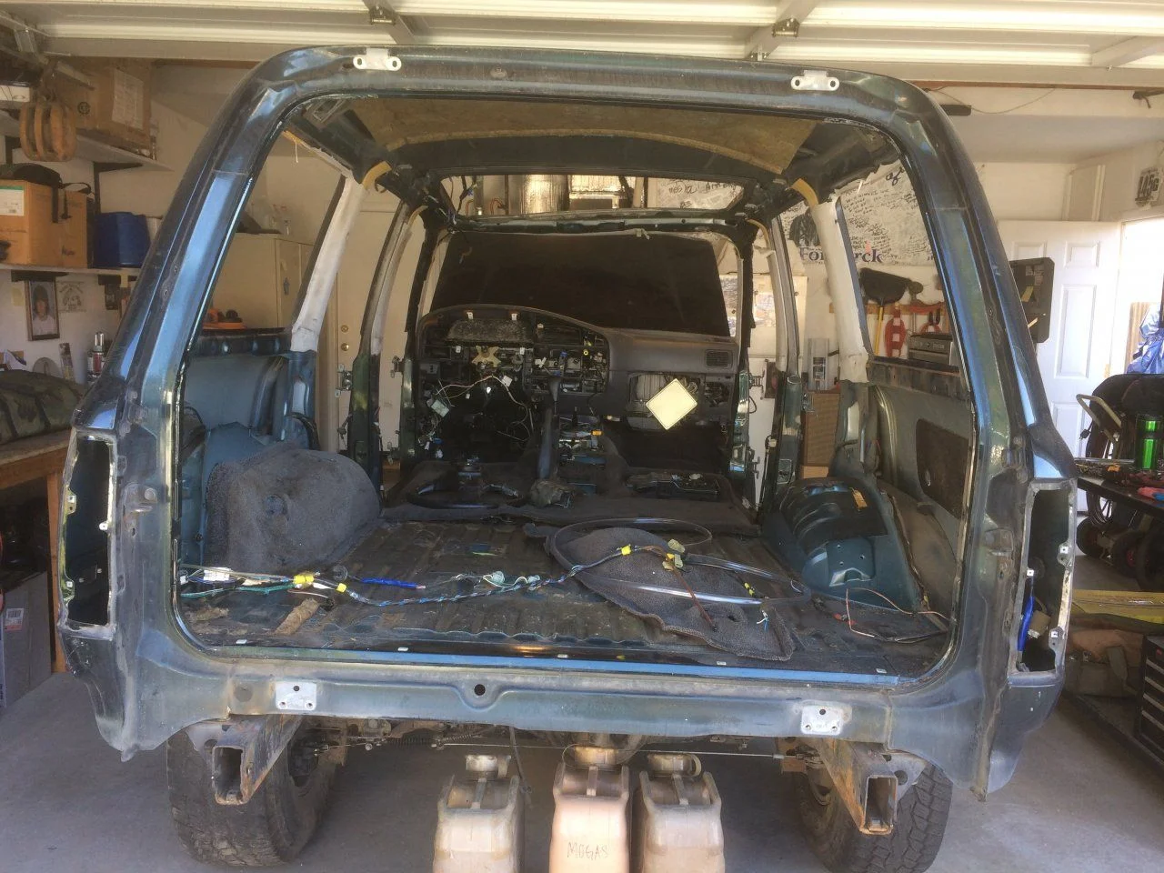

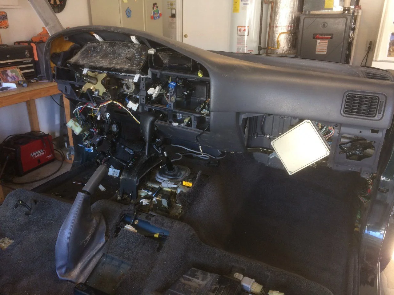

Been working on disassembling one each 1994 80 series which met its early demise one year ago when it's drive/owner (that be me) put too much confidence in the 80's snow/ice capabilities. She and I rolled three times down a steep incline. I walked away with only broken pride. The green machine is now my parts donor.
On our way to California...
All that just to get to the Antenna motor???
:eek:
I am learning a lot about the 80 series during this disassembly. The ease if antena access with outer fender removers is one such lessson.

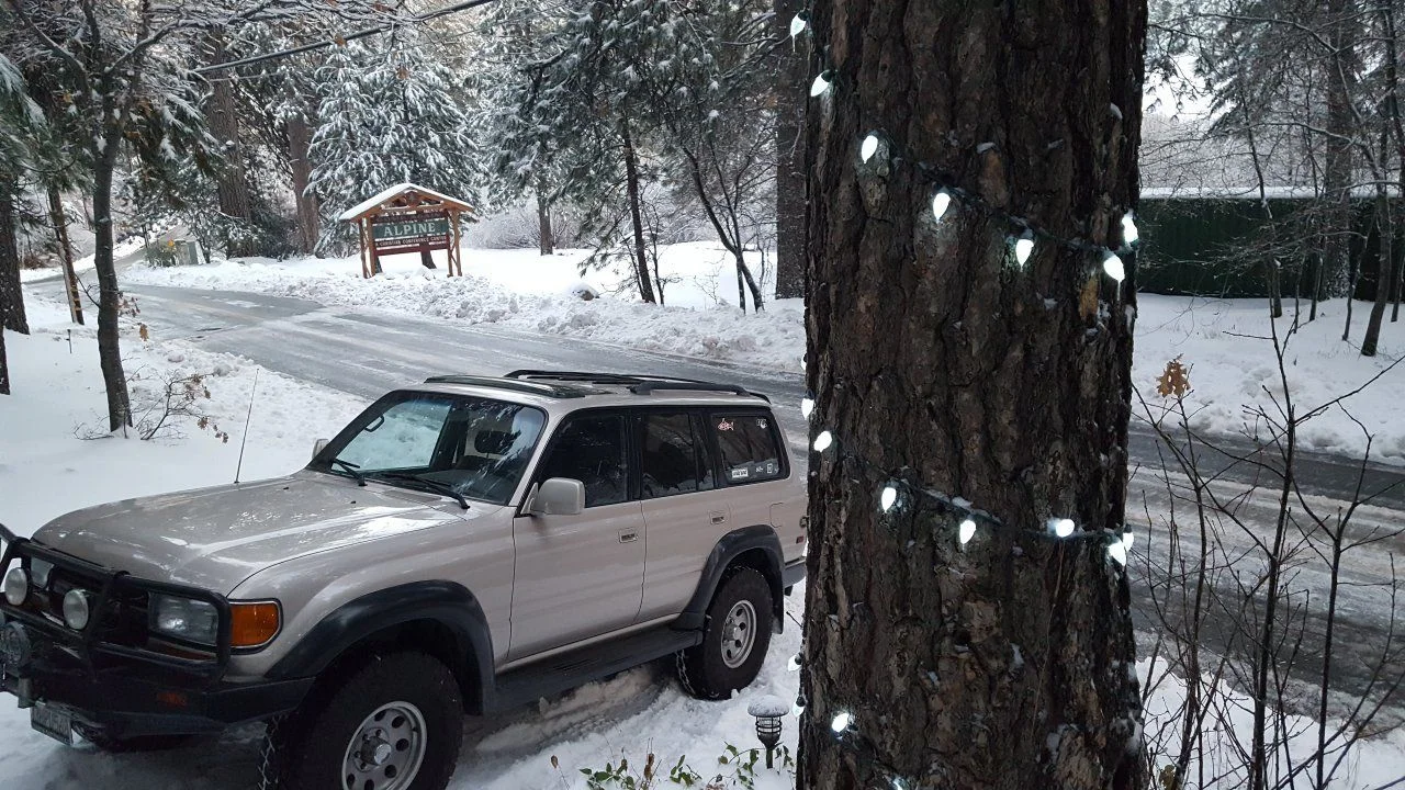

Took the cruiser up to Lake Arrowhead. Icy and COOOLD out! Had to engage the Harrop/Eaton front E-Locker to get up some of the paved inclines. While everyone else was slipping and sliding, the cruiser just mashed through it! :steer:

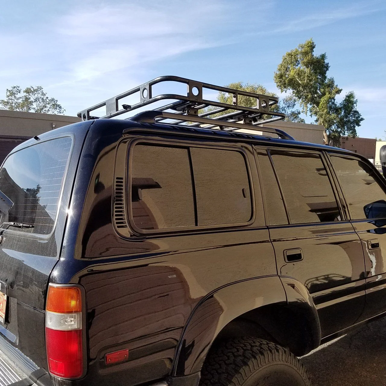

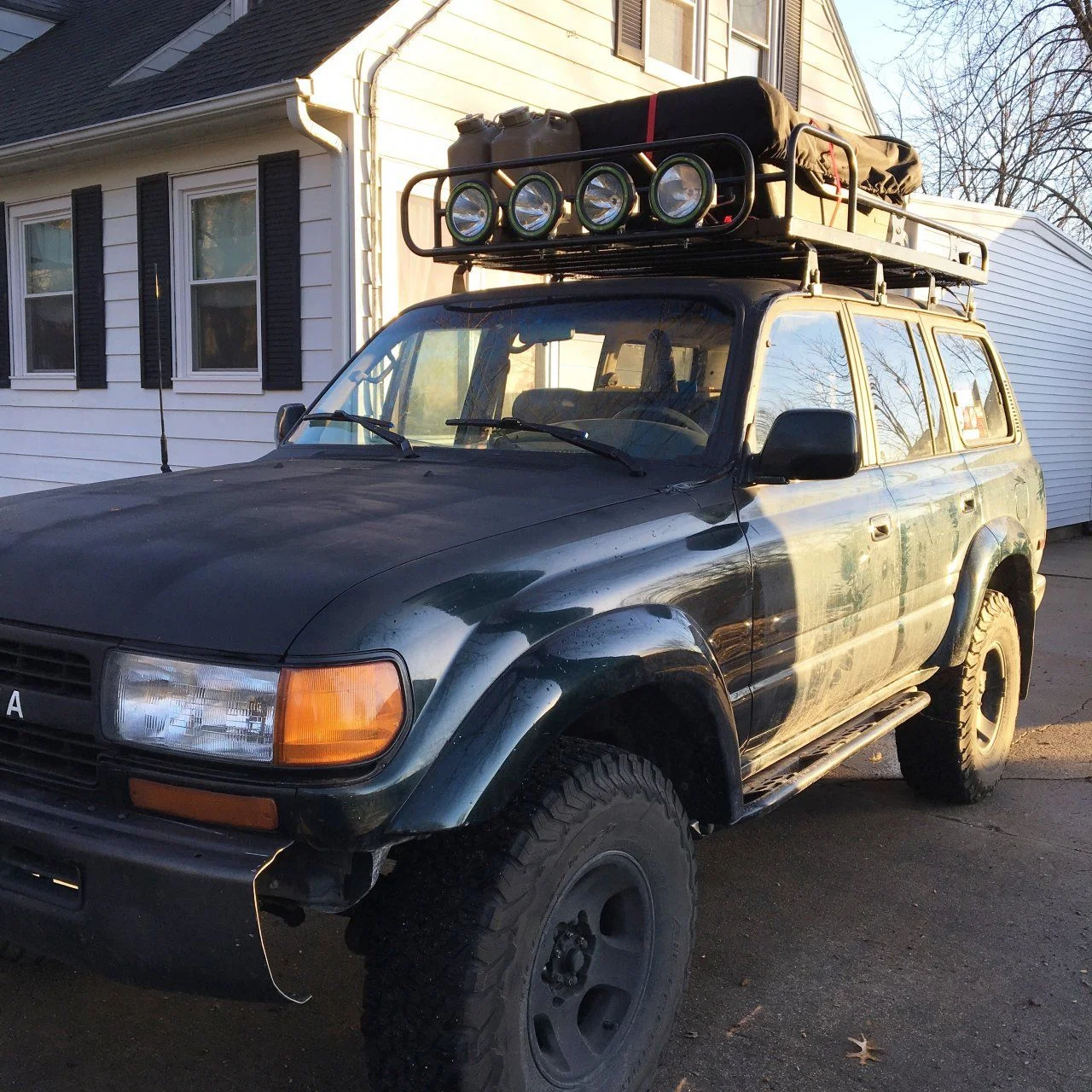

Found a used Smittybuilt roof rack for $100, only to find out the mounting brackets weren't the right size or type to mount to the rain gutters.
I then found a used set of OEM roof rails for $100. I cleaning, painted and installed the roof rails (after fixing one rivet-nut on the front driver side). The mounting brackets that came with the Smittybuilt roof rack fit the OEM rails, but the rails aren't long enough to accommodate the rack.
Since the rack is three sections, I removed the center section, fabricated some studs to mate with the alignment holes on the end sections, bolted it together for a short rack, and installed it.
Also replaced the flasher module to eliminate the rapid flash error from installing LED lamps in the turn signals.
Long story short, "Elsie" got railed, got a new rack (albeit not as big as I'd originally had in mind, but adequate) and yet still is less likely to flash rapidly. :-)

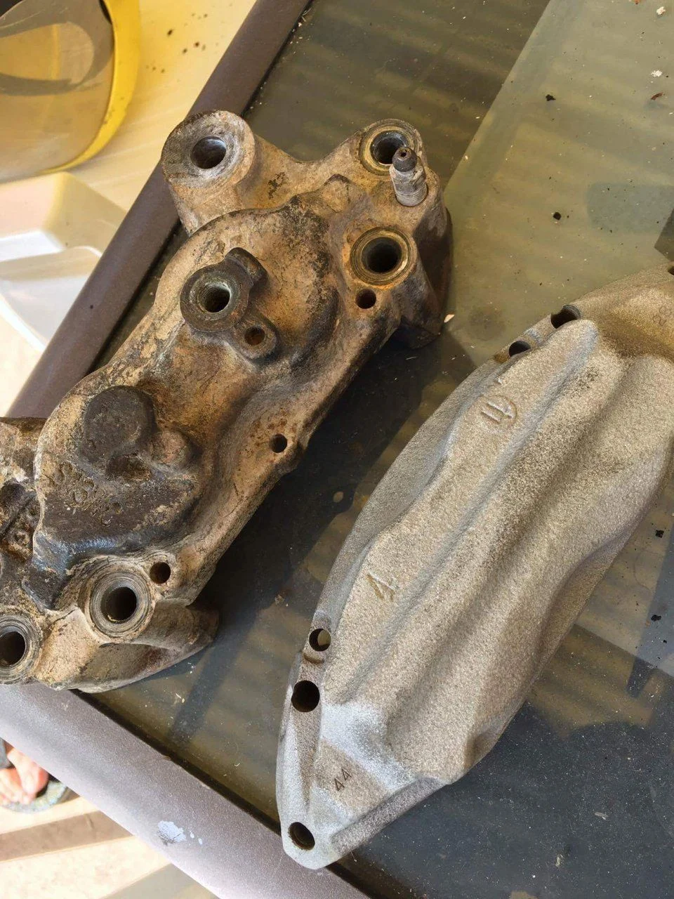

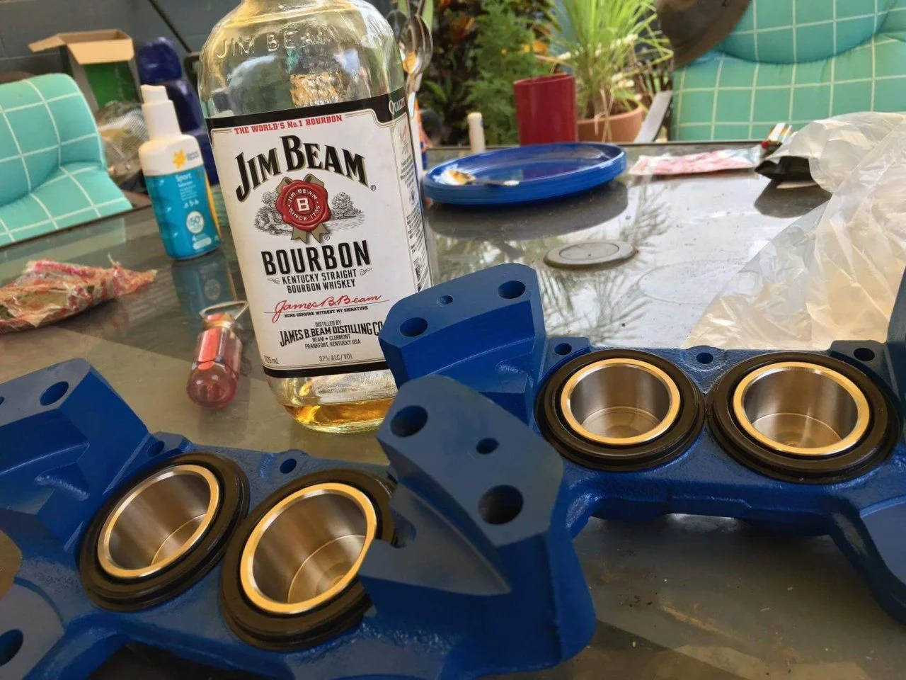

Spent Boxing Day recoing the bigger brake calipers in preparation for the reassembly, quick lick with the blaster to knock the crud off, coat of paint and new seals and staino pistons. These with some nice slotted rotors, heavy pads and braided lines should lock up the 35's no worries :)

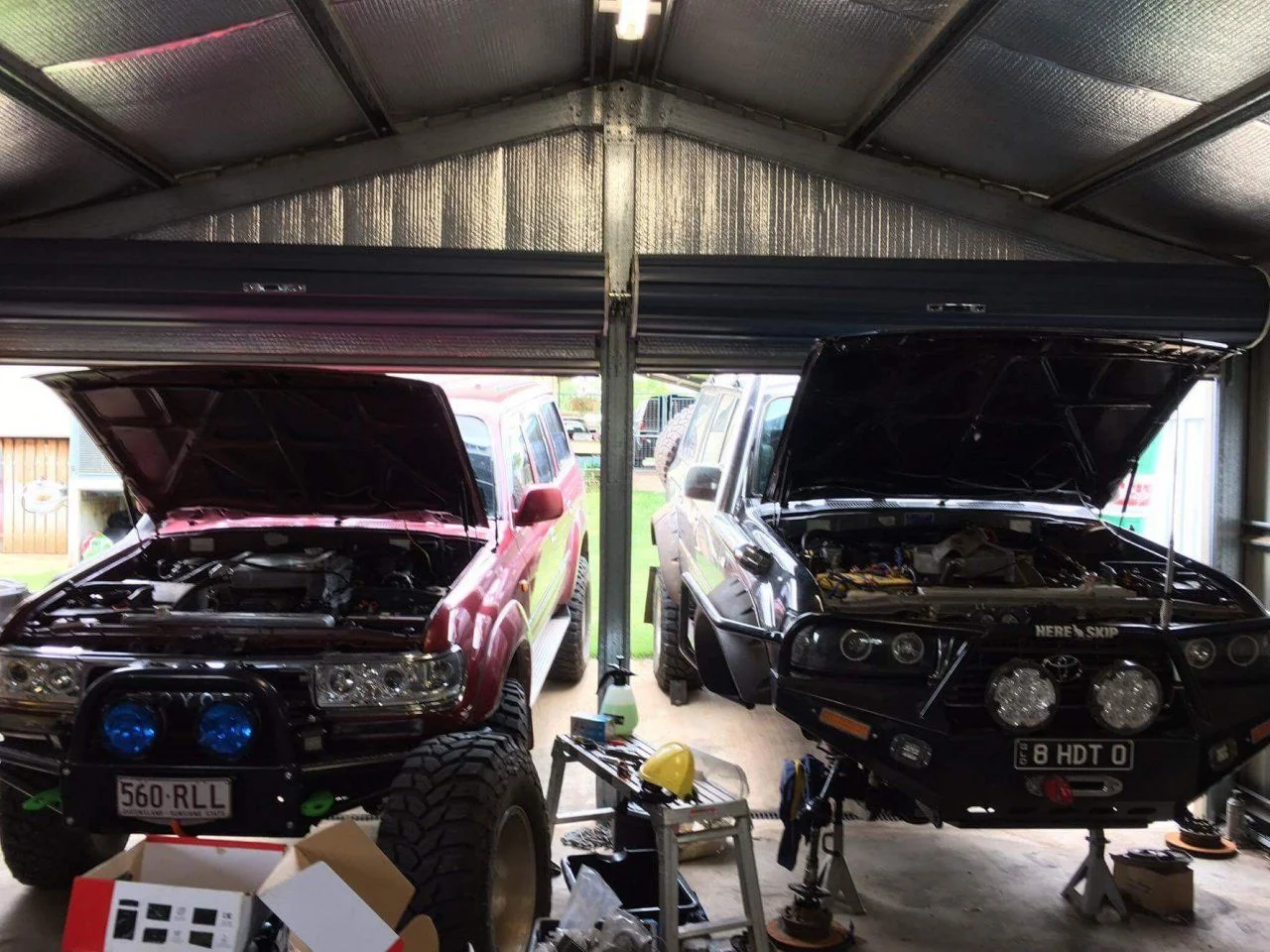

Also did a sub and egt/boost/temp gauges for the mate that's been giving me a hand with the front axle, shed looks pretty good right now :cool:

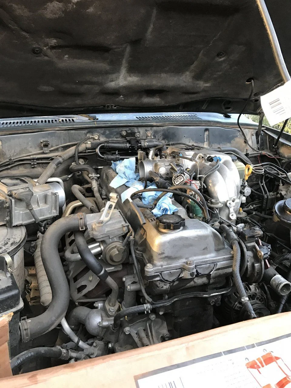

I am still contemplating switching to green. Time will dictate. The cruiser hasn't been driven for a year because it needed a lot of TLC and the AC is out. So far I've ...
New valve cover gasket and resealed the leaking half moons.
New PCV and related hoses
New EGR VSV, the old one has been confirmed bad.
New crankshaft seal
New oil pump cover gasket
Cleaned the air manifold and throttle body. Choked with carbon and oil.
Removed the injectors and had them cleaned. New o-rings,insulators, grommets and spacers.
Replaced every vacuum hose and cooling hose I could reach. I have a few evap fuel lines to go.
This has been much more fun since the Cruiser is no longer my DD. Relaxing the plunk away at it when not rushing.
