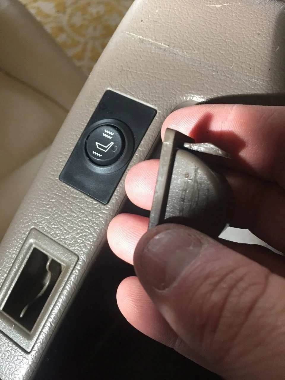

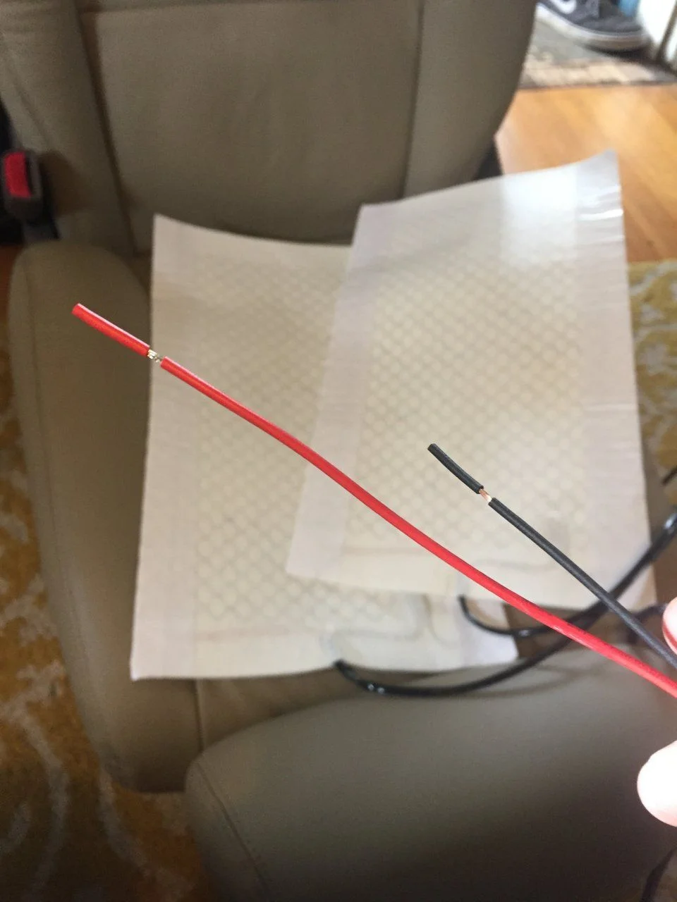

Heated seat install.
Kit courtesy of @LandCruiserPhil hardest part was committing to pulling my brand new leather off to slip the heating elements in.
After that I used Phil's beta and another heated seat thread to tap into the existing loom under the center console. Presto! Warmth.
Leather removal in process
Heating elements ready to go.
Switch installed
Plug it all together and now my wife's butt stays toasty. (She wants to drive all of a sudden)
So far I can see this being the least expensive mod that will get the most use.
While some will say it's a 1 bannana job I give it a 2.5 due to stress and blood pressure of removing my new leather and re-hog ringing when buttoning everthig up. (Which was actually easy).
Thanks to Phil for the insights and a opportunity to give this a whirl. **** star mod for sure.

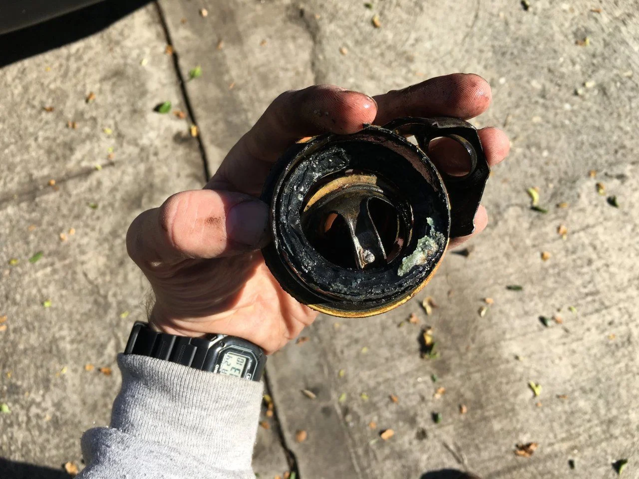

How old or how many miles were on the bushings?

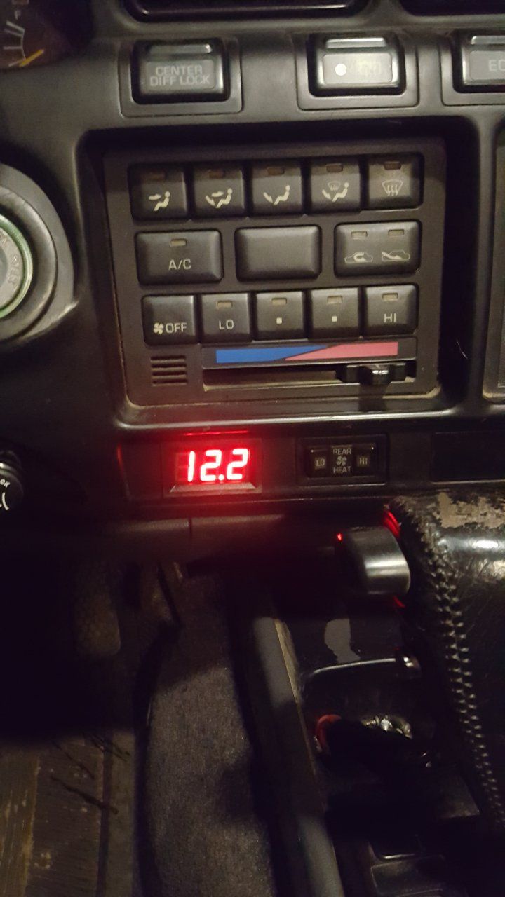

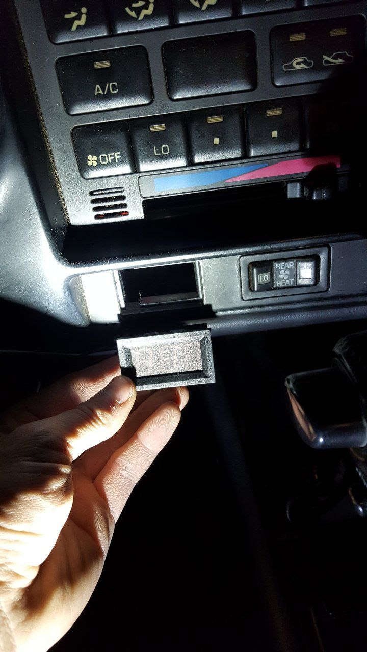

Did some electrical work. Which is generally not a good thing. However I have never had anything light on fire...yet.
Started by trimming the dash panel in my truck with a dremel to fit my gauge. Always use eye pro, because I dont. Also dont gouge it too far, because I did.
Then wire stuff together constant hot from the battery. I surprisingly fused it on the hot lead, which is really rare for me to actually do. The 80 is changing me, things are only marginally getting cobbled together...
After driving it, i would probably move my rear heater switch over to the left and punch out the center and left for voltage gauges. If I could. My steering wheel obscures the view when driving. When I toss a second battery in ill be using the other blank spot for a second gauge.
Do you mind sharing where you got the gauge? Been looking for one myself.
Just a cheapo amazon gauge, i paid like 3 or 4 bucks for 2 of them like a year and a half ago. Multiple colors. I run red for everything usually though as far as lights. I would reccomend punching the right side blank though! Its a constant hot so its always running even truck off. I doubt it draws more than a radio preset power lead.
DROK Small Little DC Digital Voltmeter 2-Wire 0.56" DC 3-30V Red Bright LED Car Motor Panel Mount Meter 5V 12V 24V 27V Solar Battery Volt Accurate Power Monitor Gauge: Amazon.com: Industrial & Scientific

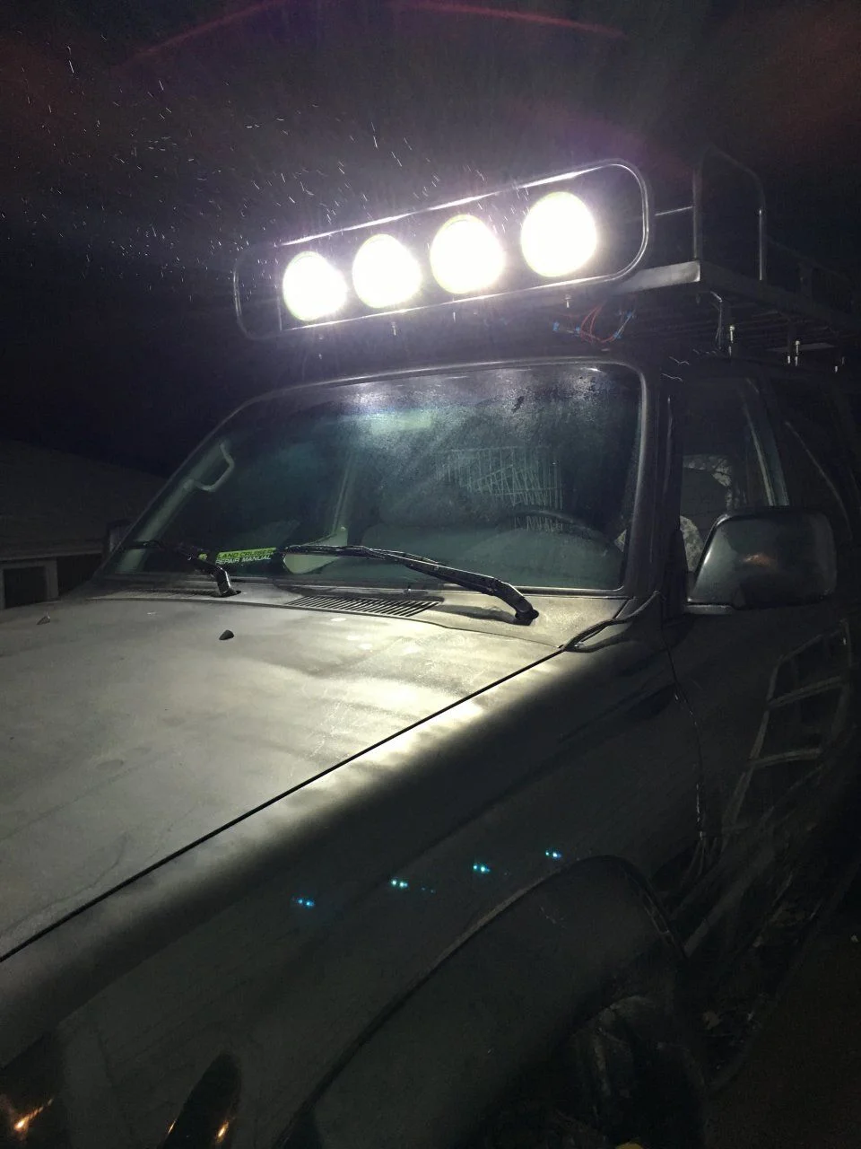

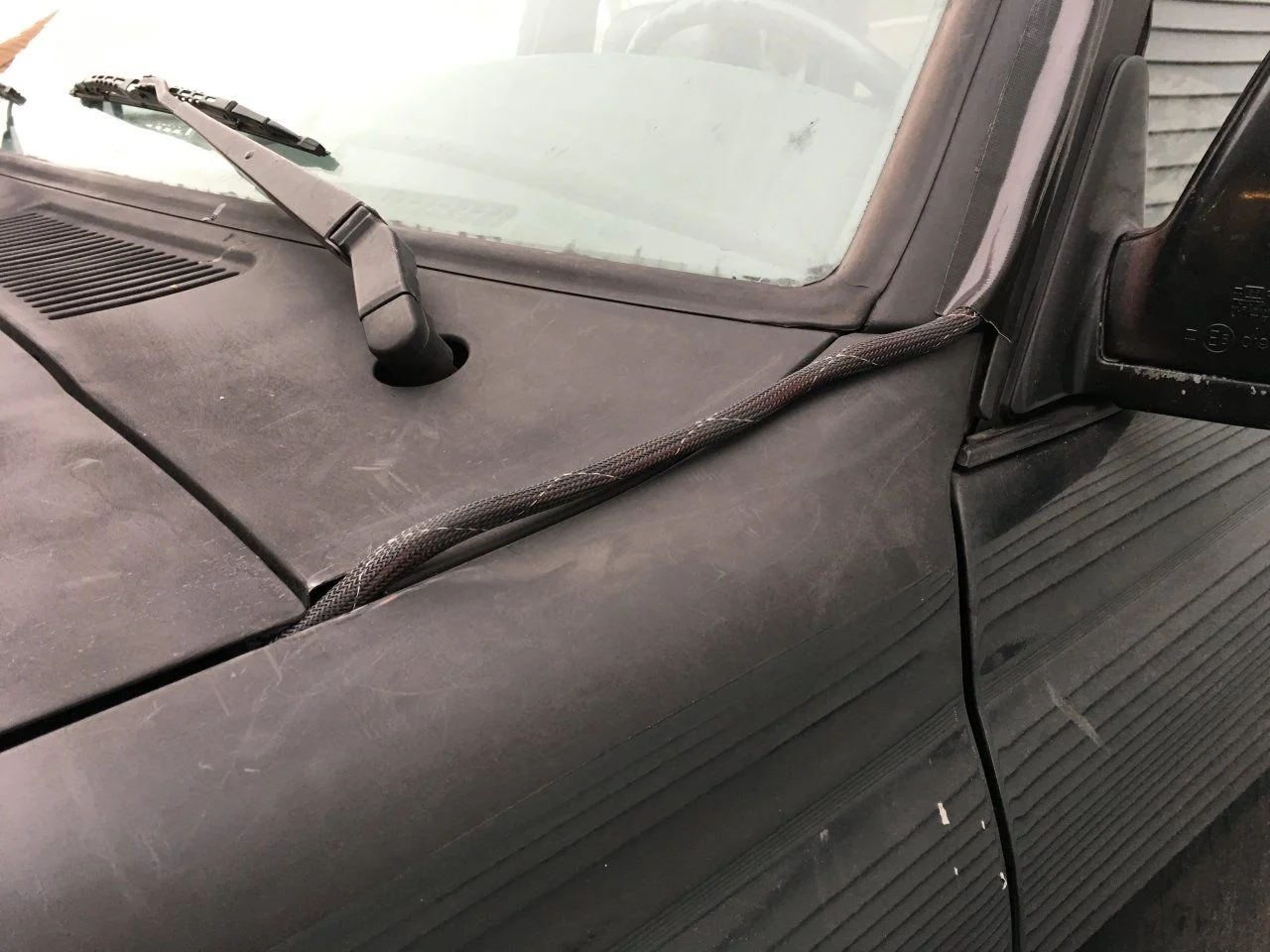

Wired up the forward facing lights. Had to get a little "creative" since I didn't have time to sort out drilling in to the roof. Notched out the valance a little bit and fed the wires in that way.
Big thanks to @george_tlc @solomrus and @NLXTACY for helping me figure out my lights!

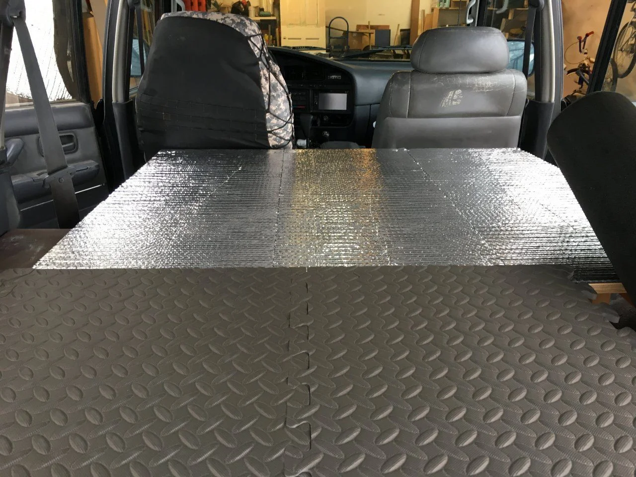

Didn't get a "finished" pic of the sleep platform carpeted. This is it in process. Used reflectix insulation to, in theory, push body heat back at us. Covered by 1/2" HF walk pad stuff. Covered by a $12 rug.
And washed out the fridge/freezer... No pics because, well, it's boring.
What are your impressions on those lights and how's the glare on the hood? I should have grabbed a couple when they were twenty bucks each!
I will tell you tomorrow night. I was blocked in and couldn't back out to test them. No glare but my hood is painted flat black...
Ive heard good things about them...
I was thinking the same thing. I haven't been happy with any lights on the roof. Between glare in the windshield and fog/rain glare I'm very close to removing my roof lights.
