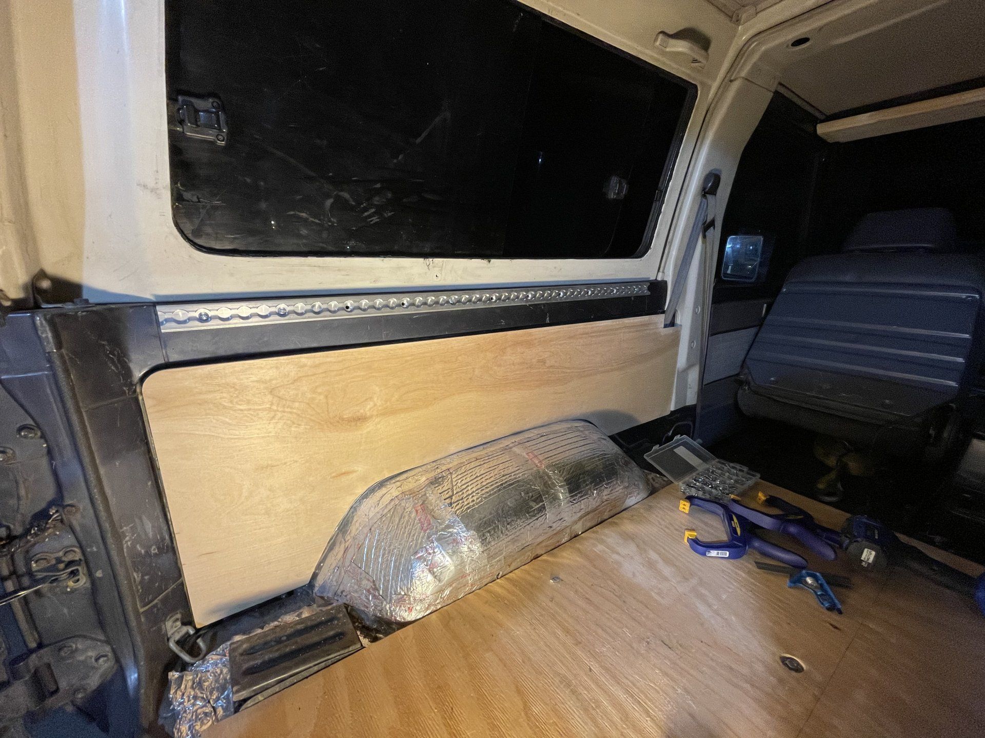

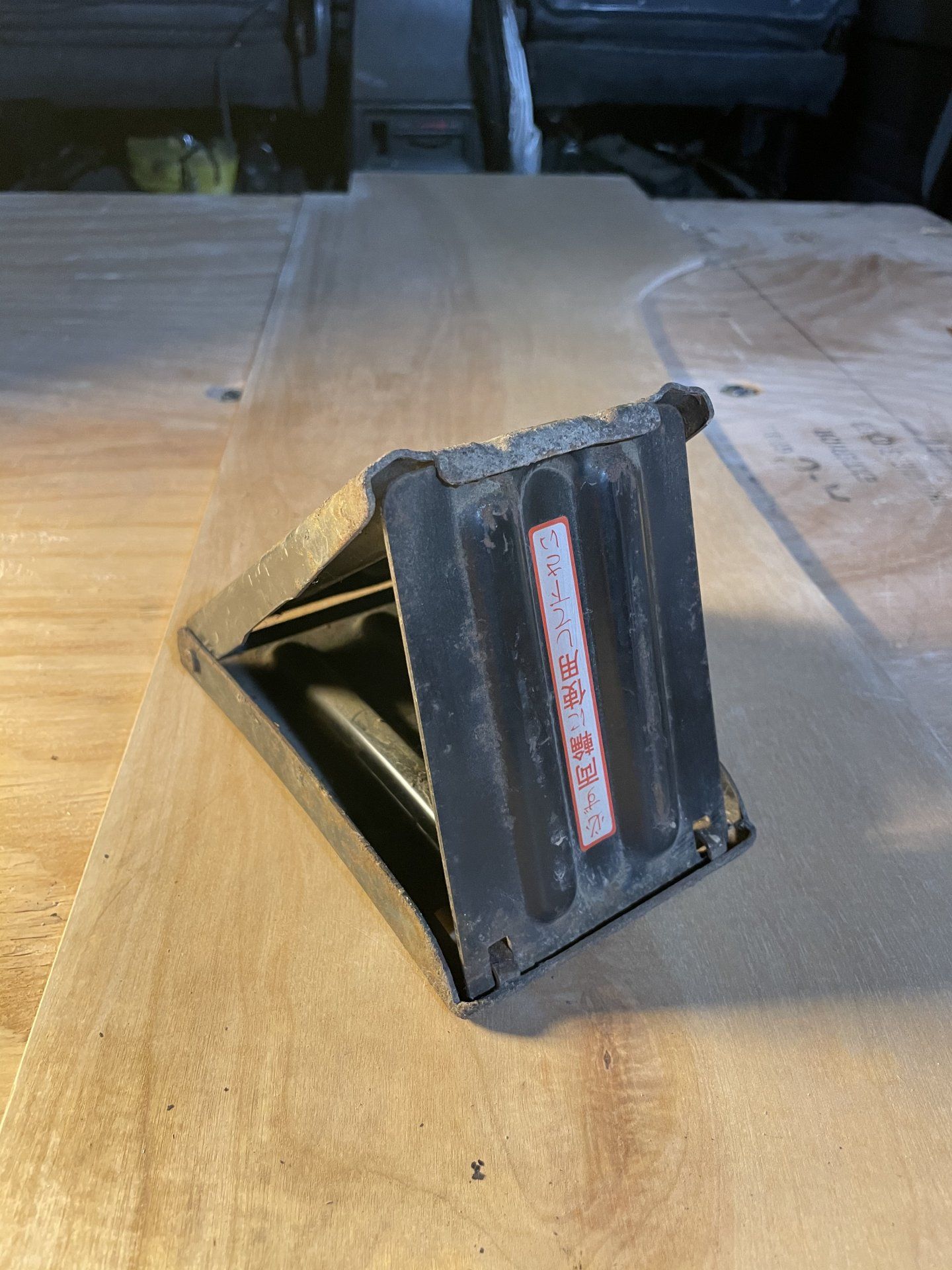

I gave the 74 some much needed attention today. I started with replacing the door trim with ameriseal, what a difference it makes (still not waterproof). Thanks @Bogan! Then I hit the mountain for a couple hours exploring some new offshoots. After getting back I added some L-tracks to the back of the truck and cut out all the interior panel cards and made a map shelf. Also found the original tire chock and a chipped benchmade knife!

What is that aluminum "rail" above your wood access panels? It almost looks like some sort of rail for attaching M-Lok accessories or something. I have been considering making some MOLLE panels that allow attachment of various pouches and kit at different points inside my vehicle, but that rail you have looks like it may be something better.

How did you mount the wood? Also, can I pick your brain? I am looking to mount an ARB twin compressor and trying to figure out the best place for it behind the rear sides or maybe even the larger rear door. Thoughts?

And also, what kind of plywood are you cutting your panel cards from. Looks great! Love the scenery...

That is aircraft cargo track (L-track Tie Down | L track System | Logistic Track & Straps (uscargocontrol.com)). Its great for tie downs and mounting points. Super adjustable. I've put it in both my Tacomas. You have to drill into whatever you are putting it in, but worth the sacrifice .

It’s called an l-track, it’s the same tie down system that are used in aircrafts I believe!

I’m still trying to figure out a permanent solution to mounting the wood panels. I’m looking at using either Zeus Tabs or some generic form of car clips.
As far as the twin compressor goes I’m not completely sure there’s enough room. Ill have to look its dimensions.
I've put 6mm cage nuts in the holes of the metal and then secured my panels with 6mm flush hardware. Super stout. I've got a single ARB mounted inside my panel and a twin would fit as well. Do you guys have less room in the 73's?
