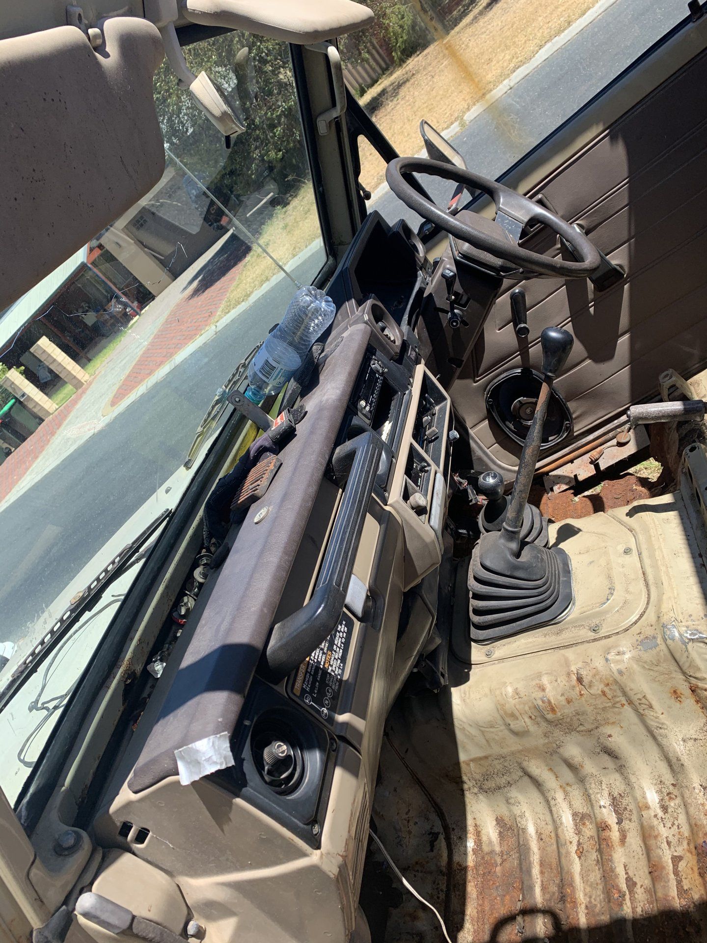

I recently started restoring my dads old 1988 Hj75 ute to its former glory. The body is extremely rusty, and currently doesn’t have a roof on it, but the engine is in surprisingly good condition, (nothing can kill an old 2H engine). Yesterday and today i got to work stripping the interior and cleaning it all up, ready to weld in new floorpans as the current ones are about 90% holes, due to rust. I also managed to fit (with quite the struggle) a drivers seat off an old 79 series mining vehicle from my dads work. I also managed to find a brand new windscreen surround yesterday in my local area, as my current one is fully rusted out, and I have a set of brand new floor pans on the way. My next project is to finish off the roof, as I have been patching up the few rust holes in that, and then chuck it back onto the vehicle. Then, once the floorpans arrive, i am going to cut out the old rust, and have my dads mate who is a professional welder to chuck them in. I will put some more pictures of the seat and roof tomorrow morning.
I cannot say enough good about using a rust converter like corroseal or por15 on rust that you cannot reach to remove or cut out. Before you repair, patch and weld everything you might look to partsouq to see how much new body panels are. IE New Rocker panels are actually fairly inexpensive at $51 for a HJ75. Inner panels are listed at $26, but not available(maybe you can find them elsewhere).
Yeah, i’m currently planning on just going to town with some rust converter on anything i can see and not either replace or weld in new metal. And the body is actually not in too bad of condition, with just two small rust holes on either side of the bonnet, which I think is not worth a whole new set of panels, bjt rather to either repair it myself or get it professionally done when i give it to the painters.
Cheers for the advice!

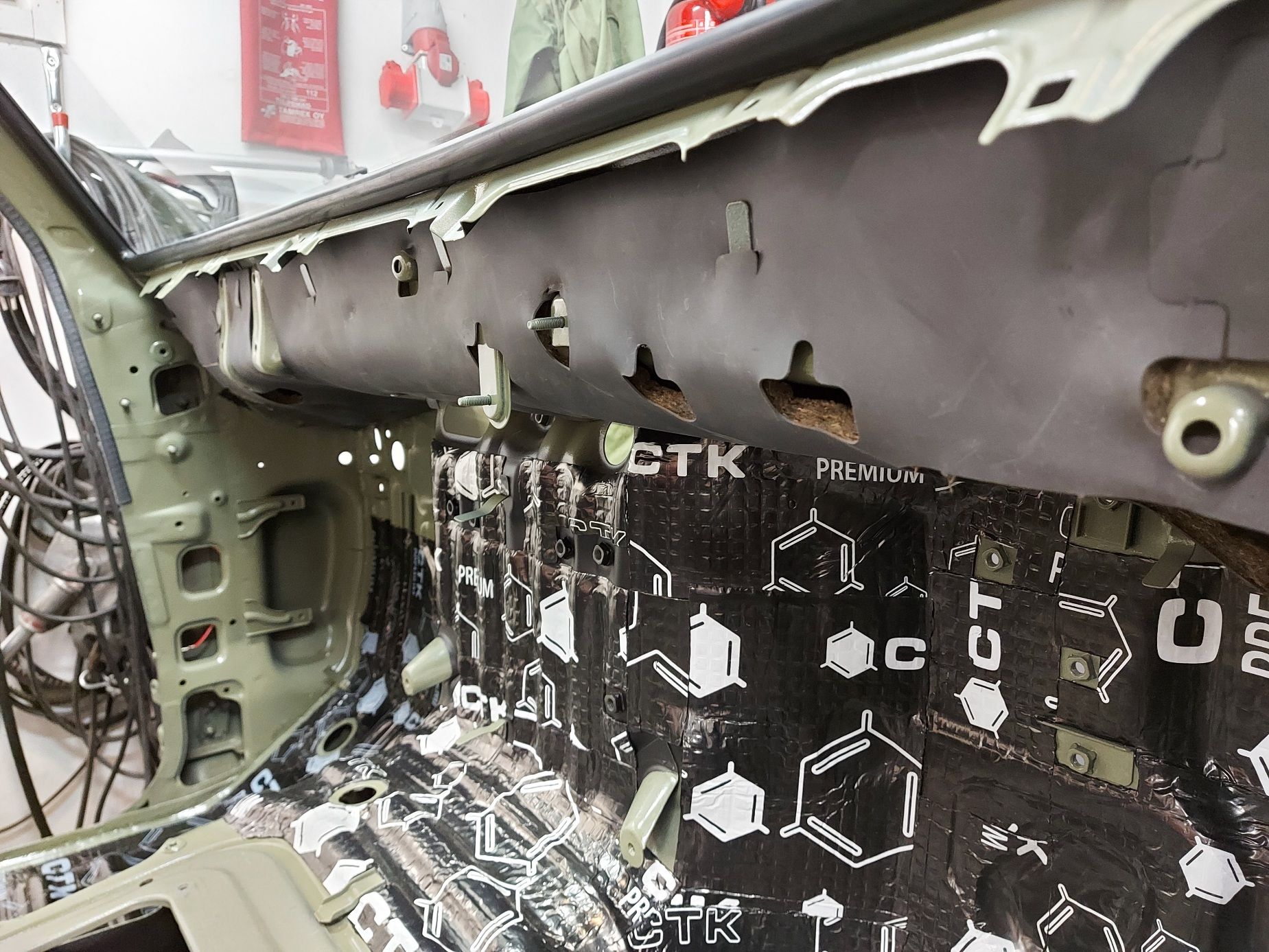

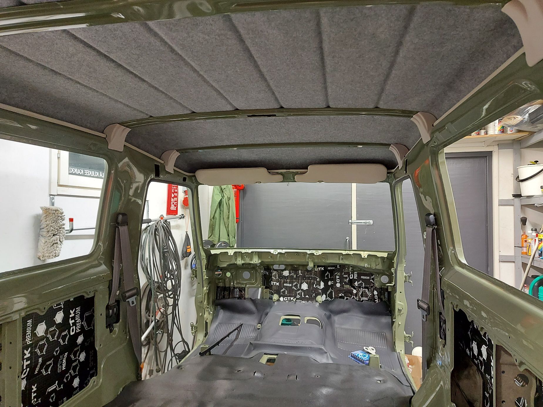

Finally had a chance to finish the sound insulation on the walls and ceiling of the troopy. Since the metal was clean and freshly painted it wasn't that challenging... Made a huge difference. Once the floor is done im sure its going to be real quiet. Also got started on the closed cell foam panels.
Similar project here. In front floor, installation was slower due to complex shapes of the surface. The echo is gone 👍 Doors are still under deadening.
You and @MES inspiring me to get off my butt and finish my soundproofing! Beautiful rig man. Question for you... what did you use for new roofliner? Is that the OEM panels?
It's Superflex automotive carpet. I bought it here in Finland, but similar to this one I think:
Good stuff for this purpose. Very stretchy and easy to attach with spray glue.
Edit: That underdash deadening mat is OEM
