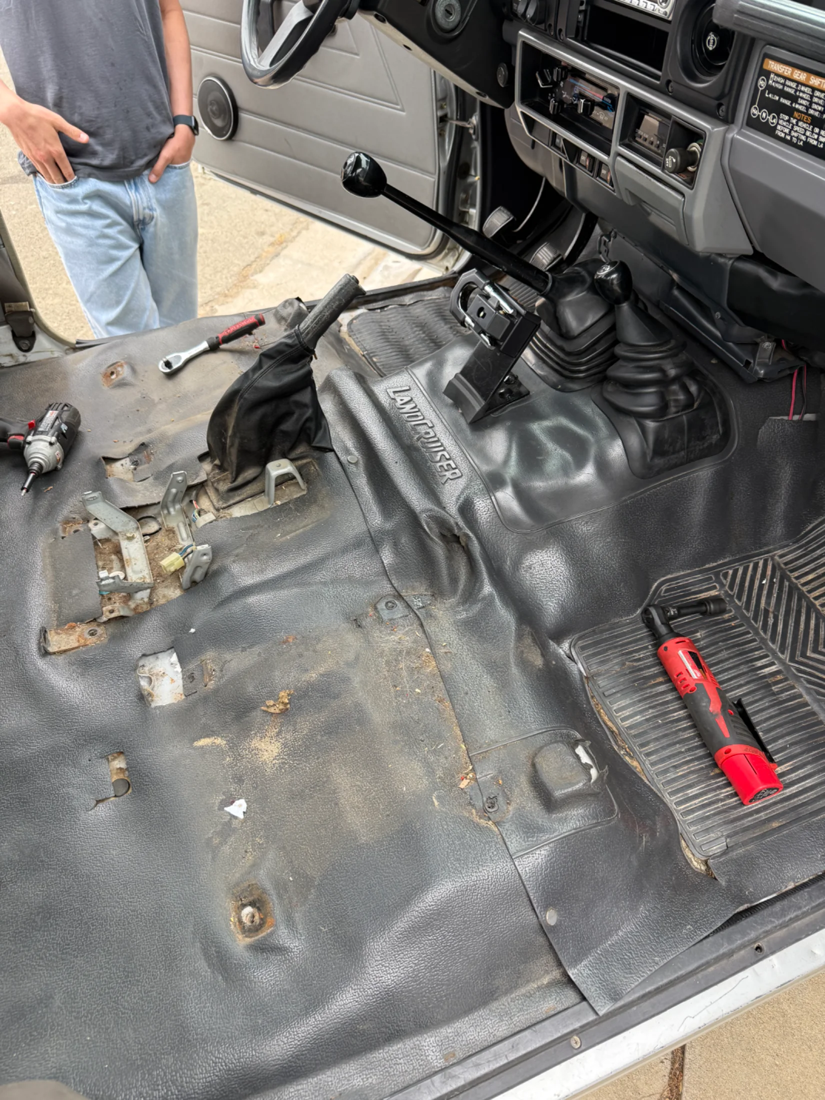

Installed my used I got carpet to replace my torn rubber / plastic floors. Much more refined now😂

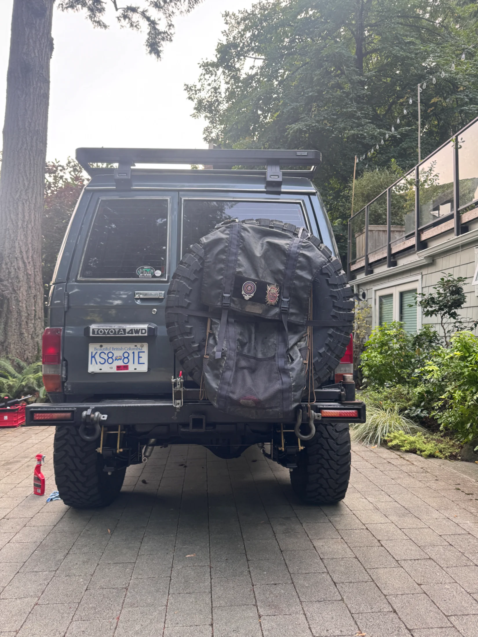

Refreshed the suspension on the BJ74 over the last couple days,
Terrain Tamer parabolic leafs (thanks George and Roarke!),
5.8” shackles and U-bolt flip kits from MAF,
& cheap and longer BDS shocks for now.
I was able to clean up and reuse the caster wedges.
The ride is seriously transformed, the 18 year old OME setup had crumbled and cracked bushings and was on its last legs. This lift brought the rear end up nearly 4 inches and feels unreal.
View attachment 3970976View attachment 3970977
View attachment 3970978View attachment 3970979
What’s your measurement from center of hub to wheel well?

your TT's are sitting 15mm higher than my ome, youre unloaded and i have a 120l of fuel and gear and add a leafs though (same shackles)...
