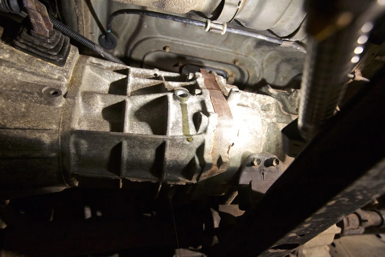

I also flushed the transmission fluid because the trans was making a racket in every gear. The flush didn't help, so I may be rebuilding that as well...Anyone have experience with a noisy R150f?

Regarding your transmission noise, is it possible it's coming from the flywheel? If it's still the old dual mass, it could be seeing it's last days. I've been driving a Hilux with 2LT-II and R150F with a flywheel falling apart. It does weird stuff and makes weird noises to say the least. It's a known issue with these flywheels. Common fix is going to the LN106 solid mass flywheel. Course you won't have to worry about that with the VW motor?
I hadn't thought of the flywheel, I'm sure it is still original. What sorts of sounds would one expect? My transmission makes a grinding noise when in gear and moving; all gears make noise, but 4th and 5th make the most. The adapter kit comes with a V6 flywheel that has been machined to bolt to the VW engine, so there is no problem there.
Yeah, its not so much of a grinding noise. More of a broken metal (spring pieces) bouncing around in the flywheel noise. A tinny noise I guess. Was just an idea, but sounds like your issue is more likely bearing related....

Could also be seriously shot synchros. I have heard them cause some pretty terrible noise. How is the transition between gears. Smooth or a little slow and notchy?

I'm beginning to think that a rebuild is probably the answer. I have heard that the R150f can be a noisy transmission, but I don't think that mine is a normal kind of noisy. The gear change can definitely be a bit notchy when cold, and sometimes it is difficult to get into first. At least the trans should be easy to get to pretty soon ;)

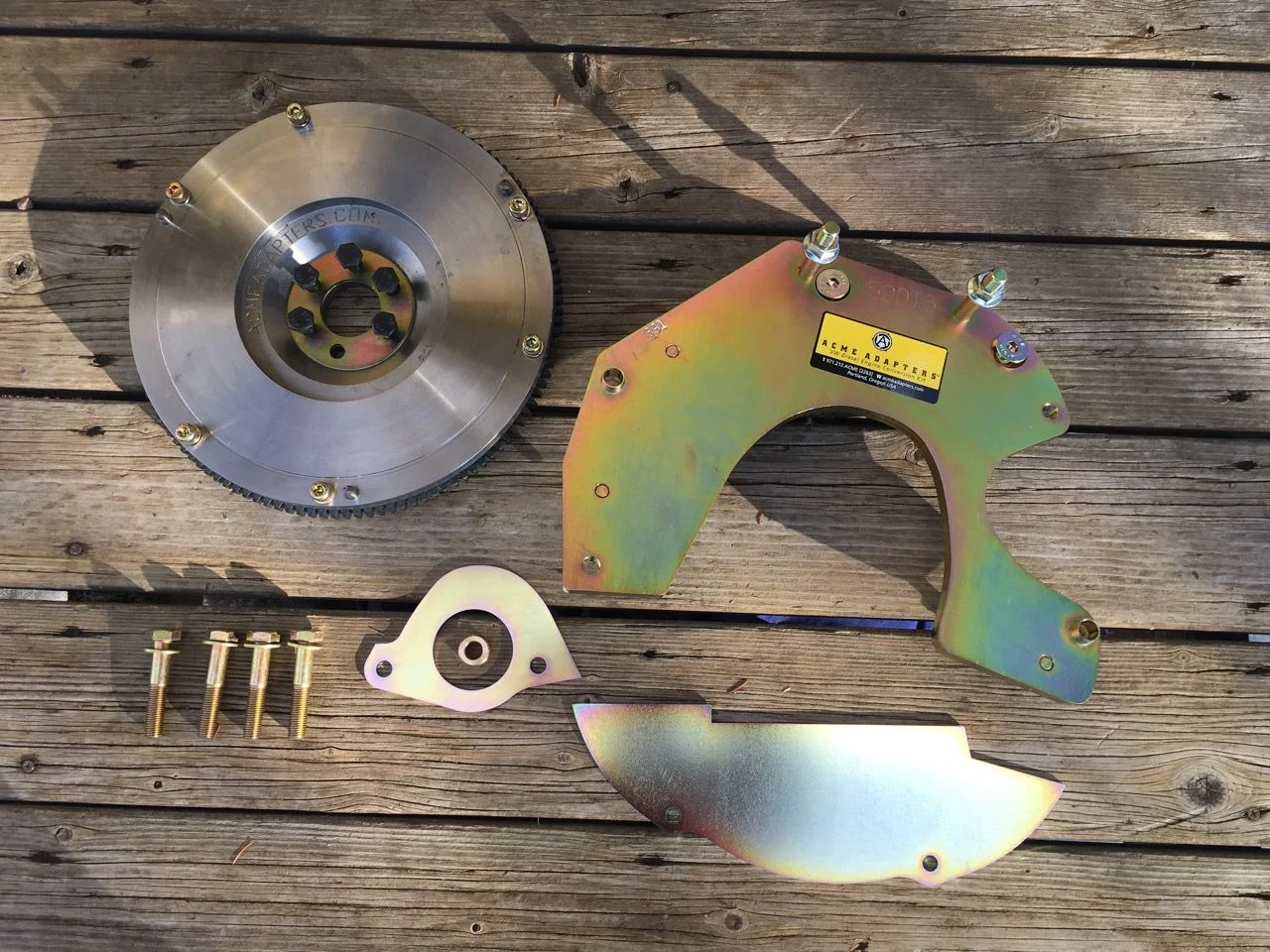

Big day! The adapter kit arrived from ACME Adapters, and it looks pretty nice! A V6 bell housing is on the way, so I should be able to test fit the engine/adapter/transmission interface pretty soon.

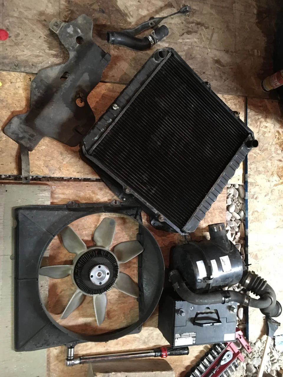

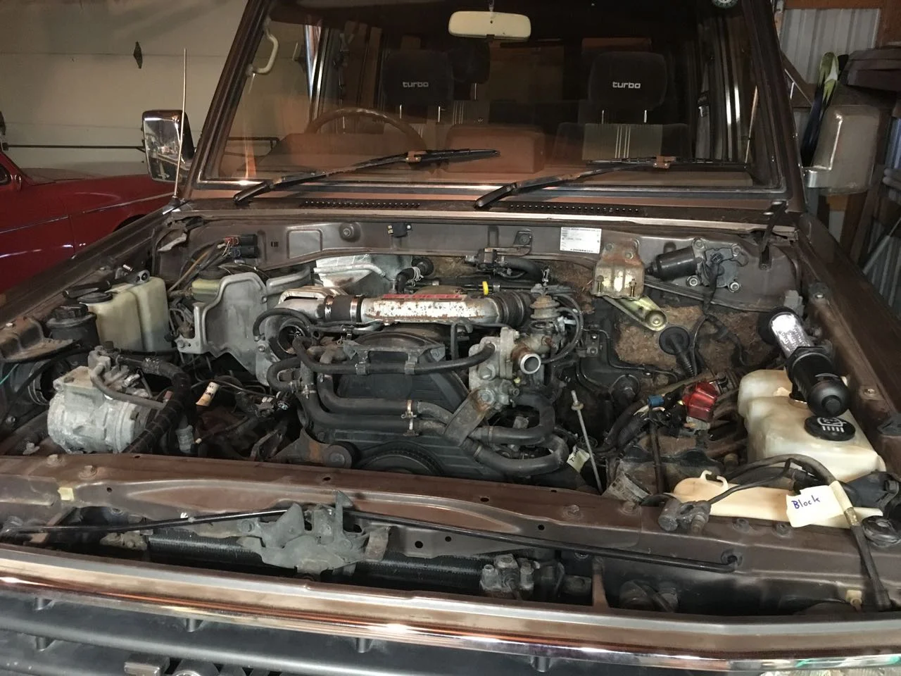

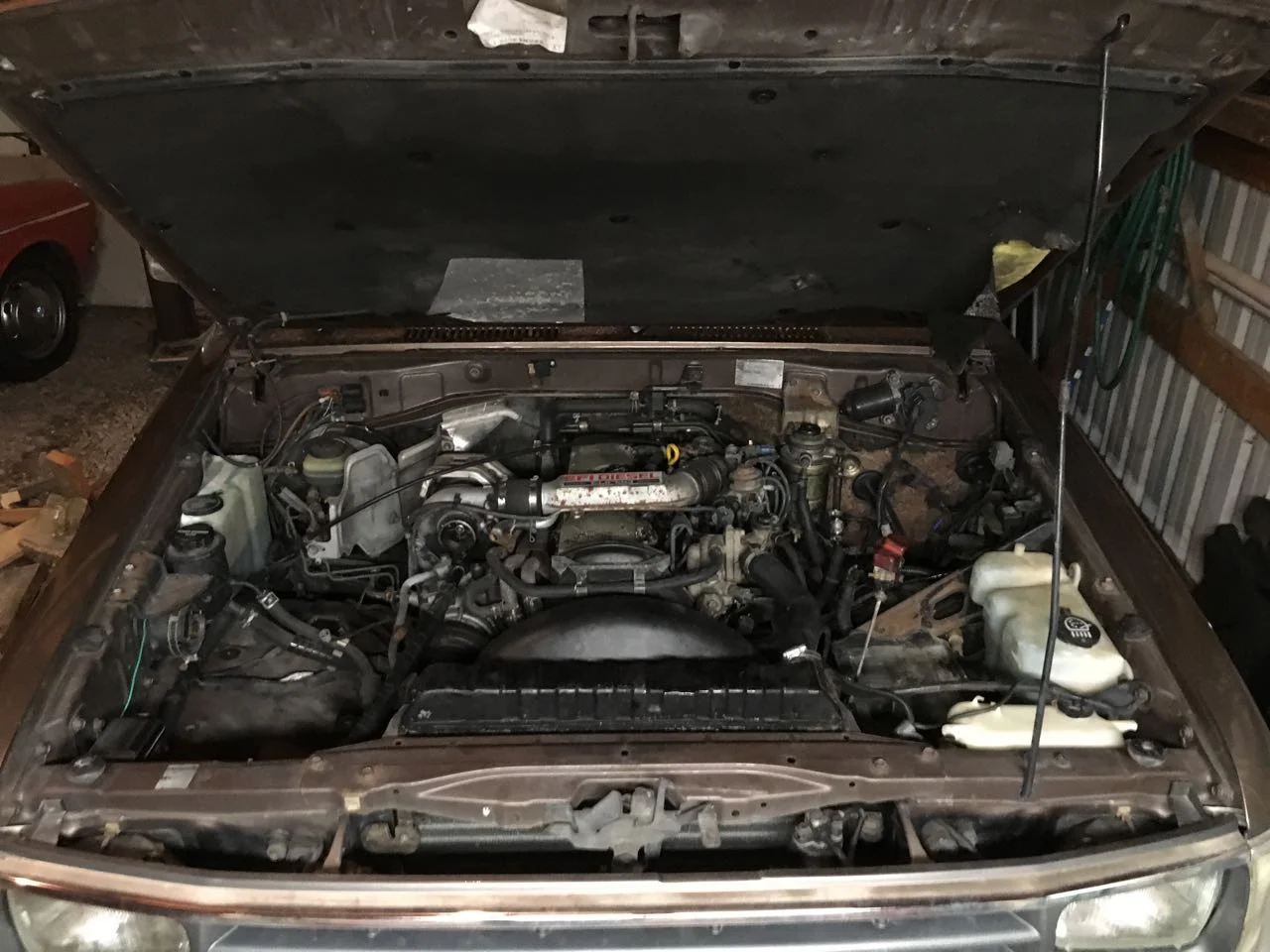

During the past few days I have finally gotten to start tearing into this project. Day one involved removing the air cleaner and turbo intake pipe, battery, radiator and hoses, and unplugging the majority of the engine wiring.
Got the hood off today and struggled with bell housing bolts. Also disconnected the power steering lines and the exhaust.
I'm trying to decide if I should remove the engine/trans as one unit or just pull the engine; any thoughts from those that have pulled one before? It looks like the transmission might have to be supported if I pull just the engine.

I just pulled my LJ78 engine without the transmission, and I did not find it that hard. That said, I did have the engine fairly stripped down, so it was pretty easy to get at everything.
First I removed the bolts holding the flex plate to the torque converter (doesn't apply to you.) I supported the transmission with a jack and jack stand with some blocks. I removed the starter, and all the bell housing support brackets and bolts except for the outer most bolt on each side of the bell housing. Arguably the easiest ones to get at. Then I supported the engine with an engine lift. I removed those last two bolts in the bell housing. Then removed the two small bolt/nuts on each engine mount. Then pulled the engine forward a bit to disconnect the motor from the bell housing and torque converter. Finally lifted it out. With the lift I had the motor cleared everything just fine without having to lower the front of the vehicle. I did all this on my own with no assistance.
I did help a friend pull an LJ78 engine and auto trans with transfer case. He had the whole front of the truck stripped down though. I'd say it was way more work. But if you have to remove the transmission anyhow....
In my case, I removed the power steering pump from the bracket so that I would not have to disconnect the lines. I also did remove the radiator to give some more space. I had to unbolt the auto trans cooler lines from the side of the block too. And of course all wiring, coolant, exhaust etc.
Haha, just looking back at your photos I laughed at how pathetic the factory cooling fan on these engines is. And people wonder why they overheat.....
For those living with the 2LTE, take note, a bigger fan and a viscous hub service are two of the best things you can do to keep these things cool. Throw in a Tridon high flow thermostat too.
