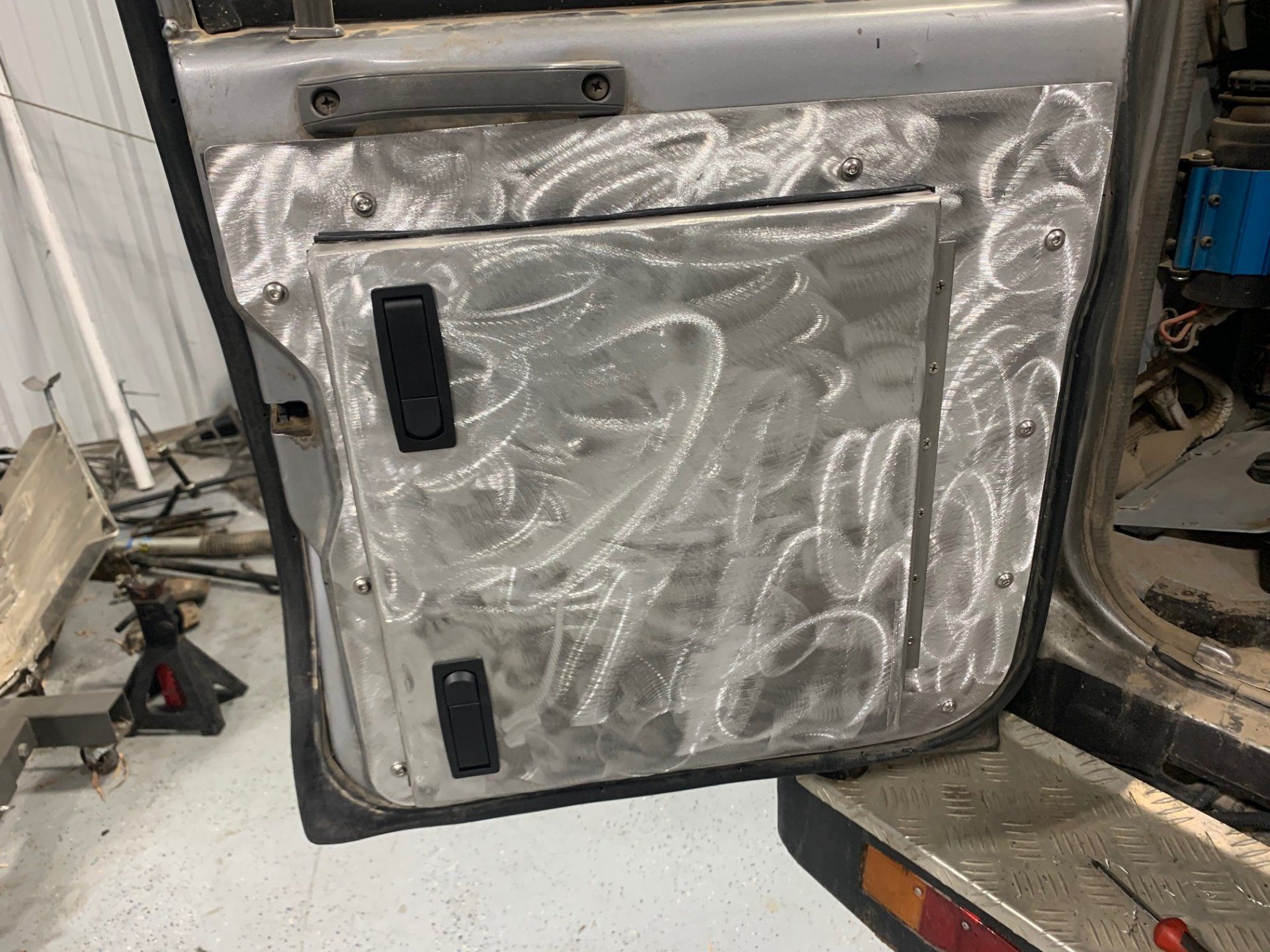

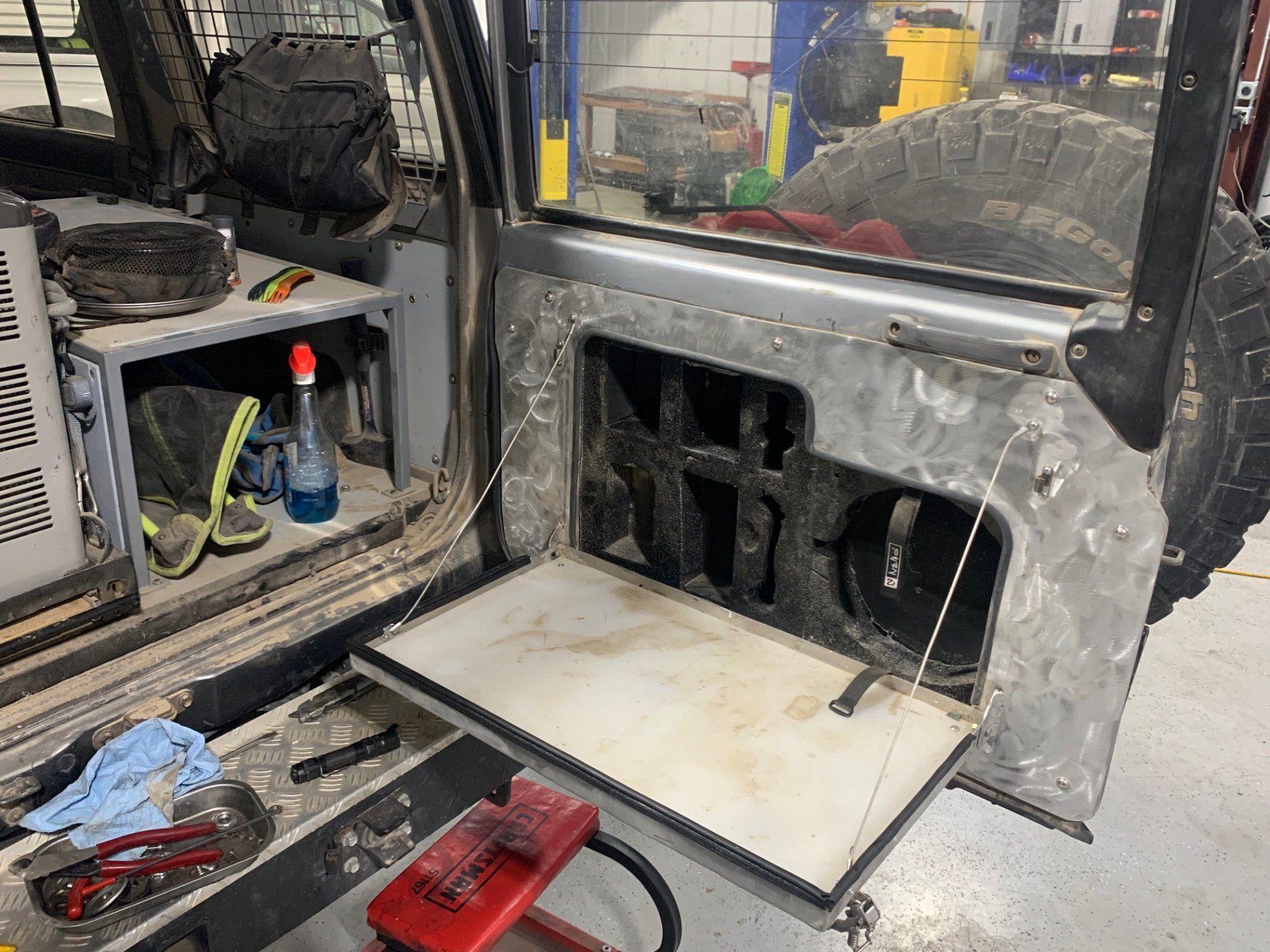

@2fpower and @saltycoconuts here is how I did my panel replacements. For inside, I made them out of 14 gauge steel, and I mounted the dual arb compressor to it. For the rear doors, I made them out of aluminum, and cut out the inner guts and used that for storage. I used the holes that the clips went in, and welded these weld nuts that I got from Mcmaster. You could try nut rivets, but I found that the vibaration works those loose over time, I think something welded works best.
You could fit the compressor inside either of the doors, there is enough depth there, the small one would be best. Although there is not much structural members inside the doors to mount it to, its pretty heavy and vibrates quite a bit when running. You'd have to build some kind of internal bracing, do-able. Or you could make something like I did, with an external panel and mount it to the inside of the door so it tucks in the panel when closed.
Where I mounted mine, made sense to me, as its dead space next to the fridge, and is accessible with just the small door open.
Well done... you really got my gears cranking on how to implement something in my doors.
