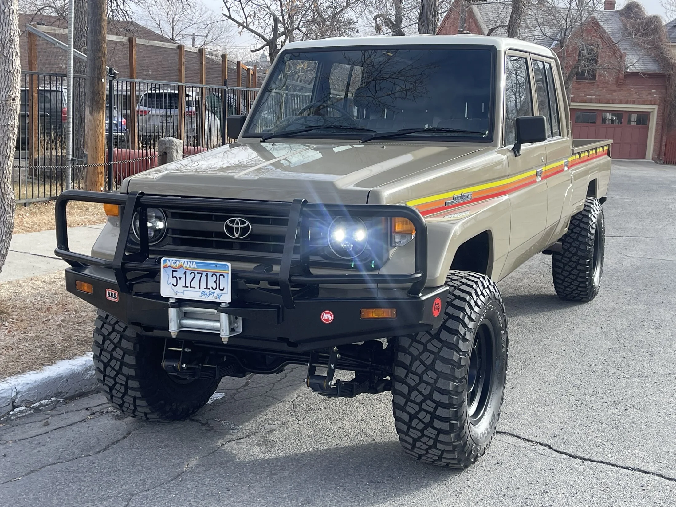

4 door pickups weren't made until 2012. The only 4 door pickups around the US are:
- grey market
- custom builds from imported bodies, maybe on 80 series chassis (my personal dream build)
- custom South African builds from back in the day
- custom builds from Japanese fire trucks

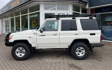

4-door HZJ76 (1HZ non-turbo diesel) introduced in 2007, so the first ones will be legal to import in 2032. Available in LHD, some will have a/c. The 76 four door wagon was (and is?) also made with the 1GR-FE V-6 petrol motor (same as some 4Runner/FJ Cruiser/Tacoma) starting in 2009, so not importable before 2034. Here's the 76 body style--this one's a 2020 GRJ76 currently for sale in Germany:

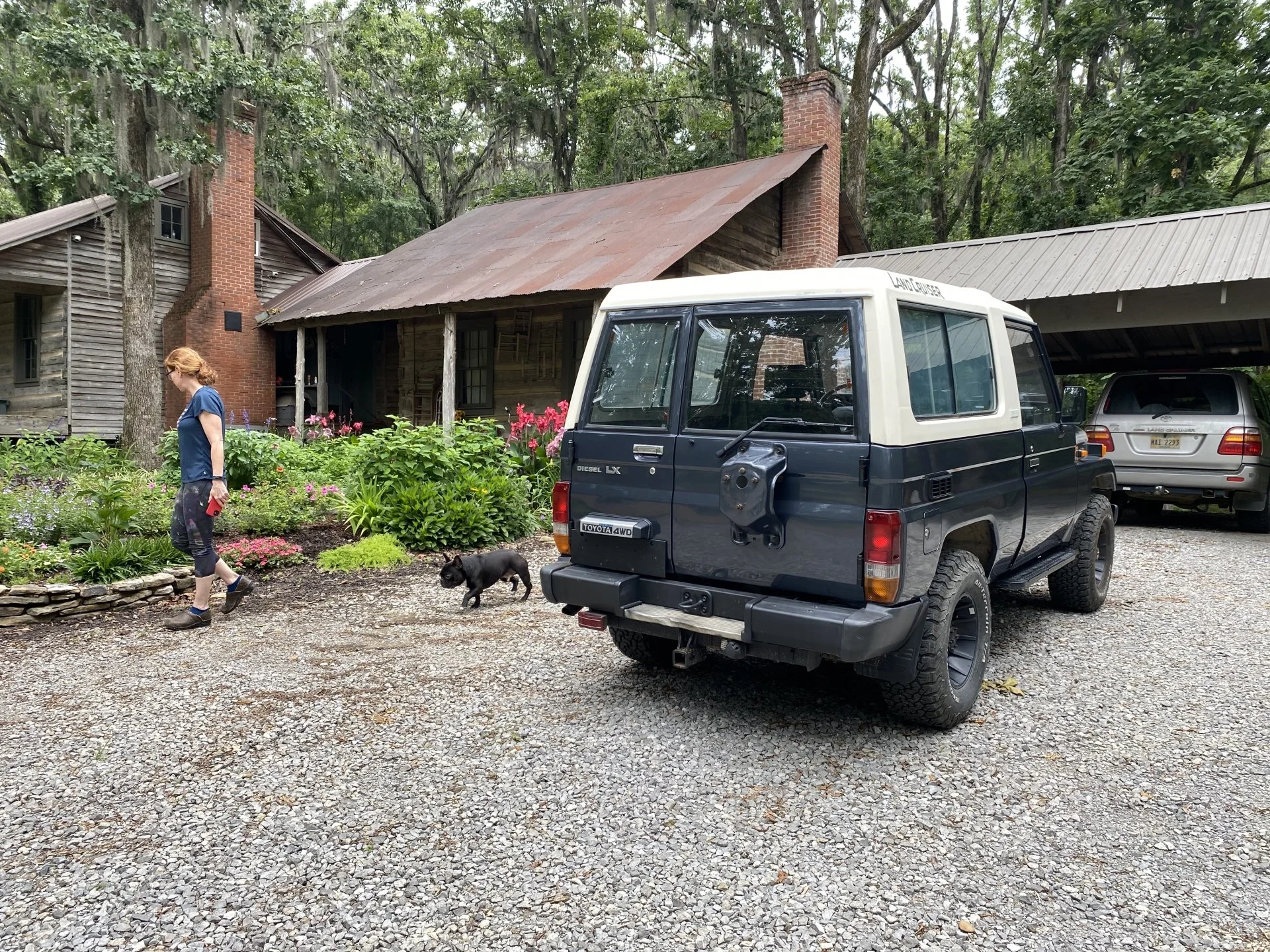

What do you plan to do with the Cruiser (daily driver, weekend toy, kid hauler etc.)?
@Fishbulb …. “Been thinking about selling my 73 lately.”
Any particular reason?
