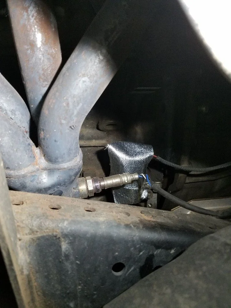

Also found that when I'm pushing the engine very hard up a big mountain pass with a trailer that the heat from the headers kills the Toyota oil pressure sensor. Need to put heat shielding around it.

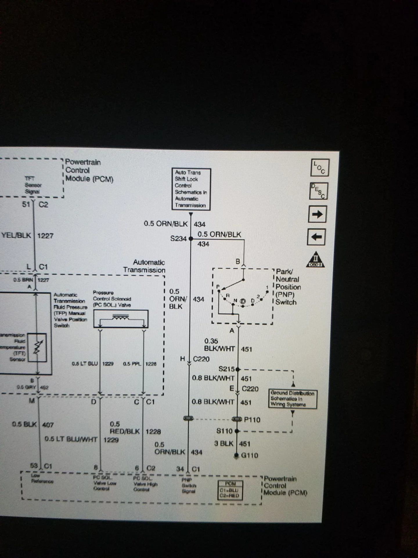

I tried doing a crank position relearn but it didnt work. This needs to be done when the ecu is replaced. I also had a p0706 transmission range code. This code did not show with my torque phone app. It only showed with a higher end scanner. My neutral safety switch has 2 plugs. 1 is 4 pin, the other is 7. I left the 7 pin disconnected because I thought it was necessary. However that's not true. On the 7 pin, the ground must be connected. However this diagram shows pin 34 also going to the 7 pin. But it actually goes to the 4 pin connector.
With that done the code was gone. I was able to successfully do the crank relearn. Now my torque converter locks up. Interested to see mpg difference if any.
During long heavy loads the header heat killed the oil pressure sender. So I wrapped it.

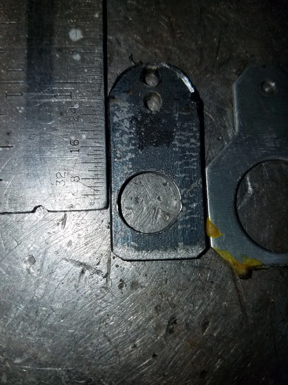

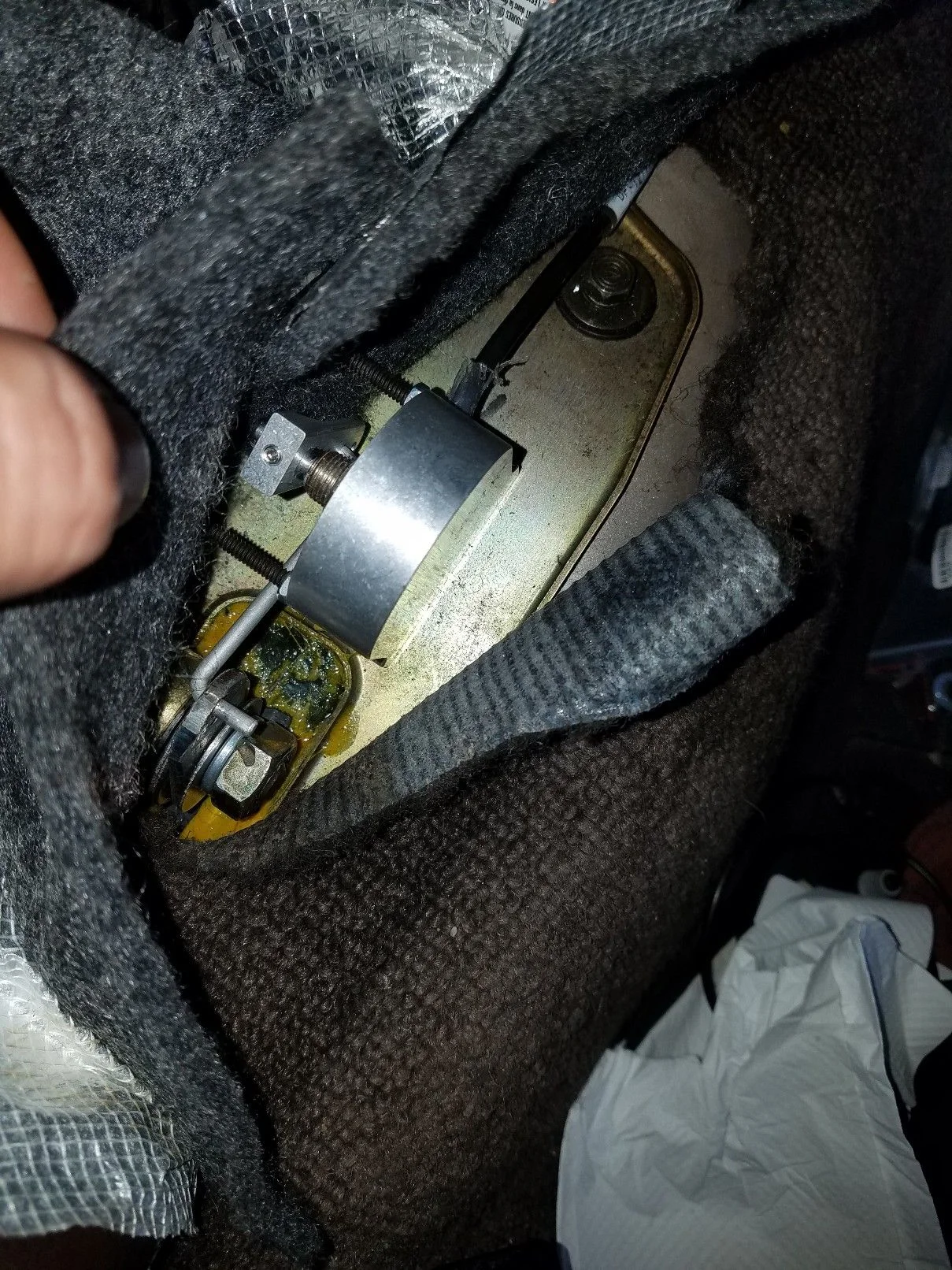

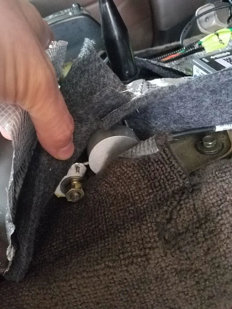

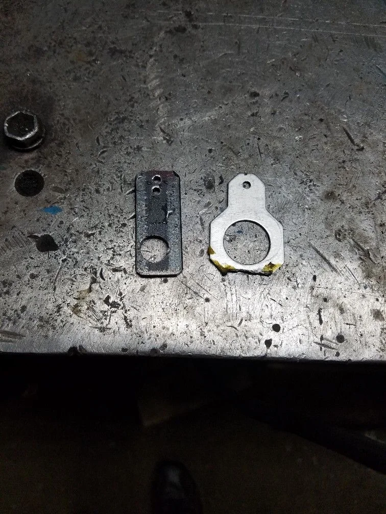

Been having trouble with my dash shift indicator lights not being totally accurate. So I made a new indicator arm. Works great now.

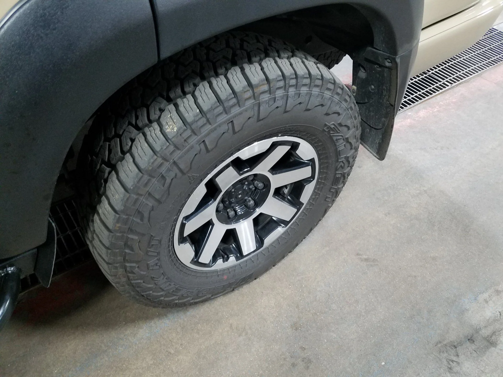

Got some new tires. I couldn't pass up the price. The all terrain tead design looks like it will hopefully do good in snow and mild trails. They are louder than my old cooper tires that were basically a all season.

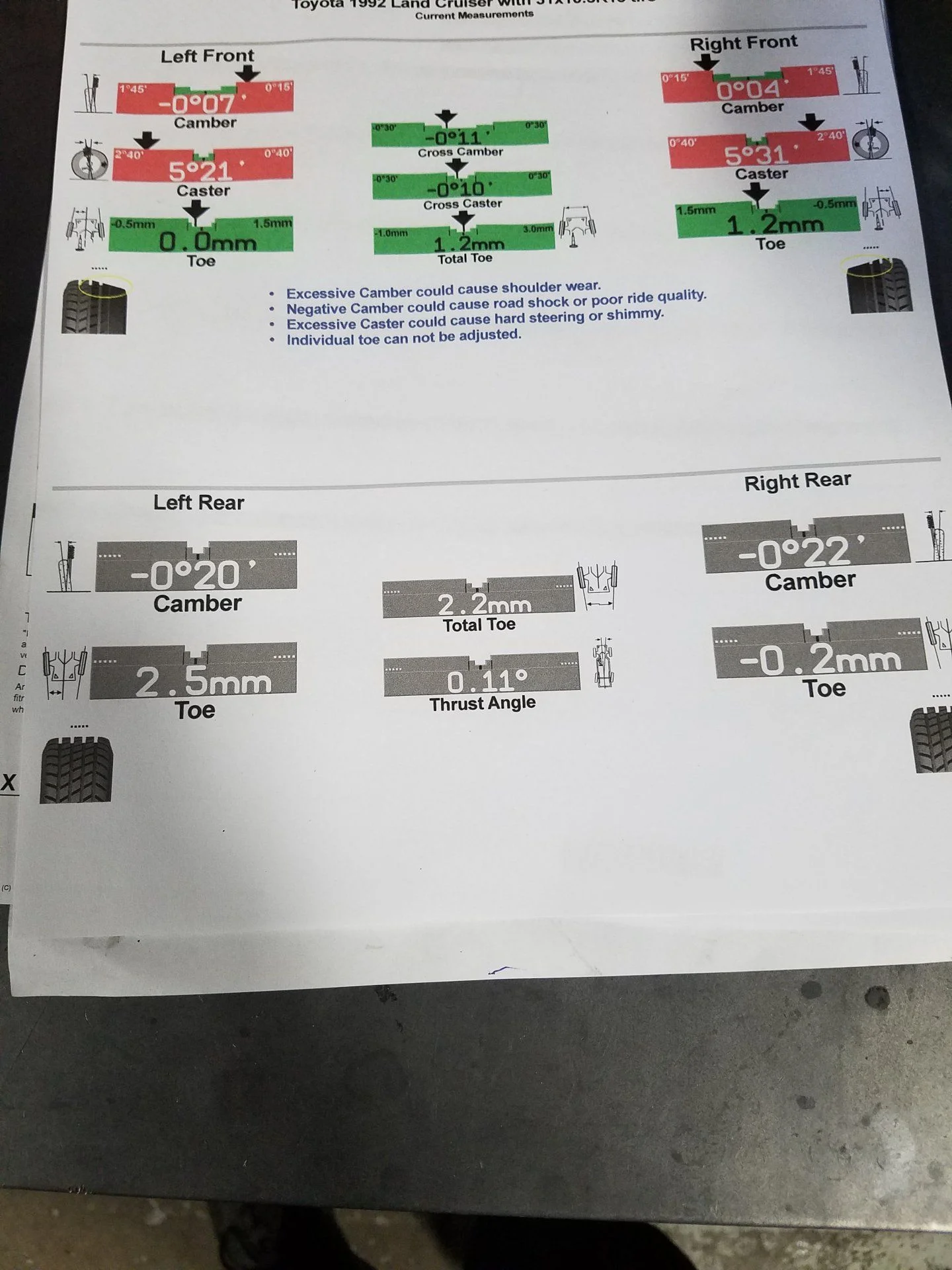

I also did an alignment. The toe was off a little and causing tire wear. Looks like my caster is higher than I thought with the dobinsons bushings. This is good in case I lift it more. I really want to avoid more lift if I can just because it is so nice to drive around town as is. Also parking garages may be a no go with more lift. With the high caster it drives really nice at freeway speeds.

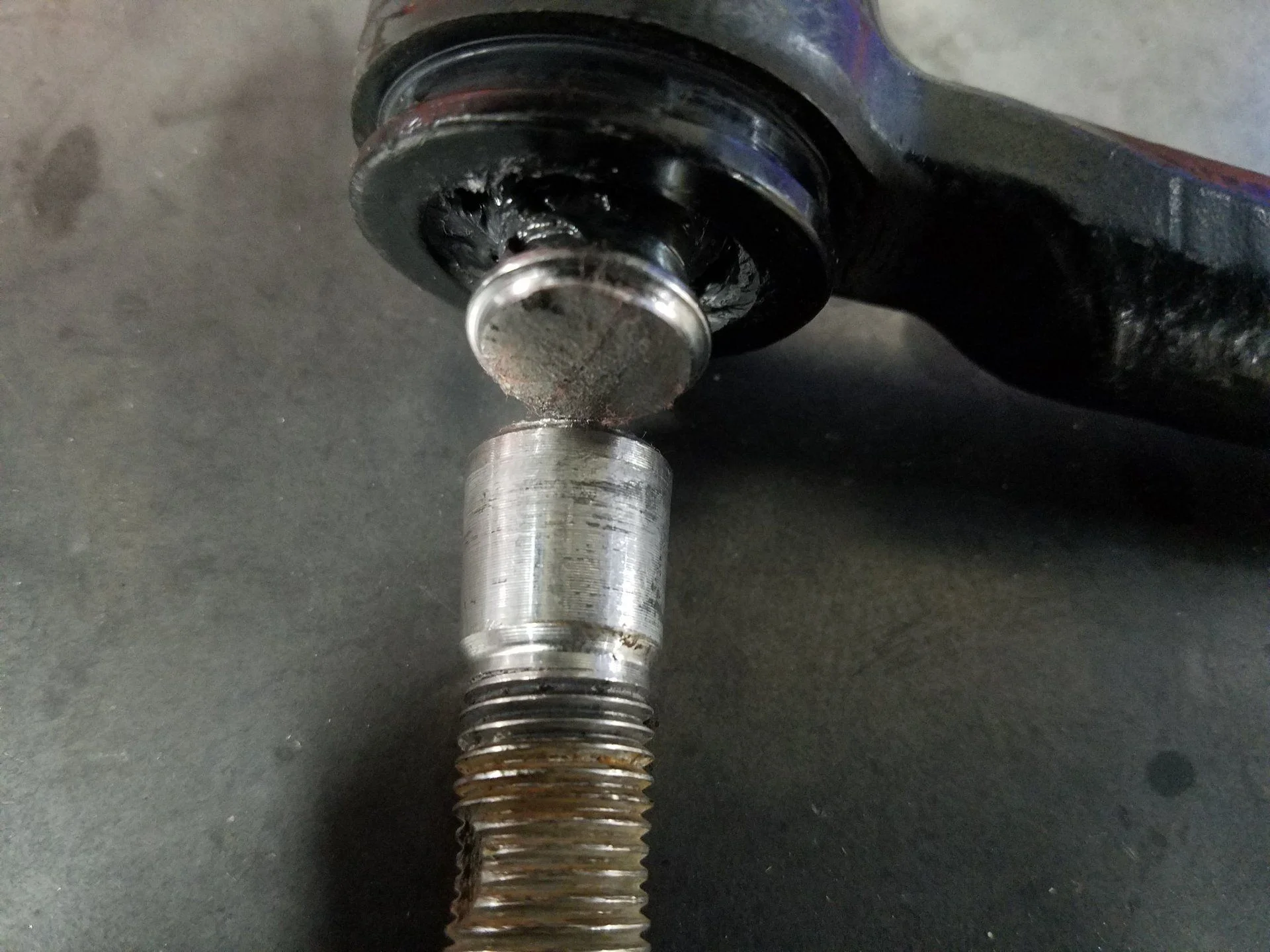

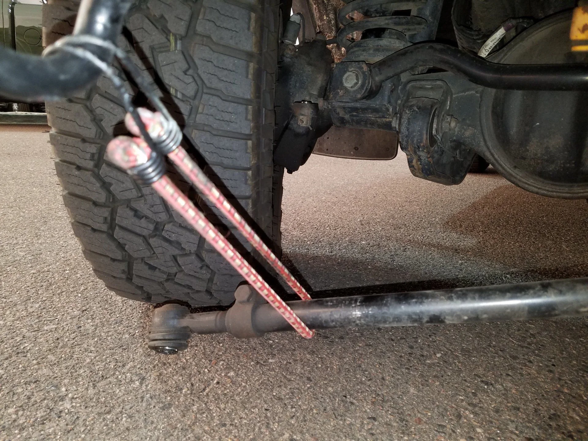

My drag link end snapped. Thankfully I was in a parking lot. Ordered new toyota ones.

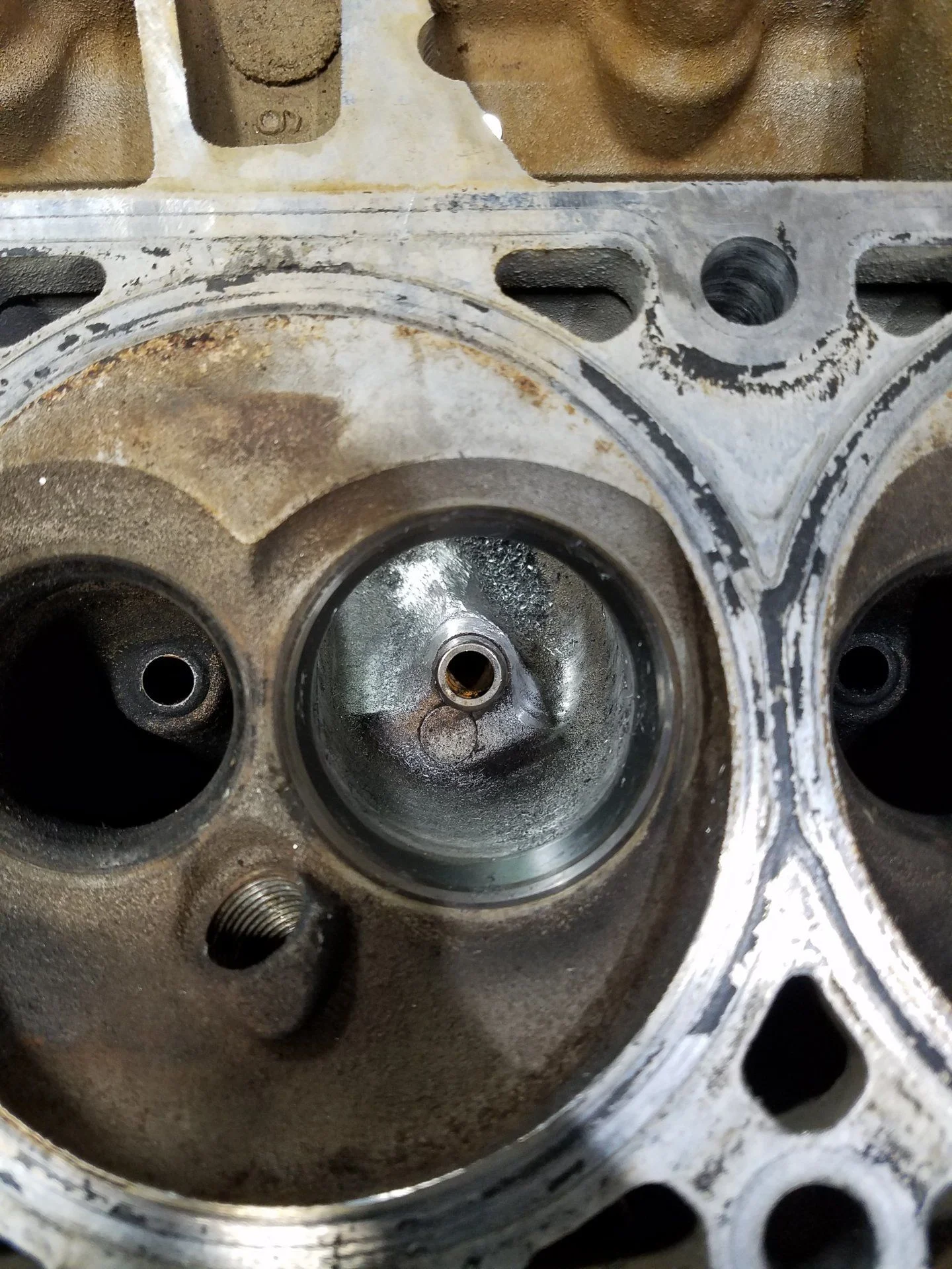

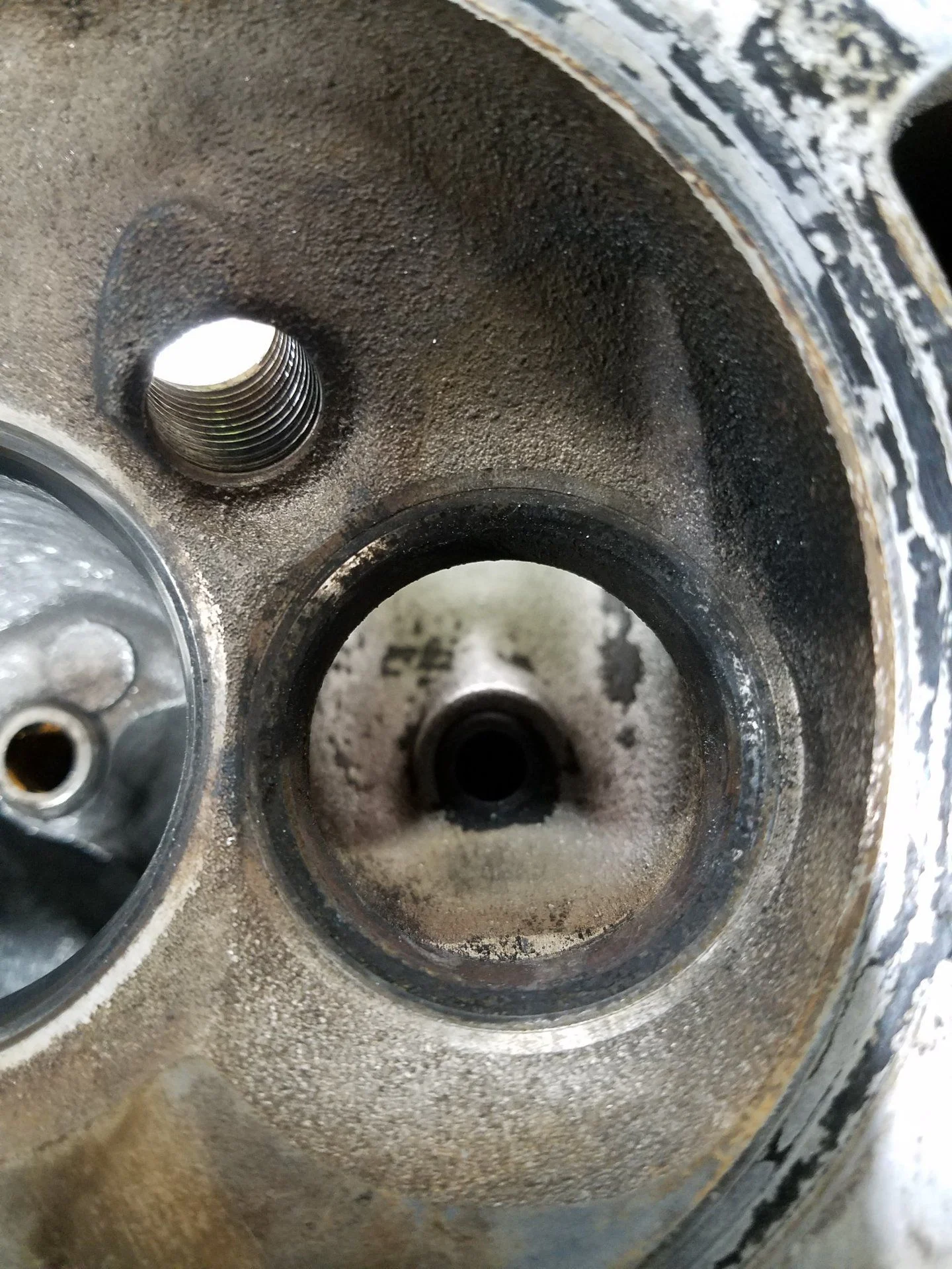

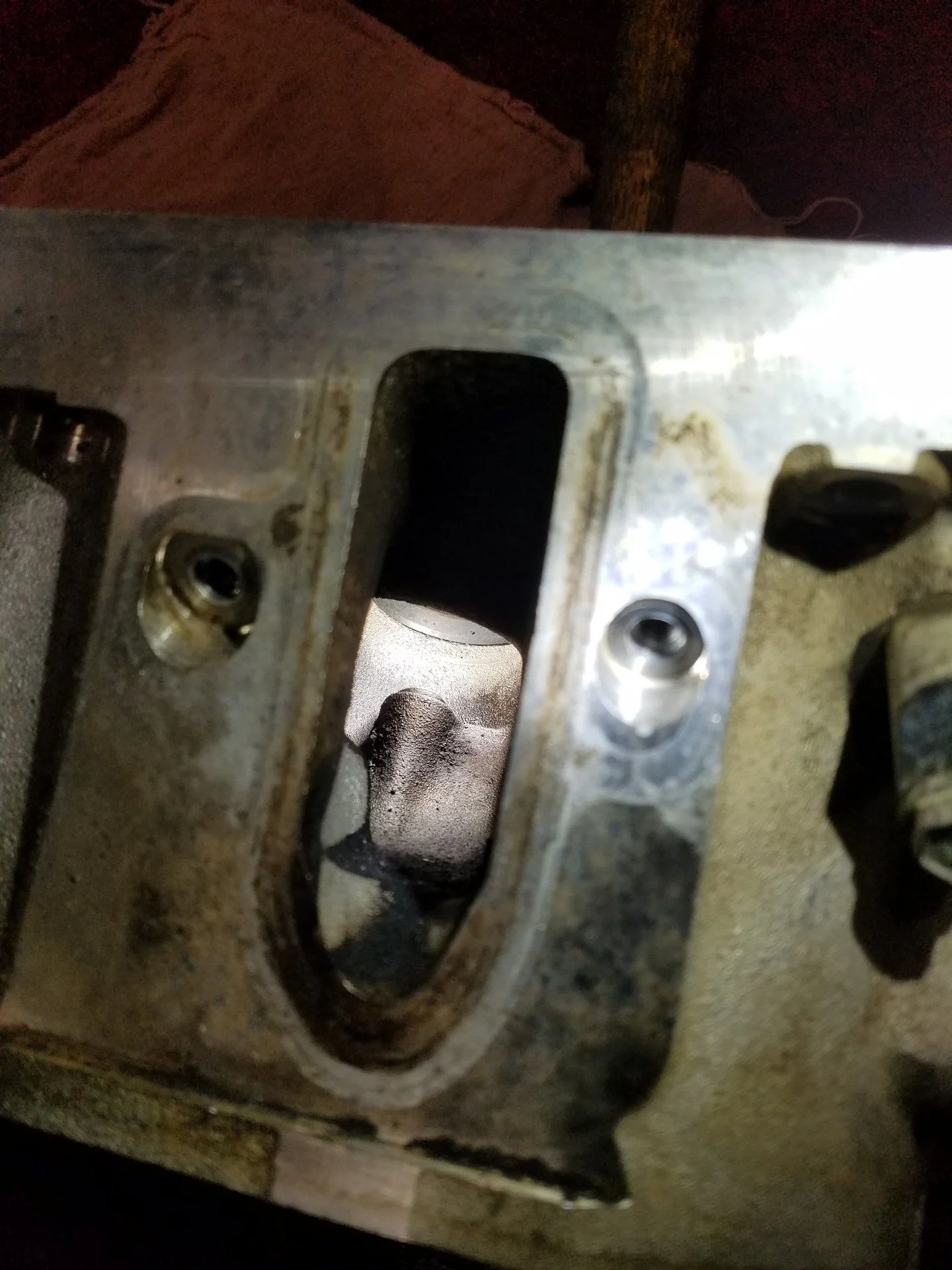

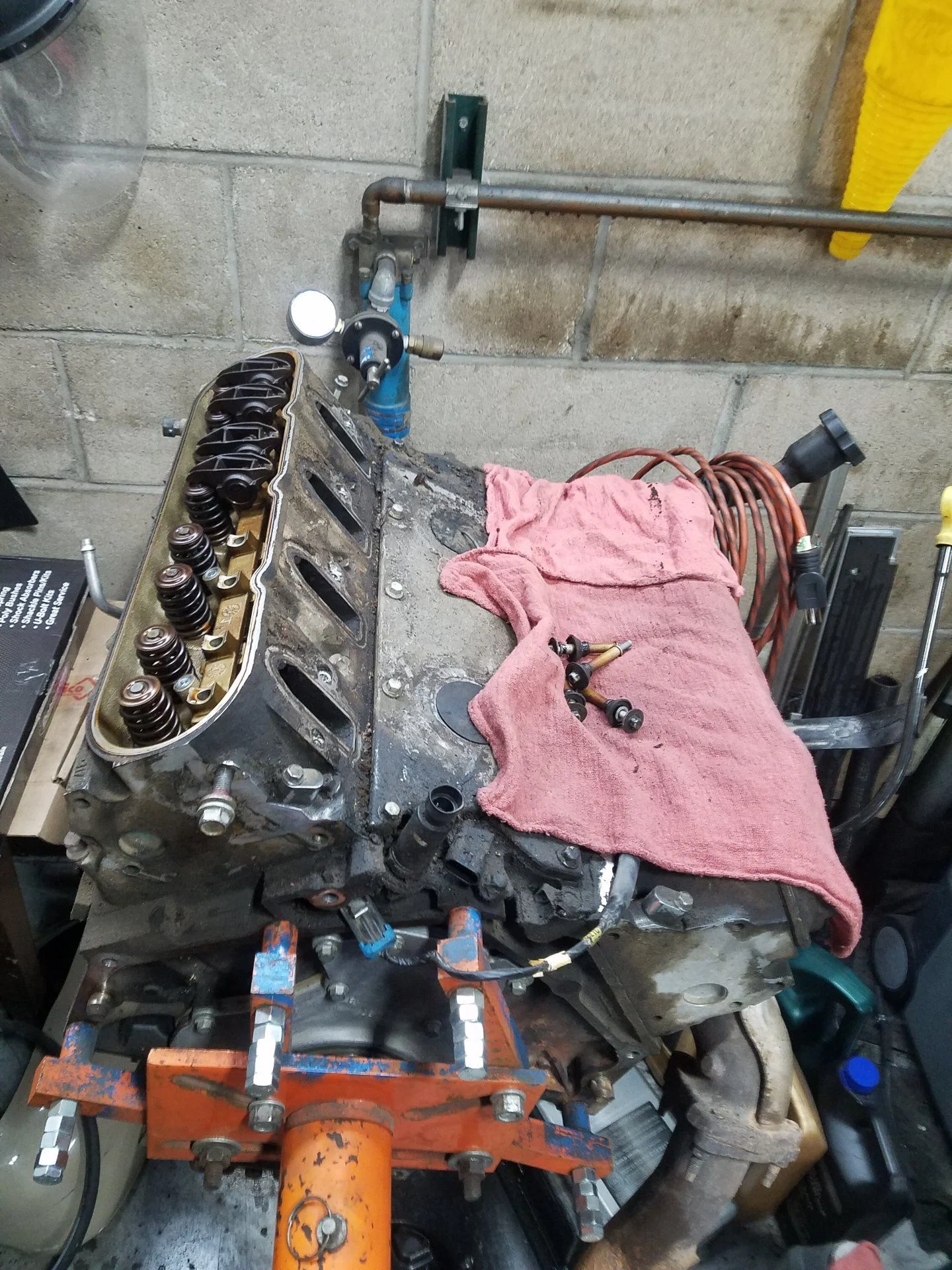

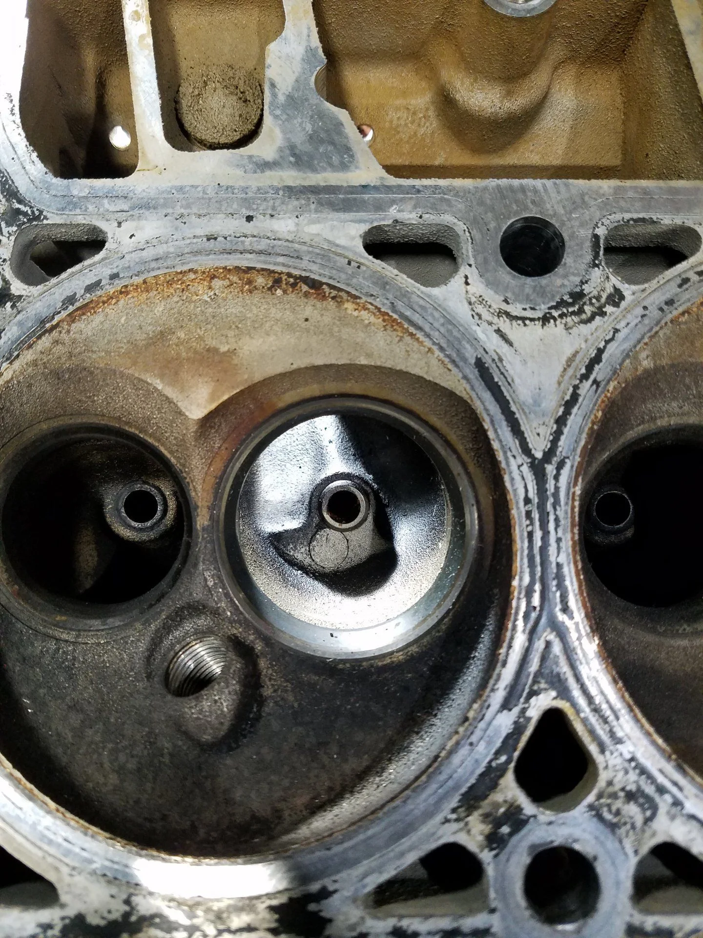

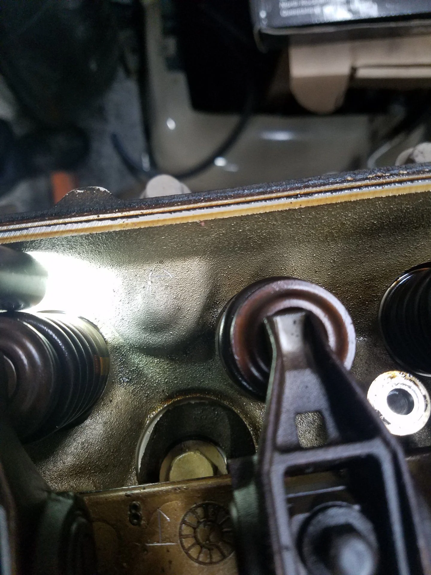

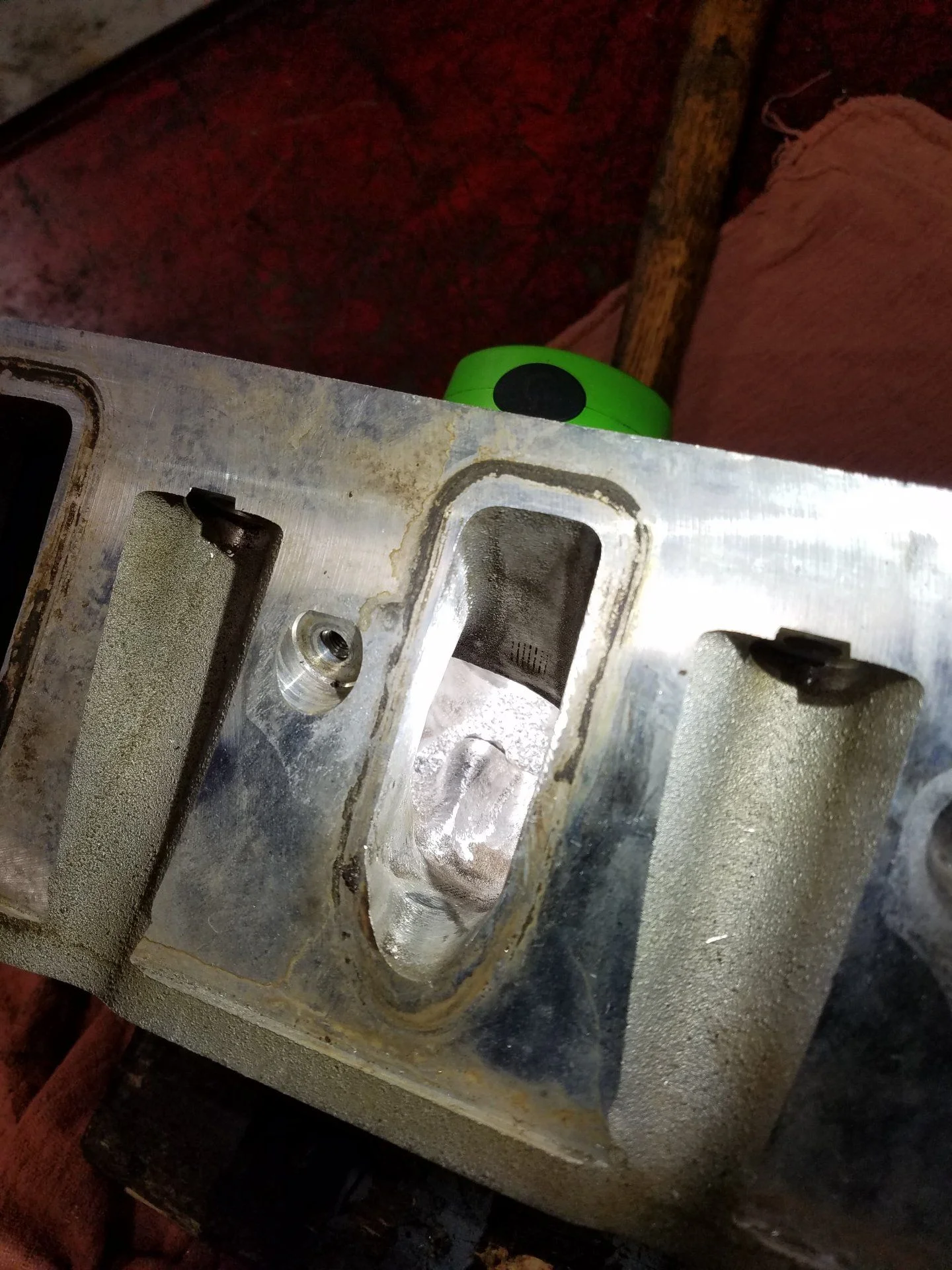

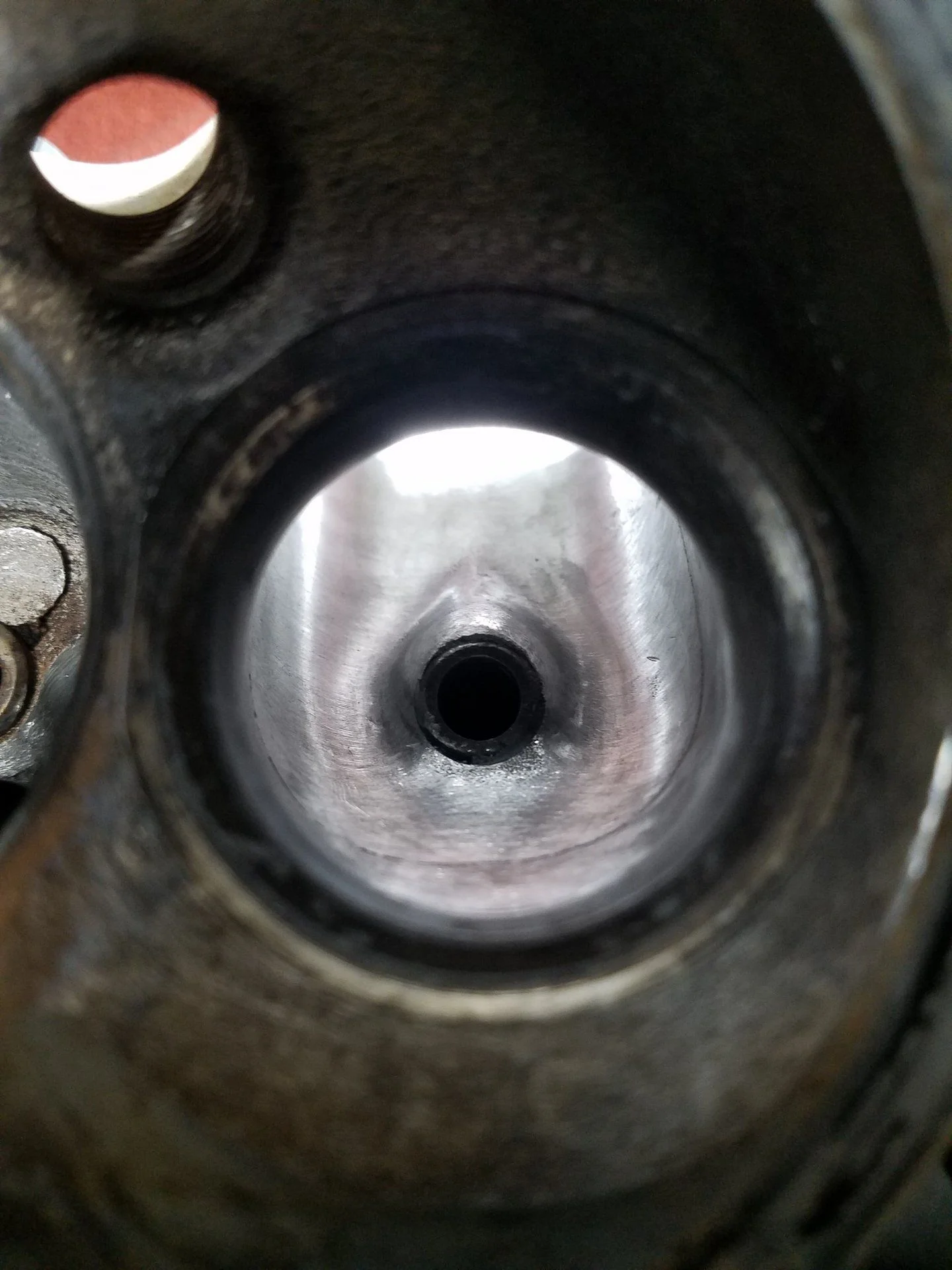

Because I'd been towing trailers more than I anticipated I was considering of doing a cam in the 5.3. It pulls ok but would like a little more. It's great otherwise. However to do a cam I either have to pull the whole front end apart or pull the motor. Both options require some down time. In addition the only way to get more low rpm torque is either forced induction or more cubic inches. I really dont want forced induction. So I bought a 6.0. My current 5.3 components will swap right over, including my injectors, accessories, headers, and wiring harness. I am also going to cam the 6.0. That will push my current injectors to their limit. While I'm saving up for the cam I've decided to do some minor port work. I'm a novice at this. Doing intake ports first. Trying to err on the side of caution. I actually find it very enjoyable except for when I'm near the valve seats. Here is a b4 and after. Hopefully it will help increase efficiency a little.
IMO keep going. Get some tapered sand paper rolls to hit it with after your material removal.

What head is that? How fine do you think I should go on the intake ports? My longer arbors are still in the mail for the sandpaper rolls. How critical is it to knock down the factory sand casting? Mainly I just tried to get out some of the larger obstacles or reduce them. I haven't enlarged the port itself hardly at all.
It is a 1FZ head. I like to use 80grit on iron heads and I will go as far as 320 on aluminum heads. Get the exhaust ports smooth. The intake ports you can leave a little rough if you don't want to take the time to buff them.
