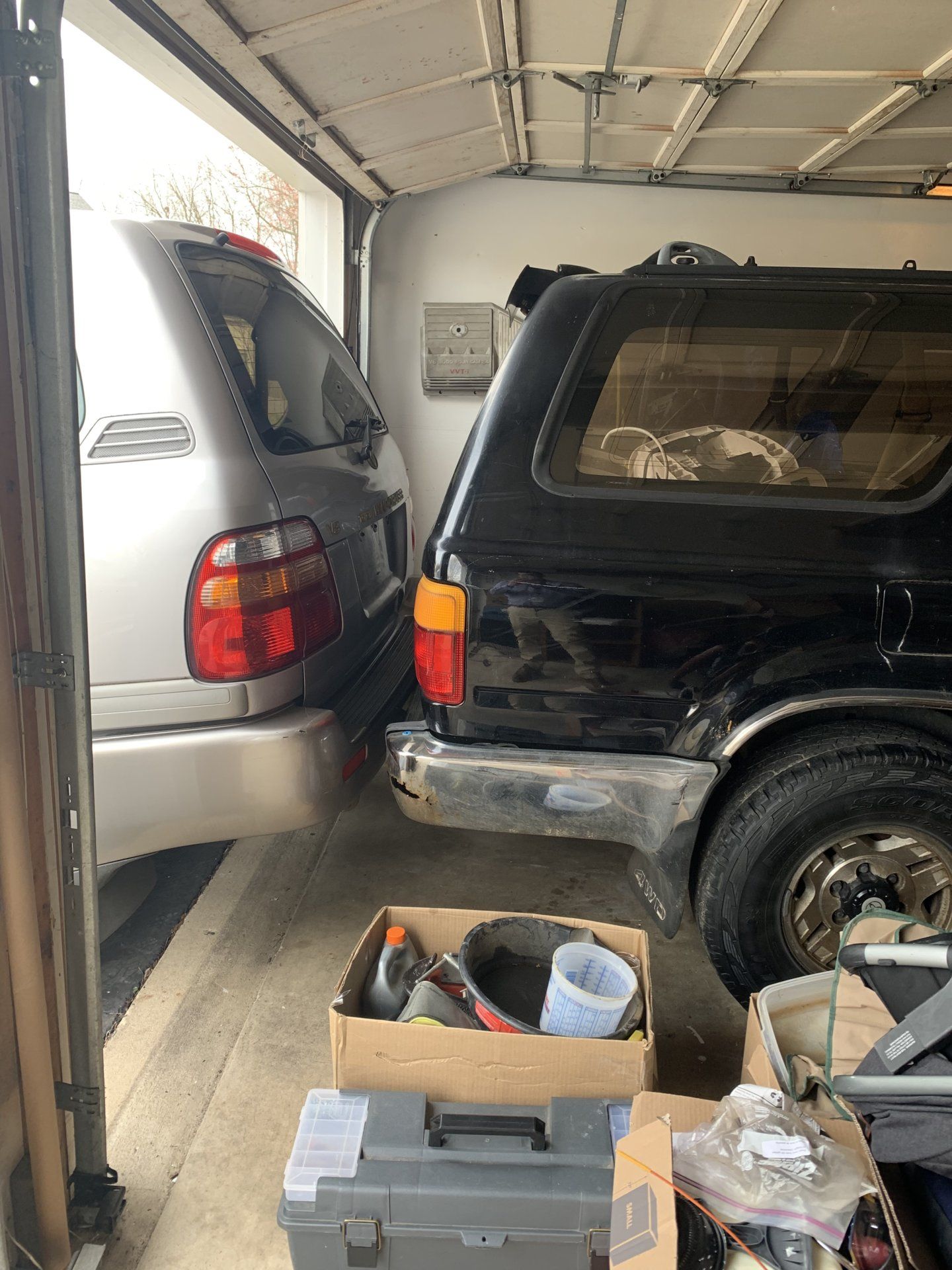

Had to move my 4Runner out of the way in the garage and of course the battery is dead from sitting. Rolled it too far back in neutral to be able to shut garage door. Wasn't sure what to do then it dawned on me that I have a leather clad Japanese tractor, so I used it to push the 4Runner back in enough to shut the garage.

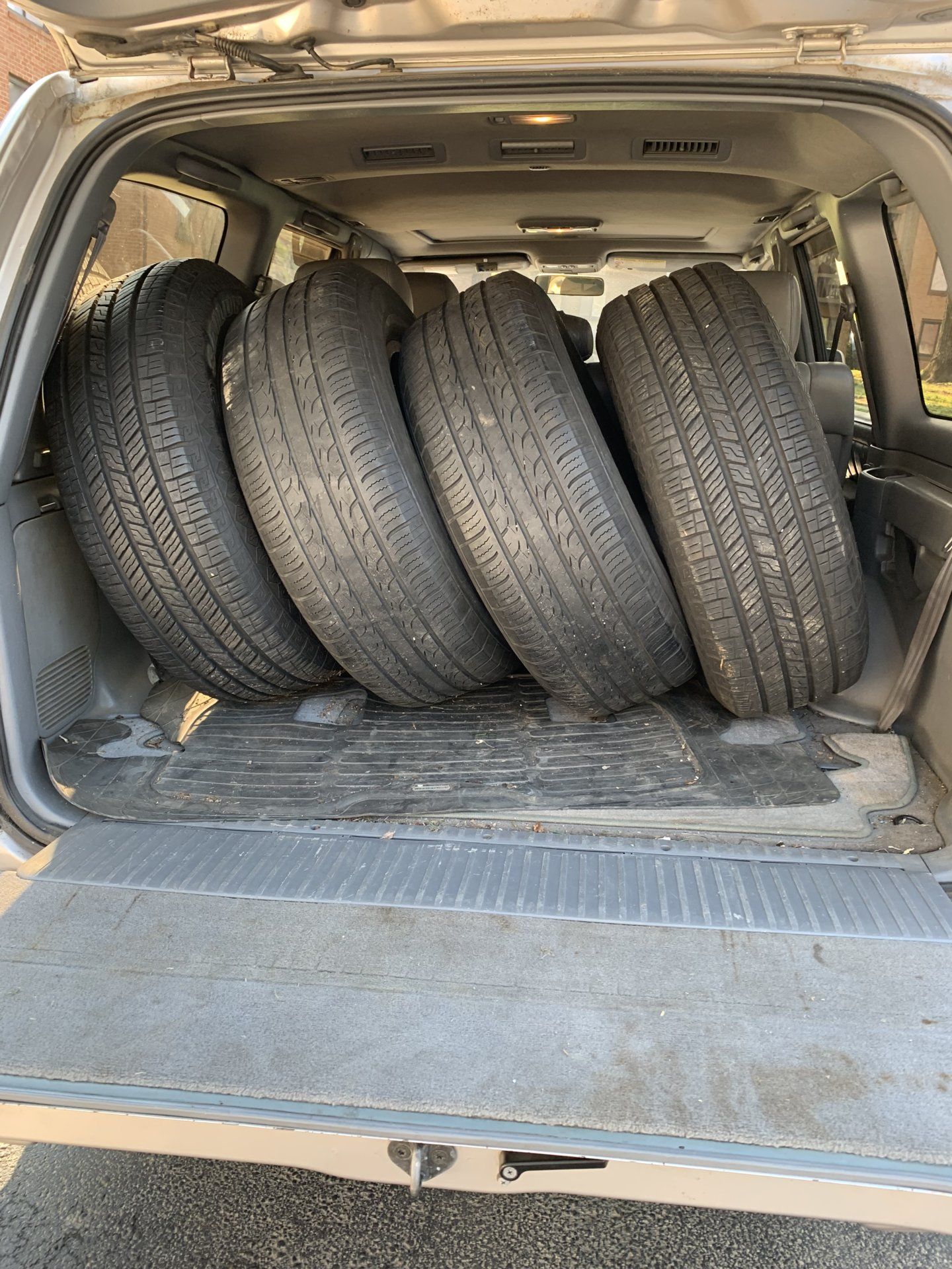

Went and picked up some tundra take offs.
My tires were 10 years old. Replacements are 4 and 2 years old, but in really good shape.
These are my 2nd fav tundra wheels behind the holes steelies. For $150 I can’t complain.

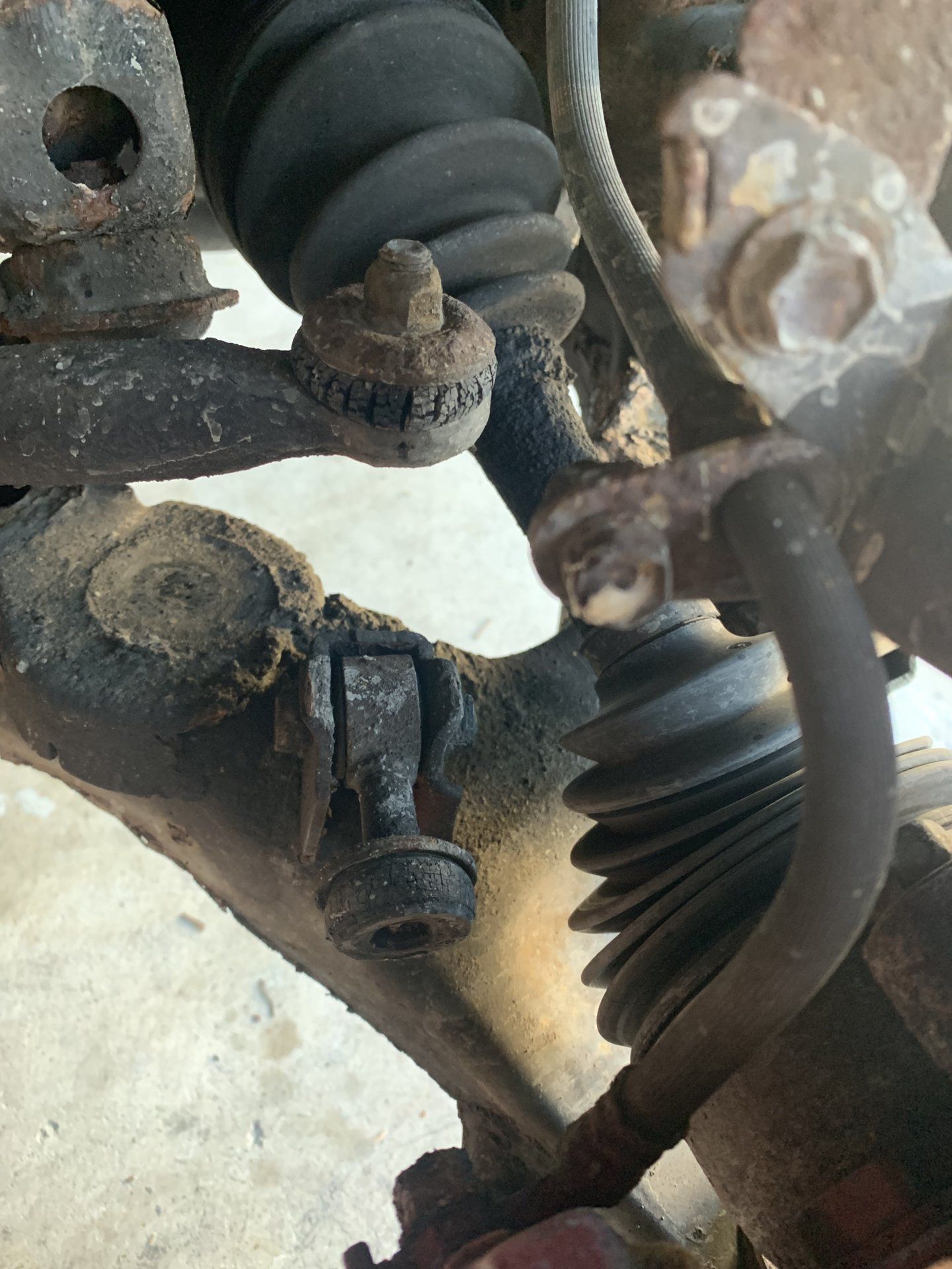

Had some hiccups and discoveries...

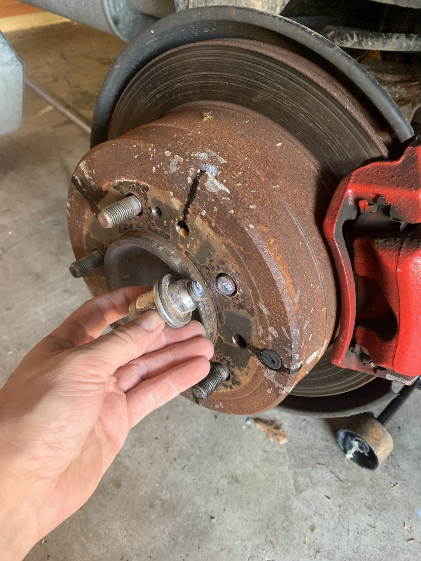

Might as well replace them all lol. one of the first things I had to do on my Rustyish Iowa truck. One broke, then 3... So I replaced every.. single.. one...
Haven’t done one before so I am hesitant to dive in. May hold out til my local chapter has a tech day and do it then... I searched here but couldn’t find anything definitive on how to do it
Rears are pretty easy, pull the brake rotors and you can see the axle flange. I think there was a a puller type press to get them out, you can use you old lug nuts to get the new ones seated. Fronts you have to pull the rotor. I was doing axles and bearings anyway so I did them while I had it all apart.

I will say with the 275/65/18's this truck drives so much differently. So smooth. I forgot how big of a difference crapped out tires can make on your drive quality.
Edit: Worth noting that when I went to pick the tires up, I filled up when I left and when I got back. Set my cruise at 60-65mph and got about 19mpg. That'll do pig, that'll do.
